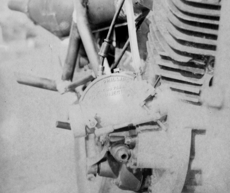

    Actually they were advertised at the time for road use as well as Racing, although Wal was a speedway bloke so IIRC they were first made for speedway. That means using alcohol which needs much less accurate mixture control than petrol.
    I used them and my clones for only a few years, always on race bikes only. I later used various carbs of my own design and later still discovered the Gardner carbs which were superior in all aspects. In the early 70s I moved to England to race in the island. I started a business making cast wheels and race chassis and Ron Gardner came to me for a chassis to resurrect the Rudge marque for which he and a partner owned the rights. He had stopped making the carbs then due to other work, we had become friends and I approached him with the idea that I restart the manufacture of the carbs, but with a slight difference. I was getting a lot of magnesium castings done and I talked him into letting me make them in Magnesium. Since then the interest in classic racing has boomed and those carbs are being made again by the Gardner family but in aluminium again. i still use Gardners on my race bikes unless the regulations forbid them, some organisations do. Then I use a Dellorto SS1.
    Cycle thread taps & dies-wp_injector01.jpg Click for full size view.
    Initial fitting of a WP "injector" on a 2 stroke which was the first engine that I ever built. I did the casting in the backyard.

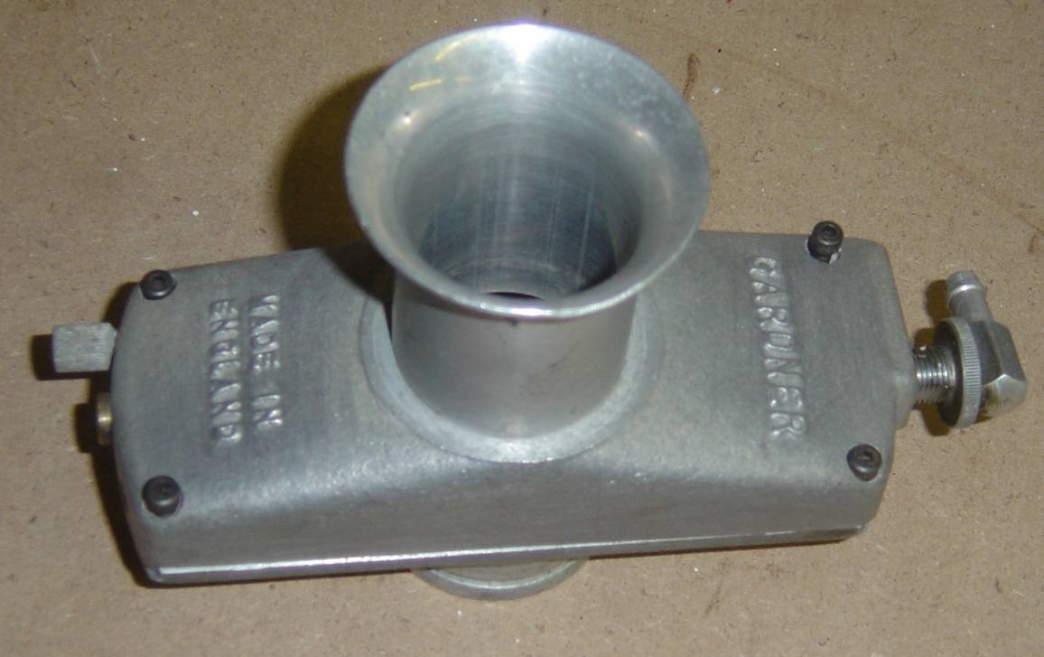

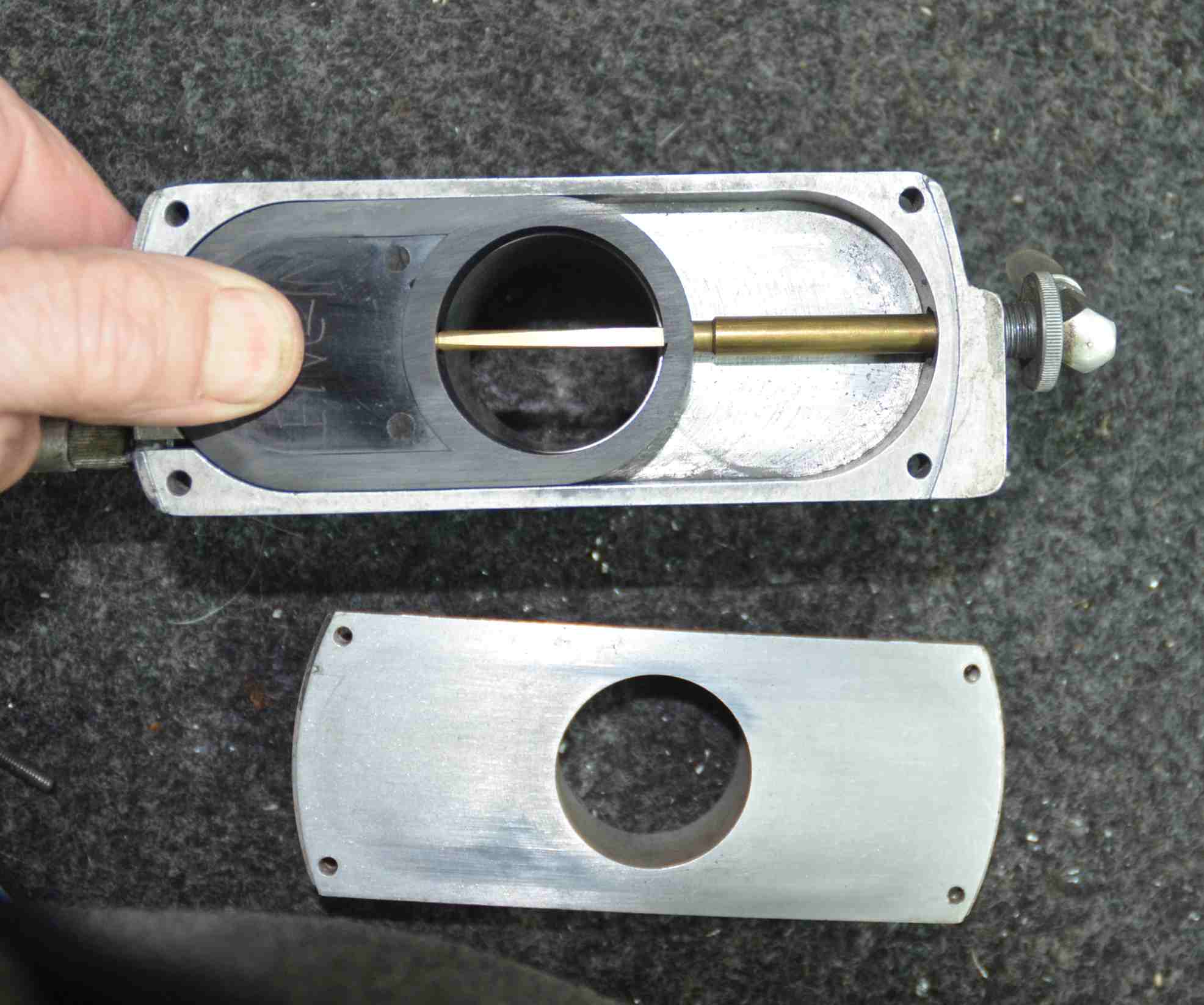

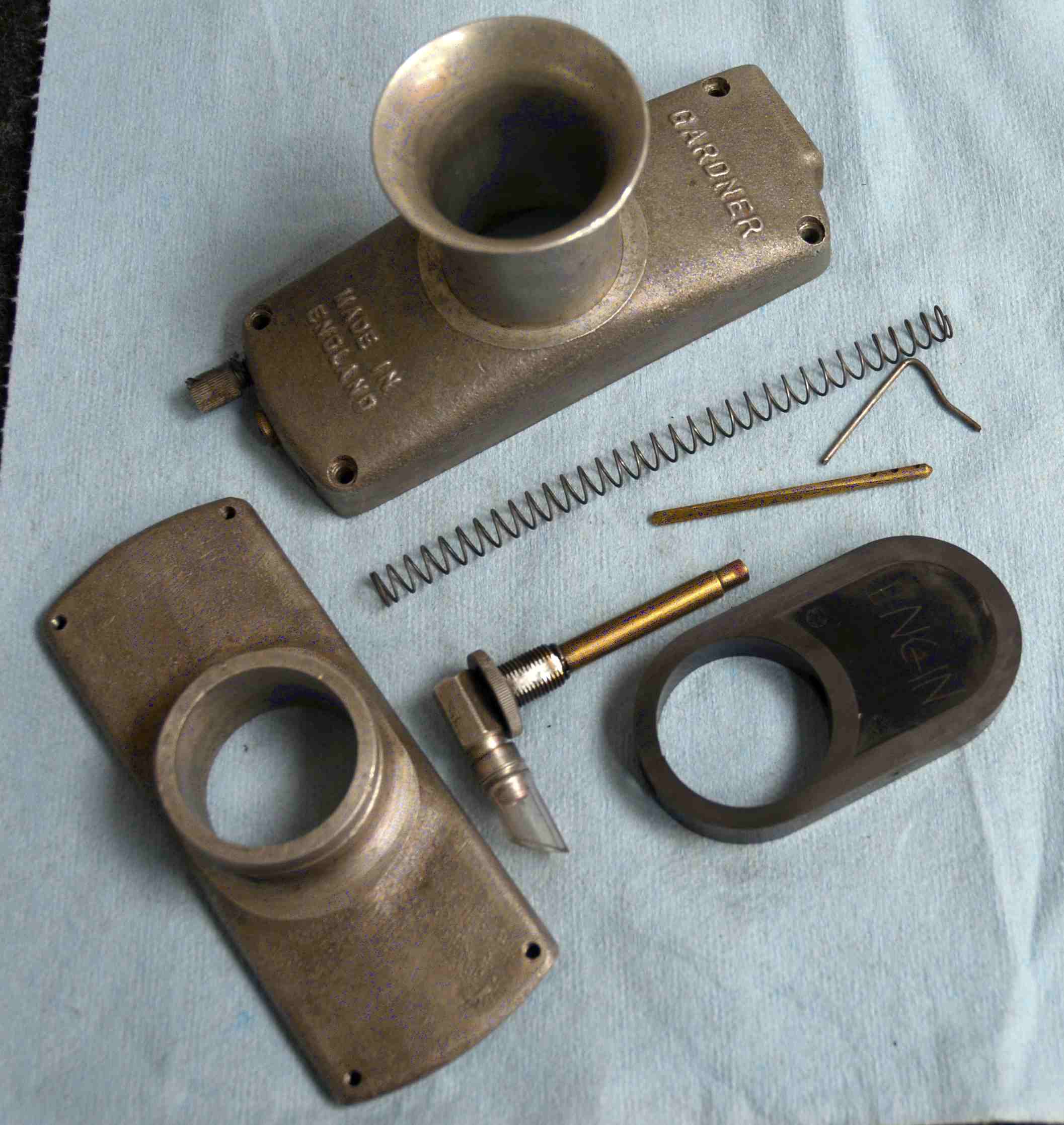

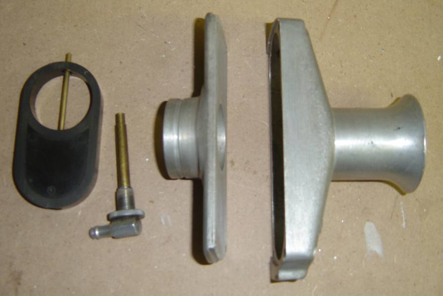

    it was simple in concept, that is an air valve connected to a fuel valve via an adjustable linkage. However, that simplicity hid some underlying complexity in matching those two valves which was beyond what the linkages could correct, unless the design was spot on for the engine under consideration.
    The problem stems from the relationship between the flow area and angular opening of each valve. neither are linear due to the nature of air and fuel flow and geometric effects. As a quick example, imagine that the fuel valve is too large for the engine. A first thought would indicate that you only have to adjust the linkage to open the fuel valve less relative to the air valve. The problem with this is that then the fuel valve is operating in the range where the geometry dictates that the rate of area increase is high. In other words a small increase in the throttle valve opening will result in a disproportionately greater opening of the fuel valve compared to a carb with a smaller hole in the fuel valve. Therefore in order to be able to get good mixture ratio throughout the opening range you would have to size the fuel hole to each engine. Of course as this was sold as a general purpose device the hole sizing had to be a compromise.
    On the other hand the Gardner was just as simple mechanically, but much more sophisticated in its mixture production.
    Cycle thread taps & dies-gardner01.jpg Cycle thread taps & dies-gardner07.jpg Click for full size pix.
    Cycle thread taps & dies-gardner12.jpg Cycle thread taps & dies-gardner19.jpg
    Pix of a Gardner.

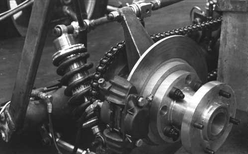

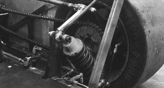

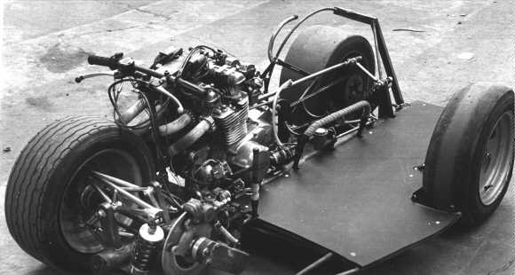

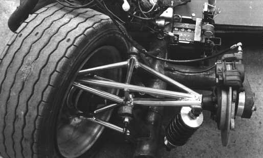

    Although I built two championship winning sidecars, my own attempts at riding asymmetric three wheelers always ended with Desperate Dan style holes in hedges. diabolical invention. Actually it was my inexperience with sidecars that allowed me the freedom of thought to design something a bit different which worked well. Today's racing rules have outlawed most of what I did. Here are a couple of pix.
