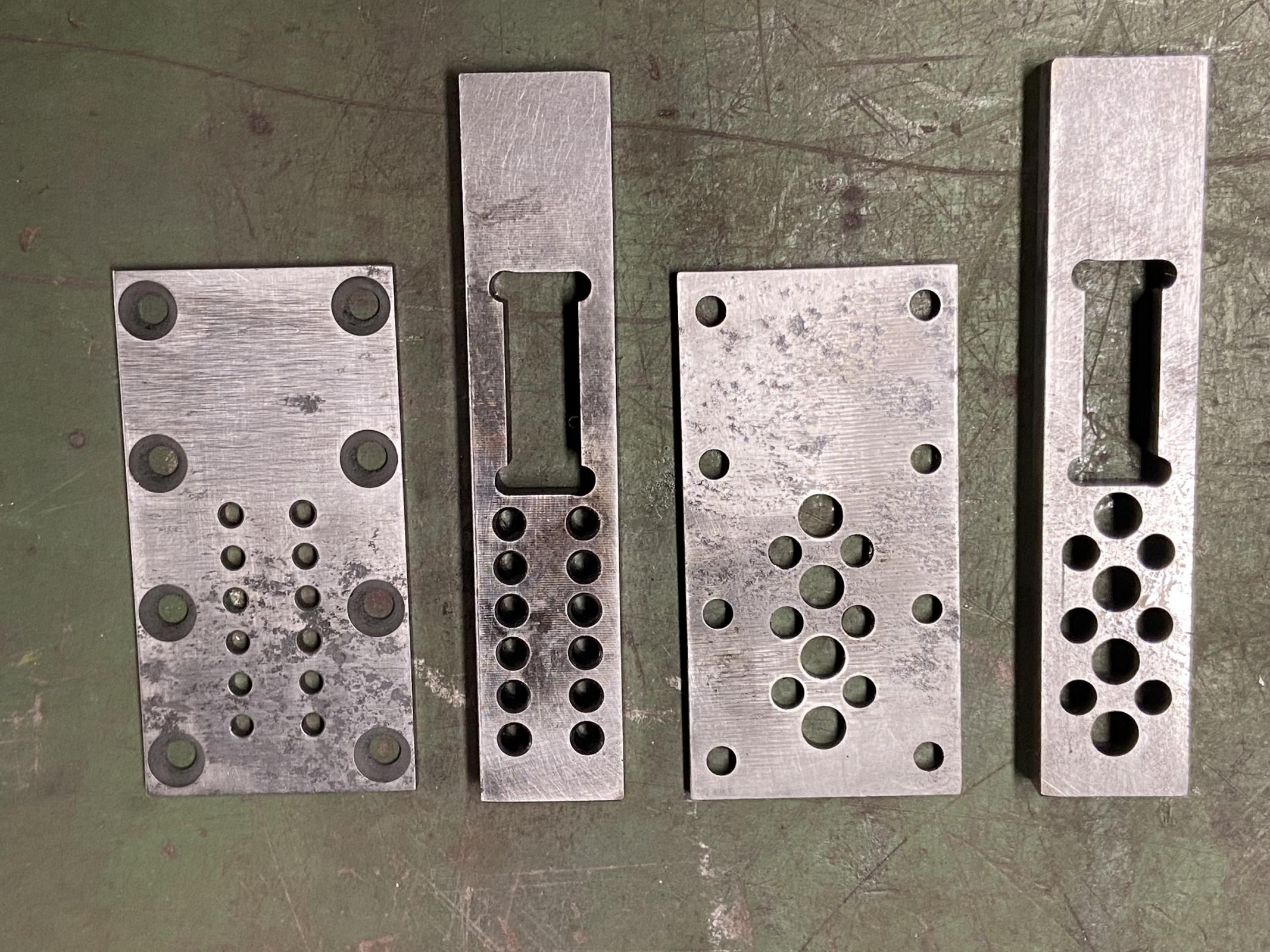

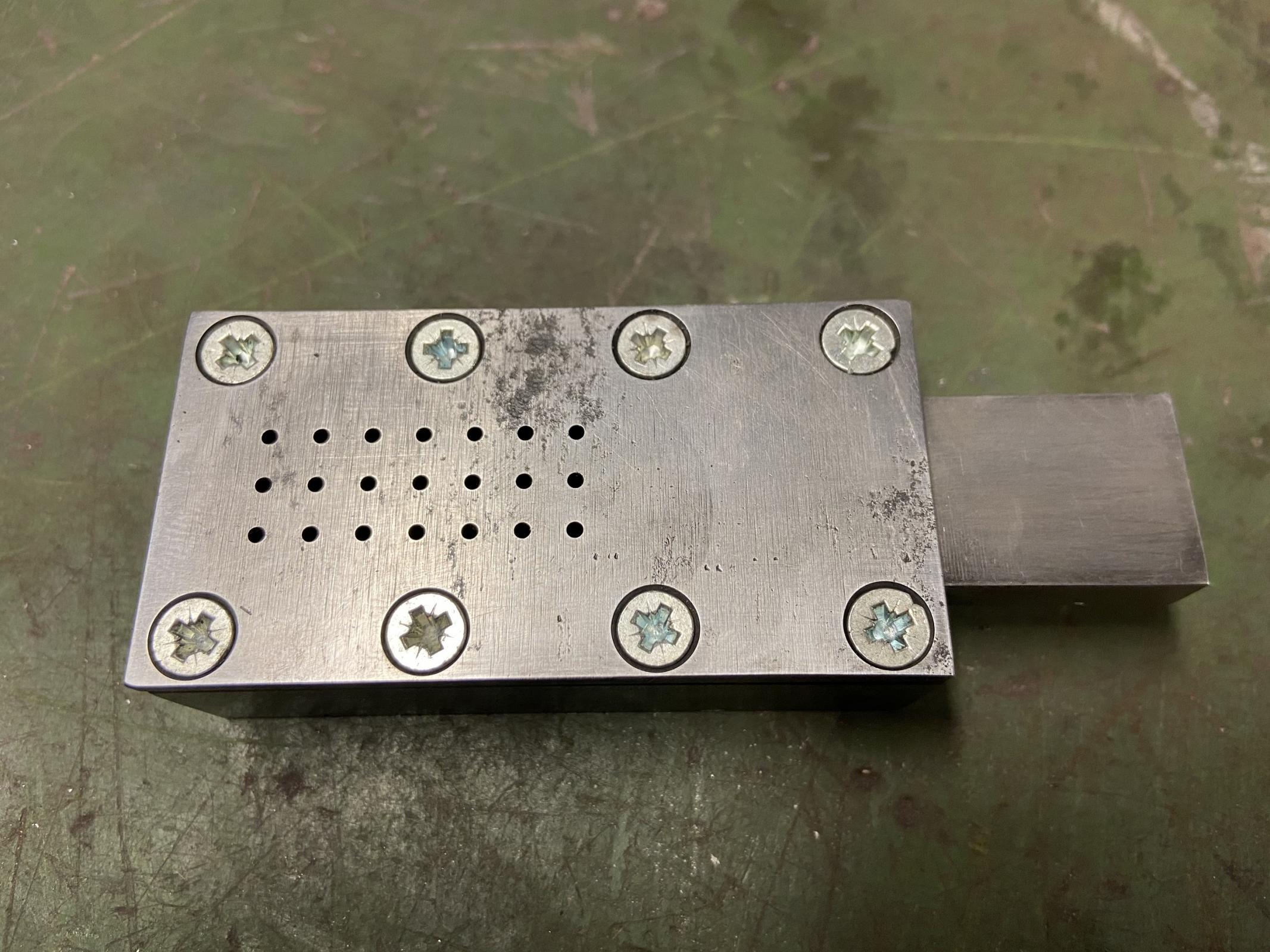

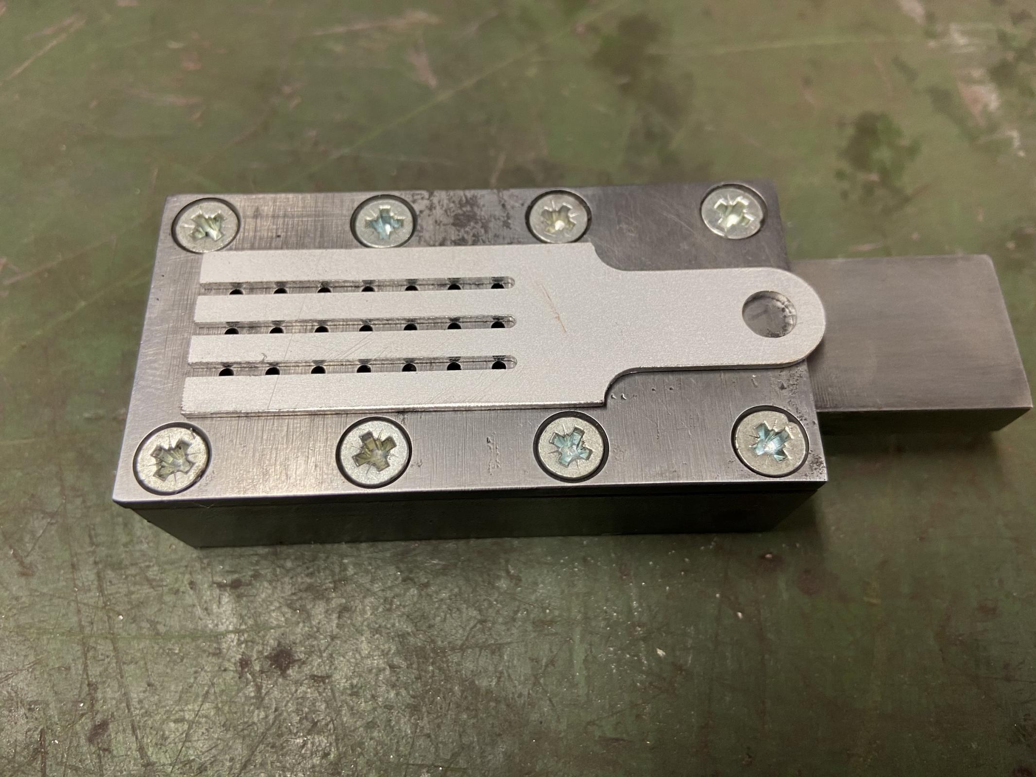

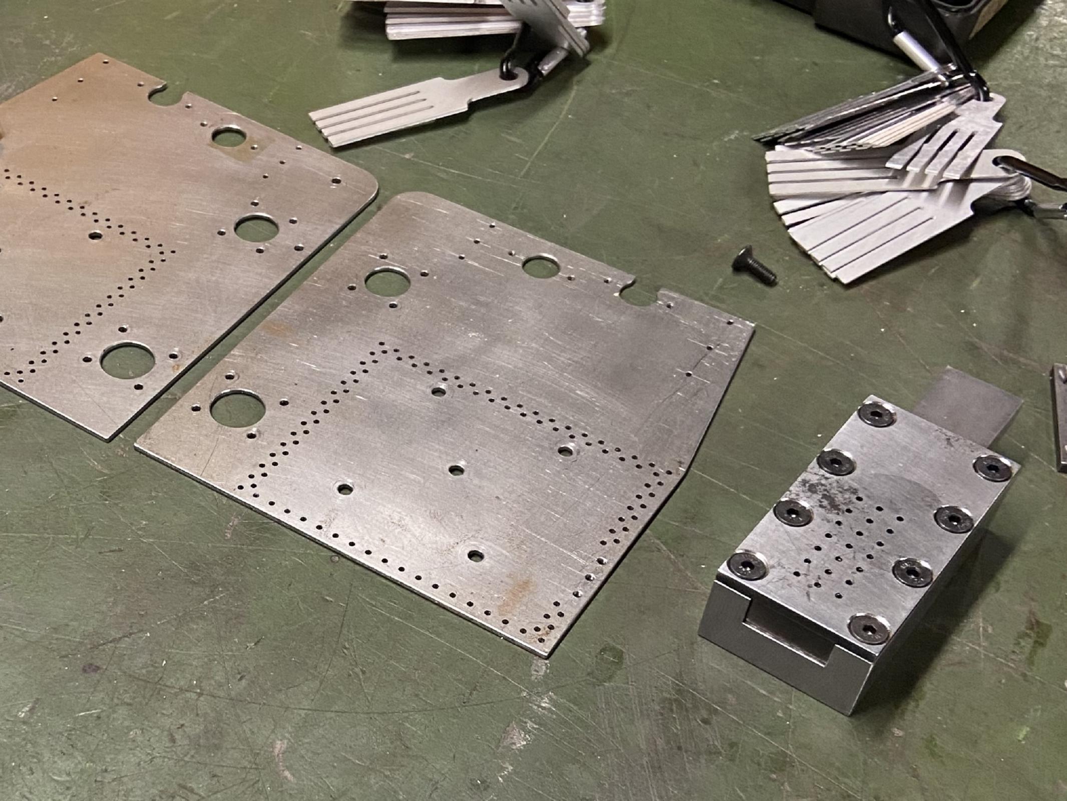

    I have quite a few solid rivets to shorten for dummy rivets on the horn plates of my 1" scale Minnie traction engine. So the criteria for the tool was to be able to cut several rivets at a time and maintain consistent length accuracy.
    Horn plate and rivet cutting tool.

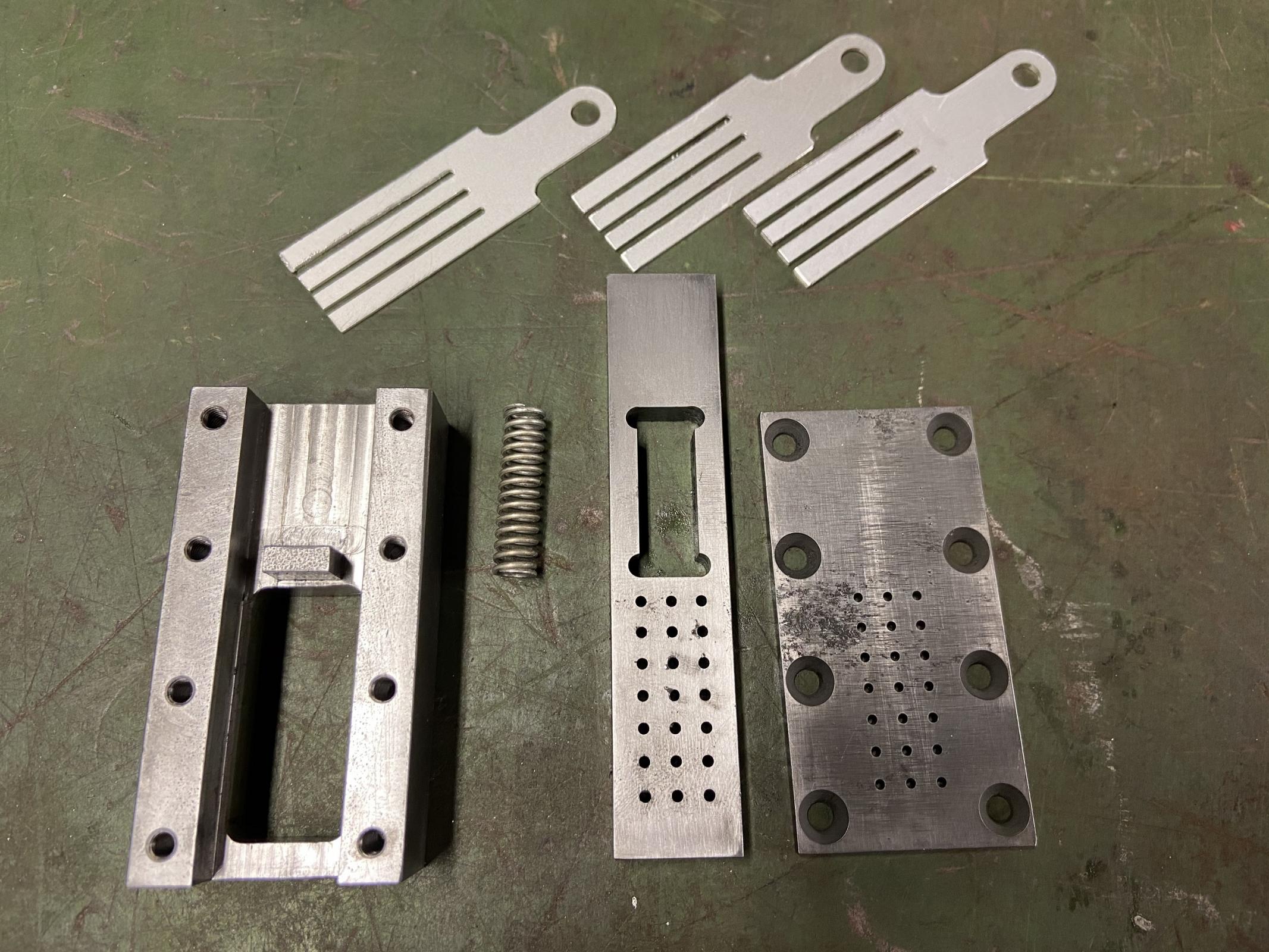

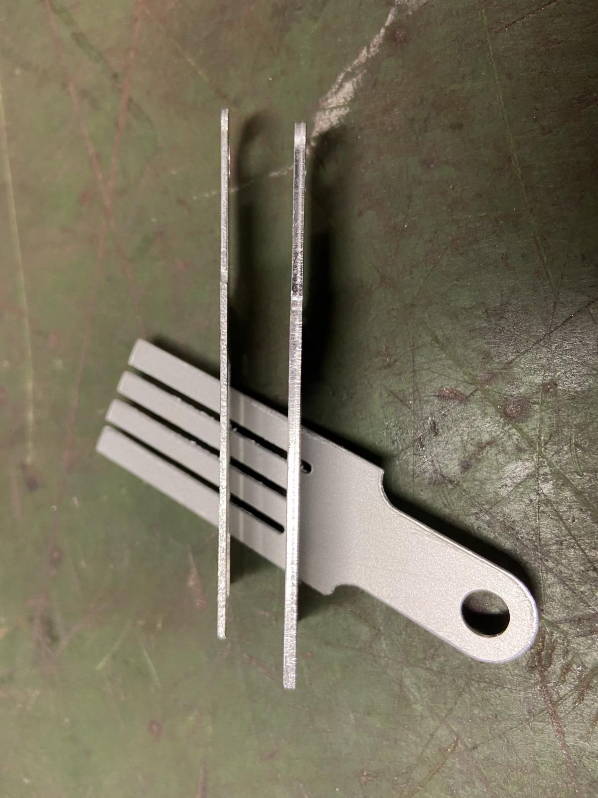

    The tool is basically a guillotine that is loaded with rivets and the length is set by shims under the head of the rivet.

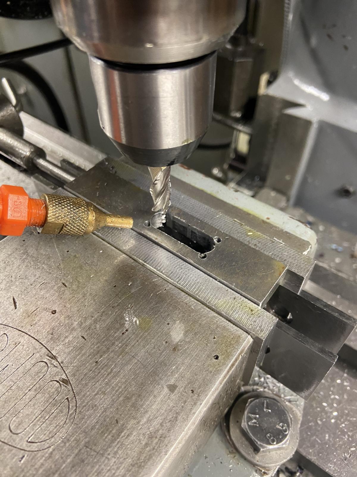

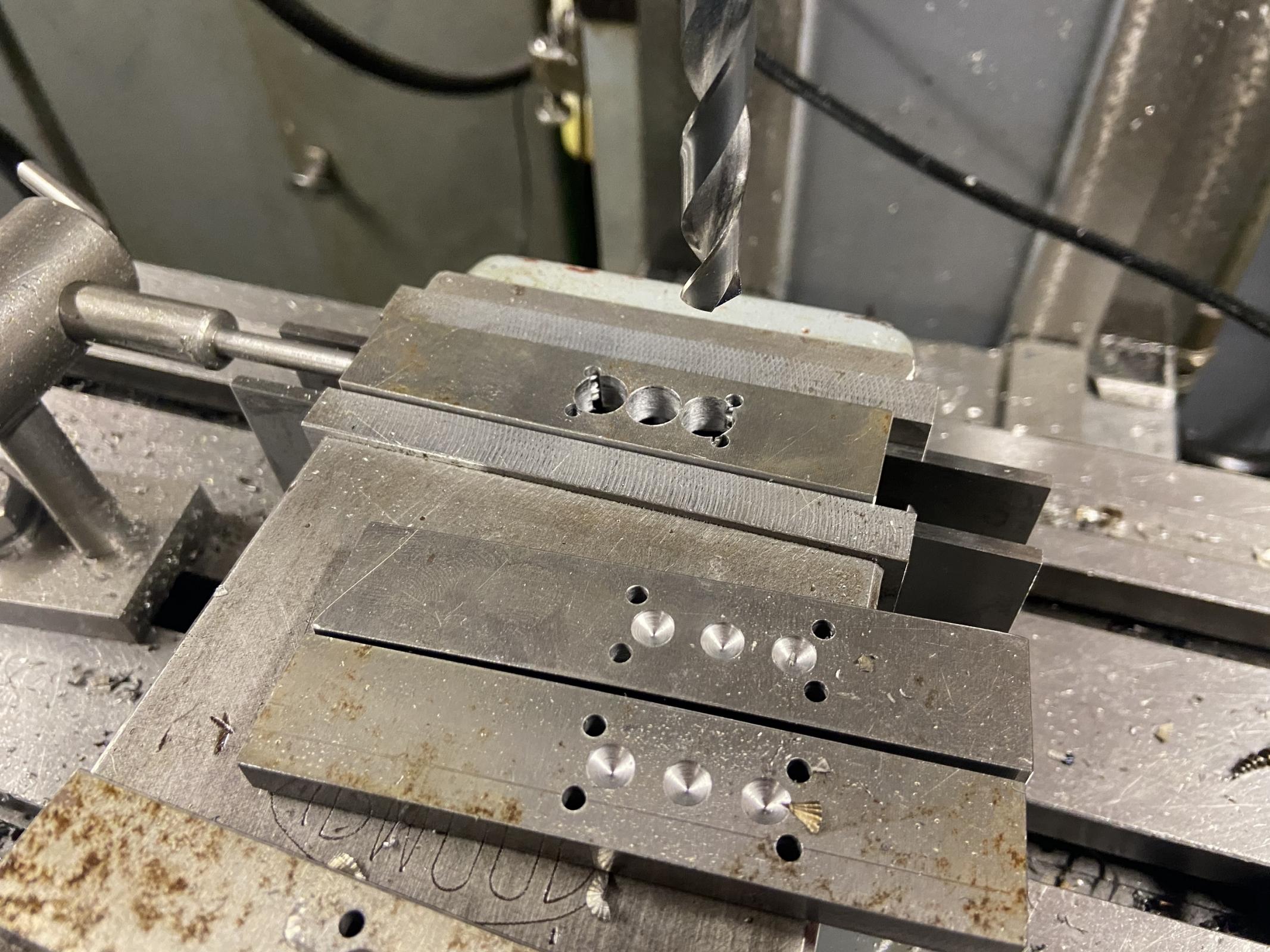

    Shims, 3 different thickness. I have access to a CNC mill and made the shims using this method.

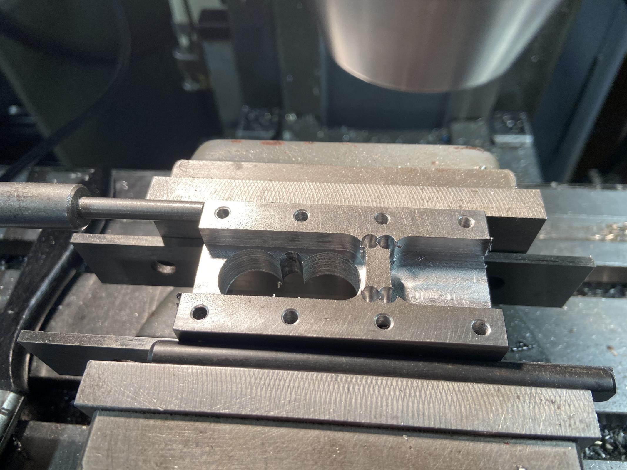

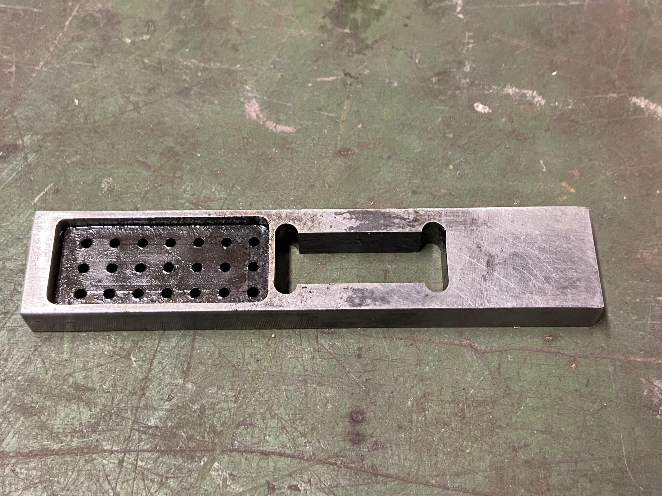

    cutting solid rivets to correct length to form button heads-chain-drilling.jpg cutting solid rivets to correct length to form button heads-clearing-chain-drilling.jpg cutting solid rivets to correct length to form button heads-body-roughed-out.jpg
    Machining main body and sliding cutter

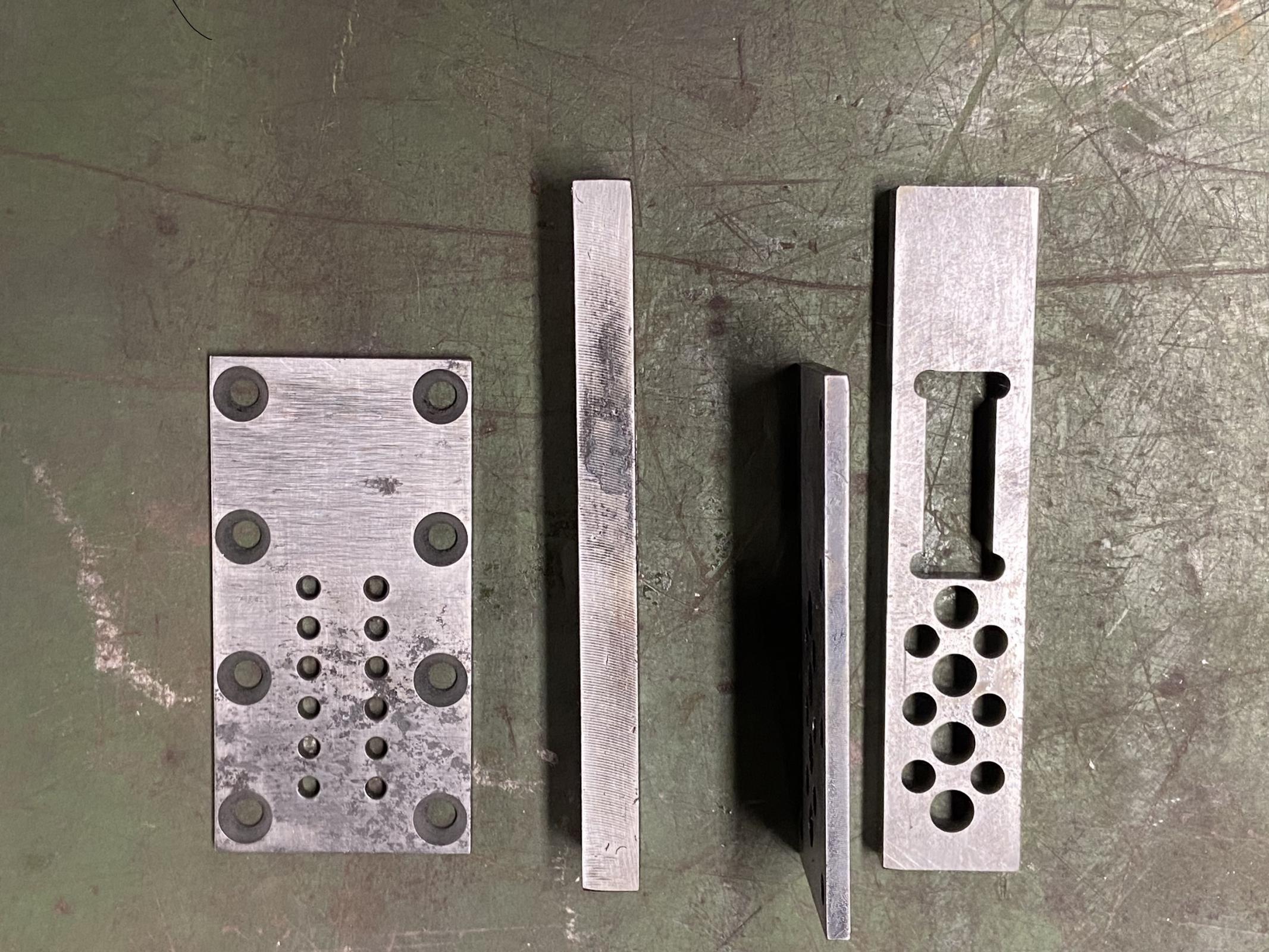

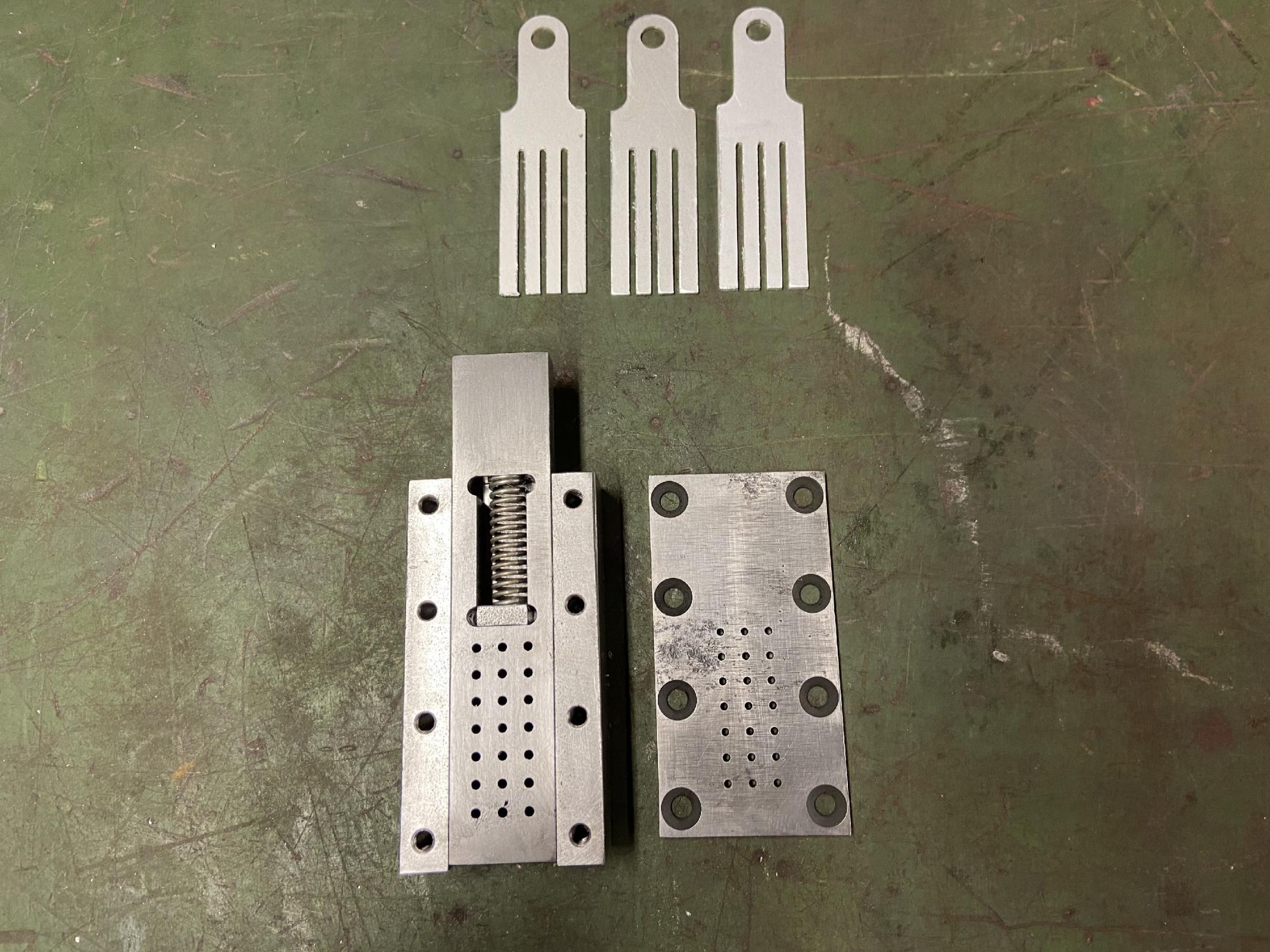

    cutting solid rivets to correct length to form button heads-unassembled-cutter.jpg
    Completed unassembled cutter.
    cutting solid rivets to correct length to form button heads-additional-cutters.jpg cutting solid rivets to correct length to form button heads-width-cutters.jpg
    Additional cutters and the thickness of each
    cutting solid rivets to correct length to form button heads-assembeled-guillotine.jpg cutting solid rivets to correct length to form button heads-spring-return.jpg
    Assembled cutter and spring return in left photo

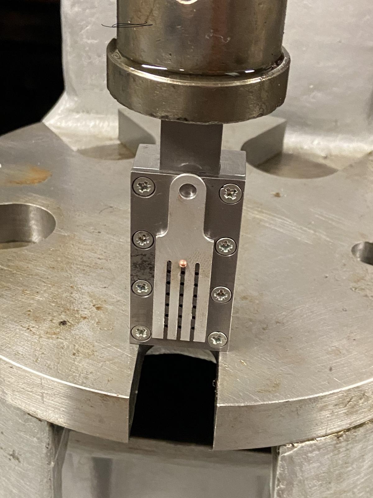

    Shim in place

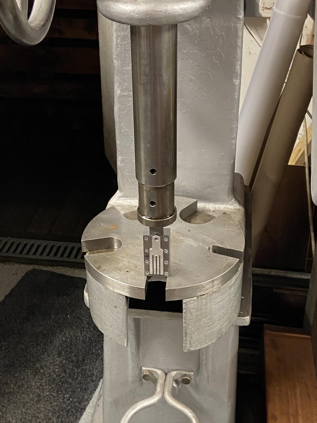

    cutting solid rivets to correct length to form button heads-arbour-press.jpg cutting solid rivets to correct length to form button heads-tool-press.jpg
    Arbour press used to apply pressure to cut

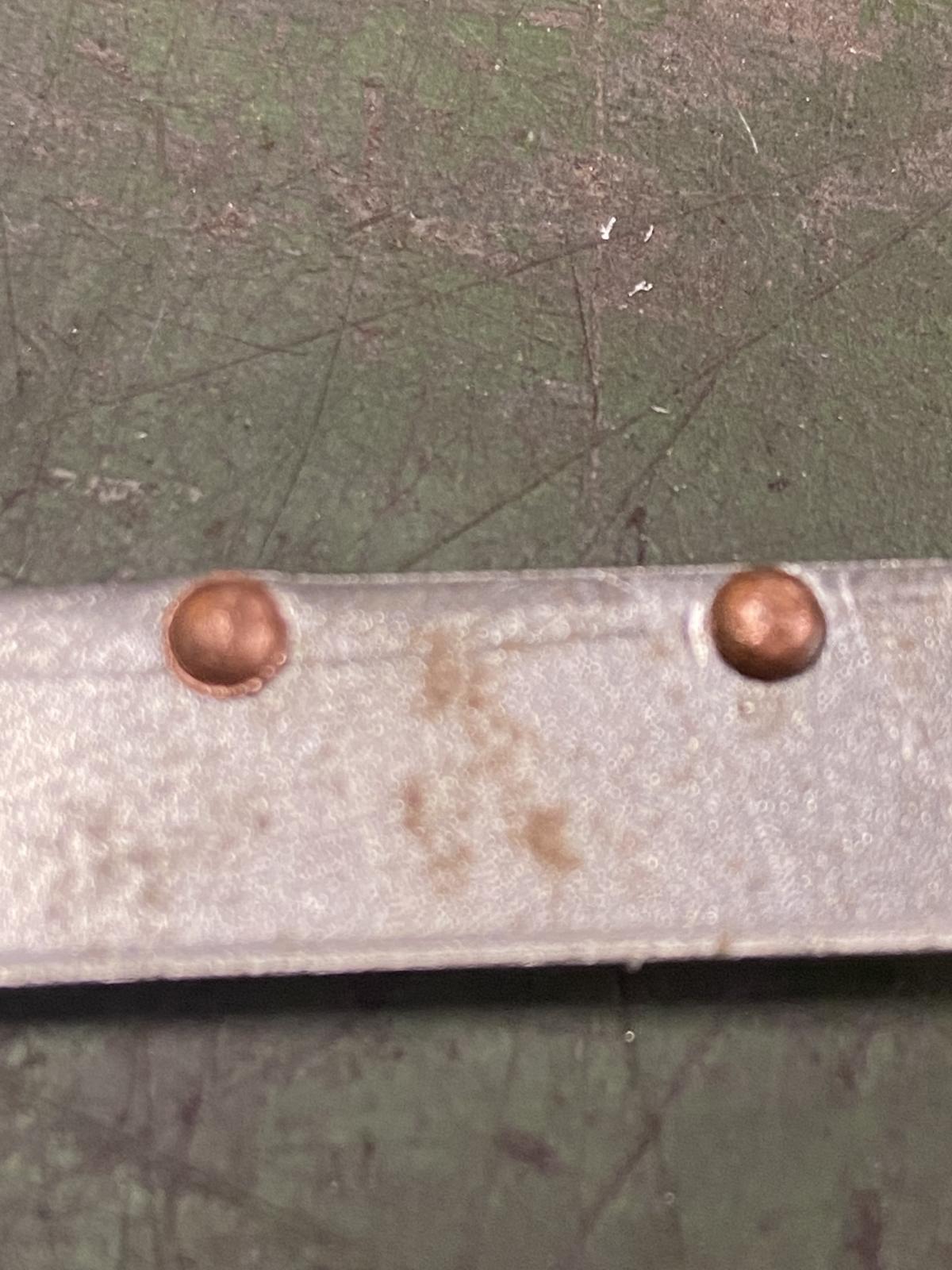

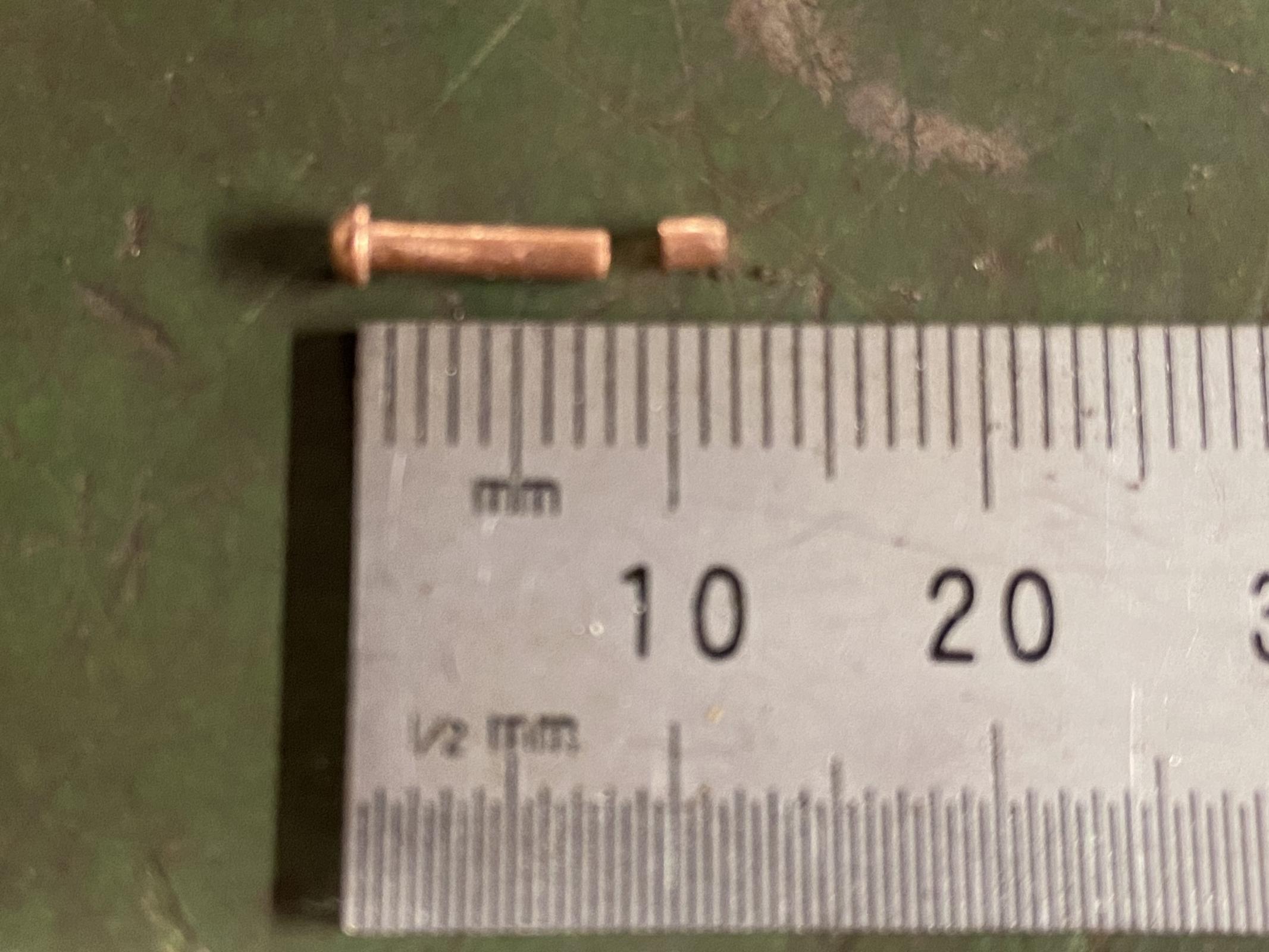

    Test cut

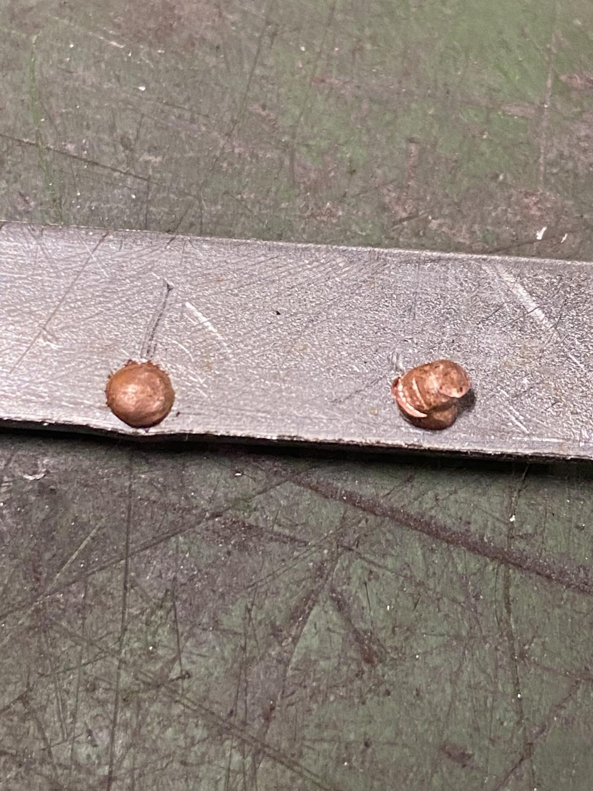

    cutting solid rivets to correct length to form button heads-img_4497.jpg cutting solid rivets to correct length to form button heads-img_4498.jpg
    Right rivet head the rivet was to long so the head didn't form correctly the left rivet was the trimmed rivet. The 2nd photo shows the preformed head side.

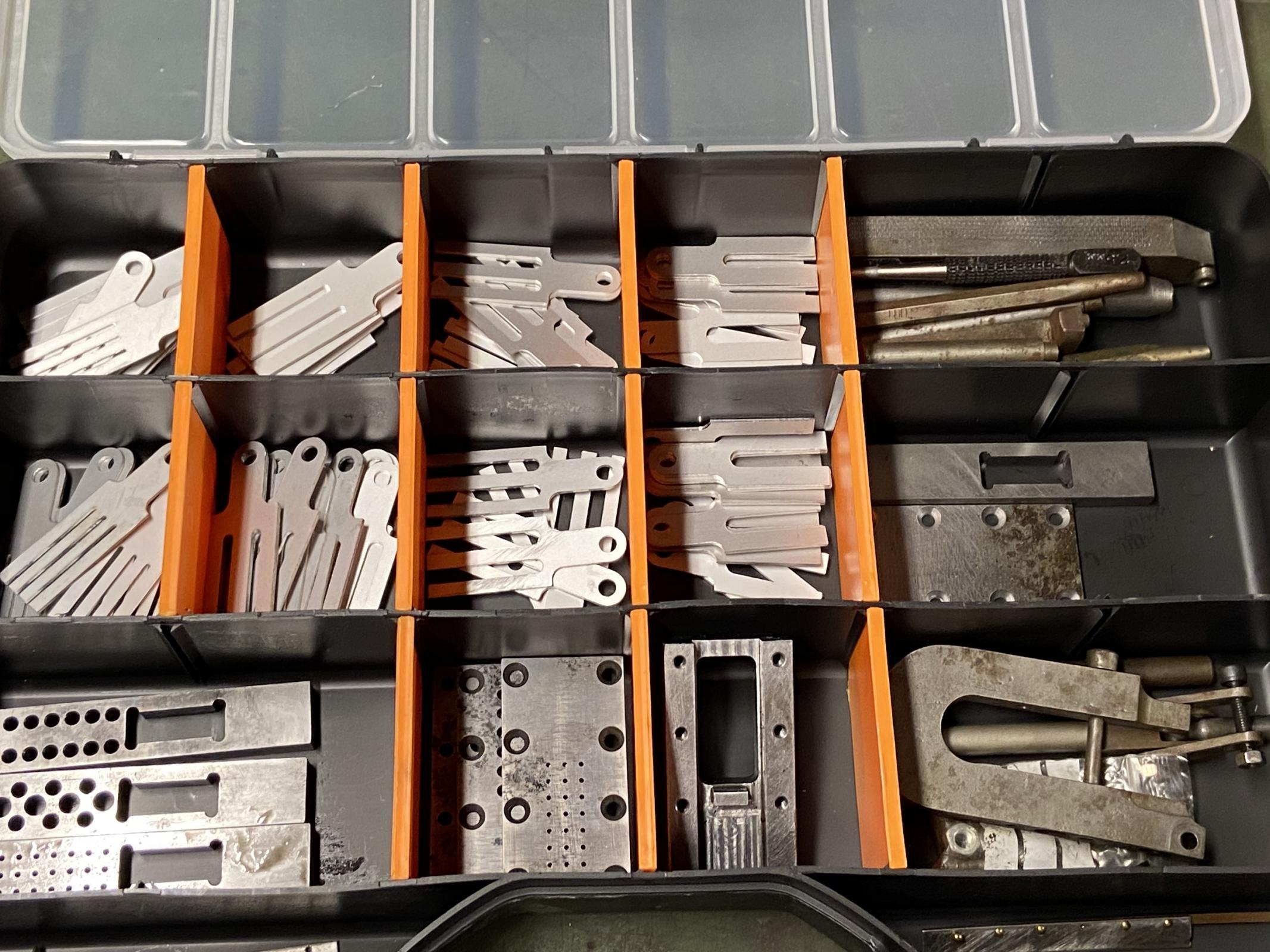

    Storage box for rivet tooling
