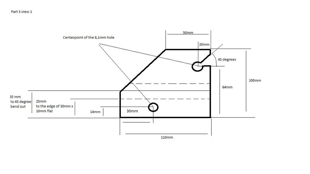

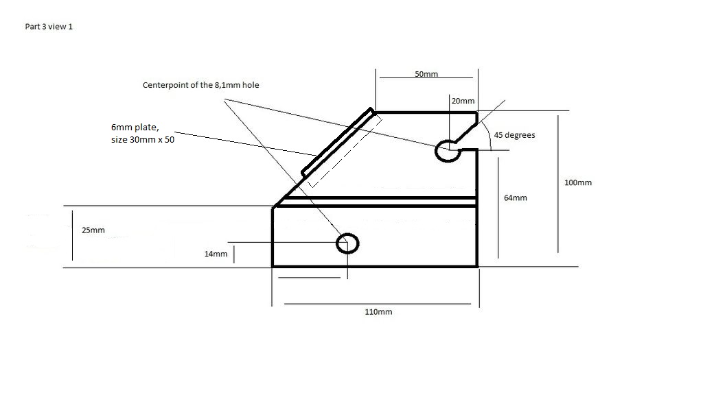

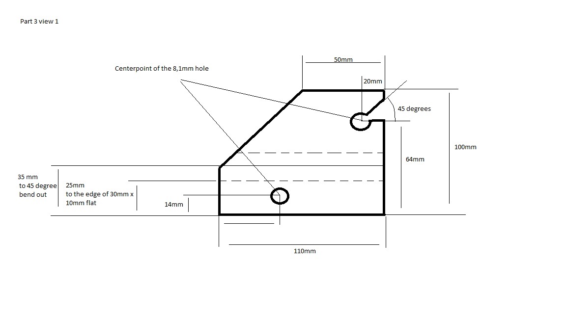

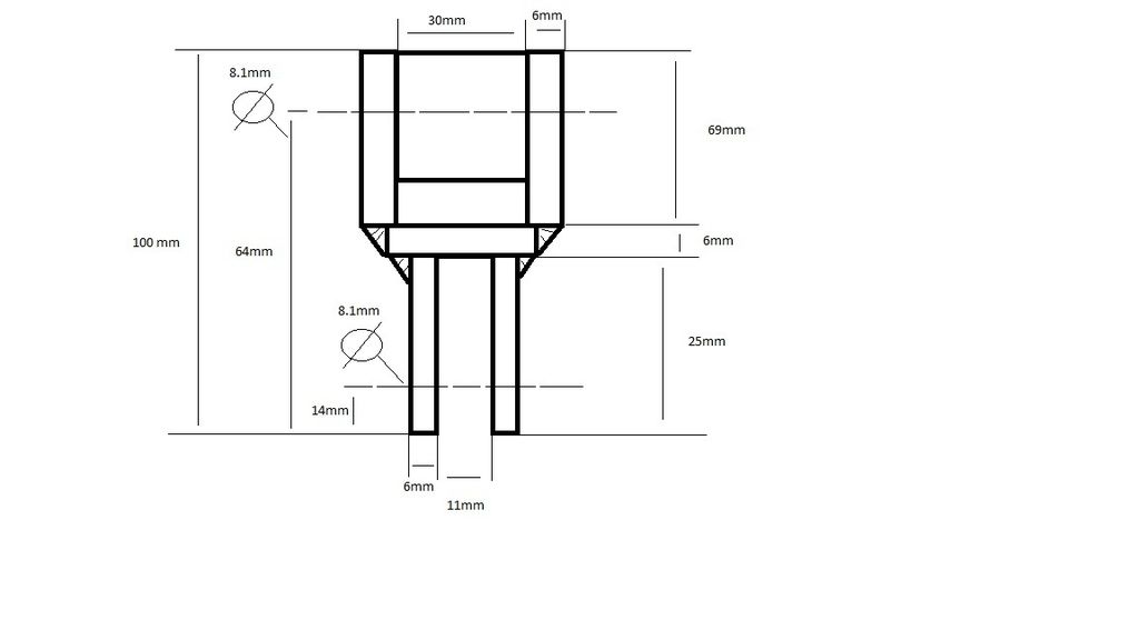

    Here is my new tool.
    Its a vise/clamp kind of thingy:
    Attached Thumbnails Attached Thumbnails Cutting bench / vise / clamp-part-3-view-1.jpg   Cutting bench / vise / clamp-osa.jpg   Cutting bench / vise / clamp-jpegkuva.jpg   Cutting bench / vise / clamp-fbvs0mlk8zzazpx.large.jpg
    Download plans for clamps.

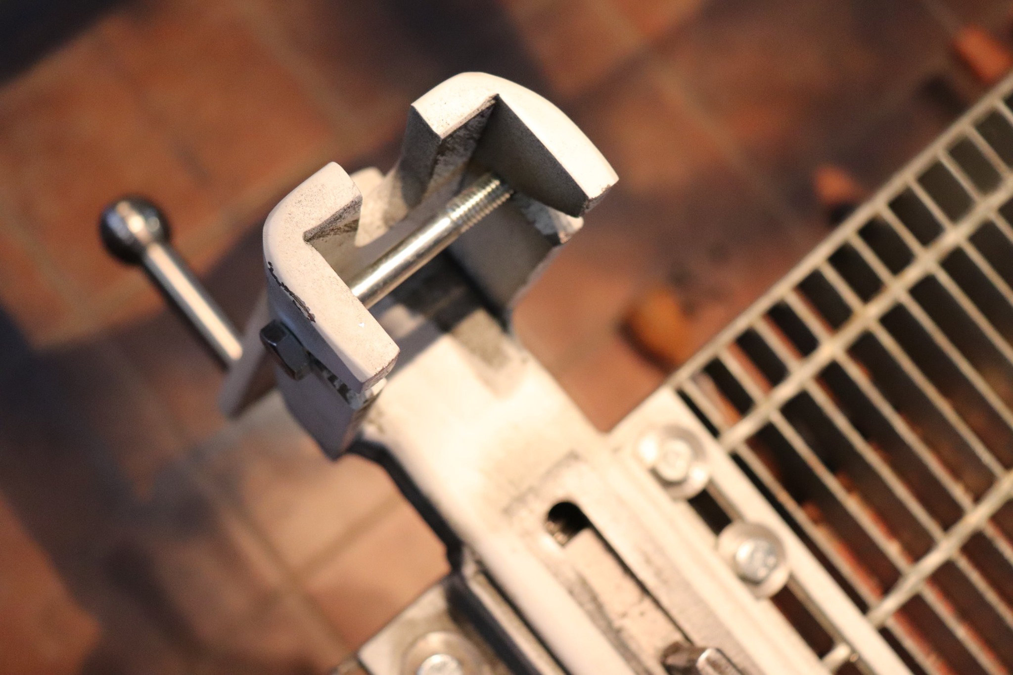

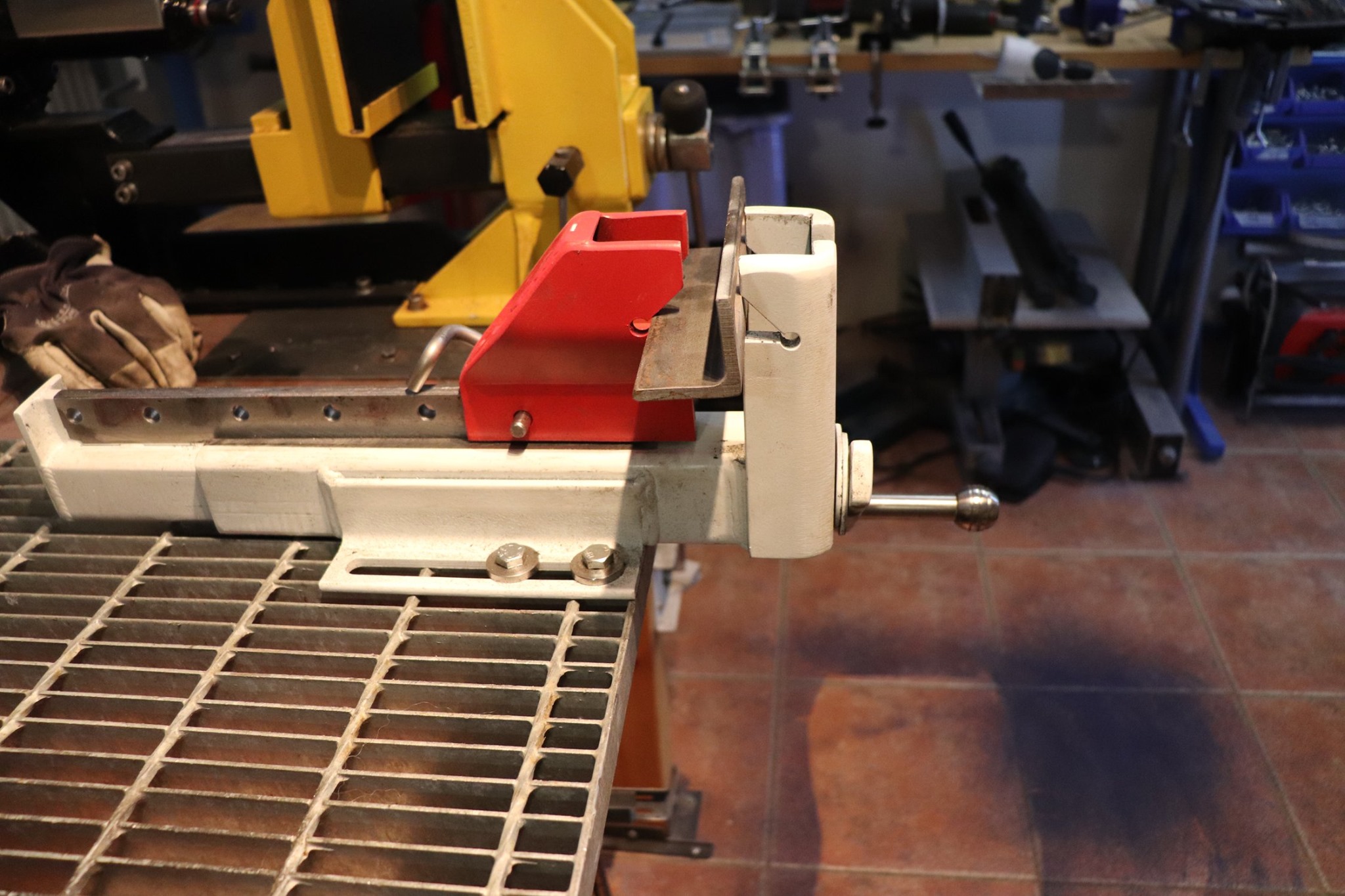

    I supposed to make a short video about making "tooling" for this. But i have fever. So, i decided to leave it for now.

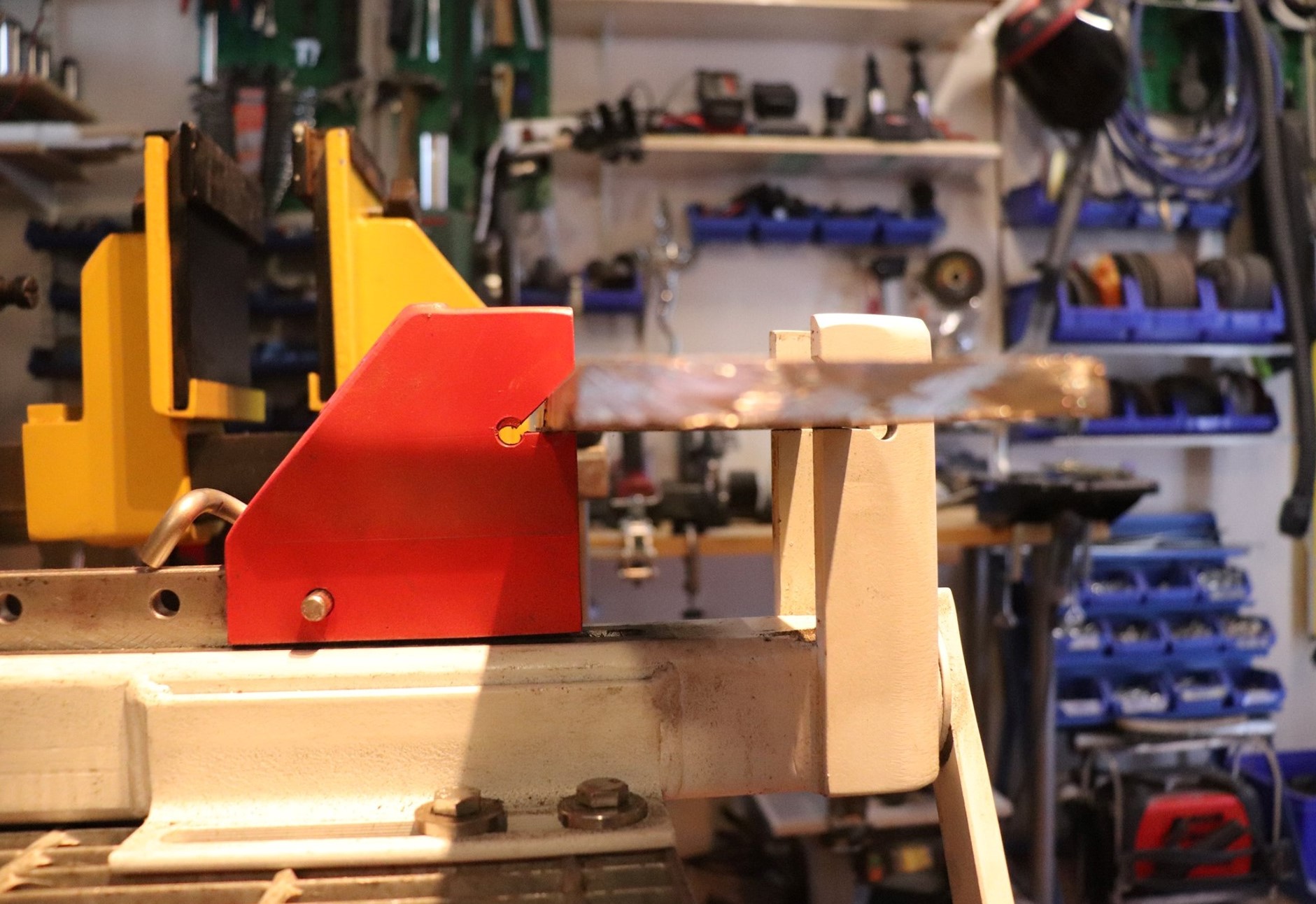

    Here is some pictures.
    As you see, Half V shaped jaws works nicely for holding different shapes.
    Cutting bench / vise / clamp-6.jpg Cutting bench / vise / clamp-7.jpg Cutting bench / vise / clamp-8.jpg

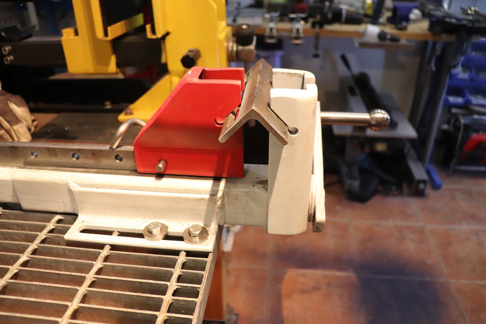

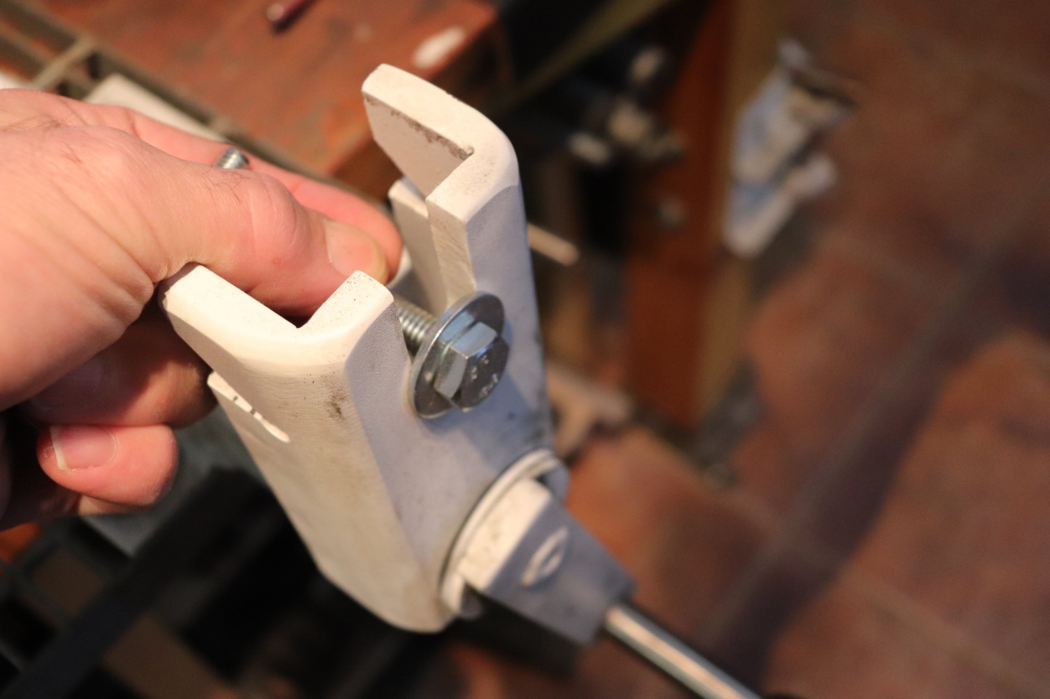

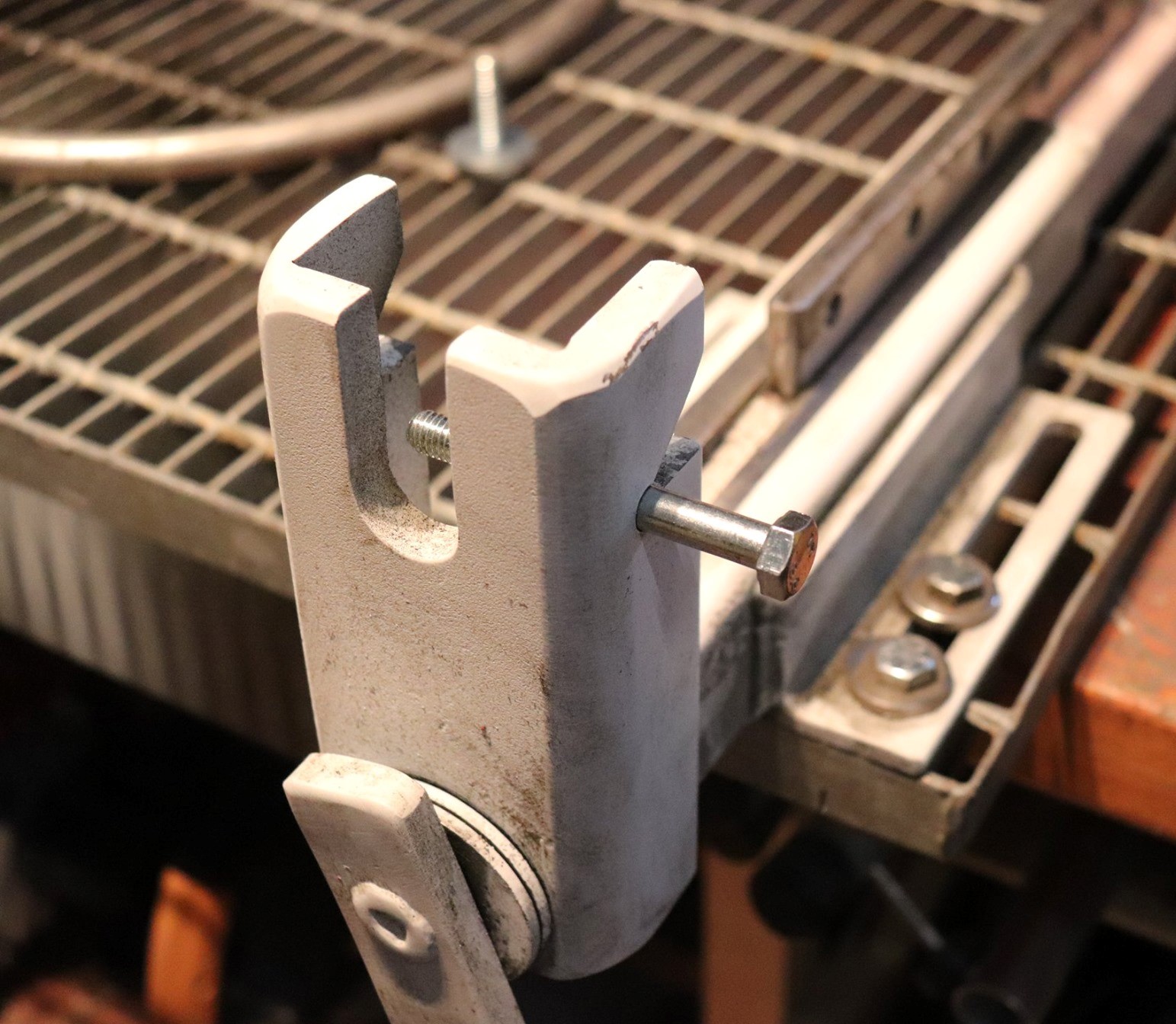

    Of course, sometimes you need bigger jaws too.
    These holes and this latch is to allow mounting of optional jaws / tooling.
    Cutting bench / vise / clamp-1.jpg Cutting bench / vise / clamp-2.jpg Cutting bench / vise / clamp-3.jpg

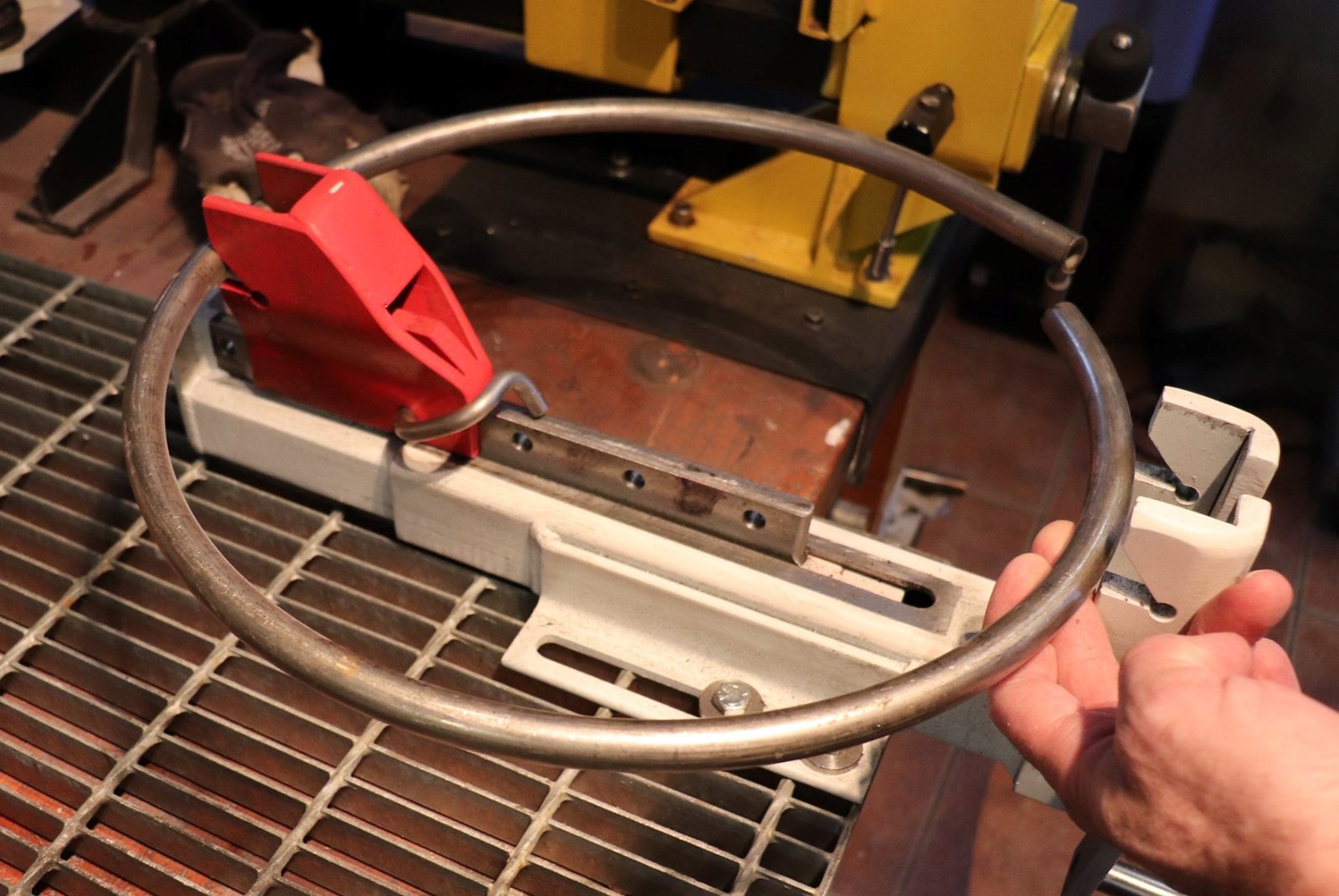

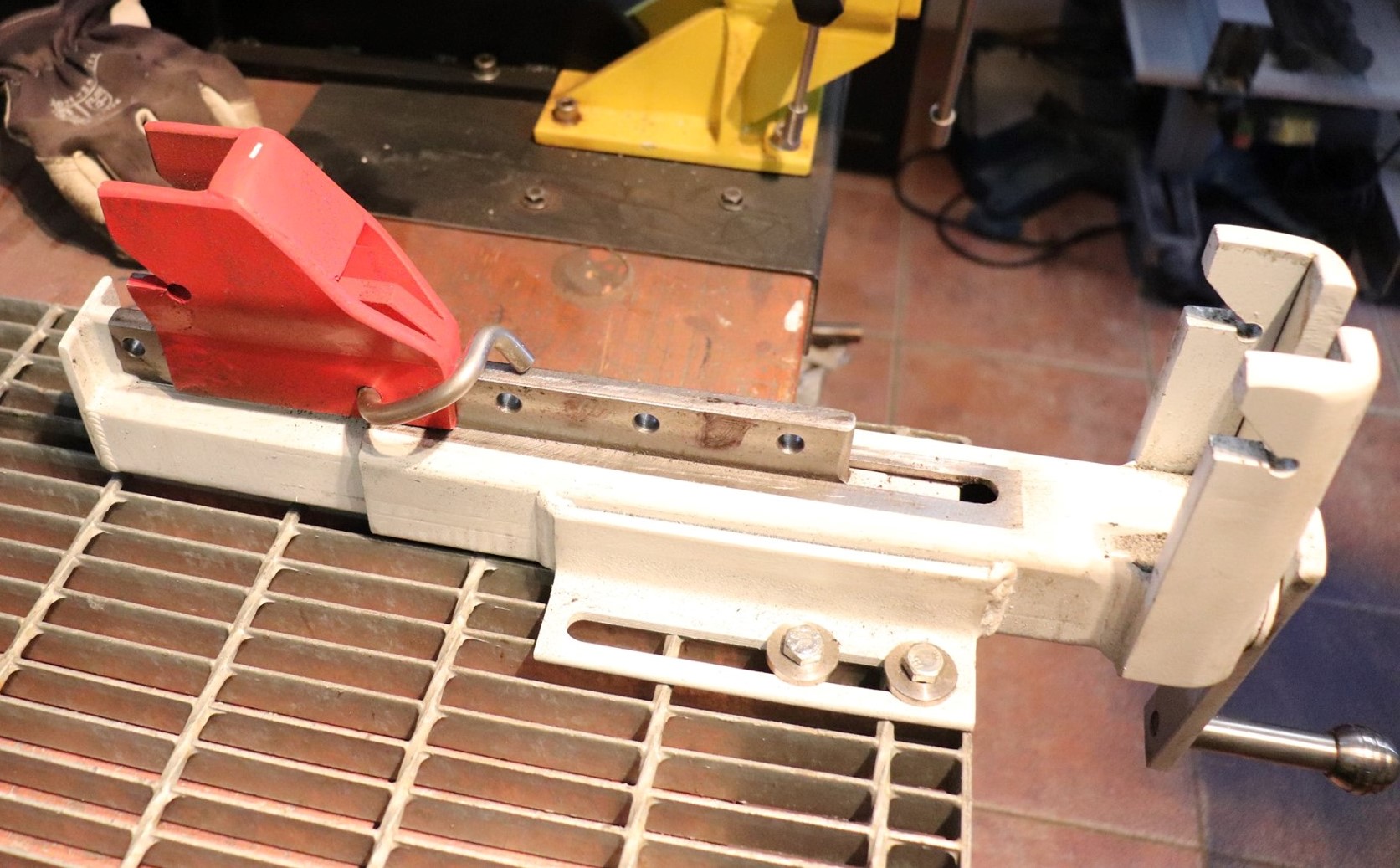

    Also, Red jaw can be turned 180 degrees, and clamp can be used for pulling / spreading too.
    Cutting bench / vise / clamp-4.jpg
    Example, for rounding elliptical pieces etc.
    Cutting bench / vise / clamp-5.jpg
    For this purpose i will make " L shaped hook ", that will be bolted to that front jaw.
    So, there is the whole idea.
    Thanks for checking it.
