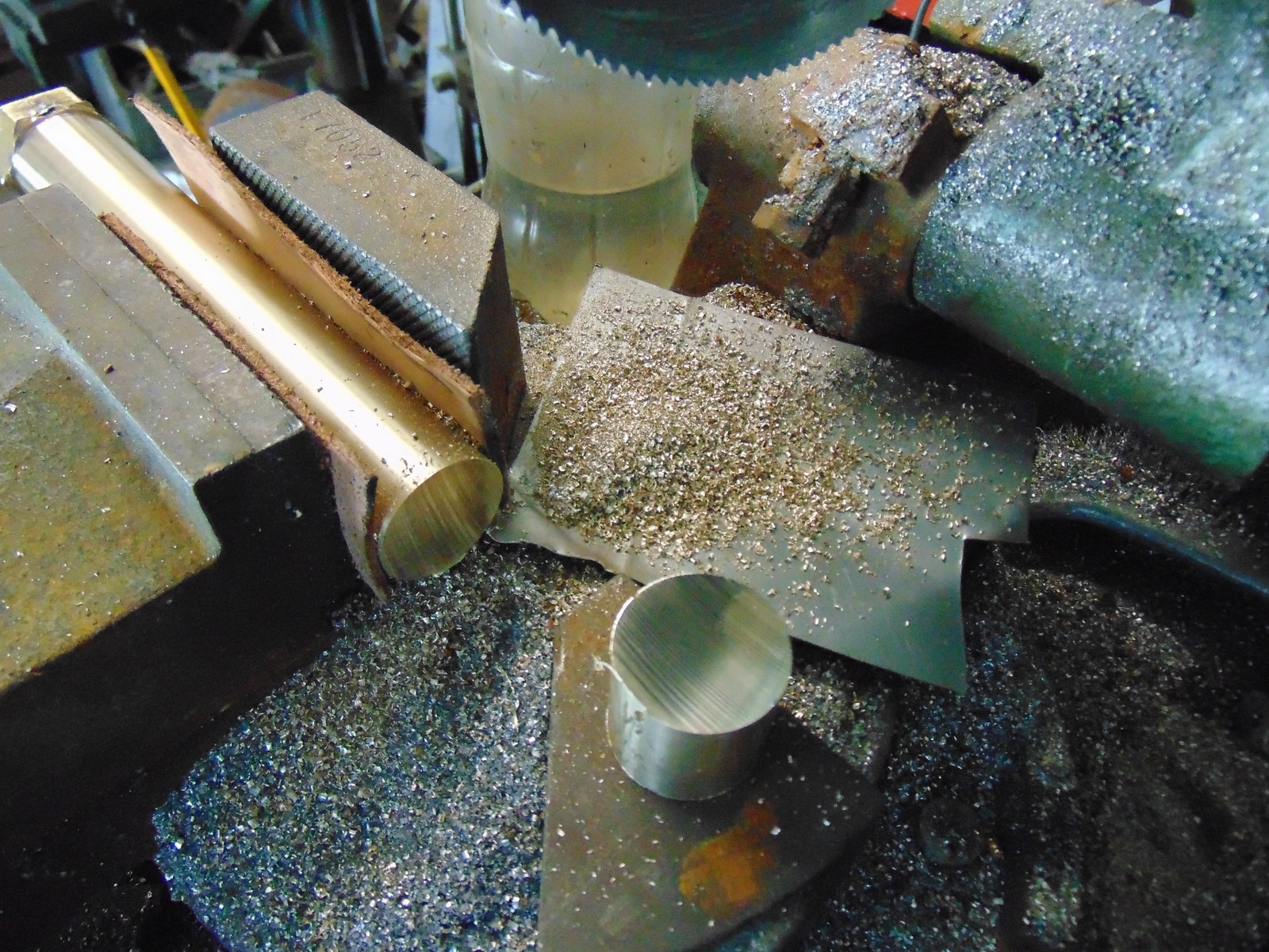

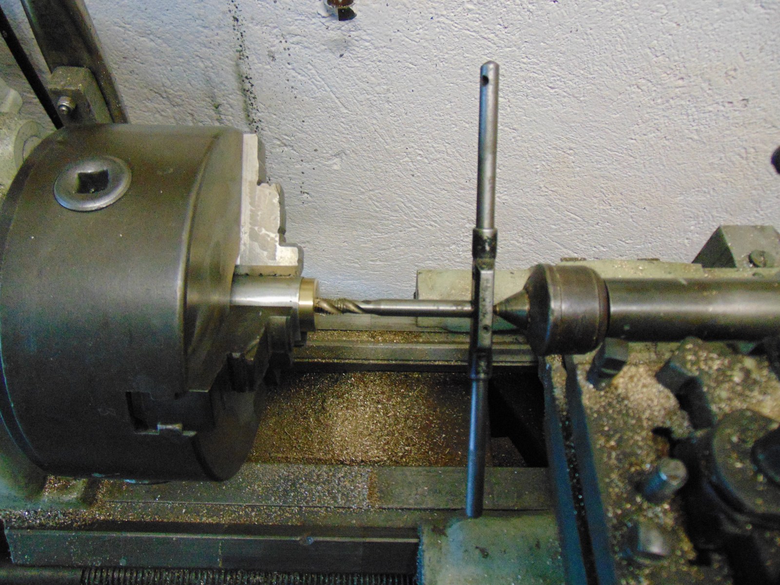

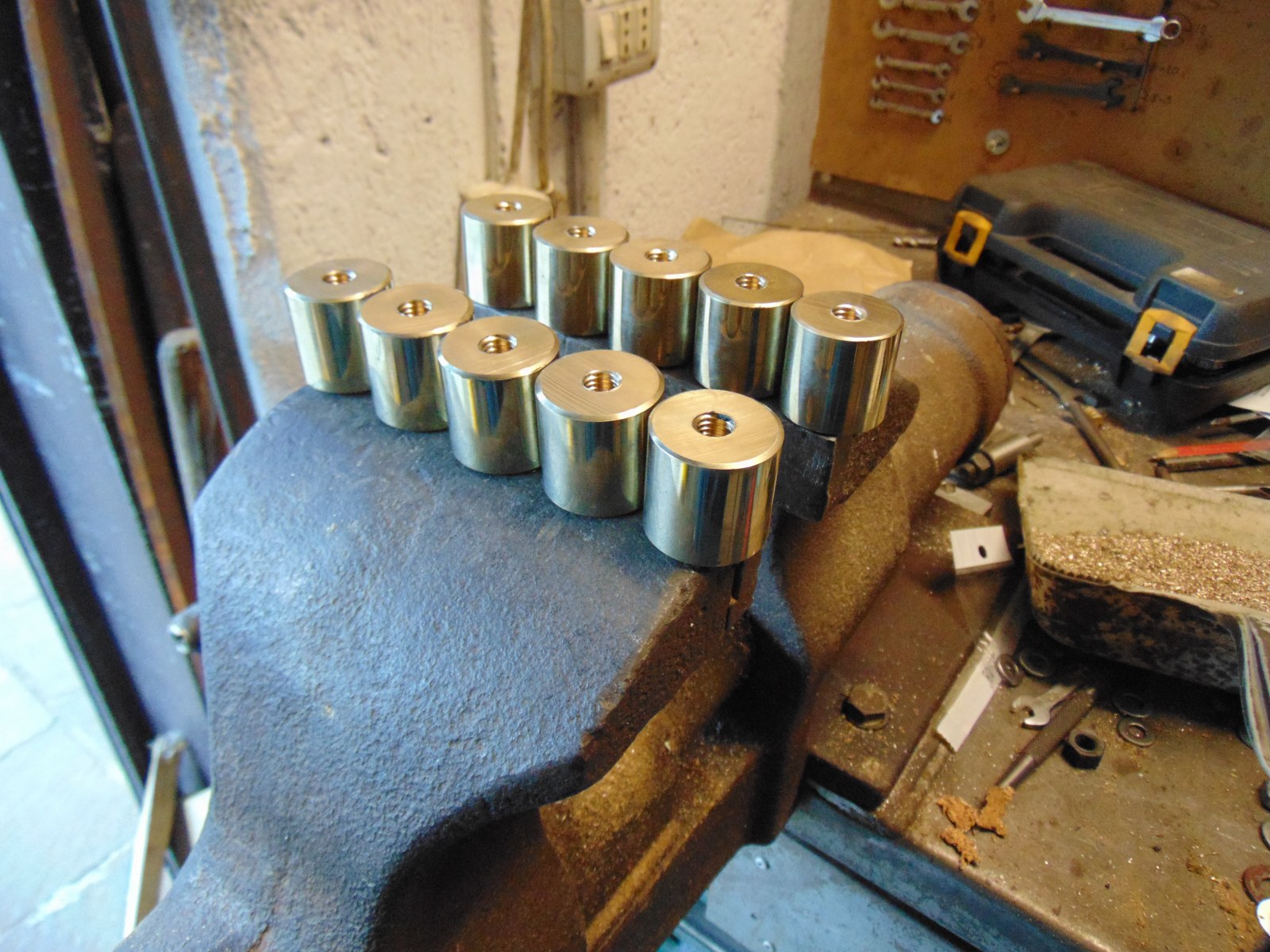

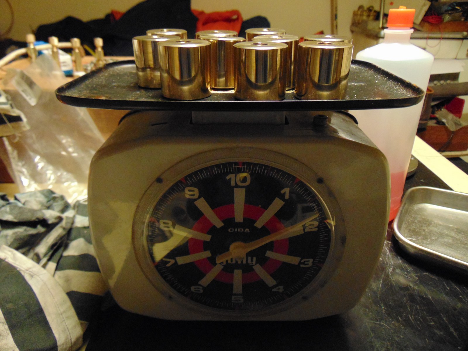

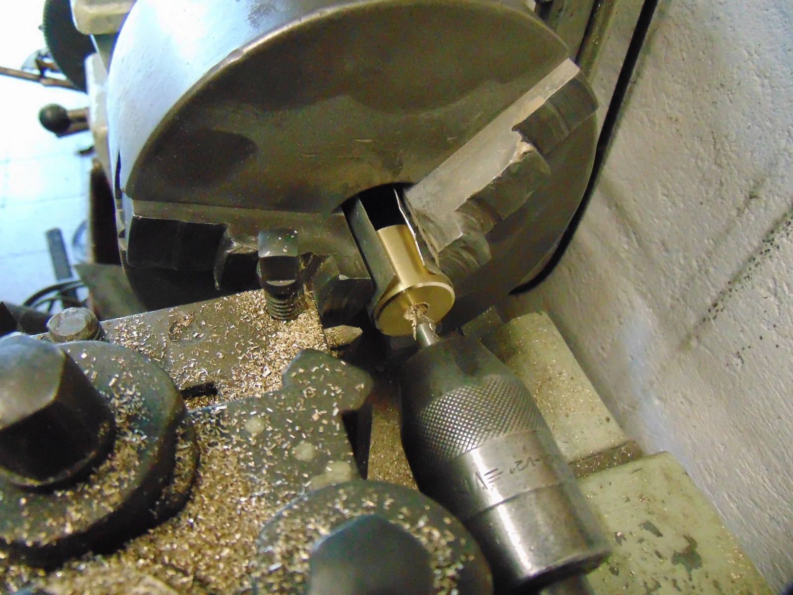

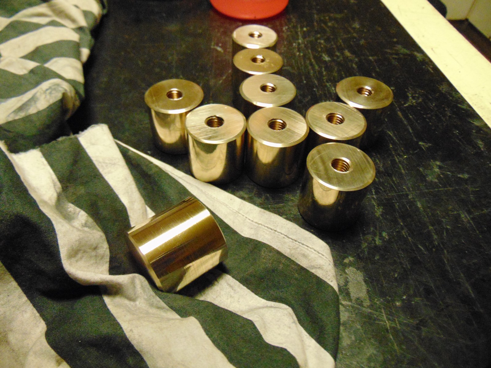

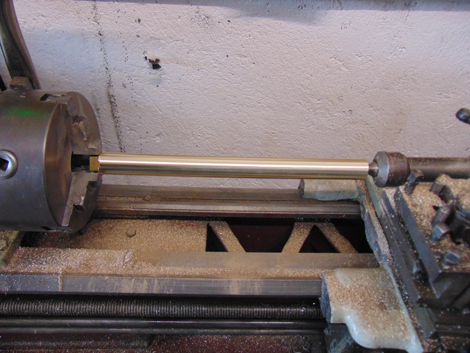

    Hi all!
    Just finished ten feet for my new speaker project. Considering material and shape, they are clearly overkill for my purpose, perfect for heavy load.
    Solid brass, 30mm, M10, beveled and polished. 175 grams each one.
    I leaved the surfaces rough to glue paloma cork in order to decouple.
    Custom brass feet - heavy load-dsc05395_1600x1200.jpg Custom brass feet - heavy load-dsc05403_1600x1200.jpg Custom brass feet - heavy load-dsc05405_1600x1200.jpg
    Custom brass feet - heavy load-dsc05384_1600x1200.jpg Custom brass feet - heavy load-dsc05385_1600x1200.jpg Custom brass feet - heavy load-dsc05387_1600x1200.jpg
