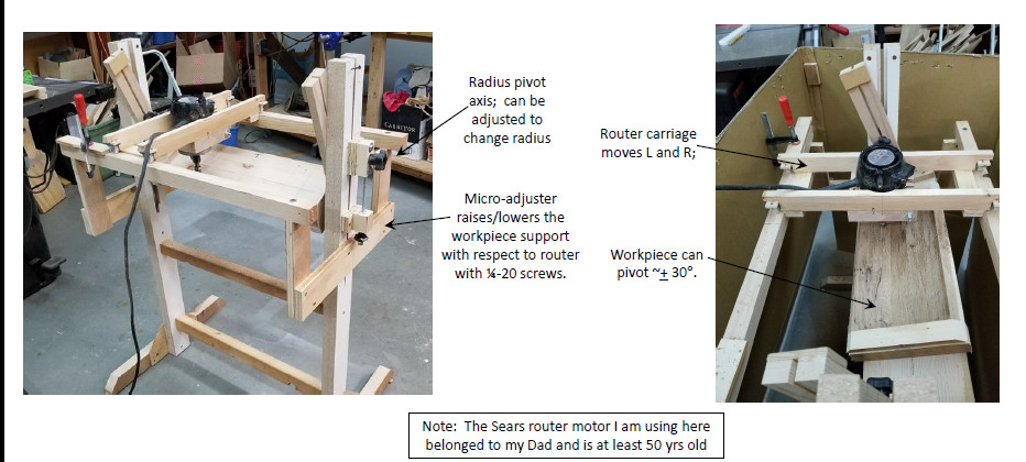

    I wanted a fixture where I could adjust the radius of curvature and more easily adjust the height of my router.

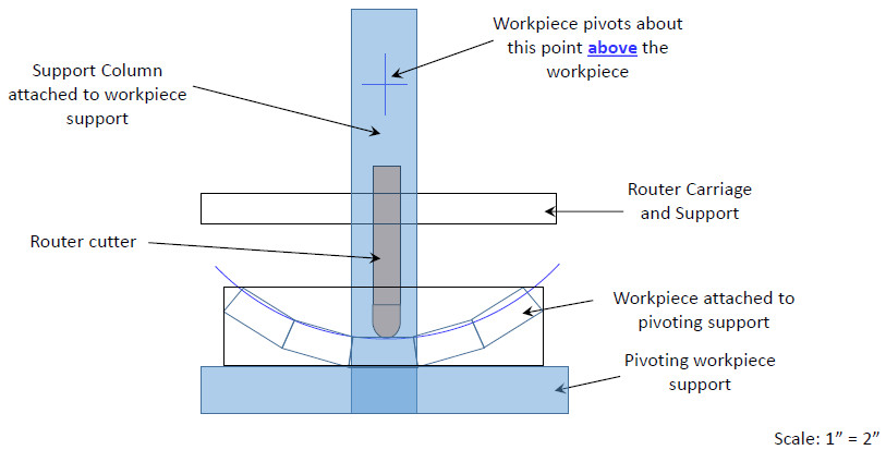

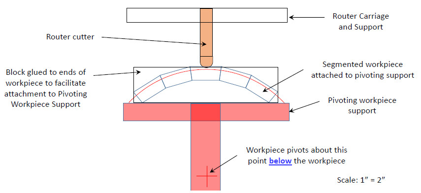

    I envisioned the scheme shown below

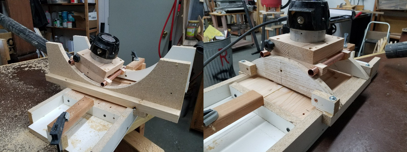

    Curved box tops with concave/convex router jig-pic2.jpg
    Curved box tops with concave/convex router jig-pic3.jpg

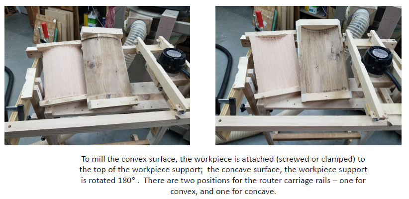

    The inspiration for this came postings I've seen form lutheriers for making guitar of other stringed instruments. The jig has a router carriage that allows the router to move back and forth (or left and right). The workpiece is screwed or clamped to a pivoting support that can swing about +30 with the router carriage in place. The same fixture is used for both concave and convex surfaces; the workpiece is mounted on the “top” of the pivoting support for convex surfaces, and on the bottom for concave surfaces. Similarly, the router carriage rails need to be moved from the “high” position for milling convex surfaces to the “low” position for milling concave surfaces. A ¼-20" micro adjuster on each end of the pivoting support allows for small increments to be milled on each pass.

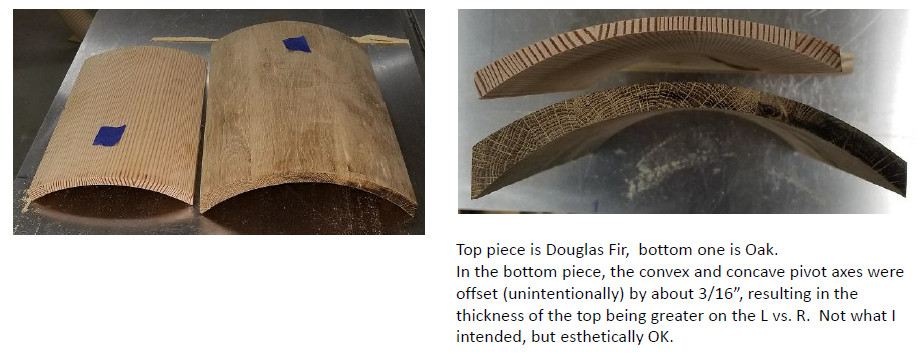

    Curved box tops with concave/convex router jig-pic4.jpg
    I am still learning to use this jig, but it seems to work well for the pine, Douglas Fir, and red oak that I have milled so far.

    I wonder about warping. Do the segments join alternate ends [or opposite faces] to counteract it?
