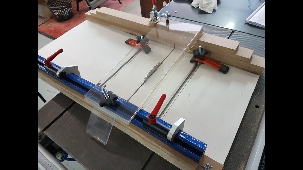

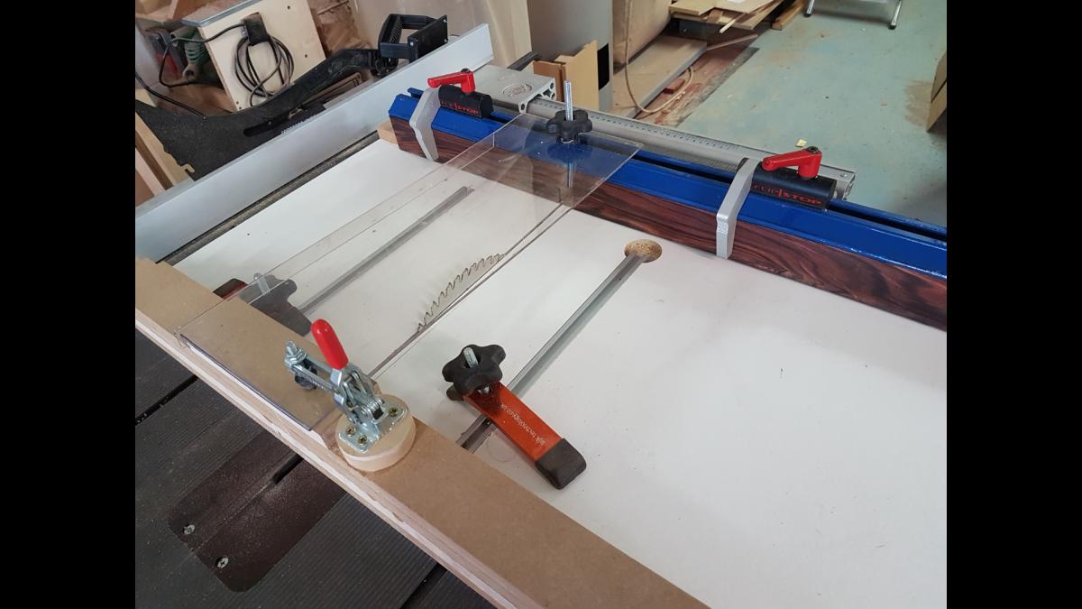

    Here is a new crosscut sled I made for my table saw constructed from melamine-faced particle board, MDF and hardwood.
    There are double flip-stops on the fence and perspex safety guards.
    Removable, sliding hold-downs complete the accessories.
    A plastic sleeved bolt tightened into the t-slots of the saw table at the appropriate spot ensures that the sled
    stops at the correct position.
    I have put a comprehensive post detailing the calibration of the fence on my blog, which may be of interest to those unfamiliar
    with how to do this. I cover the 5th cut method and the dial indicator method in that post.
    The fence itself is constructed from a build-up of MDF pieces glued together. I chose MDF for its stability. I then fitted a hardwood face to the fence to ensure a good registration surface.

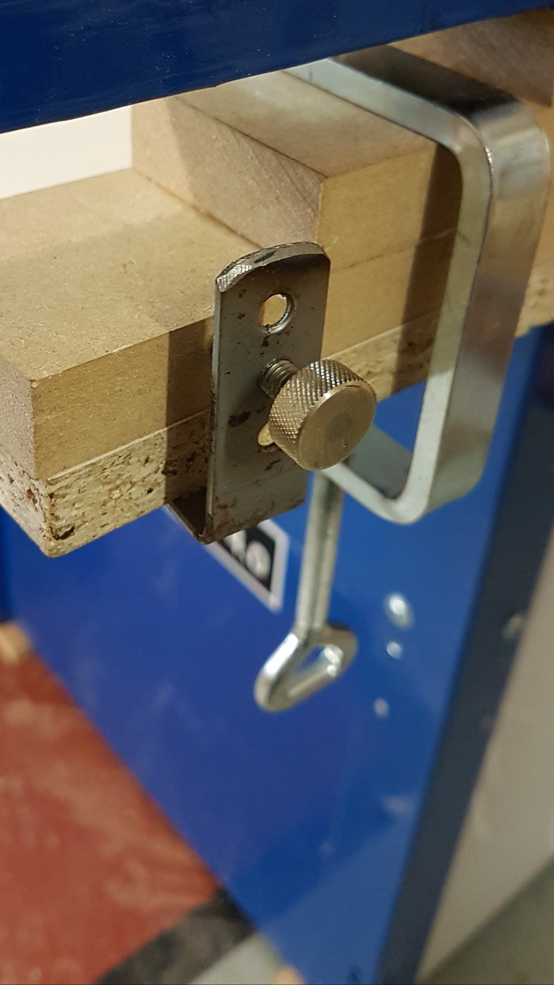

    One end of the fence is fixed with a bolted pivot which enabled the calibration to be done.
    A micro-adjuster was made and fitted at the other end of the fence, again to facilitate the calibration.
    Good calibration of the fence is imperative for square cuts to be maintained.

    Very nice build. As a beginner in this sort of build, I'd like to see or describe how to build the micro adjuster on the sled so that adjustments can be made to insure the back fence is square. I'm really not clear on how this is done. Thanks again for the great build of the cross cut sled.
