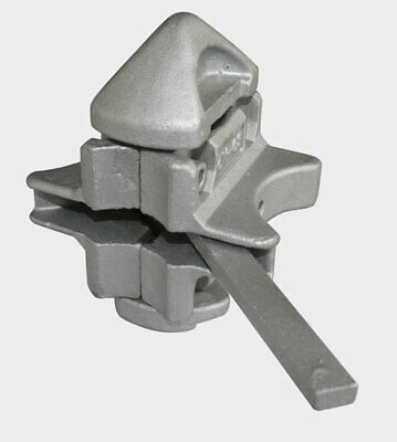

    But here is a web picture of one. The ones I like are the retractable so when they are not needed they drop down flush with the trailer floor
    This one is fixed non retractable the kind you would find on the specialty container chassis just give the lever a 90° turn the crown rotates and locks in the socket on the container

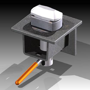

    This one is a flush mount same principle but you push it up then the stub locks in place until the container is lowered over it then rotate the lever to lock it

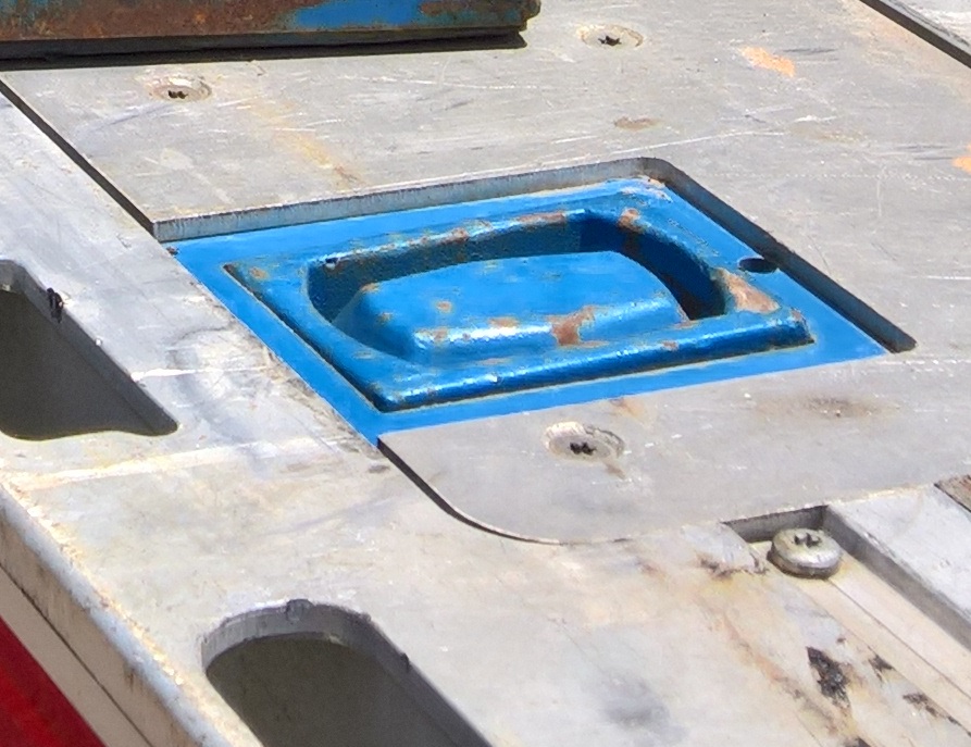

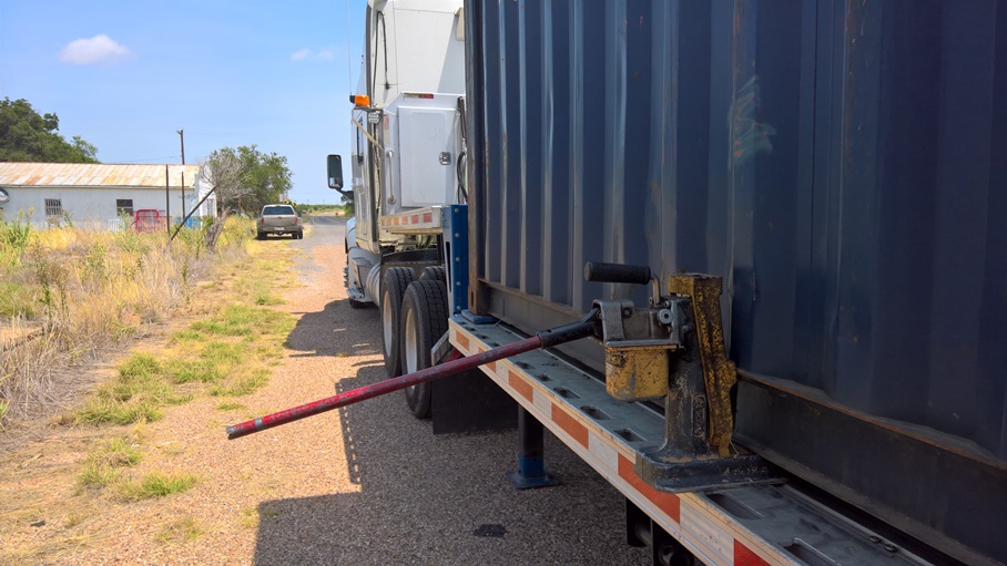

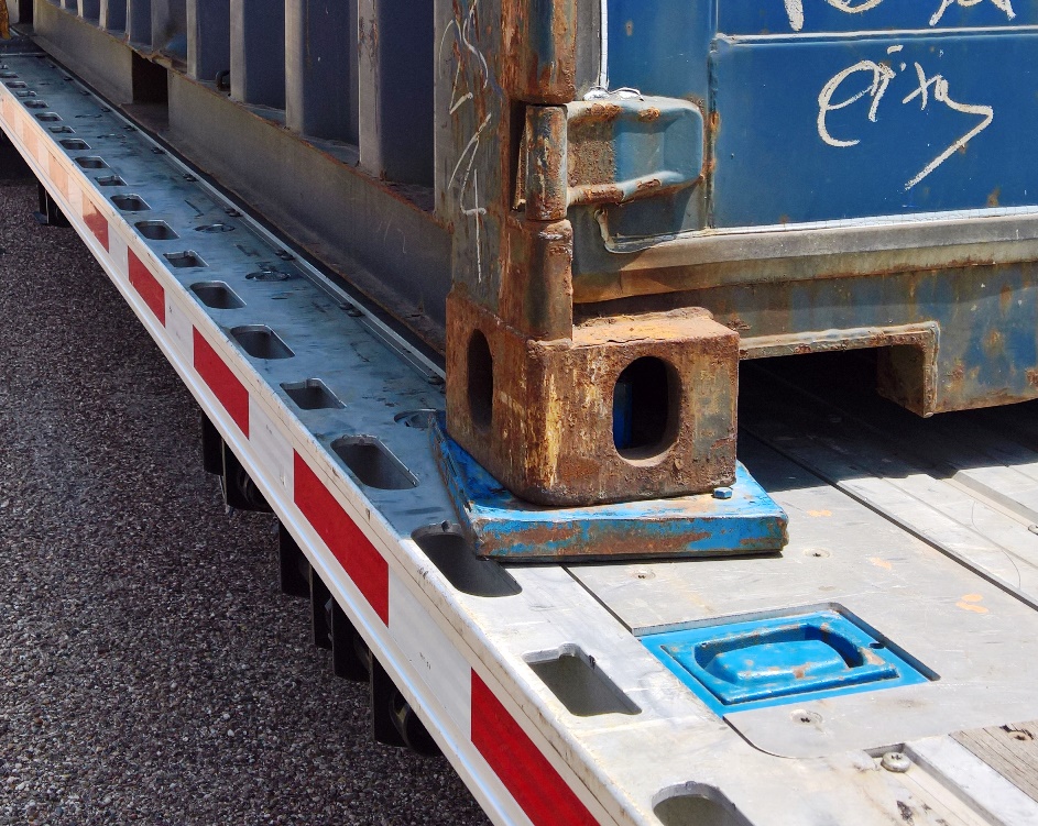

    Ok I did find a picture of a trailer we off loaded one of the containers from that had the locks but I had already jacked up the container and placed my UHMW clad slide blocks under the container.
    Crane lifts shipping container stuck to trailer - GIF-wp_20200622_12_37_52_pro23.jpg
    Crane lifts shipping container stuck to trailer - GIF-wp_20200622_12_37_59_pro122.jpg
    Crane lifts shipping container stuck to trailer - GIF-wp_20200622_12_37_52_proct123.jpg

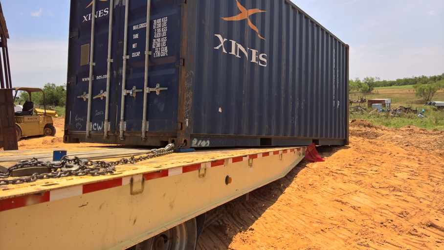

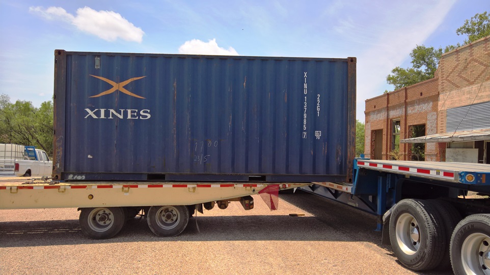

    We winched the container off sideways rotating it 90° onto our Landol trailer
    Crane lifts shipping container stuck to trailer - GIF-wp_20200622_12_54_33_pro123.jpg

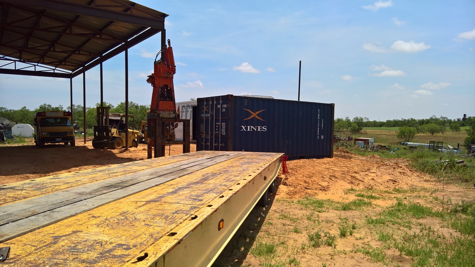

    then slid it to the ground at the corner of my shop
    Crane lifts shipping container stuck to trailer - GIF-wp_20200622_13_15_18_proct123.jpg
    Crane lifts shipping container stuck to trailer - GIF-wp_20200622_13_31_07_proct.jpg

    I too see, container pockets have potential beyond shipping environment. Frank's picture shows a toe jack, lifting the container to get slides under. Another method uses a 'hook' or lug more correctly on the backside of an angle iron. Lug engages the tiedown hole on the side corners, the flat positions a standard (but large enough) bottle jack. Underneath, those openings make a solid but temporary mount for casters.
    There is an organization in charge of shipping container specifications, with dimensioned drawings for all the features in various type containers.

    That hydraulic toe jack is just 1 of many toe jacks I have You cannot believe how many tiems it has been the go to lifting device for raising things to be moved especially containers since I can place it at one of the forklift openings lift the side or the end then place either my rollers or slide blocks under them.
