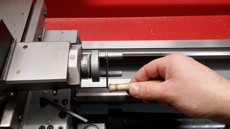

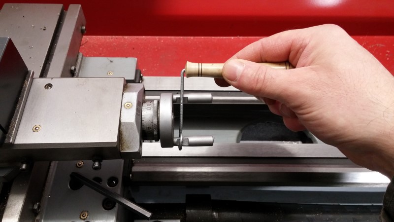

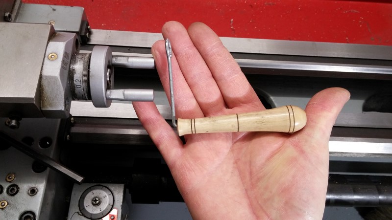

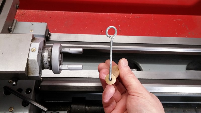

    While turning a taper with the compound silde, I was a bit fed up with this very small wheel that couldn't be turned continuously, leaving a poor finished surface.
    So I quickly did this :
    Works forward
    And backward.
    It works absolutely great, I can easily get a continuous chip all along the travel of the compound slide.
