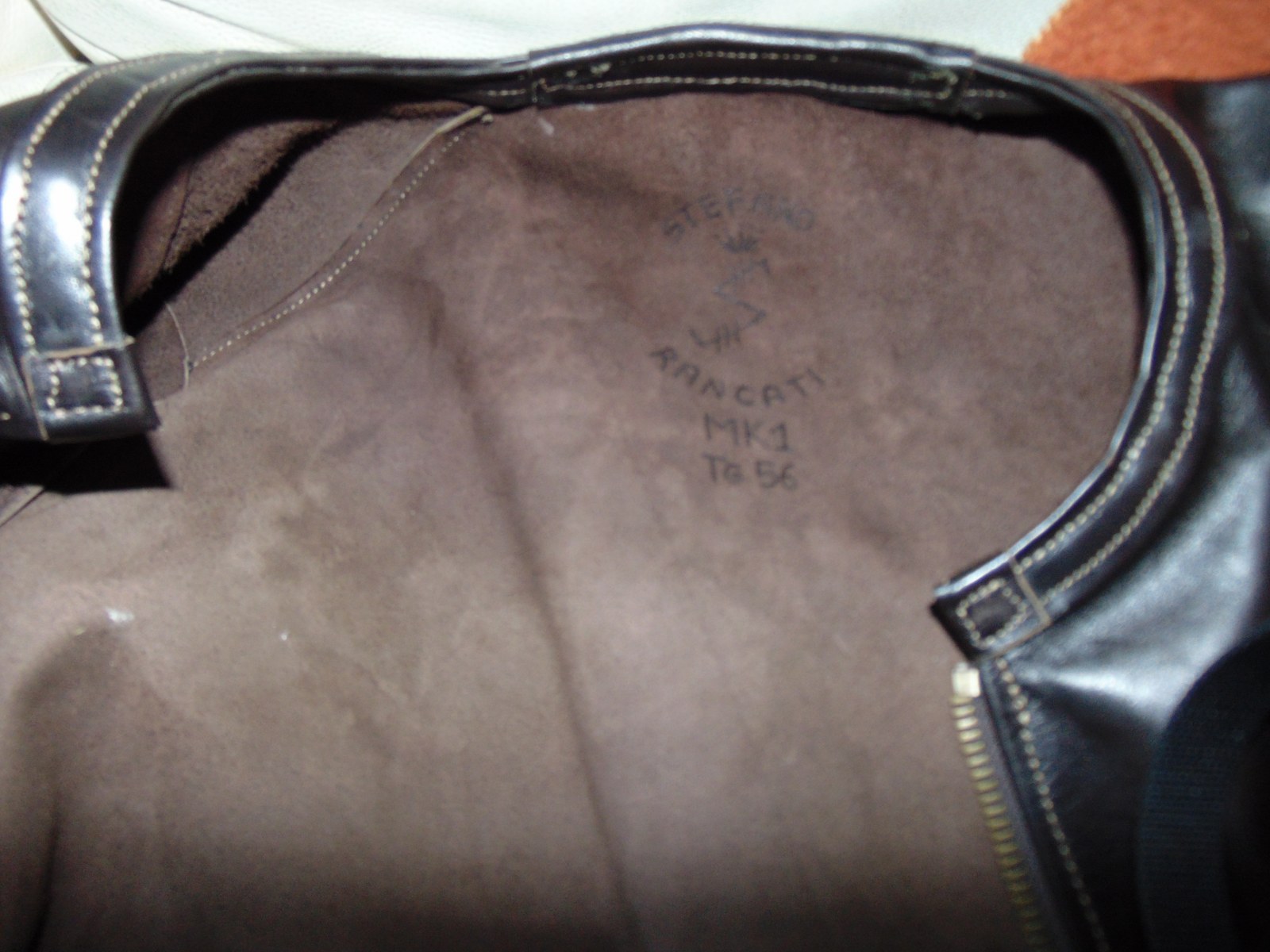

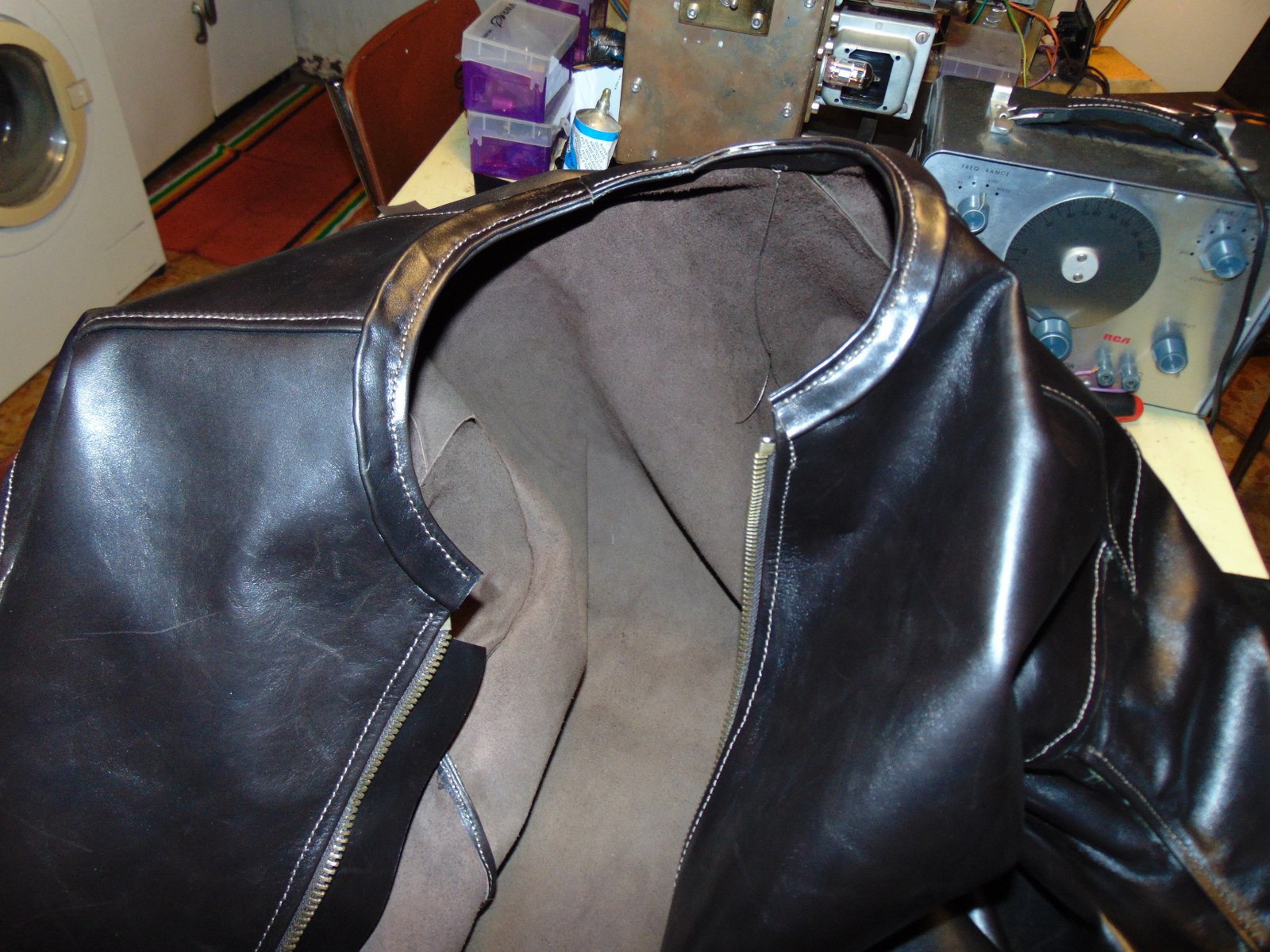

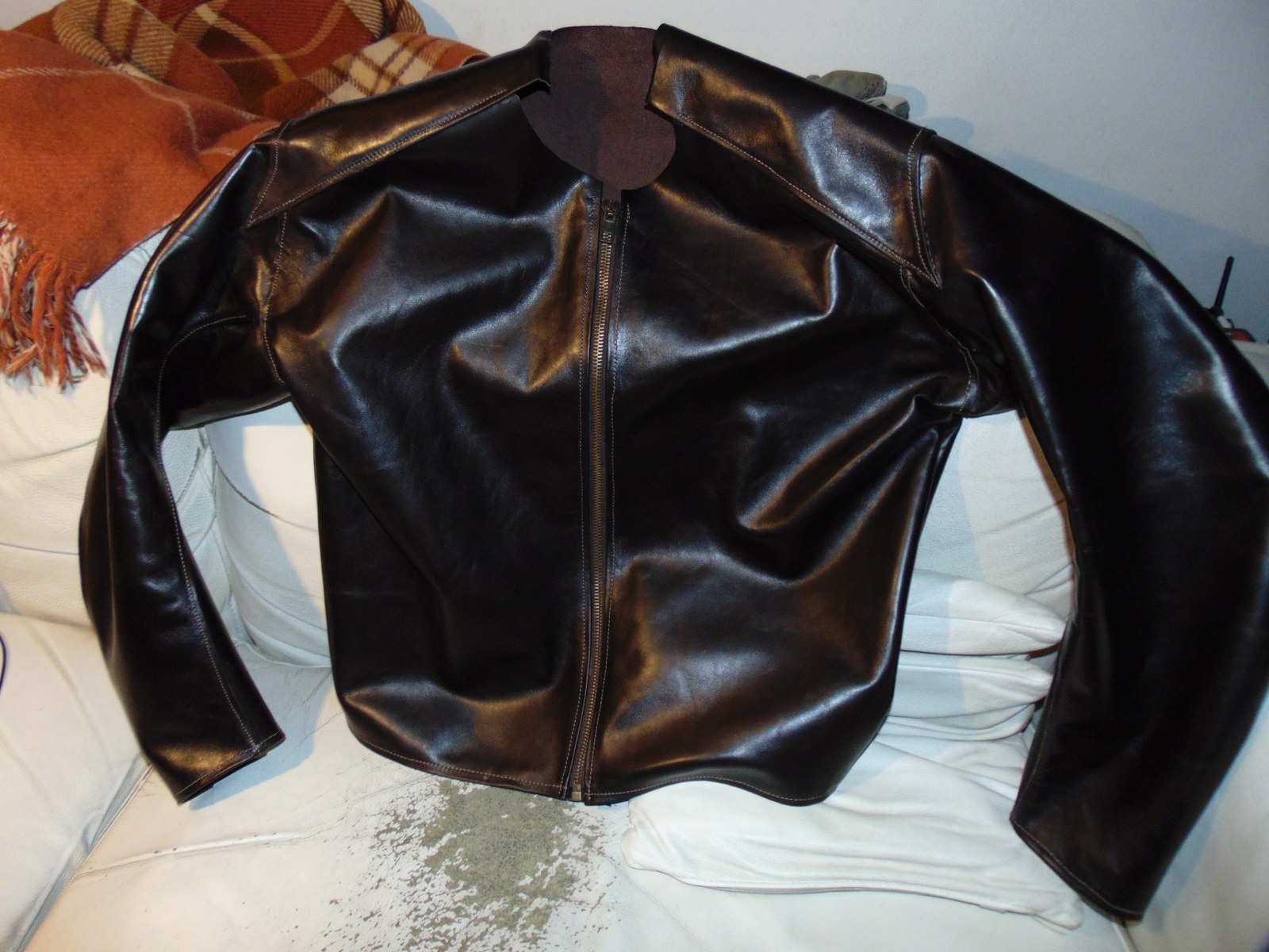

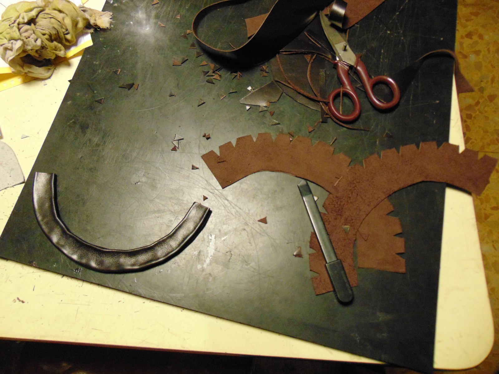

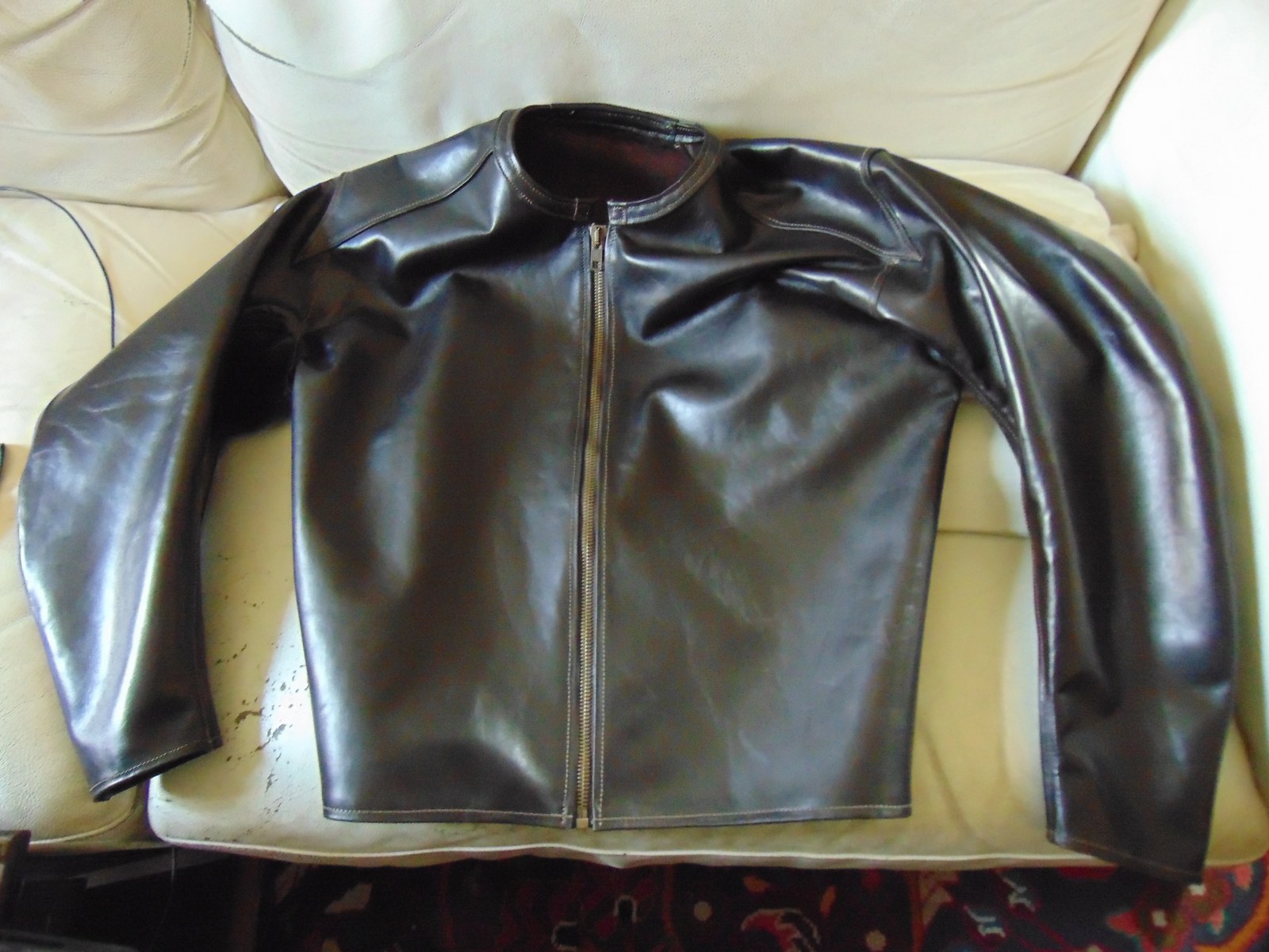

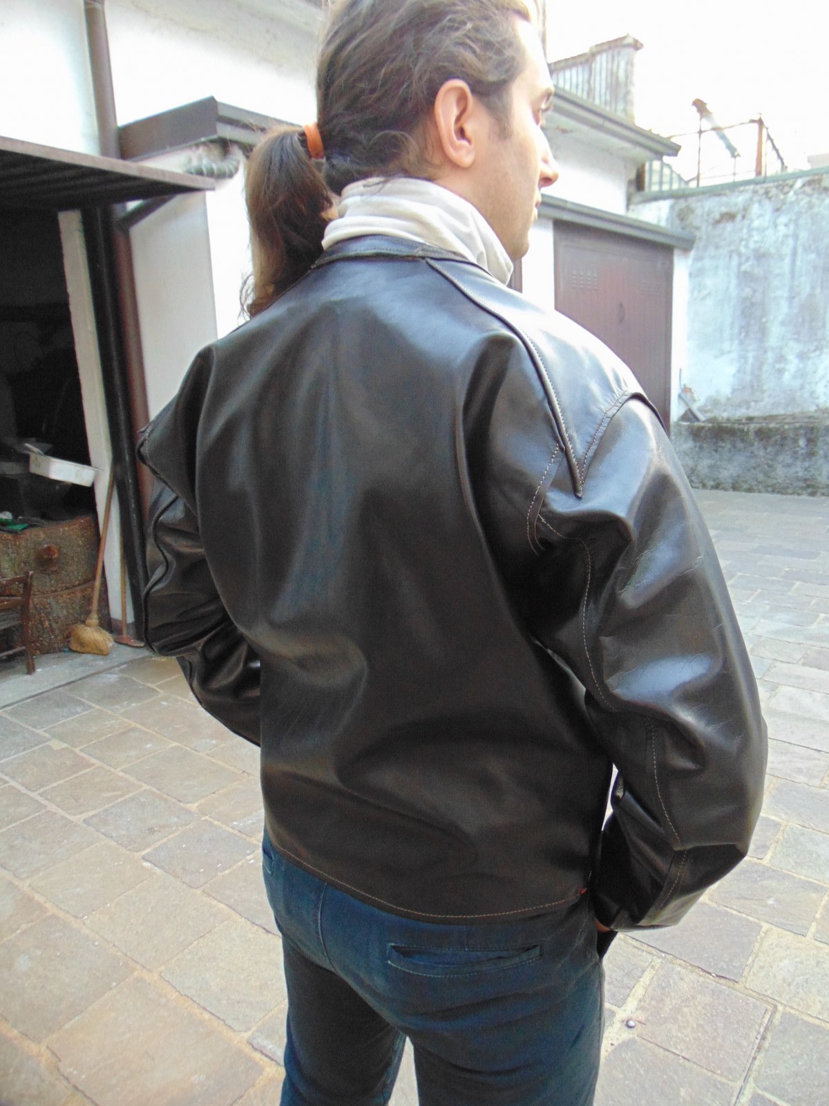

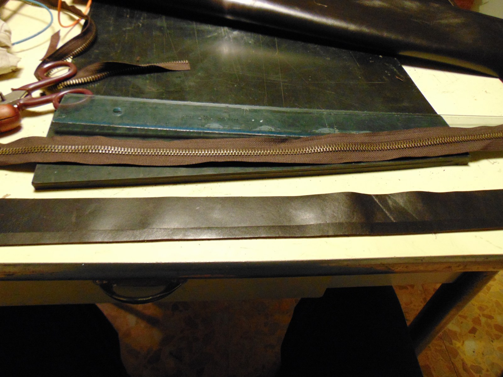

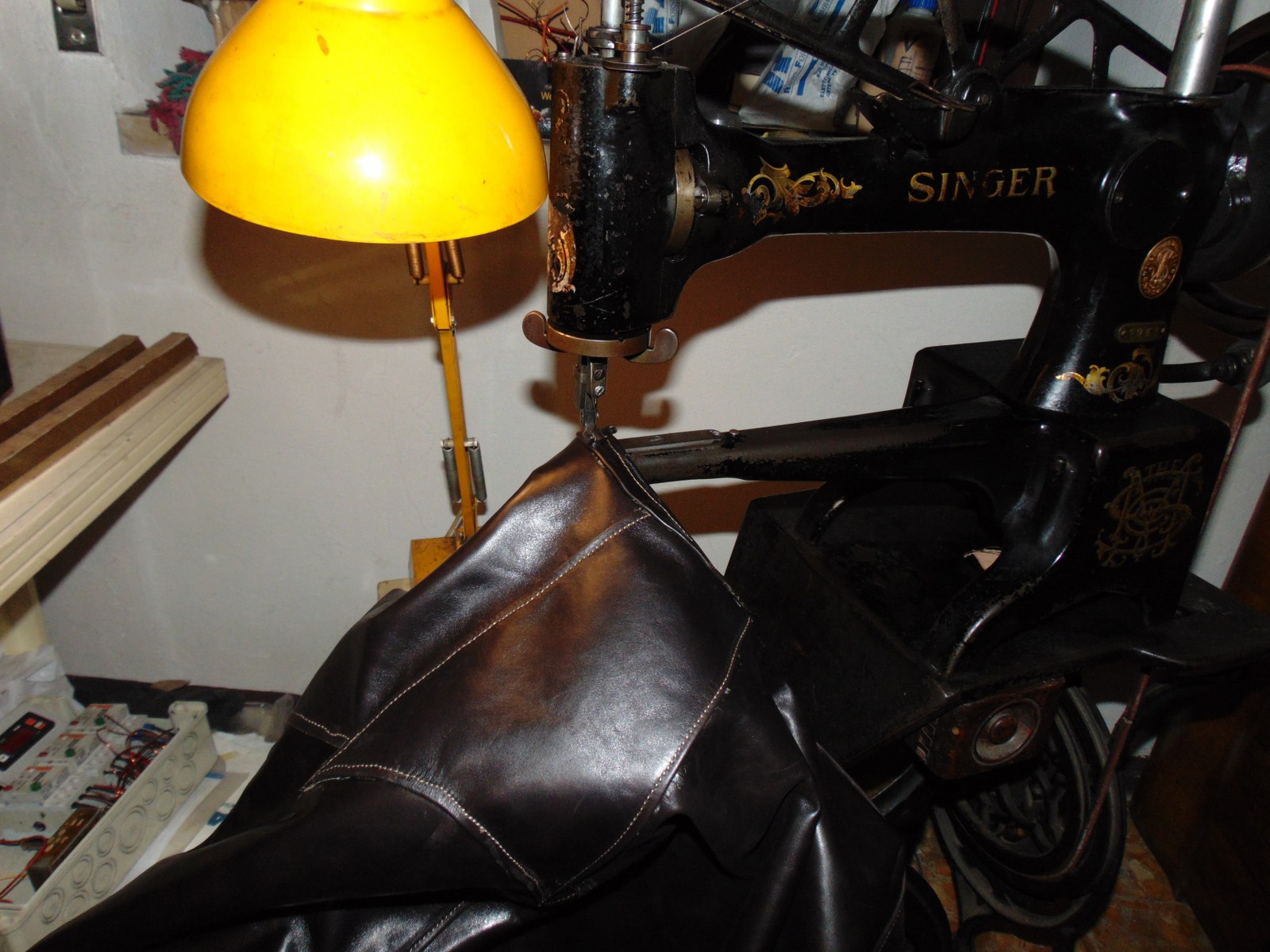

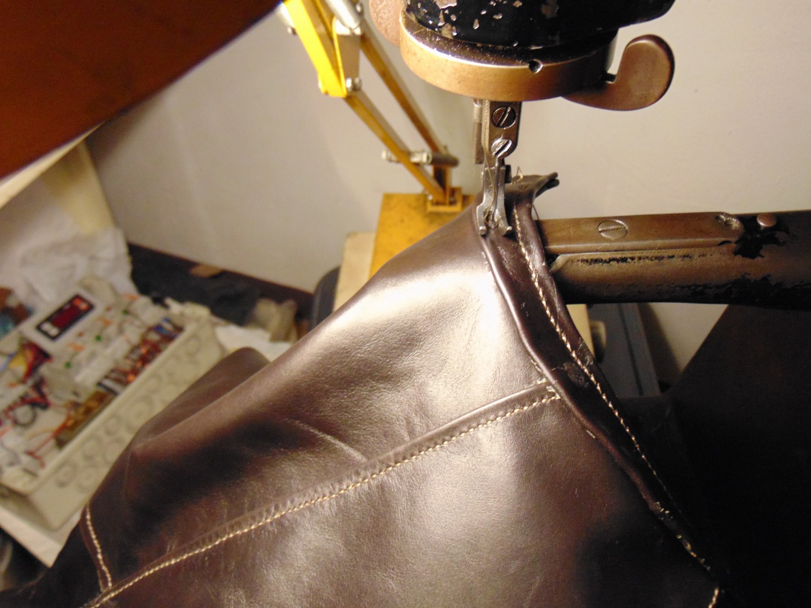

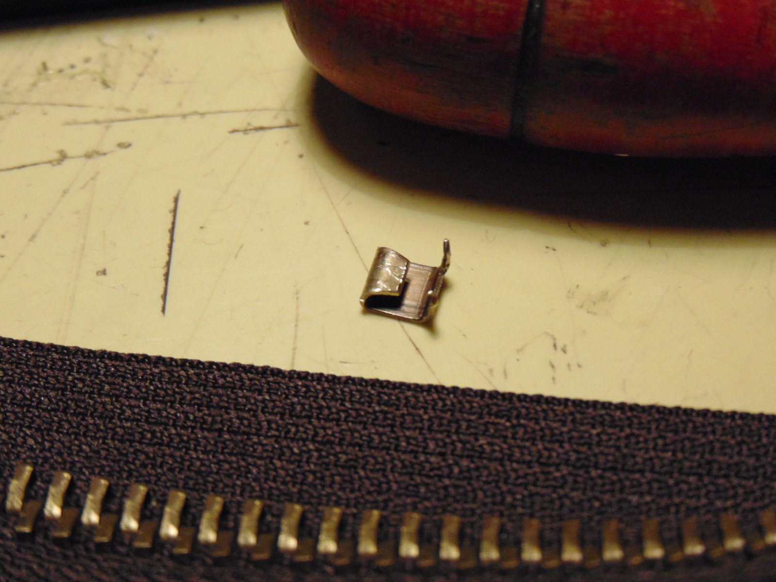

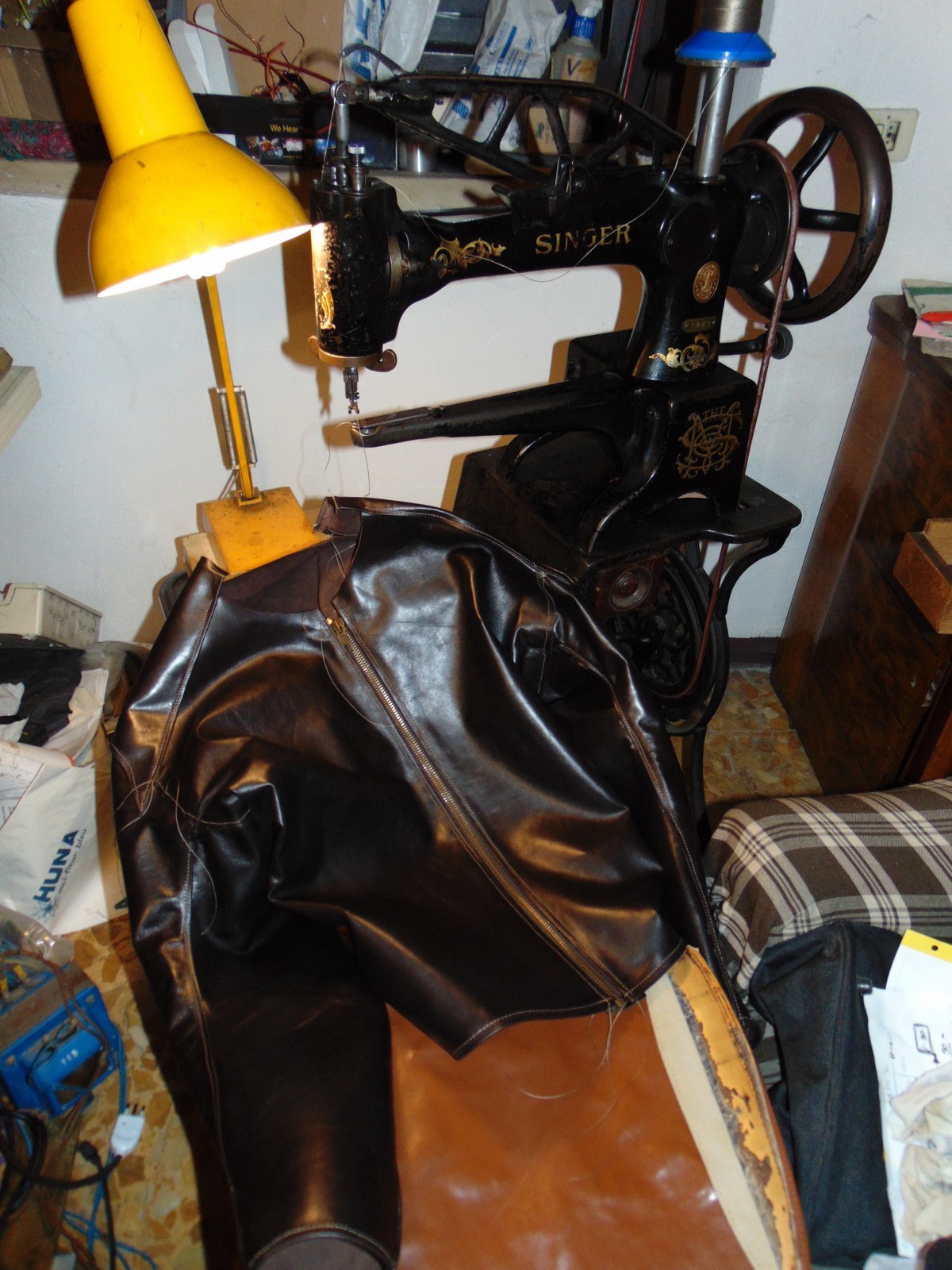

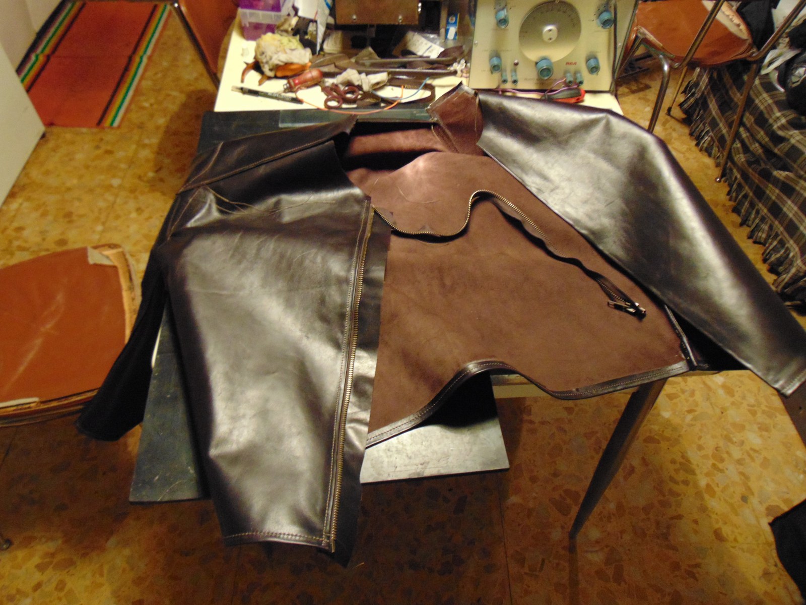

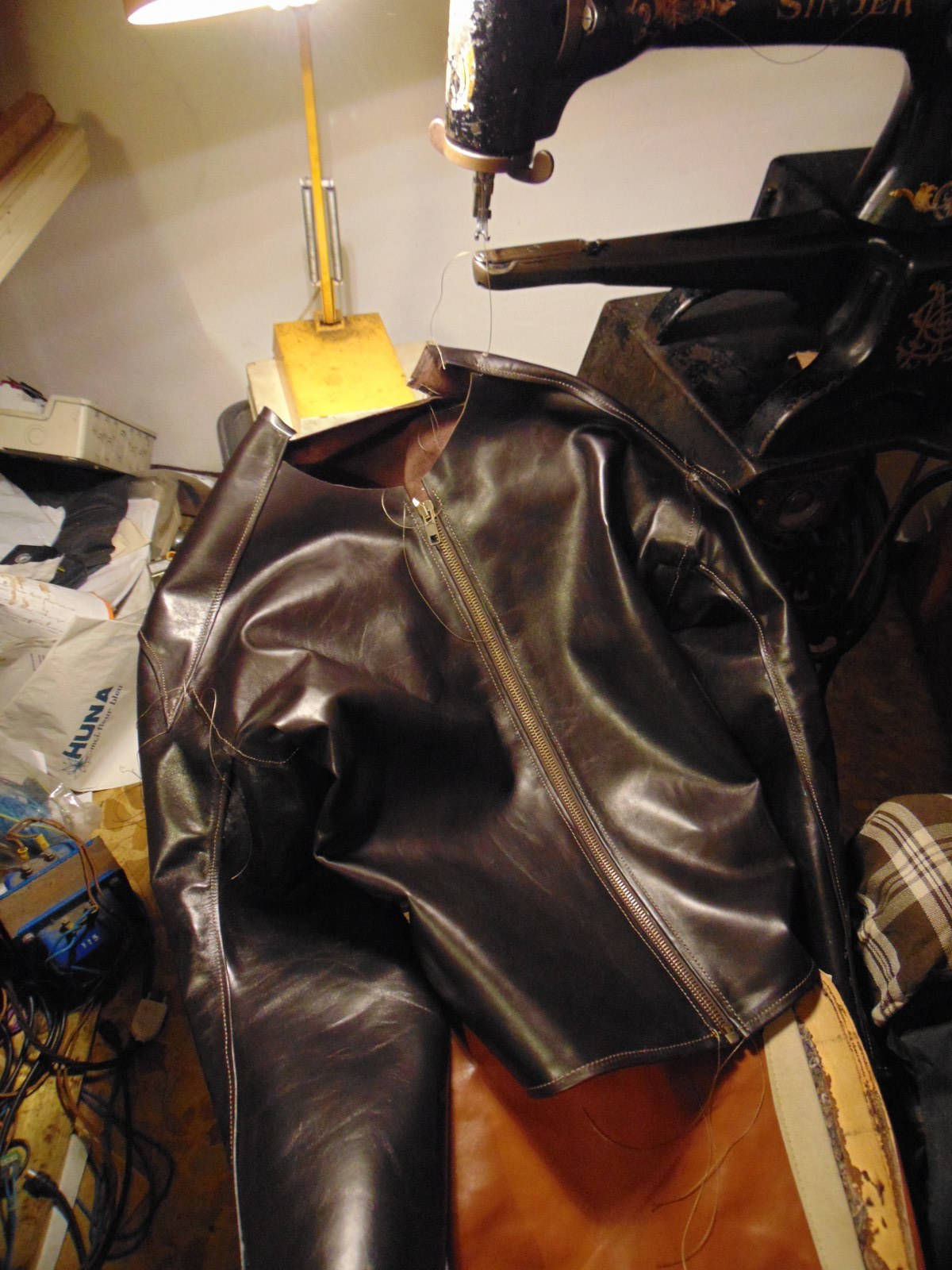

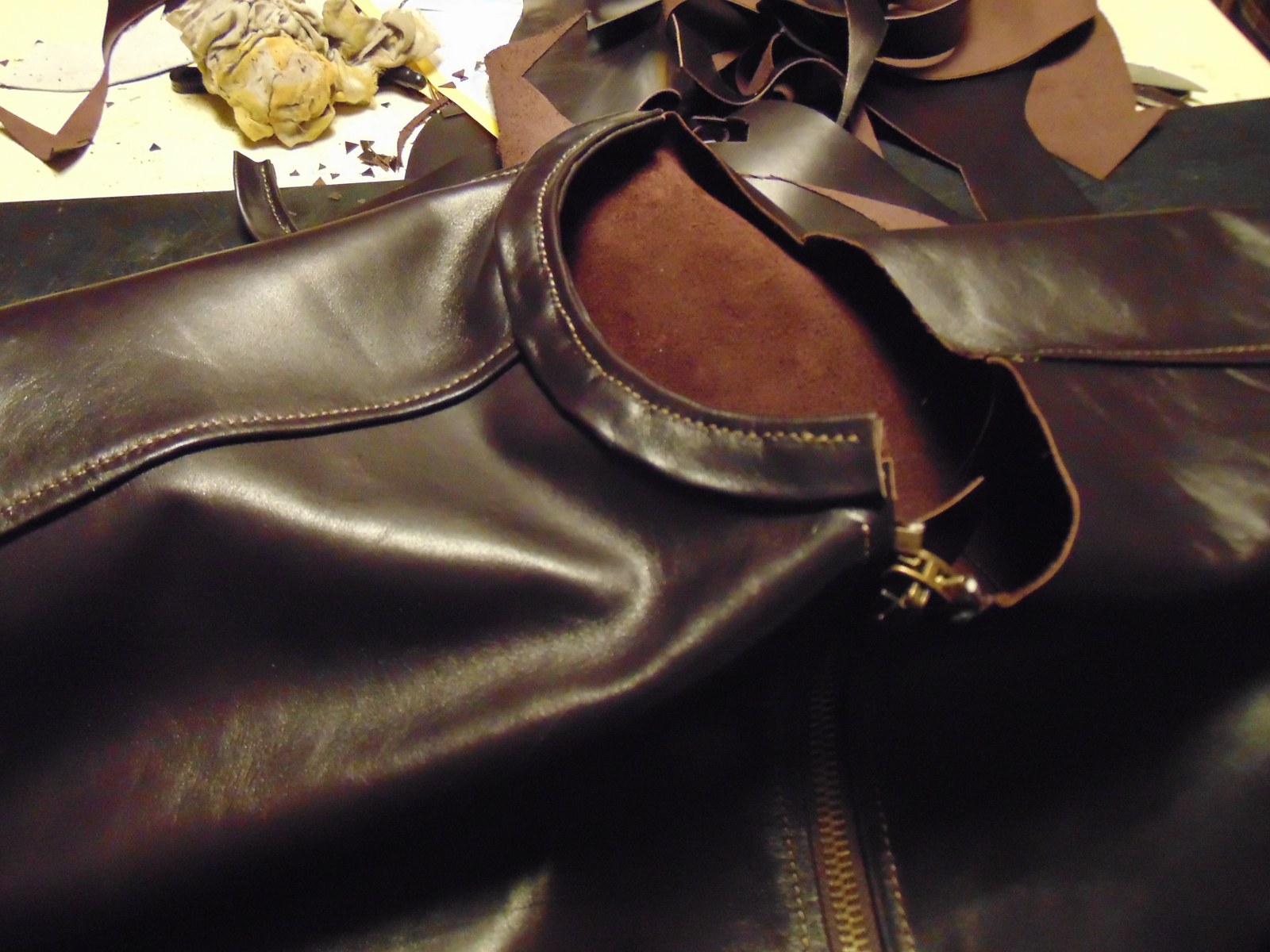

    Hi all!
    I just finished my first leather jacket!
    My goal was to build a motorcycle jacket, I have an Arlen Ness suit, pretty well made, I've been using it for 14 years every day and it's still alive . I really love traditional Vanson jacket, but here it's quite hard to find a store, and it's not good to buy online without wear it.
    I took the measurements (paper pattern) from mine, and I tried to modify the shape mixing the Vanson. I rotated the sleeves a bit more, according to my Ducati 996 riding position.
    Since my jacket is in leather of furniture ( I don't know if the translation is correct, it's the leather treated waterproof, for seats and sofas) I wanted a "real" leather for the new one.
    I chose an high quality cowhide, "testa di moro" dark brown, from a renowned italian tannery, I used nearly a whole beast, about 34 feet, with little waste and some useful scraps.

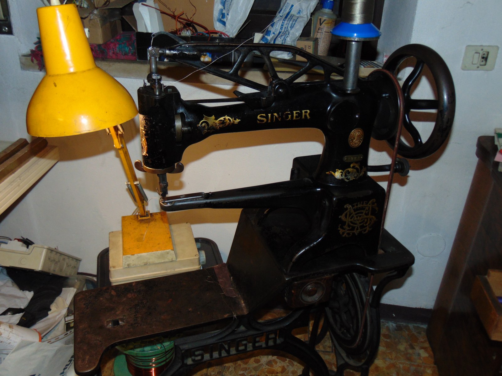

    I took about a week to complete the project, the difficult part is to create patterns, since they are not available, the leather work was funny with the old Singer 29k1. I used polyester twisted wire.

    Tool? Sure is. Beats winding up like a strawberry when you lay one down or highside. Buddy "S", [aka rendoman] you've done a fine job, unbelievable for a first try. Patterning is a job in itself, not to mention the actual sewing. Safe bet few other Ducati owners wear leathers of their own hand. As a side note, what make and model are you riding in the avatar?

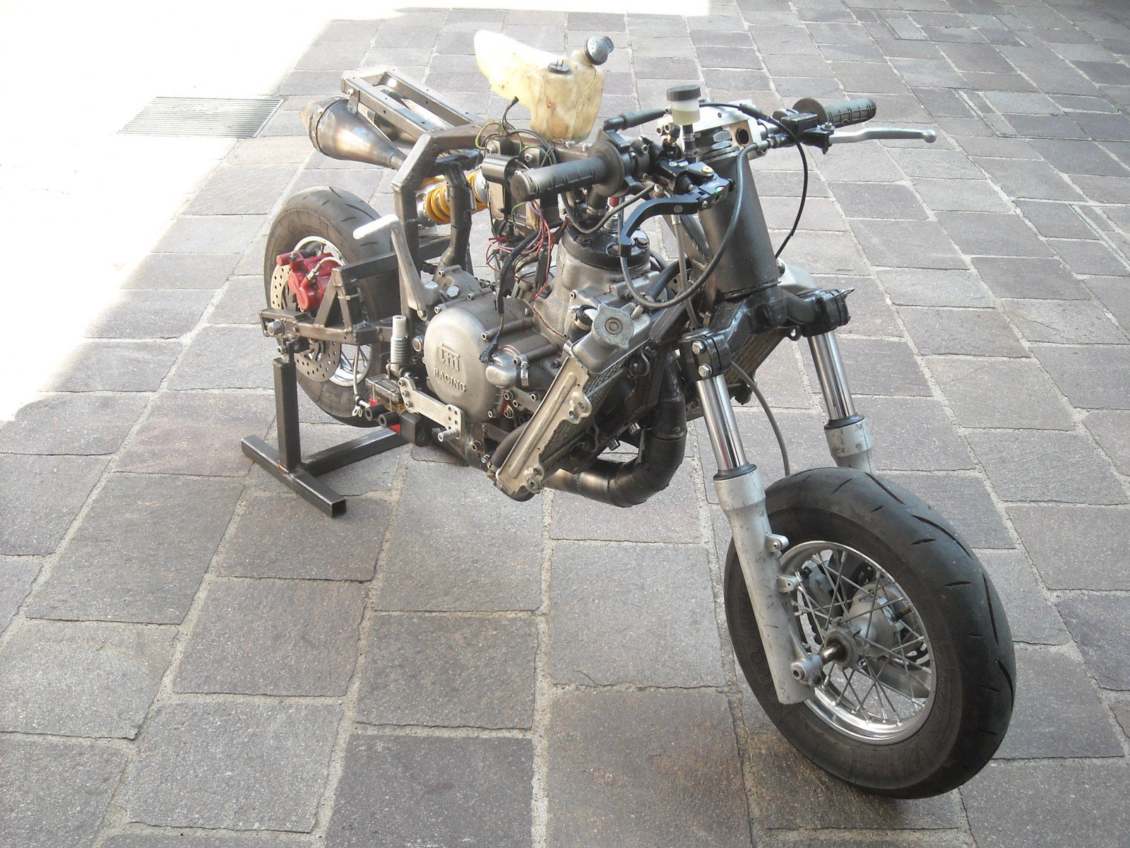

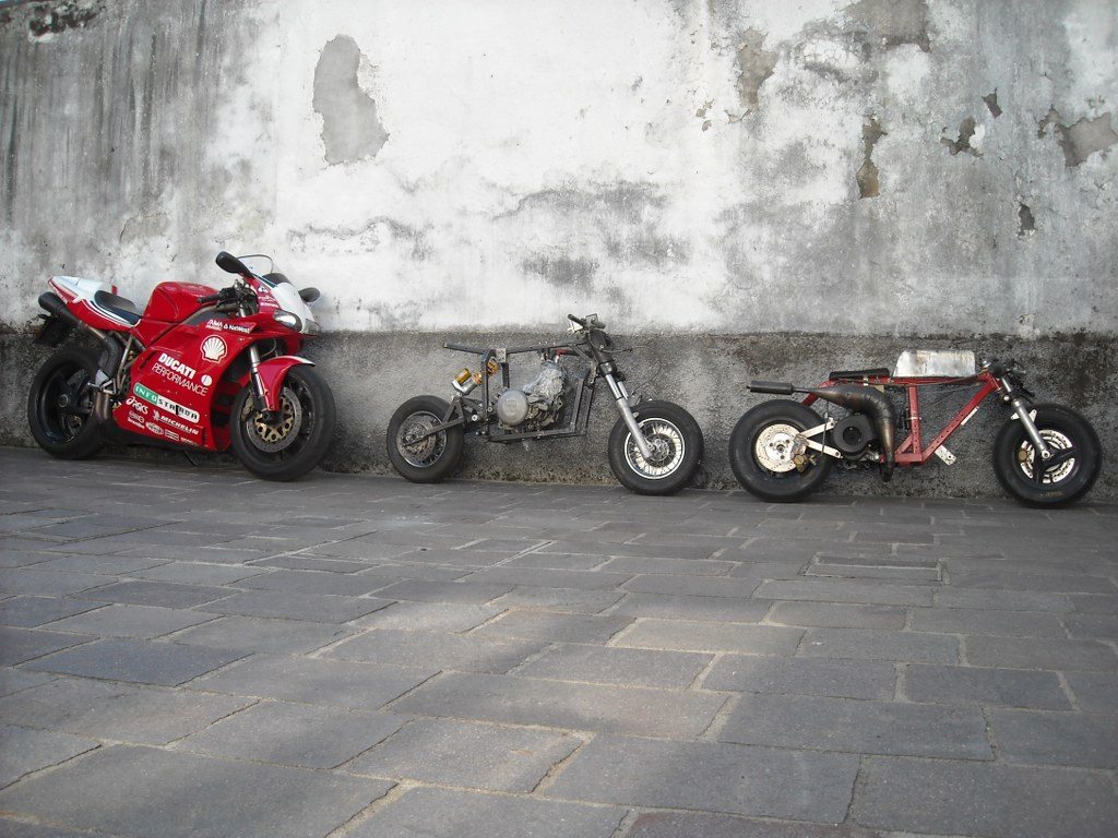

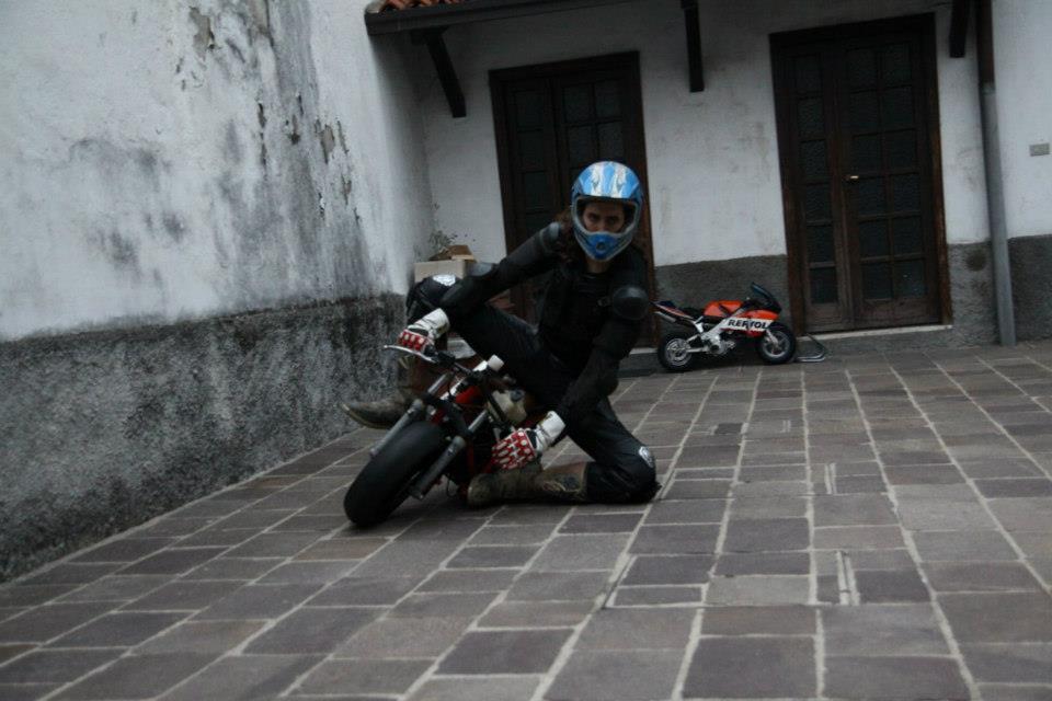

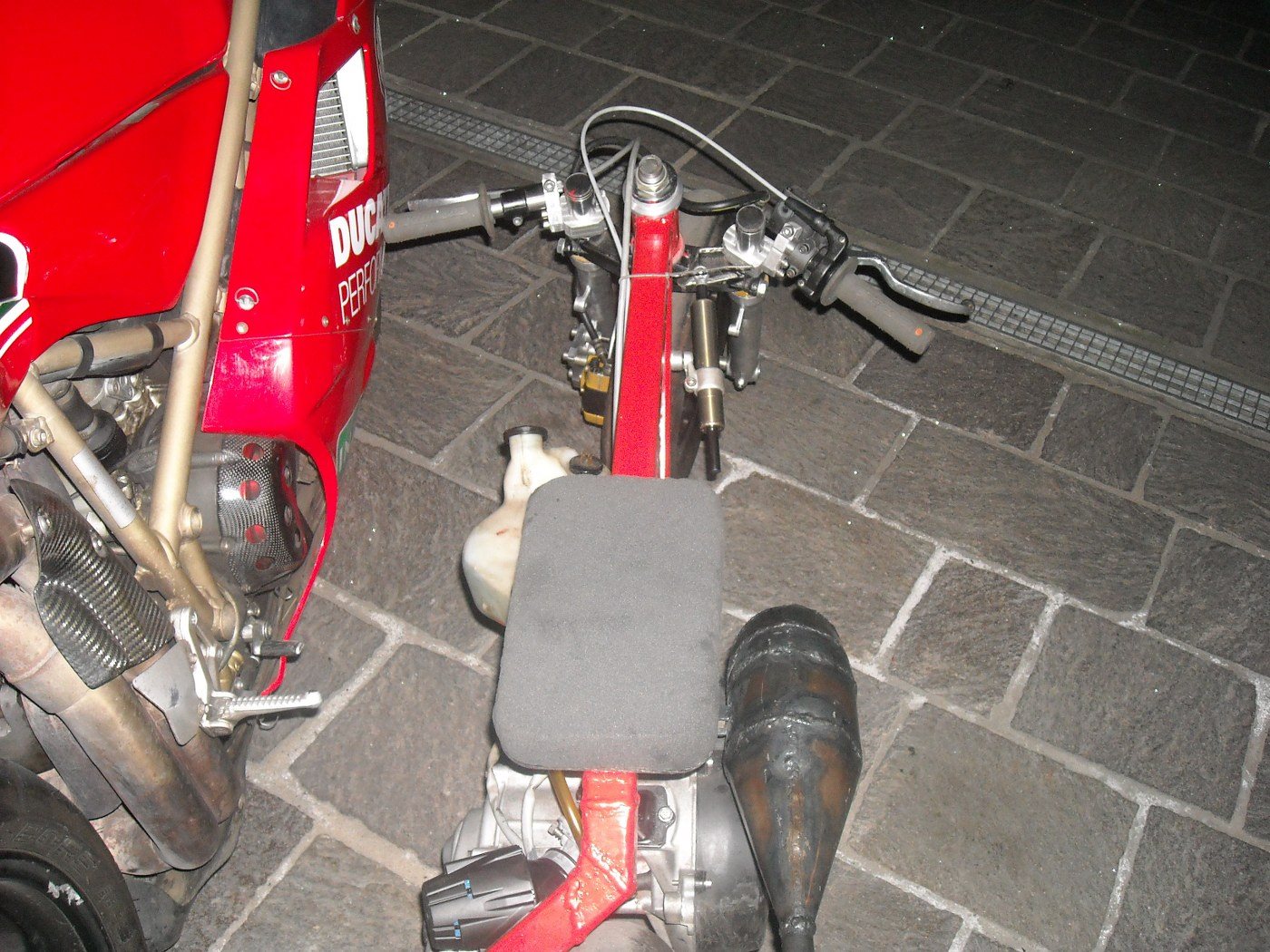

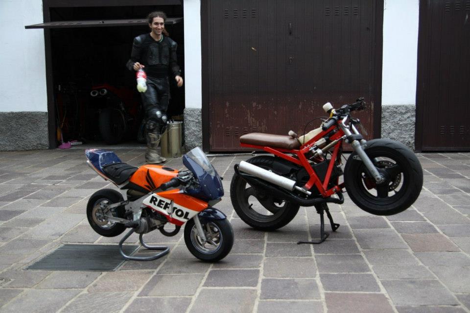

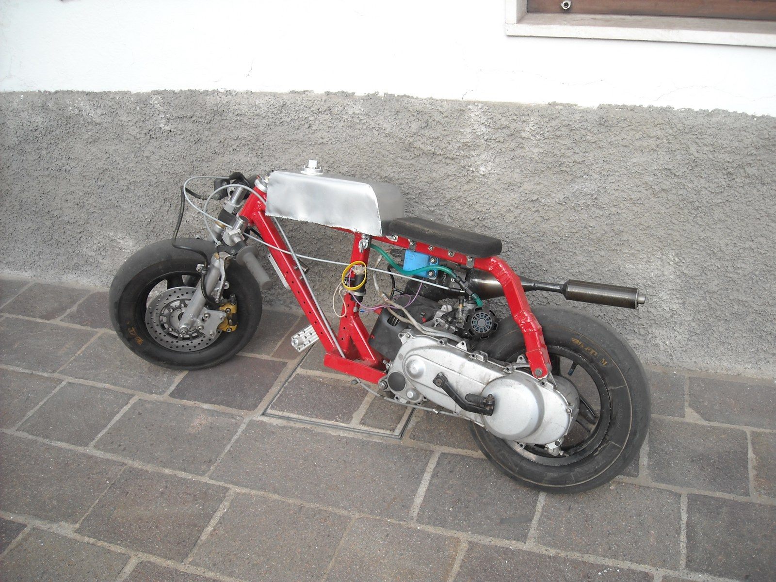

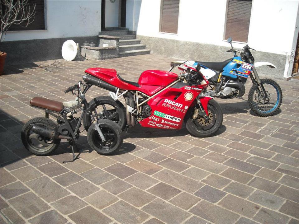

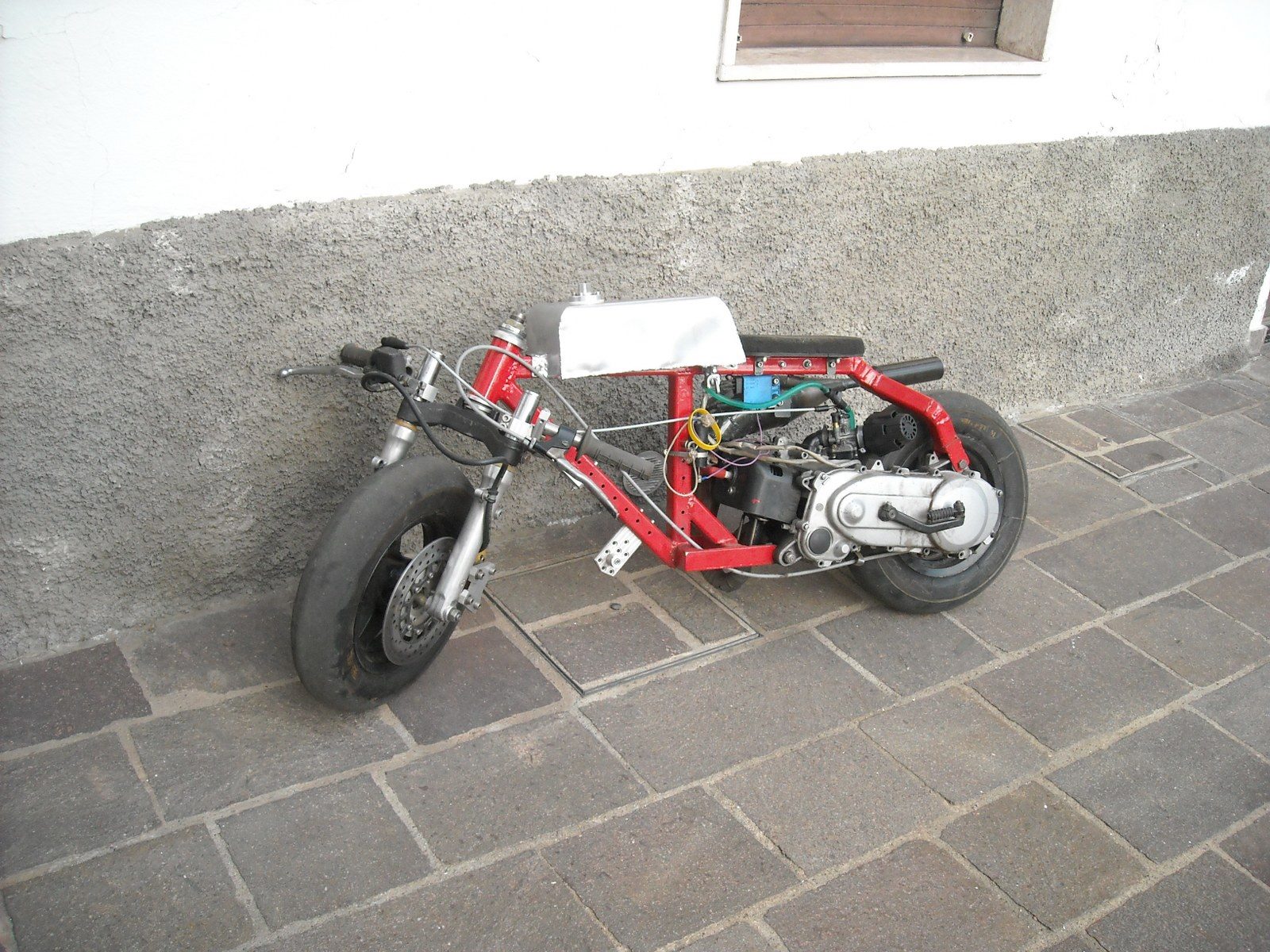

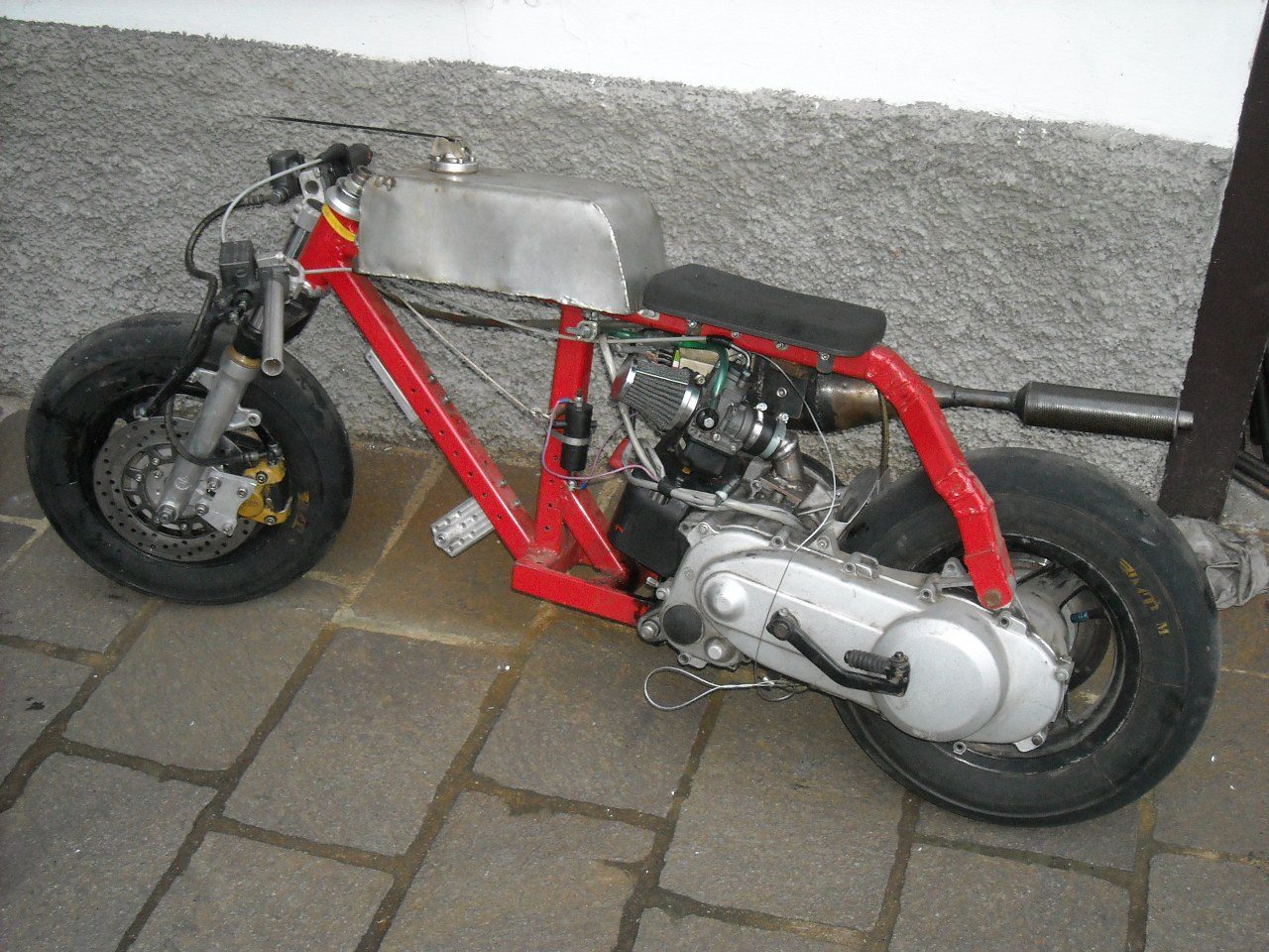

    The little motorbile is my first attempt to build a minibike
    Made from square iron tube, lot of errors, I learned a lot from this project.
    Basically it's a very short, not good, frame. Engine is a long arm Piaggio 2 stroke with 12" wheel and combo front disk and rear drum brake.

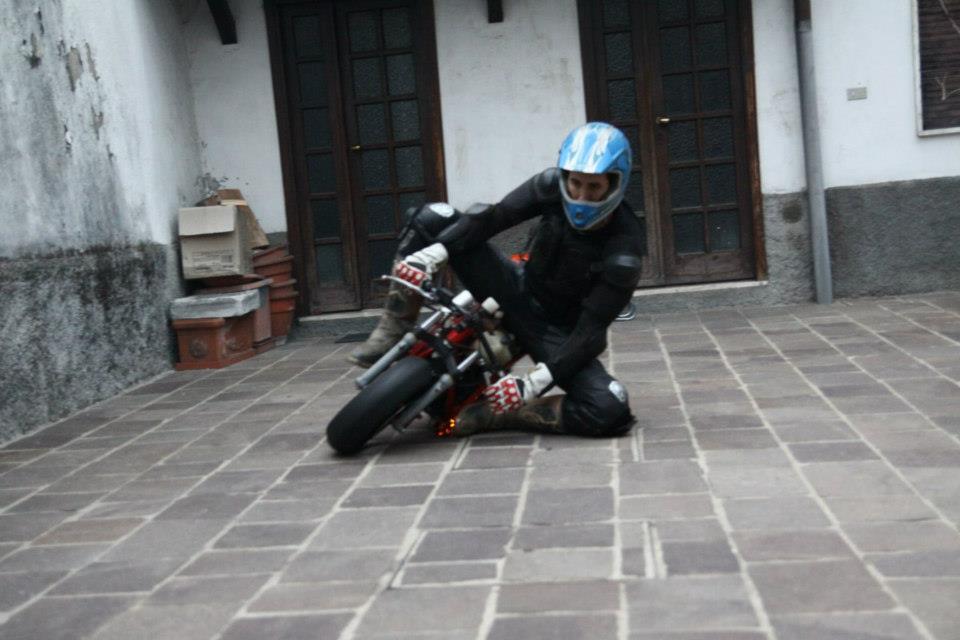

    Due to the angle of turn, sparks in pictures show the limit, I decided to change the frame to increase the angle and turn better. I changed also the handlebar.
    The bike was funny, but not so nice to drive to be honest. I dismantled the parts.
    Cowhide Motorcycle Jacket - DIY-255512_4750693607982_1961533392_n.jpg Cowhide Motorcycle Jacket - DIY-397307_4750680767661_1341486287_n.jpg Cowhide Motorcycle Jacket - DIY-486899_4750699248123_1857466732_n.jpg
    Cowhide Motorcycle Jacket - DIY-560737_4750688967866_2052294468_n.jpg Cowhide Motorcycle Jacket - DIY-599817_4384935944269_1337691971_n.jpg
    The new mkII (still in working condition) is funny to ride! Long frame with space for legs, very good position on seat, low center of gravity perfect for high hp engine and turn.
    Some specs:
    - 10" wheels with PMT soft racing tyre
    - Front 220mm disk with radial caliper and pump, rear 220mm disk, normal pump
    - 60kg
    Engine is a Piaggio "short arm" 70cc unit, 2 stroke tuned
    - Full shoulder crankshaft
    - TPR cylinder milled for high revs, head and single band piston
    - Calculated handmade exhaust, I tried maybe 15 aftermarket type
    - Carbon lamellar valve, 28mm carburettor Dell'Orto with filter.
    - Variator, adjustable clutch, final gears
    This little beast reached more or less 13500rpm, about 135 km/h at full speed. Very stable and funny to drive

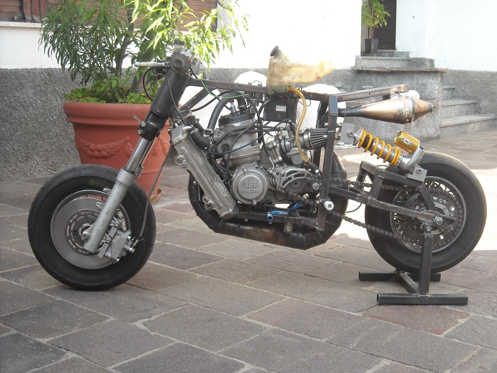

    I build also a mini beast with the engine of my enduro bike.
    250 cc TM racing engine, 10" wheels with Sava racing tyre and good brakes. I have to rebuild the engine with new rod and piston, and make a nice tubular frame.
    I tried the prototype, it's nice the position on seat, too much vibration due to weight on cranckshaft. Power of the engine was terrible, but with high gear it's impressive how it can be fast
