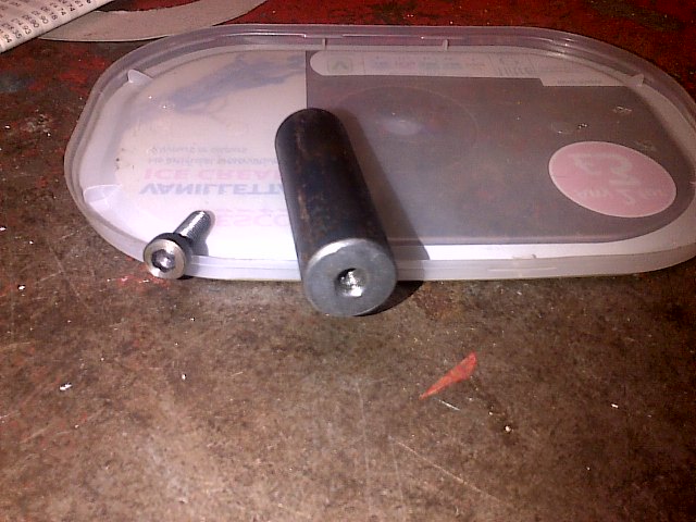

    first up is holder so i can turn down heads on cap head bolts without damaging threads, made it double ended to do m8 and m6.

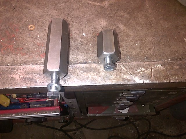

    next are couple of adjustable spacers for cutting short stock.

    Thanks naughtyboy! I've added your Cap Head Screw Holder and Adjustable Spacers to, respectively, our Machining and Metalworking categories, as well as to your builder page: naughtyboy's Homemade Tools. Your receipt:
    796
    Simple, but great idea. I love no-frills tools!
