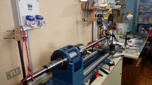

    Hi guys, I'm testing some ideas before effectively going into the task of aligning the headstock of my lathe. For this job I'm gonna use a 30mm dia x 1m ground steel bar, as a test bar, that I clamped in the chuck at midway, so that it is balanced on the chuck.

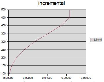

    This however would cause some deflection because the weight of the very same bar (as described here: https://en.wikipedia.org/wiki/Deflection_(engineering) see Cantilever Beams section.) To calculate the deflection I used the formula: d = (F * L^3) / (3 E * I) subdividing the bar in segments of 50 mm each and increasing the load at each step, the load given by the weight of the remaining bar overhanging the calculated point. This resulted in a maximum deflection of about 0.06 mm. Using the Uniformity Load Cantilever Beam formula (see the linked Wikipedia page) the resulting maximum deflection is 0.048 mm.

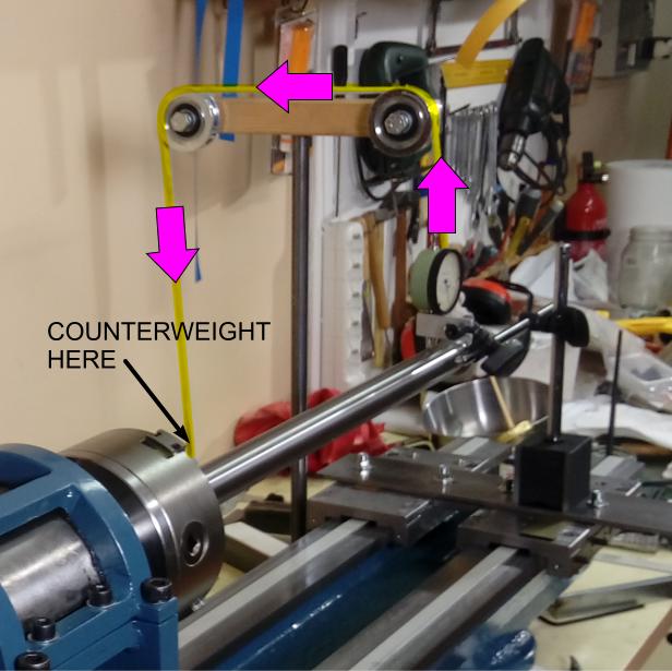

    I also thought to experiment a method to compensate the deflection caused by the weight of the overhang bar. I used a couple of pulleys where a string pulls up the bar while on the other side a weight pulls the string down, on both sides of the test bar (see photo).
    The counterweight is calculated to be half the total weight of the segment that overhangs from the chuck, since half weight is supported by the chuck.
    Measurements are not as expected though. With the bar not supported by the counterweight I can't see any deviation. Theoretically the bar should deflect in a bow-shaped way, as in the diagram in figure A. But I measured a perfectly straight bar. With counterweights at each ends I measured a negative deflection of 0.12 mm with a kind of bow-shaped pattern.
    Any thought?
    figure A
    photo 1
    details: how counterweight is attached.

    EDIT: I had an error in the algorithm that calculates the incremental deviation (the first method), that explain the difference with the result of the Uniformity load method. Though measurements still do not match theoretical calculations.

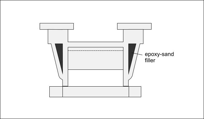

    The bed of the lathe has a geometry that should hardly let it twist and moreover deflect (see attached picture). The calculated deflection with a force of 200N (eq. to 20.38Kgf or 44.93lbf) exerted in the middle (between the feet) is far less than 0.01 mm (0.000394") while it could twist by ~0.03 mm (0.00118") under a torque of 1000Nm. So I don't think the bed of the lathe could deflect of any meaning amount for that small weight (the whole bar weigh less than 6Kg (<13lbs)).
    However thank you for the hint.

    Quote Originally Posted by Claudio HG View Post
    I was not thinking so much about the bed but about the head relative to the bed. You have stated that practice and theory do not match, therefore there is something lacking in your theory.

    But the final point is this: I don't see an excess in persuing precision given the tolerances found in that book, and the possible deflection I could have with my "test bar". Right? So the idea of counterweighting the bar do not seems to me so bad. The only thing I wonder is whether my calculations are correct because the sag I see is different than the one I figured out after calculating it theoretically.
    For instance, considering the counterweight that makes the bar as suspended on two points, the sag I calculated is approx. 0.008mm however I measured up to 0.02mm in the very middle of the bar, while the end and the beginning (on the chuck side) are both at zero, and the curvature of the bar (it has a slight bow of 0.02mm) is rotated midway so it does not influence this maesurement.
    So I think there is something that does not add up.
