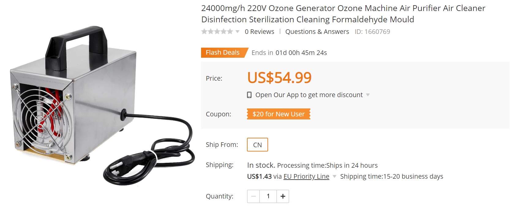

    Seems like some Chinese outlets whips out loads of discount ozone generators:
    Advertised as a do-all, cure-all method "for use in the home, hotel room, conference centre, karaoke bar, car, RV" etc.
    Specs for this particular unit is sparse, but it seems to be of the "Corona Discharge" type*,
    pulls half an amp (at 220 VAC only) that equals 110W,
    and thus cranks out a hefty 24 g/h of ozone - which could be detrimental to the stuff you're curing:
    I've read in another forum thread from a dude working for a fire sanitizing company,
    who'd just bought a really cheap car from a chain smoker:
    He got the brilliant idea to borrow one 250 W Heavy Duty ozone generator from work,
    and run it overnite in the car to rid it form the smell.
    He got the car free of smell, all right - but all rubber parts within the compartment had petrified,
    giving him a hell of a time to even get the unit back out, as all rubber seals had fixed the doors positively shut.
    I never posted asking whether he scrapped the car or tried to refit everything "rubberish" inside.
    My small unit pulls a mere 15 watts and gives plentiful of ozone for my 9 cubic meter hallway.
    Two cents & YMMV
    Johan
    *Corona discharge units also "provide" Nitrous Oxide - which could lead to respiratory problems, established earlier in this thread:

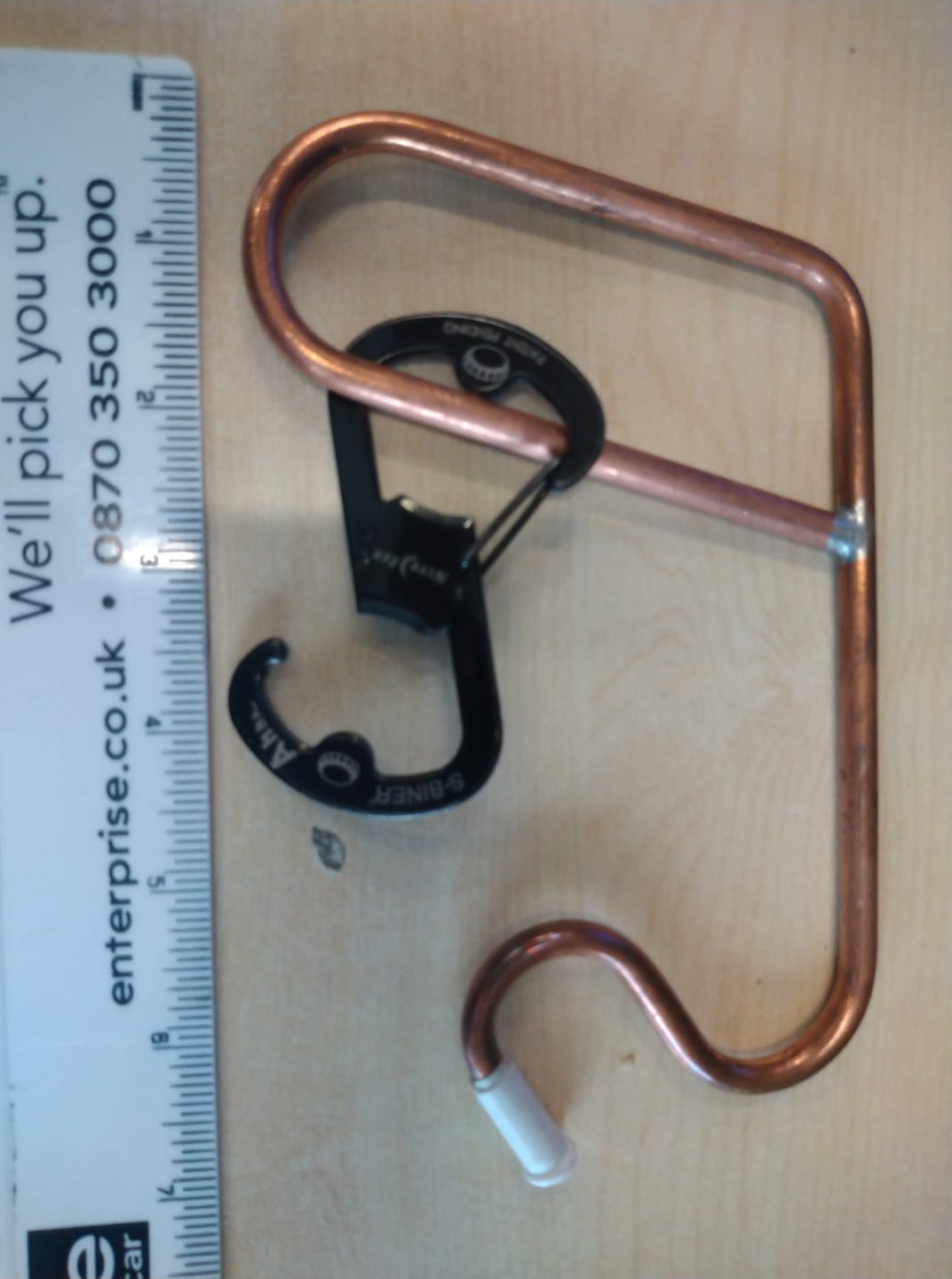

    Similarly, here's the CleanKey. Stuff like this will be easy for our guys to make. I wouldn't mind an accompanying sleeve for it, so that it doesn't just go back in your pocket. 0:44 video:
    The cleankey is a great idea, until a Police officer realises it also makes a usable knuckle duster, so not much good it the UK (banned it country), I've been making these out of 1/4" copper pipe offcuts and it does much the same thing, but it can't be mistaken as a weapon (hopefully). The broken s-biner lets it hang easily from a pocket or belt. Grip handle is ~1911 angle, later versions are P.08.

    Still wont be of much use in the land of the round door knobs

    Simple. Elegant. Nice for most uses, but, as mentioned, no good for round doorknobs.

    Thankfully here we have lever type door handles, knobs are considered unsuitable for disabled users being hard to grip, and too easy to tie a ligature on.
