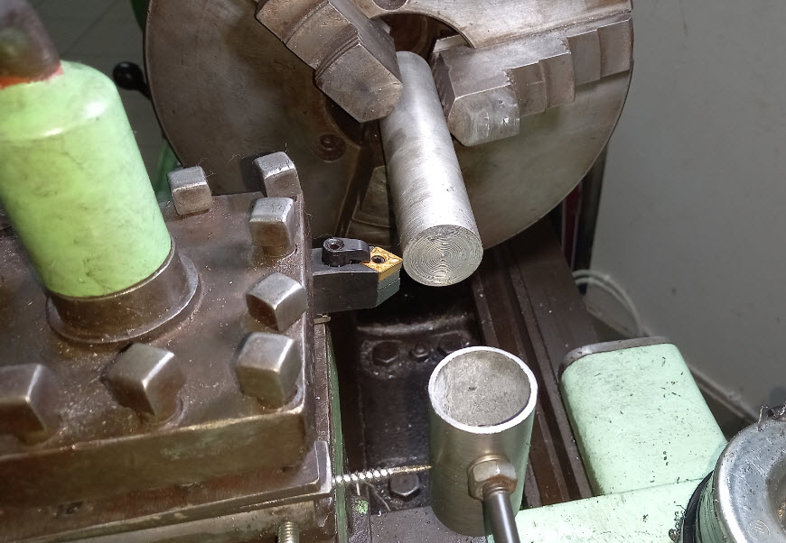

    COPY SMALL OBJECTS ON THE LATHE WITHOUT SPECIAL TOOLS.

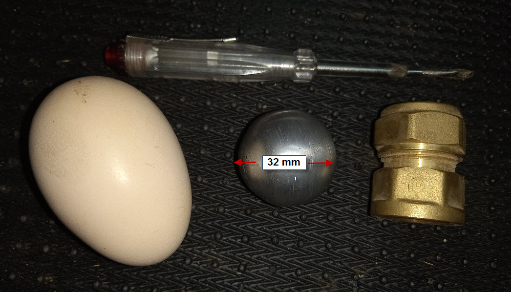

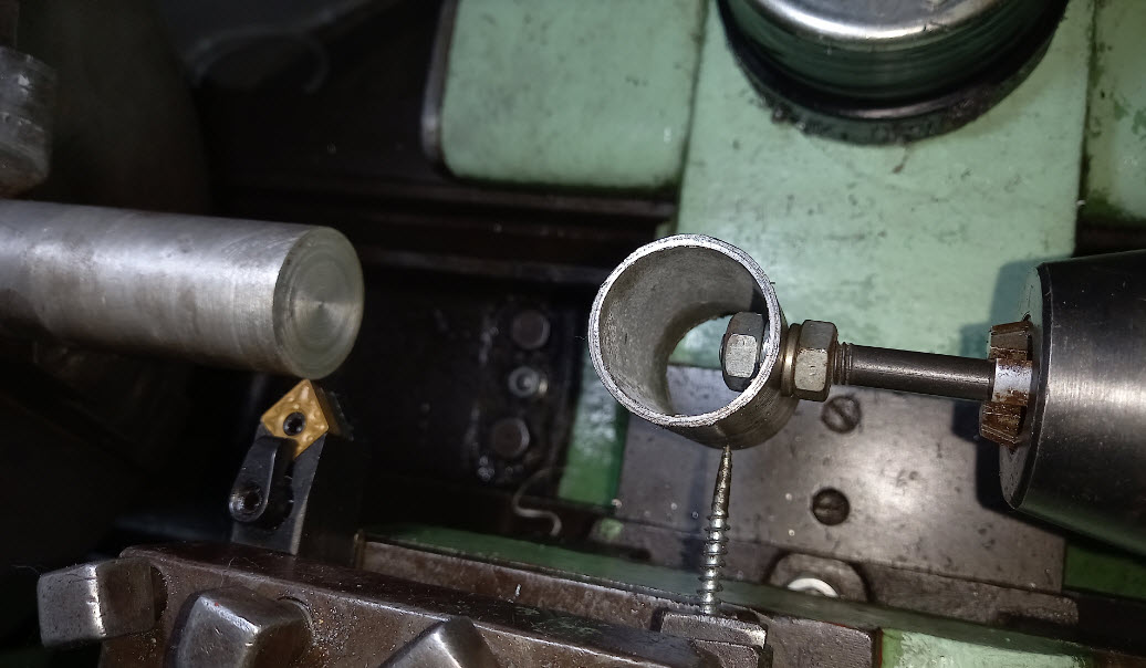

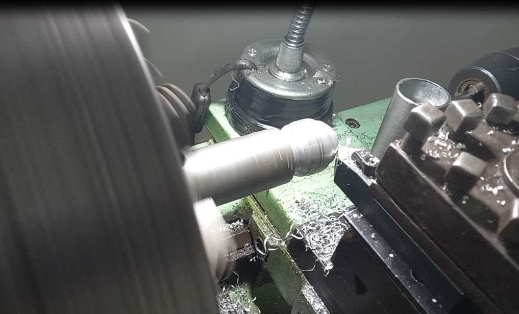

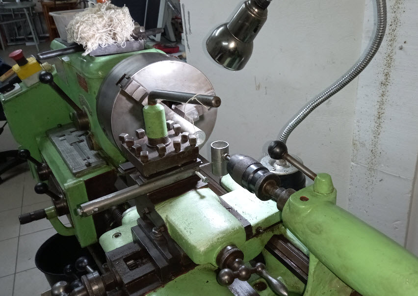

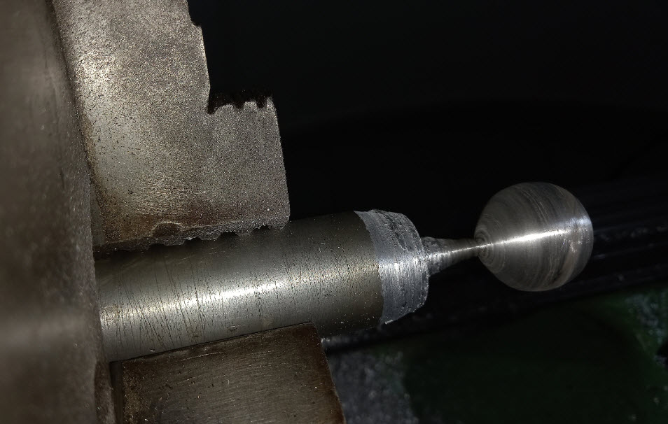

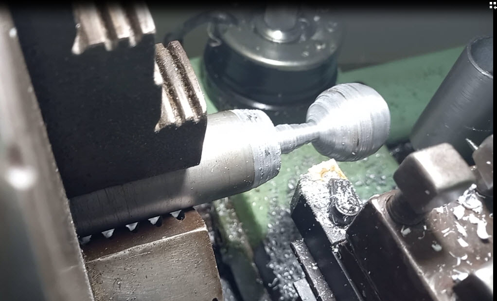

    In this video I make a copy of a small object on the lathe without special tools.Τo be more specific i turn a small sphere on the lathe using a cylinder with the same diameter as the sphere.
    Attached Thumbnails Attached Thumbnails COPY SMALL  OBJECTS ON THE LATHE  WITHOUT   SPECIAL TOOLS.-1.jpg   COPY SMALL  OBJECTS ON THE LATHE  WITHOUT   SPECIAL TOOLS.-2.jpg   COPY SMALL  OBJECTS ON THE LATHE  WITHOUT   SPECIAL TOOLS.-3.jpg   COPY SMALL  OBJECTS ON THE LATHE  WITHOUT   SPECIAL TOOLS.-5.jpg   COPY SMALL  OBJECTS ON THE LATHE  WITHOUT   SPECIAL TOOLS.-6.jpg

    I can't help it. No matter how well your method works for copying shapes I really hate seeing people put their hands so close to moving machinery.

    Get yourself a Ball Turner.
