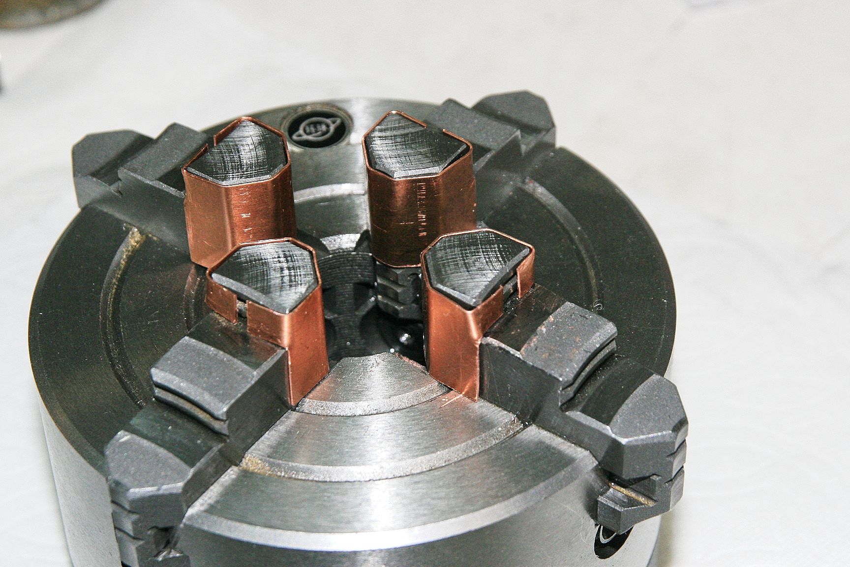

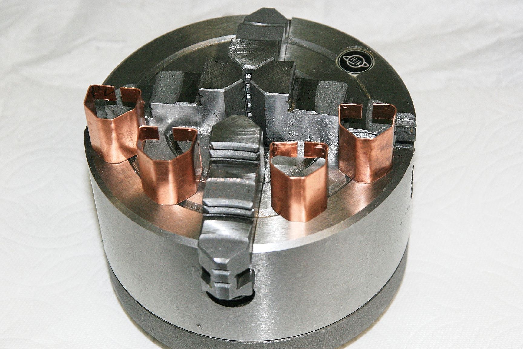

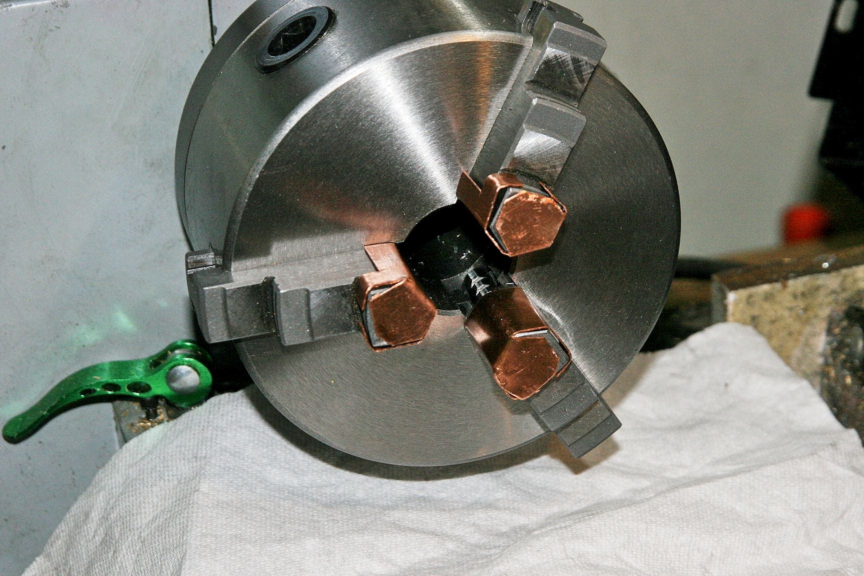

    I needed some soft jaws for my lathe and after seeing homeengineer's aluminum jaws:
    http://www.homemadetools.net/forum/a...029#post106174
    I decided to make some for two of my chucks. The first set was for the 3 jaw and has an added plate
    to protect the back of the part you are turning. Takes a bit more work but the added protection is worth it
    for some projects:

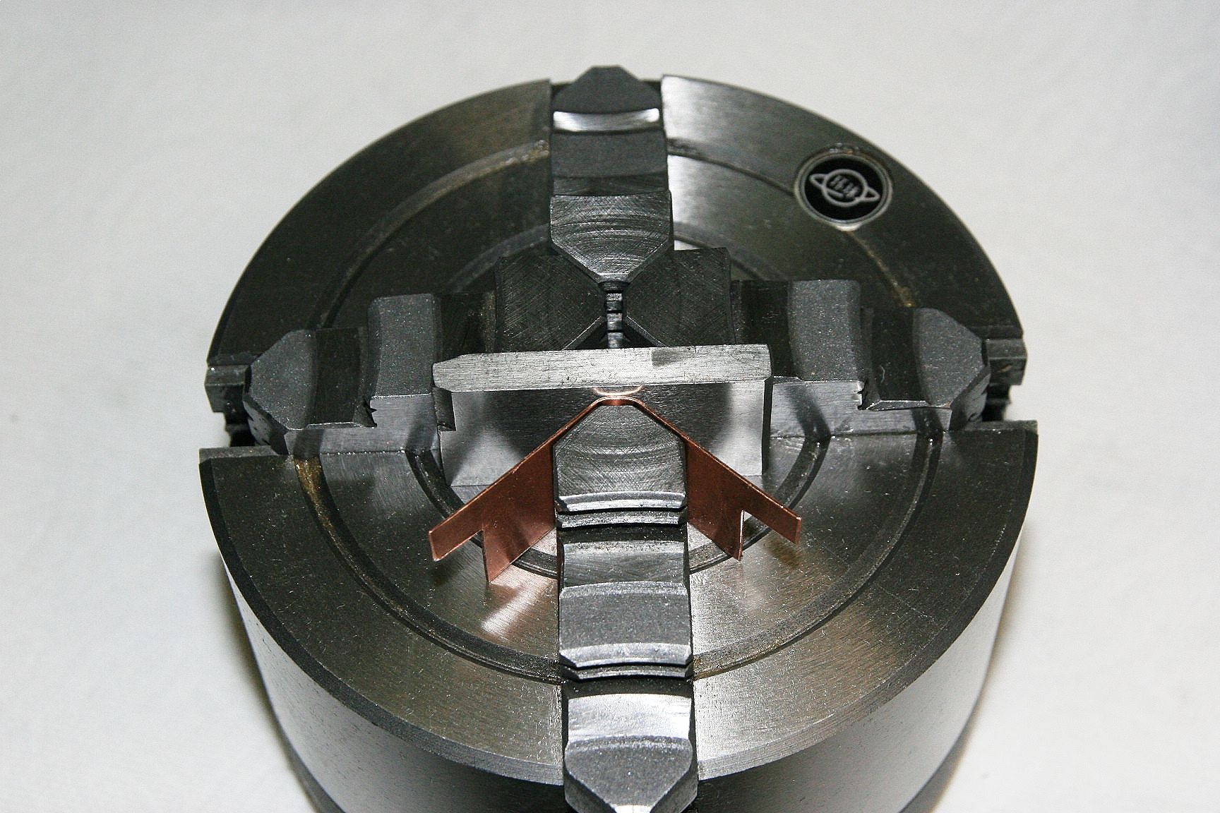

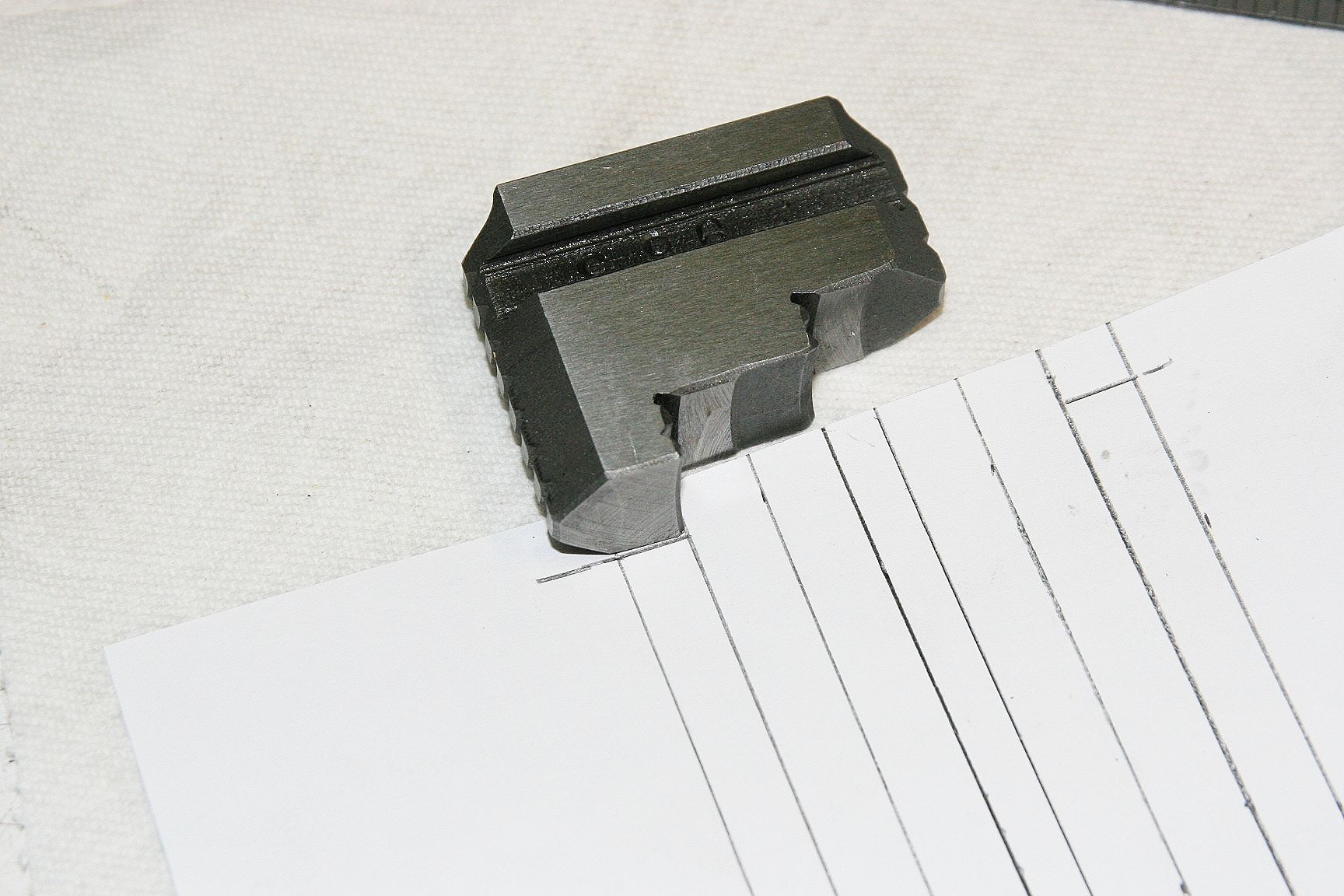

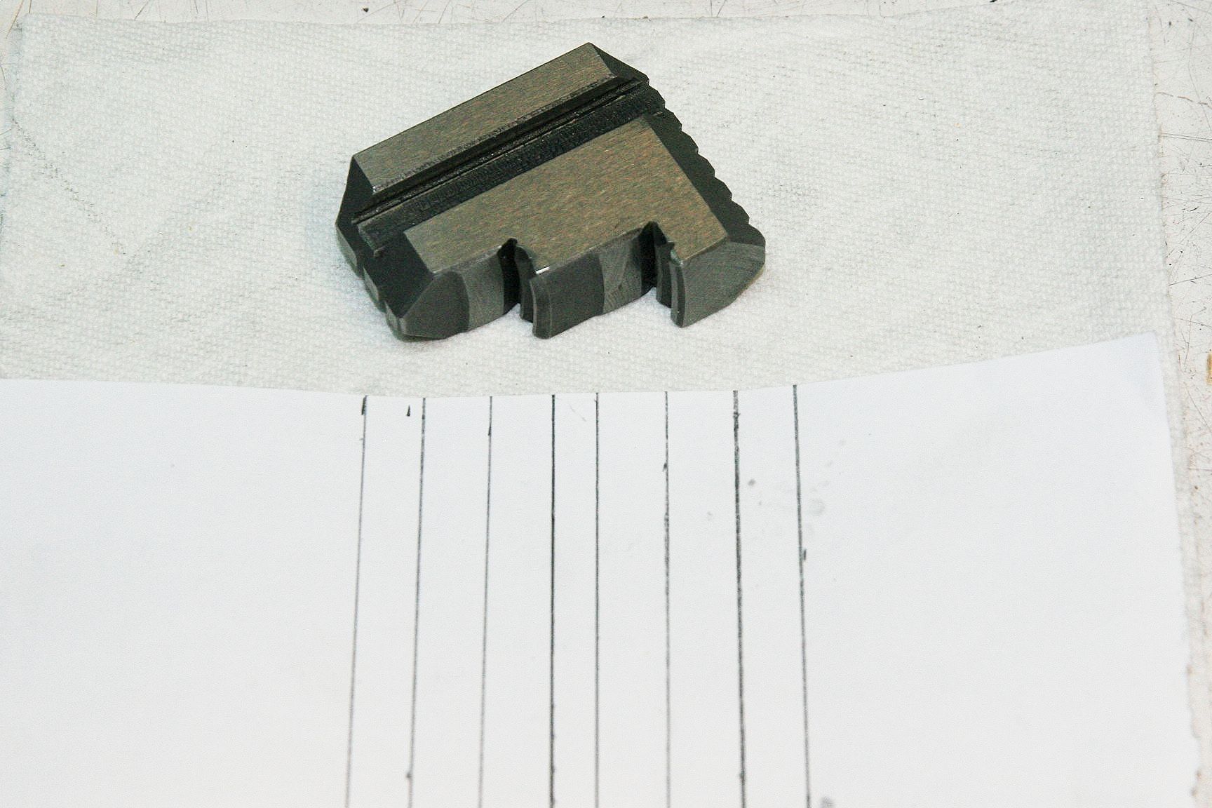

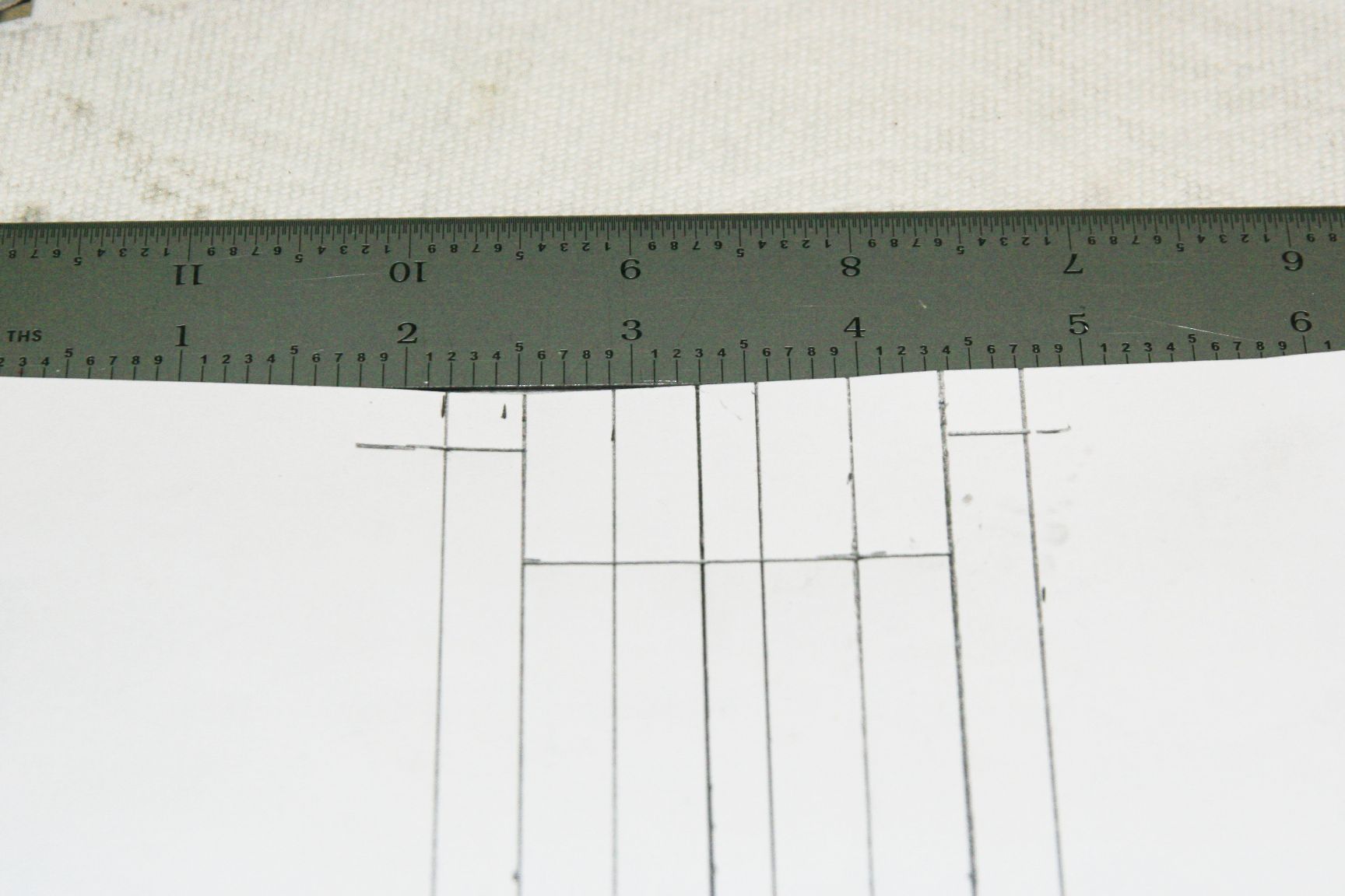

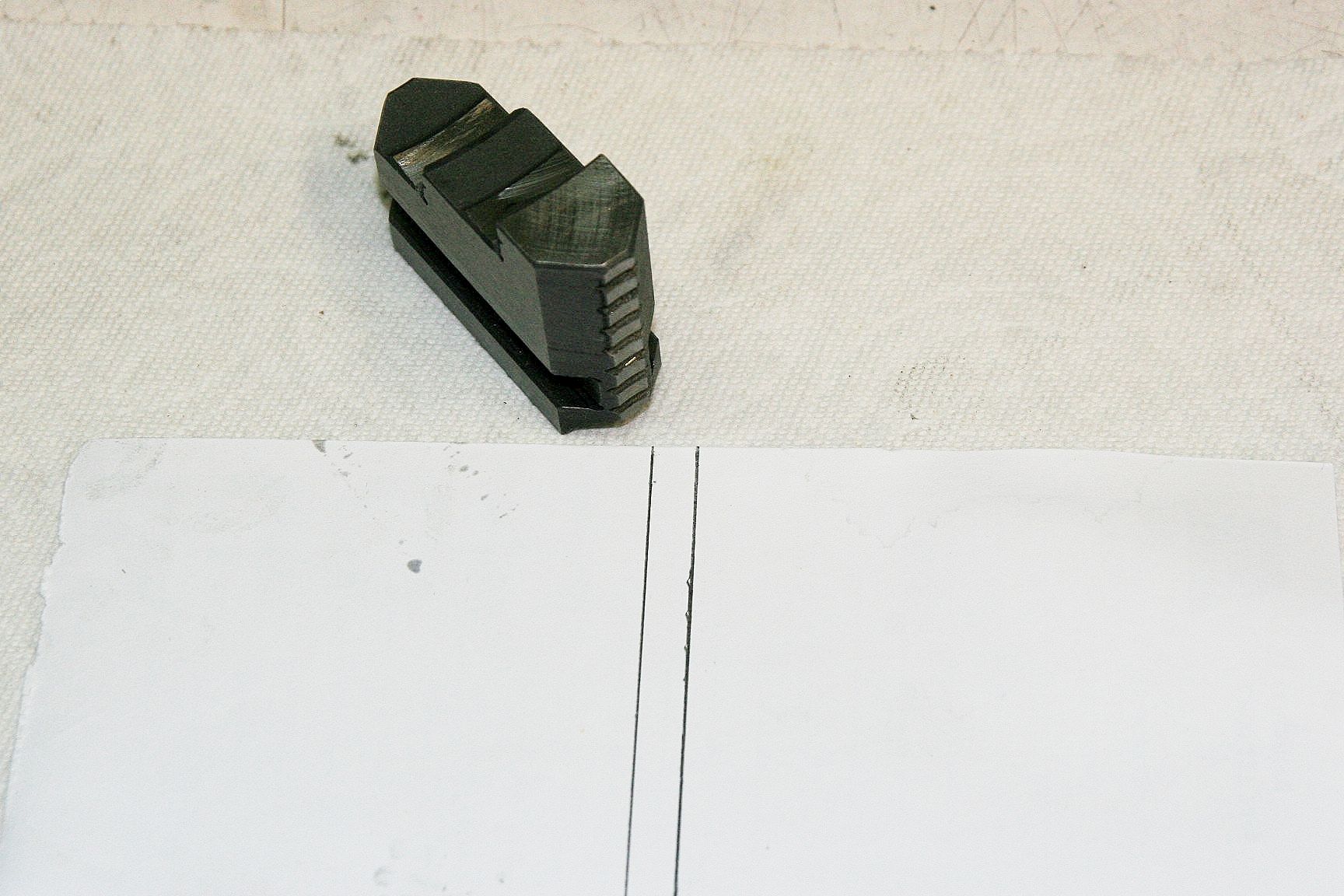

    Then on to the easy type. Just take some measurements and transfer them to paper. No measuring tools required, just use one of the jaws:
    Copper soft jaw faces for lathe chuck-img_1618b-copy.jpgCopper soft jaw faces for lathe chuck-img_1620b-copy.jpgCopper soft jaw faces for lathe chuck-img_1621b-copy.jpgCopper soft jaw faces for lathe chuck-img_1623b-copy.jpg

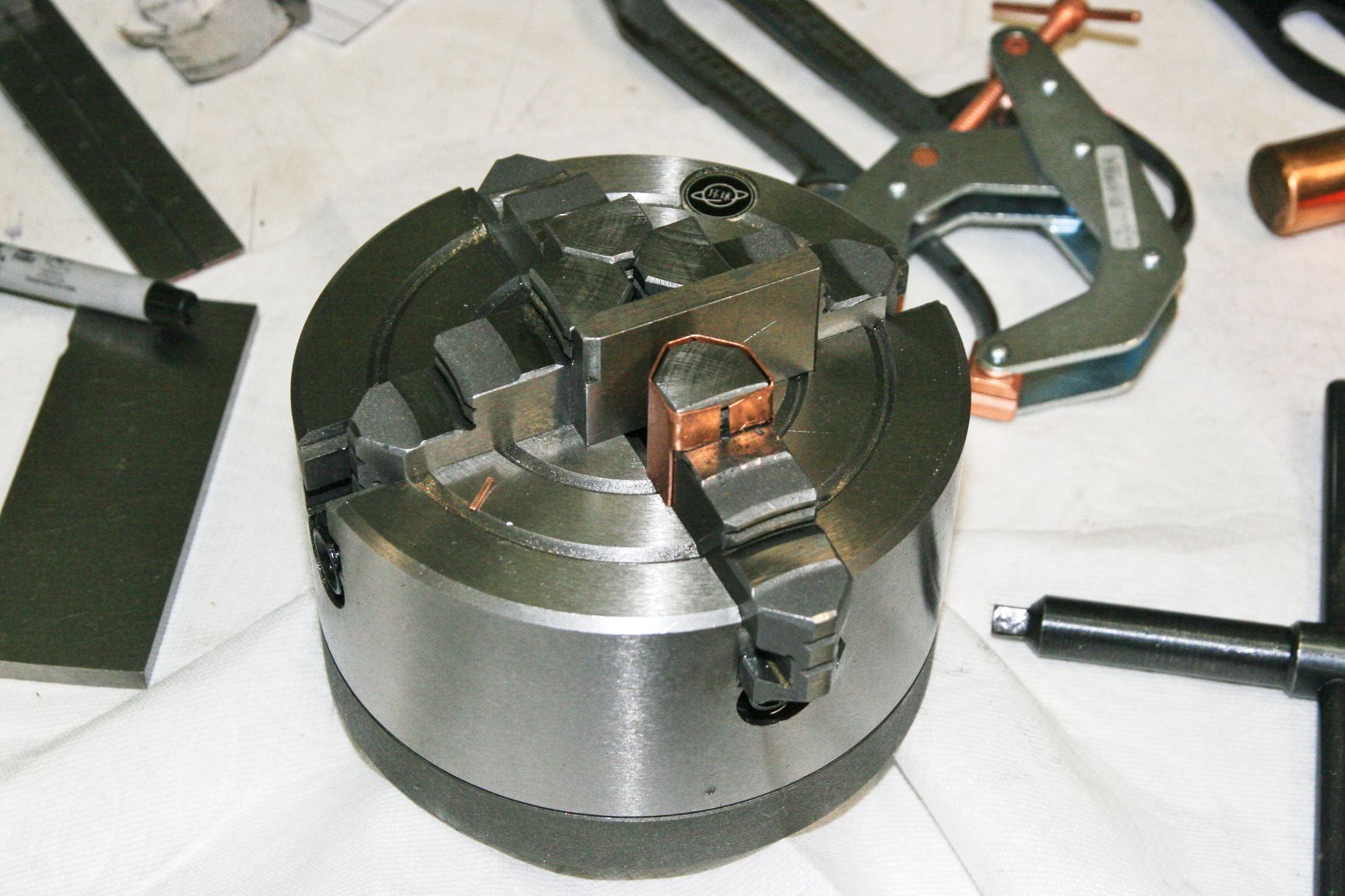

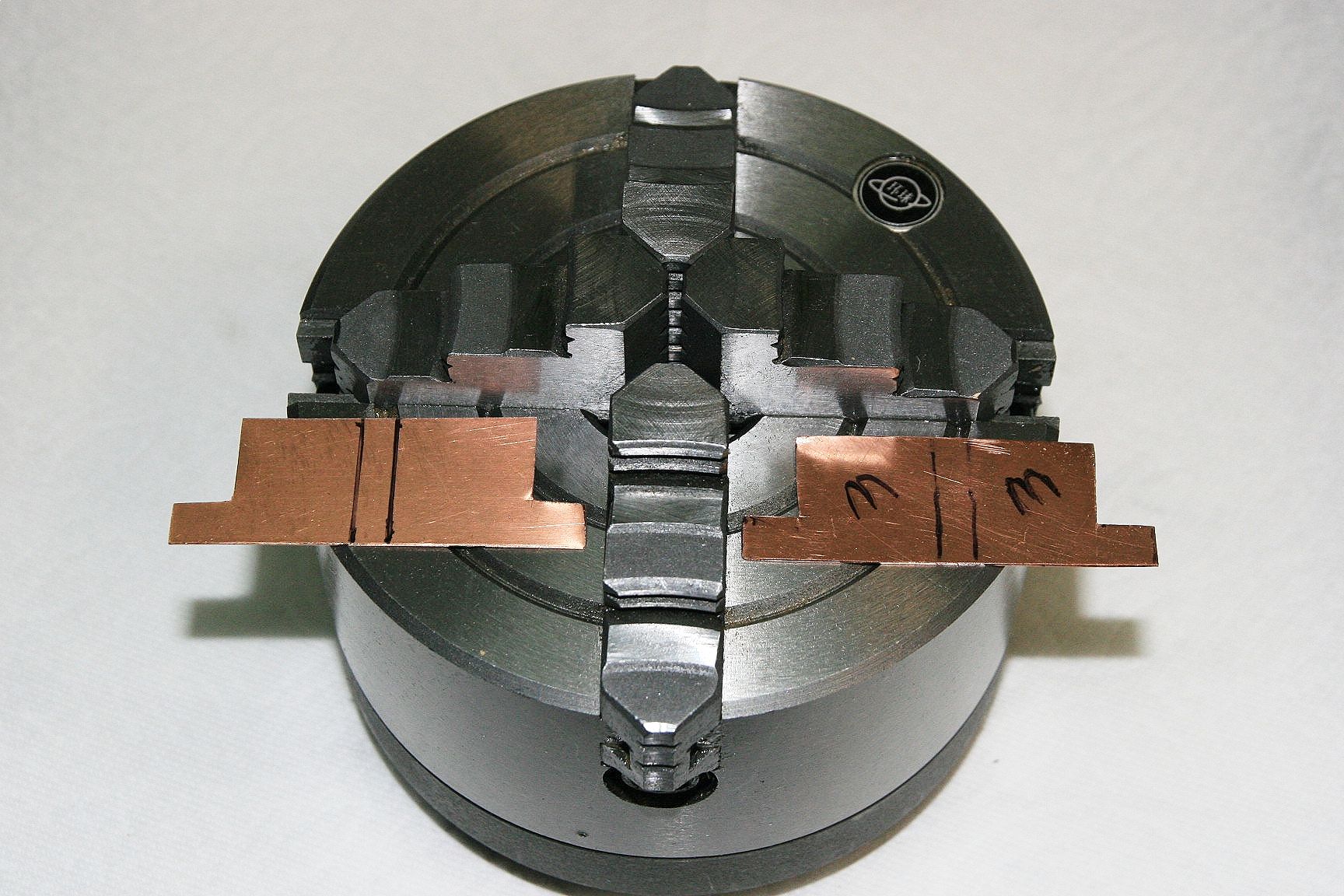

    Cut them out from copper sheet:

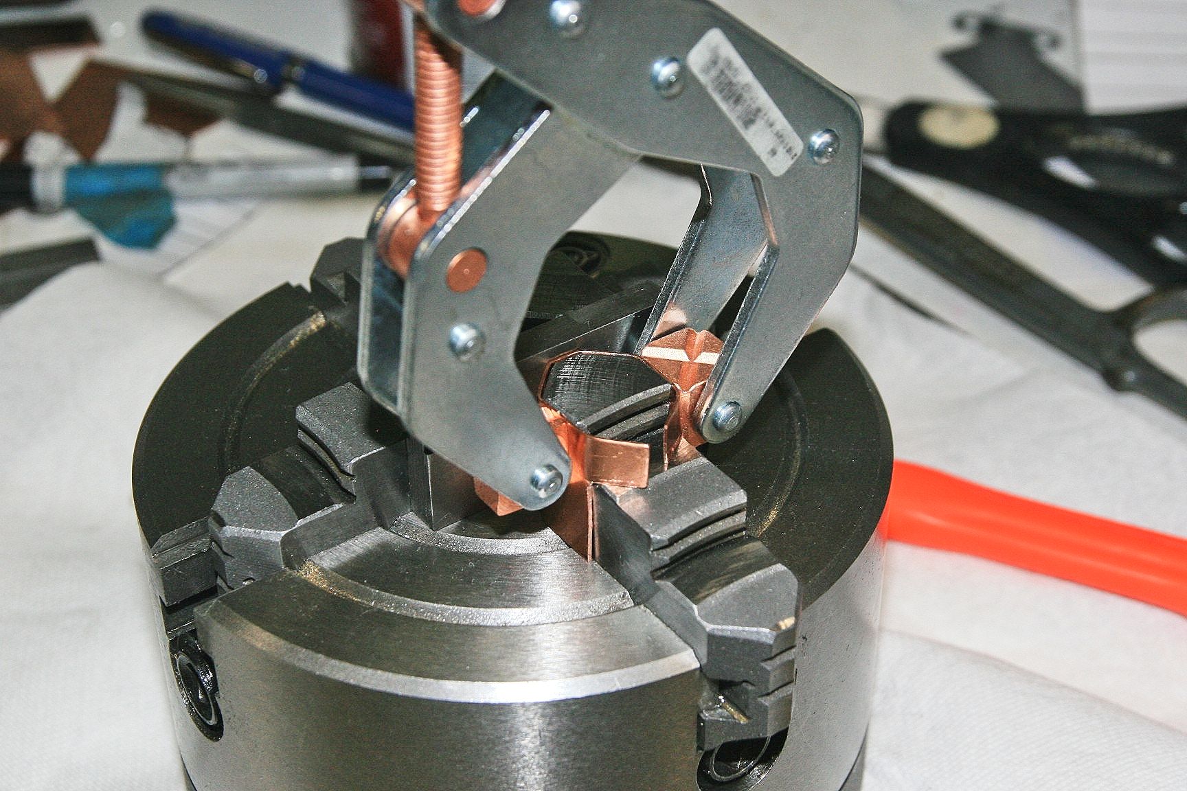

    Start the bending process:
    Copper soft jaw faces for lathe chuck-img_1631b-copy.jpgCopper soft jaw faces for lathe chuck-img_1633b-copy.jpgCopper soft jaw faces for lathe chuck-img_1634b-copy.jpgCopper soft jaw faces for lathe chuck-img_1635b-copy.jpgCopper soft jaw faces for lathe chuck-img_1636b-copy.jpg
    Then I always save a small poster board template for next time, and there will be a next time.
    Cheers, JR

    Hi JR
    great idea to make the template. I will do the samething next time.
    The Home Engineer
    Jun 2016
    939
    1,190
    Thanked 2,128 Times in 566 Posts
    jjr2001's Tools
    Thanks Andy, the template is from my background in model aircraft. Multiple ribs etc require a simple template since so many are made and
    it is easy to just trace around the original. Same with broken parts. Just glue them together and make a template for laying out a new one.
    Cheers, JR
