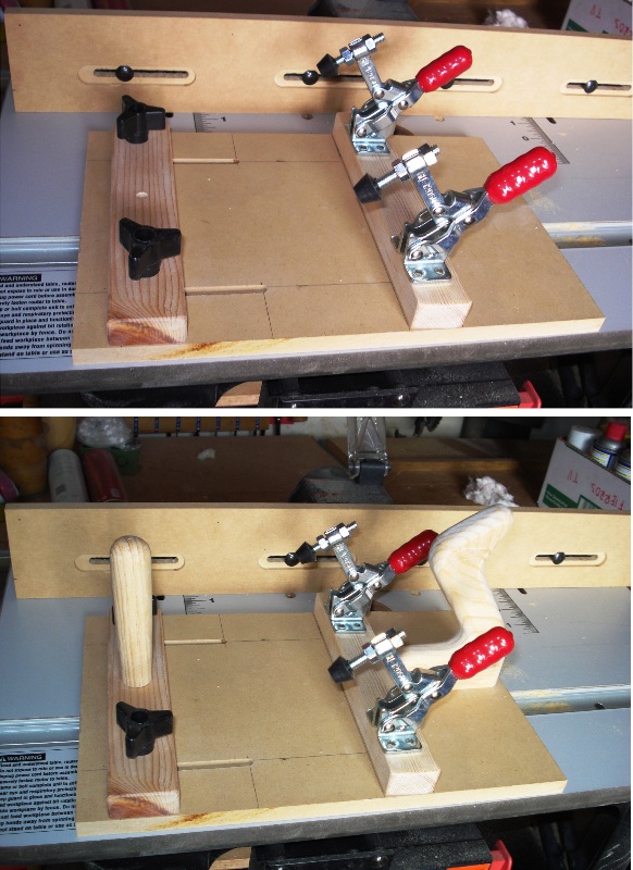

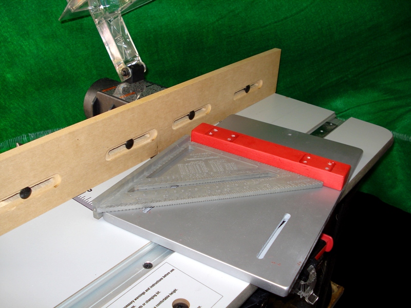

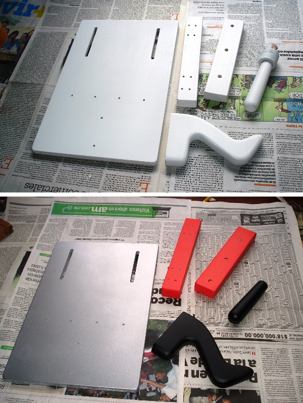

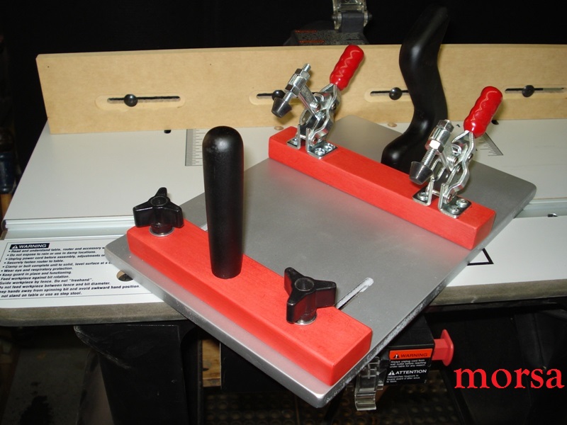

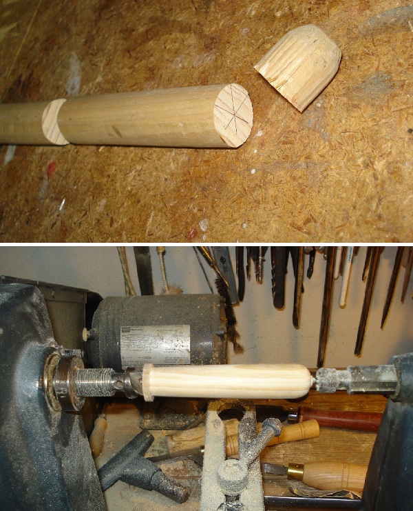

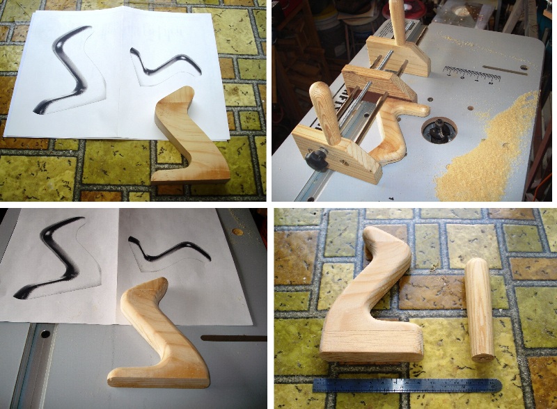

    Coping Sled
    There are lots of models of router table coping sleds, both commercial as homemade (https://www.google.com.mx/search?q=c...HXx6D9AQsAQILg)
    This Project was made in april-2013.
    The base is 1/2” mdf; handles and stops were made with scrap wood.
    Finish is primer and lacquer.
    Regards, morsa.

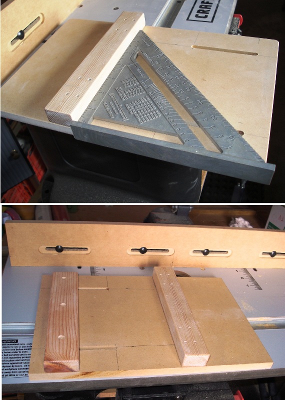

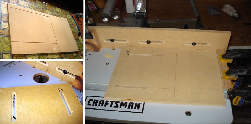

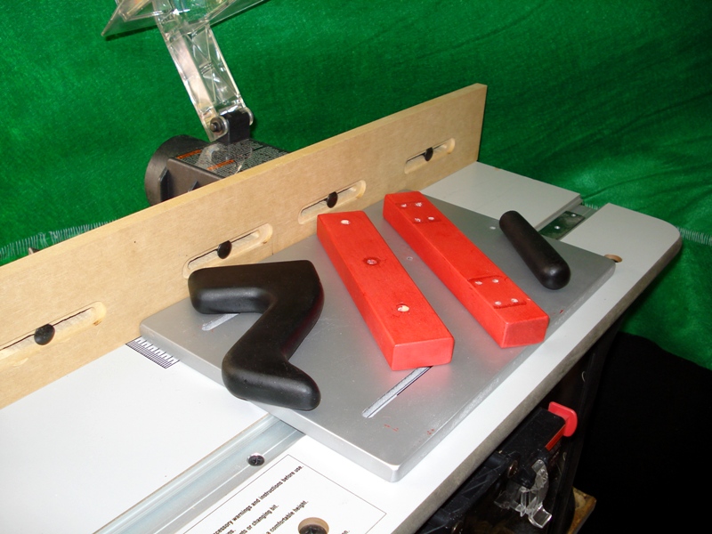

    This sequence of images shows the assembly and also the way of fixing the workpiece:

    Thanks Morsa. I really like your sled Idea and a Nice build. The animated video showing the clamping helped a bit, mainly for clamping work. Do you mainly use this for cabinet making type work, like door corners? Wood working terms are still a bit (actually a lot) of a mystery to me. Coping as I know it, from only a little experience of baseboards and crown molding, is for the corner joints to be near perfect, but your sled seems to make finger/rabbet type joints based on the bits I saw in your link above. Although...it looks to me like you might be able to make a strong, quality scarf joint with something like this also...again small experience. Apologies for my naivety...but curious.

    Thanks, PJs. You are right; a coping sled is a jig for end-grain cutting at the router table.
    And yes, I use it for frame and panel doors. The coping sled would be used to cut the profile in both ends of the rails; the sacrificial wood behind the workpiece helps to avoid tearing at the end of the cut. The edge-grain cuts, on both the styles and rails, are made without this jig, supporting the workpiece against the fence, with the help of featherboards and push stick. Here you can find the procedure: Frame and Panel Door - Popular Woodworking Magazine
    Of course, there are many profiles for these frame doors: MLCS Rail and Stile Carbide Tipped Router Bits 1
    The technique for coping crown moldings or baseboards with a coping saw is somewhat different. See this link: Coping Crown Molding on Inside Corners

    Thanks, Paul Jones. It is important, in addition to this support with sacrificial wood, to hold the workpiece firmly perpendicular to the fence (or miter guide if it guides the sled). In the end, this is the goal of all models of coping sleds, whether simple or highly sophisticated.
