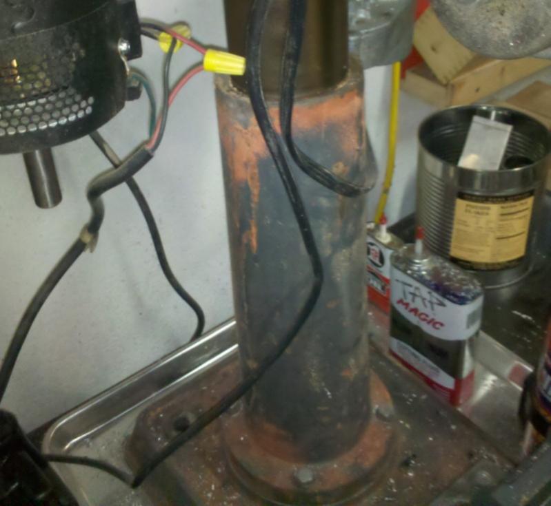

    Replaceing the lower bearing and things to look for on the drill press selection
    The first thing that I look at when contemplating a conversion is the Drill press that I am starting with. I look for a floor model that has a tall column attachment block to help the rigidity issue. Then I also look for one that has a broken table or possible damage to the upper column. This last project press was a craigslist find that had a broken table and bent rack. Neither of these where items that i would use in the end but it did allow me to get a solid 17" machine for $75.00 to start my project with. This drill press new is in the 500 to 950.00 range. As has been brought up many times if you were to pay new price for all the items for a conversion you would have 80% of a factory mill drill.
    The other item that I look for but don't always find is the heavy quil lower bearing. These will allow the installation of the 5200 series angular contact bearing without modification. In this mill it had a 6203 series bearing which I was able to replace with a 5203 double row bearing without modification with the exception of the lock pin on the top of the upper bearing due to the quill being 3/16" lower then before. Even with the deep bearing block the bearing still hangs out about 3/16" below the bearing block, much more then that and I would have bored the bearing deeper in the block. These bearings new are about 40 to $50 but by watching Ebay I have been able to get new Fafnir bearings for under 15.00.
    The double row angular contact bearings are the style bearings that the automotive industry has gone to for modular wheel bearings. This site has a quick description of angular contact bearings. http://www.astbearings.com/double-ro...r-contact.html

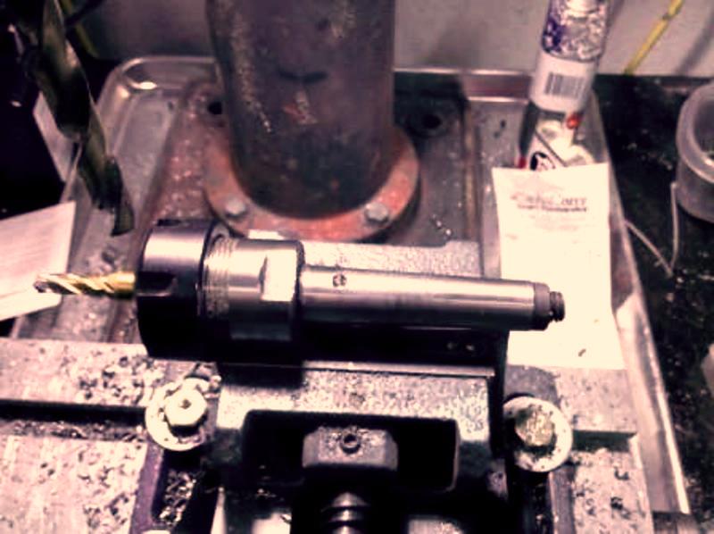

    Dealing with the tapered chuck holding Issue
    • I go to a ER25 or 30 series collet systems with the proper Morse taper and either use a draw bar or a lock-pin to retain the taper.
    On this conversion I have gone to the ER25 series collets. I bought the HF set of end-mills and only need 3 collets for all that is there 3/8, ½, 5/8 . This gives me 3/16 to 5/8 mills
    My son has a full machine shop up to a 30hp Haas CNC mill and if I really need something else I go and use his shop. He is production oriented and I’m more of “enjoy the feel , and the journey type. We give each other a bad time about our different views of the world.
    The spindle shaft was small enough that I did not want to bore it for the draw bar. So, on this conversion I’m using a lock-screw retainer. I drill and tap a 10-32 hole in the bottom collar of the spindle shaft. I then seat the MT2 collet and center drill about a 1/8”’ deep hole in the Morse taper. I then use a 60o chamfer on the hole.
    When I put the MT into the spindle I line up the MT chamfer with the screw and push it in loosely, I then tighten down screw and it centers the taper on the chamfer, I then tap the taper home and finish tightening the setscrew, because the setscrew and the chamfer share the same center on a fully seated MT, by seating the MT and tightening the set screw the MT is locked in the fully seated position. I retighten the screw after the first pass just for safety sake.
    The screw is a mild steel screw that has been sharpened and end-blunted. If I forget to unscrew it before I drive out the MT when changing tools it just shears of the screw and doesn’t mess with the chamfer on the hardened MT. The first one of these I did I used a hard set screw and tore up the MT when I forgot to loosen it once. Lesson learned

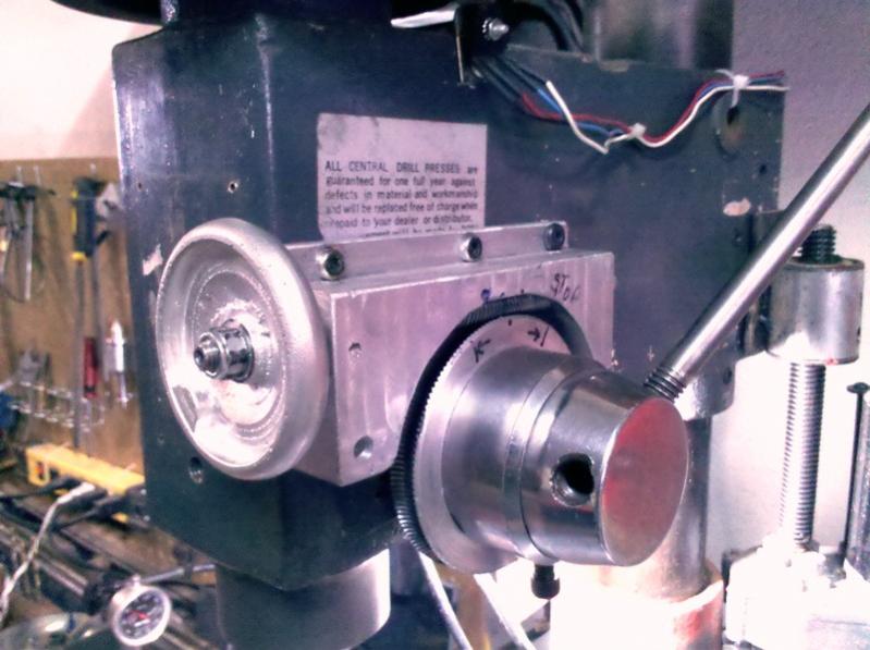

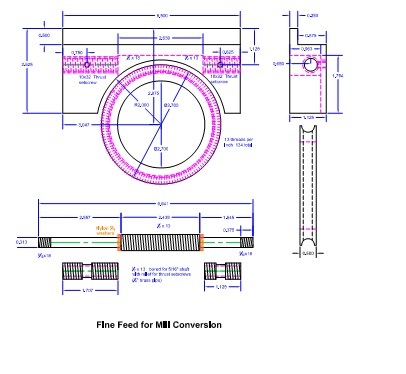

    Fabrication of the fine feed
    The basic idea for the fine feed came from those that where needed for the early Grizzly and Harbor freight Mill drills.

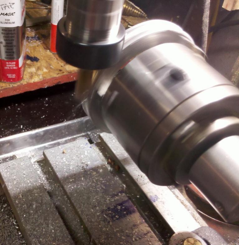

    I modified the design to allow for eliminating the backlash in the worm gear. I cast mine from a ZA27 alloy that I mix but it could be cast from aluminum just as well. I turn the ring gear and thread it using a tap as a gear HOB. I have gone to using spiral taps as hobs because there is always a thread in contact with the gear. You don’t need to scribe the first set that way.
    This picture is using a 7/16 mill to cut the cove for the thread in the ring gear. The ring gear is mounted on a 3 jaw lathe chuck that is in turn mounted to a live center and held in the vice. My live center is designed with a ½ x 20 thread for the cones. It allows me to remove the cones and mount chucks etc to the live center for this type of application. My live centers uses a small double row angular contact bearing. By bringing the mill down to the tangent point it cuts and drives the ring gear.
    As you can see in this picture this also works with the tap when placing the threads in the ring gear. I turned the tap at about 60 rpm and started with the taper just above the tangent point and feed the tap down until it was turning through the taper and on the full tap. I then run the rpm up to about 550 for a minute or so and allowed it to clean up the threads.
    The ring gear is mounted to the drill press ring that was used for a quill stop. This allows the fine feed to be disengaged vary easily when you want to use it for a drill press. The ring gear is bonded to d-press ring with Locktite bearing adhesive.
    The worm gear is a piece of ½ x13 threaded rod that has been turned down to 5/16 on each end where it goes through the housing. The housing is bored and threaded ½ x 13. The bearing surface inside the housing is made by taking a ¼” brass nipple and threading the outside and cleaning up the inside bore for a bearing. These can also be adjusted to remove the backlash from the worm gear. I use this bearing method most times on items that need a worm/ring gear set. It also acts as a hard brake on ring gear travel. The worm gear on this also extends beyond the housing for the attachment of a z axes drive. I normally just put my vary speed drill on the hand wheel bolts for rough setting and quick moving.
    Converting a drill press to mill-drill-fine-feed.jpg Converting a drill press to mill-drill-drill-mill-fine-feed.jpg
    The next set of modifications for this conversion will be to add external springs to the quill. The reason for this is that the spring that is currently lifting the quill is on the pinion which leaves the quill floating. The external springs will force the rack against the pinion and the fine feed will then be in direct down contact with the quill. The weight of the quill and the springs will prevent the end mill form walking in most cases.
    The installation of Gibs to the quill will remove the play that is between the head and the quill. At that point you will be able to raise and lower the quill under light cutting loads such as a boring bar, heavy loads like a face mill would still require locking the quill in position.
    On this conversion I will use the center Gib screw to lock the quill.
