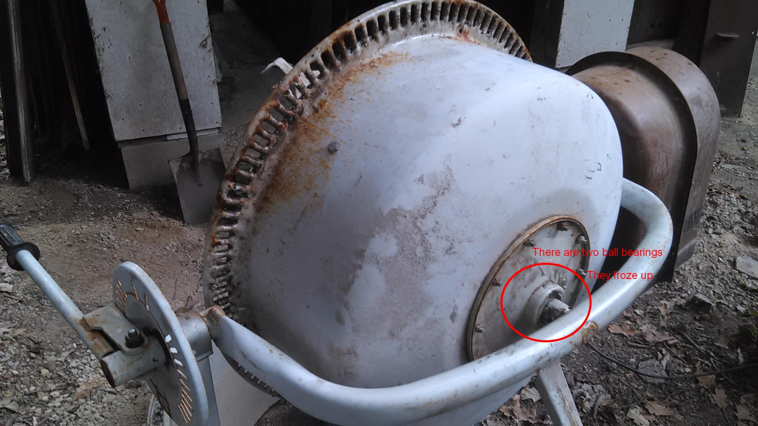

    I was going to pour some repair patches of concrete this morning. But instead I spent the day repairing a cheap import mixer (says 3.5 Cu.ft., but really only 1cu.ft.). I used it 10 years ago to mix mason mortar, to lay up concrete block for my house addition.
    Well it sat these past 10 years under an overhang. The dual ball bearing drum support froze up. So after much dis-assembly, and a can of penetrating oil, it's working. I installed a zerk to fill the sealed from access space with grease.
    The concrete repair is because of a ground hog (marmot, wood chuck, whistlepig) that was able to dig under the door, and then a hole down in the back of the shed. It filled 4 wheel barrows of earth inside.

    I stored it with the bearing up as it freezes here. But I didn't think about a small amount of wind blown snow melt over 10 years, and no weep holes to let it out, that would damage the bearings. There should have been a zerk fitting for grease from day one.
    And so true, it is better then mixing by hand. For as cheap as it is, it works. And it has an over current circuit breaker to prevent motor burn out.
