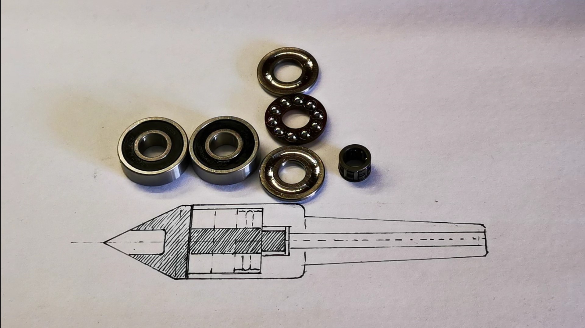

    Hey guys (and gals if any) me again,
    Been thinkin of this project for some time now. It's been a fun and somewhat challenging endeavor believe me. With the magic of some clever editing the trials and tribulations seem invisible but be assured I had a few with this one. Anyway the final outcome was well worth it. I hope you enjoy the journey as much as I had doing it,
    regards stevoh

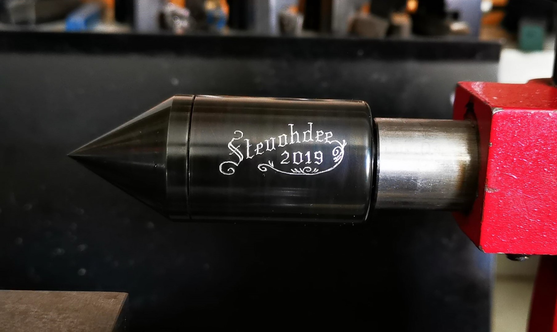

    Stevohdee,
    Great job on the compact live center! Many years ago I had a small live center known as a "Nyroll" center. It also was quite compact and was very nice to use.
    What is the length of overhang from the end of the #2 MT?
    Dick

    Thanks dick, here's some measurements:
    Overall 133mm
    Point to shoulder 71mm
    Taper 62.5mm
    Gap between shoulder to tailstock quill 1mm
    Phew that was close to the bone!! Haha

    Stevohdee,
    Thank you for the dimensions! It sure looks like a nice project.
    I did not have success searching for the "Nyroll Center" either. It was sold in the US about 50 years ago and maybe was not a successful product. It had a very small head about the size of a Morse taper shank and was very handy for getting in close to small diameter work.
