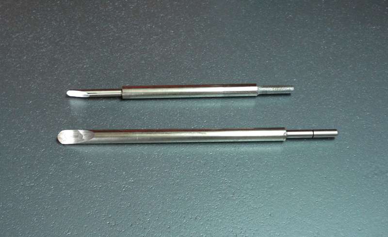

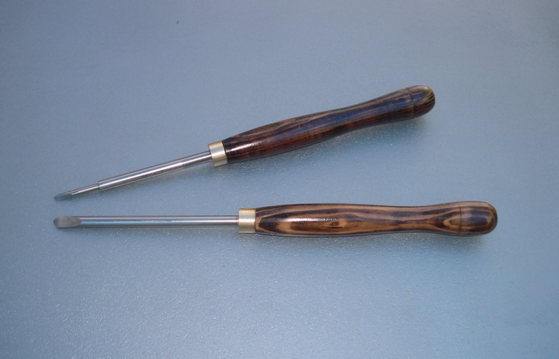

    This tool, also called sjewji gouge or skewchigouge, has a combination of the cutting profiles of a skew chisel and a gouge, and hence is a multipurpose tool.
    The tools I show were made from a discarded printer 3/8” Ø steel bar, which had a reduced diameter to 1/4 "at both ends. The handles were made in pine and a brass ferule was added.
    This tool is based upon the article “Unconventional Tools” by John Siegel. It is possible to buy these tools in several commercial firms that sell woodturning supplies, and there are several homemade models on the net.

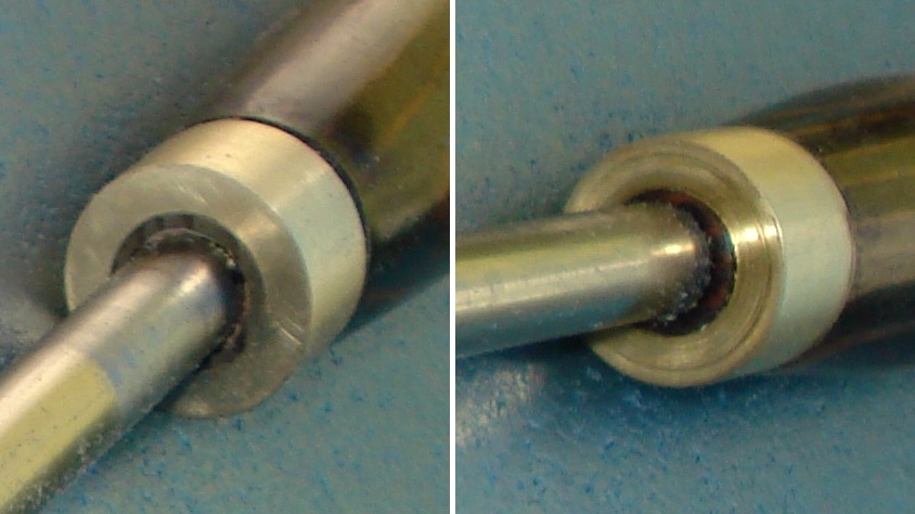

    Nice re-purposing of the printer shafts Morsa. Really like the tool shapes, seem very versatile. Got lots of scraps like those and just getting to making a handle for my metal scrapers...hopefully I can turn them on my mini. Curious about your ferules...almost looks like there is a slot in the ferule end of the handle for clamping? Thanks for sharing another great build from re-purposed materials! ~PJ

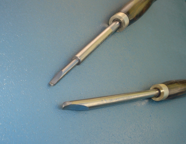

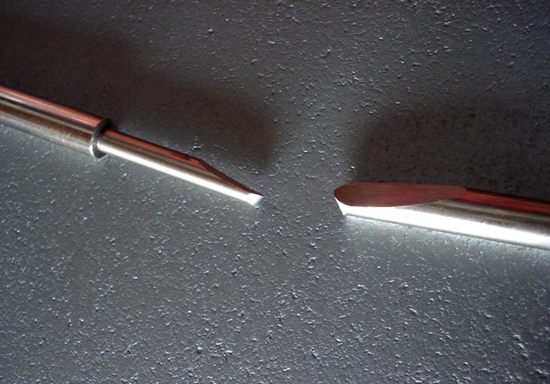

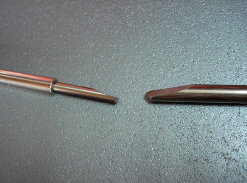

    Same as my comrades above, great idea for the steel shaft reuse, what kind of steel do you think it is ? If you try to file it, will the teeth bite the steel ?
    Another question, why do you call it a skew gouge, I would have said scraper gouge ? Maybe I have not well understood the way you use it ?
    There is no slot in the ferrule nor in the handle. I use leftover plumbing brass nuts rounded at the Unimat lathe; once finished both elements, they are assembled by hand. Here is an amplificated picture:

    I don't know what kind of steel are these shafts, but they are really hard; the file does not bite them. For grinding, I proceed slowly and cooling with water in order to not alter the temper.
    I suppose it is called skew and gouge, more than because of the shape of the tool, because the way it cuts the wood, but to answer this question I refer to the article of John Siegel:
    http://www.bigtreetools.com/articles...ionalTools.pdf
    By the way, commercial houses that sell these tools also call them combination of skew and gouge.
