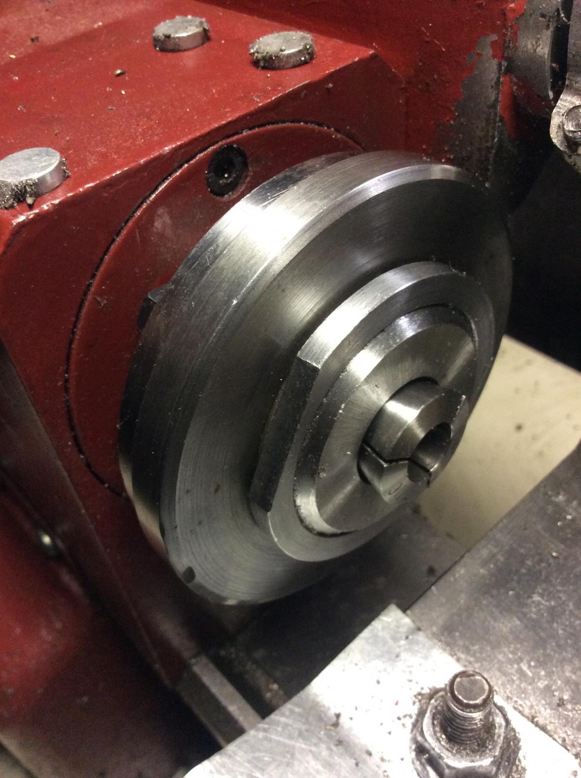

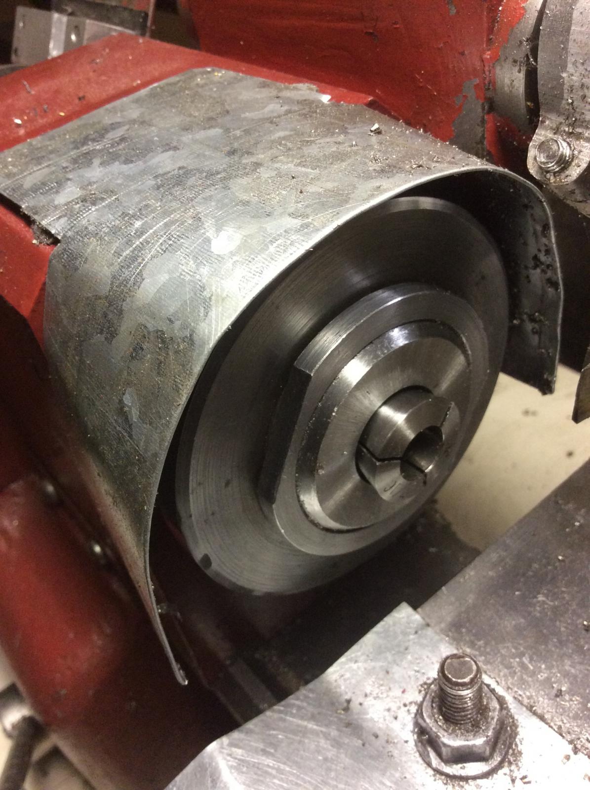

    These are less interesting, but still useful parts of it.
    The first picture is to show the sleeve with a couple flats that unscrews from the spindle guard to release the 3c adapter. I made it soon after the first time swapping from collets back to a regular chuck. I also figured out pretty quickly using it that I needed a splash guard, but didn’t spend as much time on that.

    Thank you for the pictures. They are most helpful.
