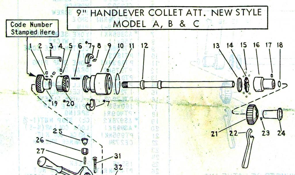

    I’ve only seen the oblique parts list drawings for the ball ones. I think this South Bend works that way.
    I wonder if along with modified thrust washers you could use a tapered roller bearing cup for the cam.

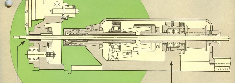

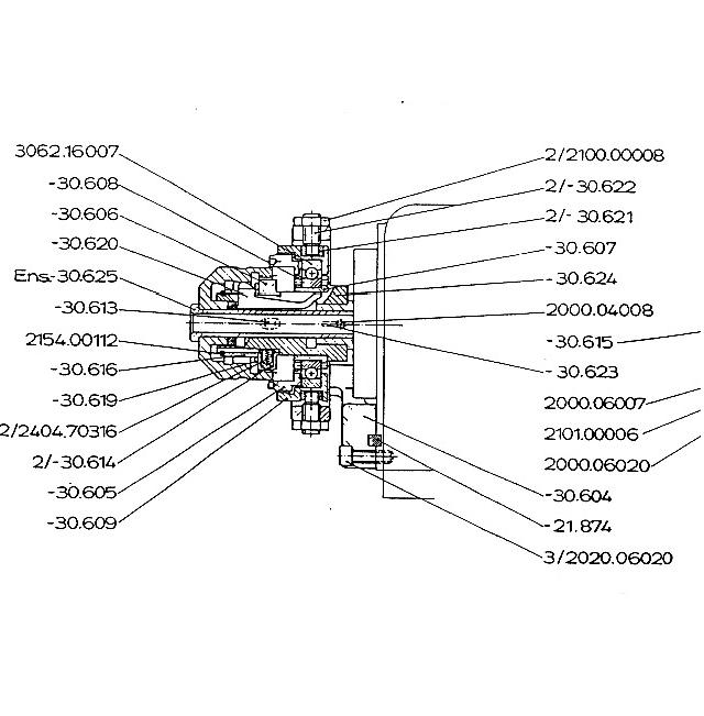

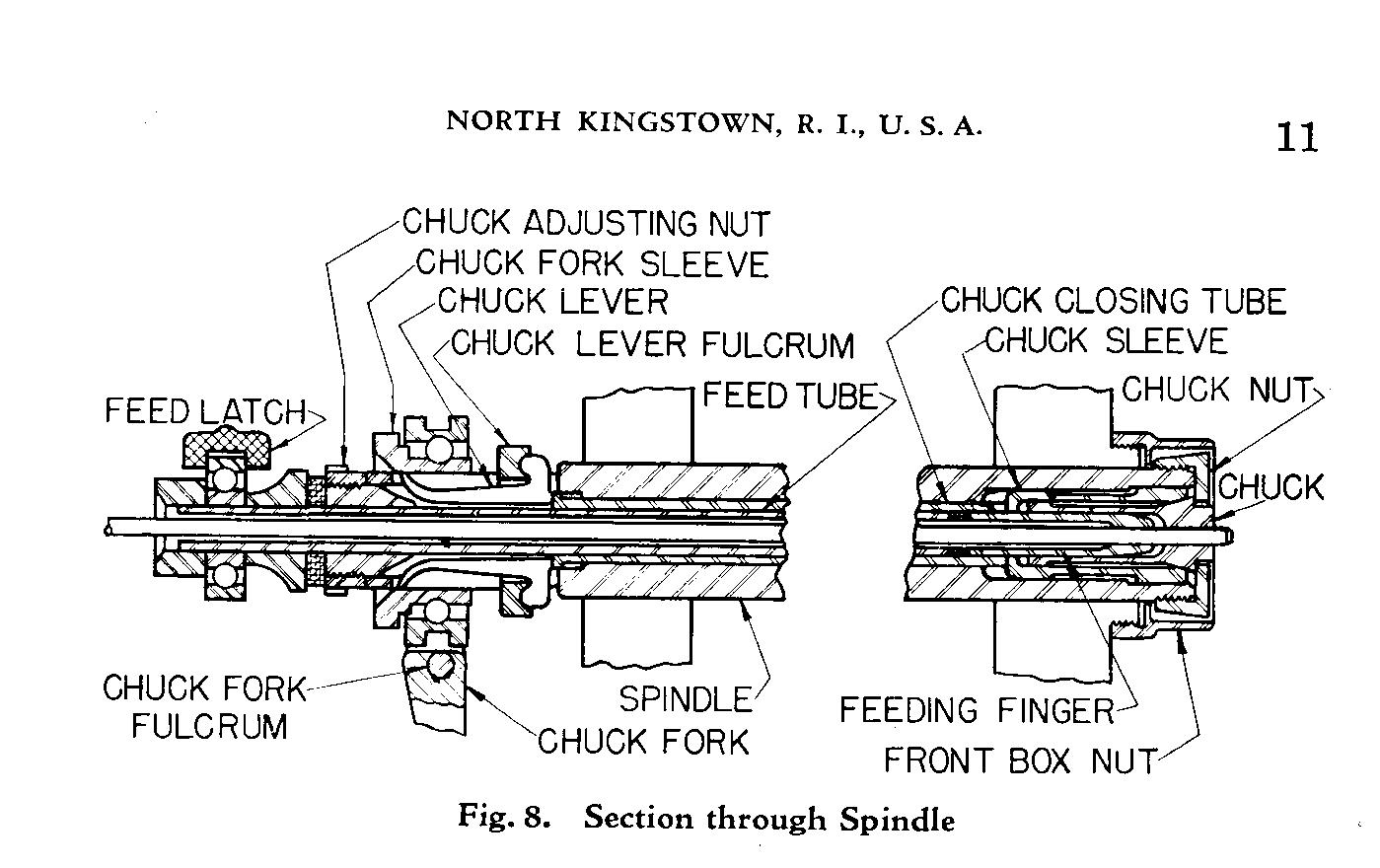

    Here are some of the two-finger designs I remembered - Brown & Sharpe, Gorton/Petermann, and Schaublin.

    This video about Kiyoshi Kato’s workshop that produces “Space man” pens has one of my favorite collet closer designs, first shown in operation about a minute in.

    Clark,
    Thanks for the schematic drawings. That will sure help me while I search and think things through.
