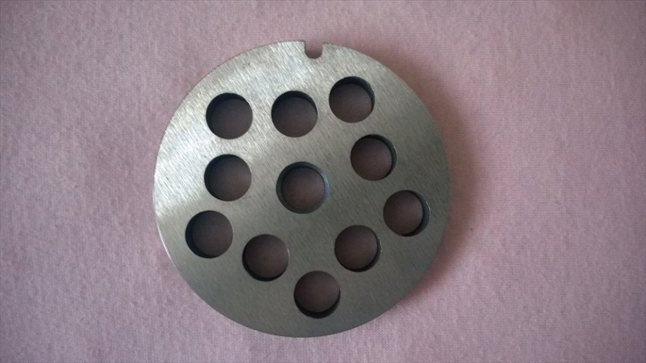

    The plate, through which meat is fed, has 13-18mm holes, so the cut bacon is not large 15x15x15 mm

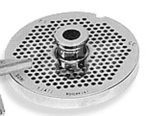

    Larger cut pieces of meat and biscuits give a specific look and sausages are more compact. The plate 3mm:
    We get another type of sausage:
