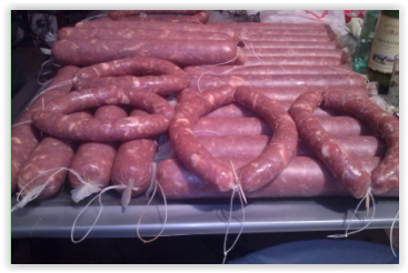

    Quote Originally Posted by KJ1I View Post
    Are you willing to share the recipe for the salami in the bottom photo?
    I'm not sure how good a Google Translator is.
    I mostly use blades for pigs because they are for me for another purpose. Naturally, the rest of the meat, or all the pieces that were excessive from the other, were used. Most importantly, these bits are not bloody meat. Later in the section of dry sausages can be noticed because they are bright red. The oldest red meat is ham and a little lighter than the blade.
    Every piece of meat must be cleaned of those tendons, opaque, veins and special care must be taken to remove all the fat because these fatty parts are grunty and never harden in the sausage.
    Small pieces remain as big as they are, and they are cut into strips to make it easier to mesh, especially if it is milled manually. I use a hammock with a diameter of 18mm and this proved to be the best combination. Of course it is important that the machine is well groomed, that it is properly assembled and that the knife and the shadow are well-knit.
    Now we're at the bunk. The best bun is from the door and then from the back of the pig. From this part even the soft part (skin and skin) is removed. I twist it into cubes of 15 x 15 x 15 mm (odontatively). It did not turn out to be good grinding because they got softer cobs. When the bouillon mixes with the meat, it is a golden tip to brush a little with lukewarm water to separate the cubes. Until I learned about it for hours I manually cut off the dice per dice. : Shame: You can bribe to put me up to 20% maximum, some put 30% but that's too much for me. This year I used only the neck bush and up to 10% on the total quantity. If they are unlucky there is a bait to lubricate. : Laughh:
    The taste remains. 2.5% salt, pepper, hot pepper, chilli, garlic juice, some sugar and sugar. How to know a good quantity? Simply make a small sandwich that you throw on the pan and after the baking you try. When the roast appetizer is a little bit slower and a little hammer is best for you to lose it all after drying. If you want stronger even though, you need to stop them.
    I leave the mixture for several days with at least one mix daily. Mesari claim it is unnecessary because it is meat in the intestines. As I said, it consists mainly of muscle, and after grinding you get a new pile of spoon that needs to be thrown because nobody is able to eat sausages and pull dry *****-squeezed teeth between teeth. And as I mix, I pull out those tiny nails. After each mixing, the mixture should be well pressed and smooth as if it was concrete, no holes should remain, and after mixing the smoothed mixture, it should be covered with white soy sauce and cotton cloth.
    Caliber is again a matter of taste and speed of drying. I always do a few pair of probes in the pharynx fi32mm. They are fast dry and for a third they jump, so they are really overweight and impractical to use. You cut a lot and you do not order. : Laughh:
    Serious calibrators start at 45mm which fit 700g of meat, 50mm goes 900g and 55mm 1100g. Of course weight depends on the meat and the way of filling. This 55mm if the meat of the work is 1500g.
    I have thrown all the cannons and similar inventions out and I use a grinding machine like a knife and a funnel hopper. The reason is the only way to get an airplane stuffed with no air.
    Charging to go fast and easy should be done by three people. One full meat in the machine, the other with one hand rotates the handle and holds the cobas to control the filling and the third binds and agrees to the finished sausage.
    The binding bush has to buy a big choice and all are good but it's better to use a little thicker to not cut the hose. Before filling, it is necessary to cut a larger number of hoses per couple of pieces. Do not skimp on the length and run at 40cm because you can tie a lot easier, count the weight fat and that it was quite clumsy. The best constrictor knot: laughh: but you wrap twice, tighten tighter and the most common double node is quite enough. When everything is over, if you are bothered by a slight excess, cut off with scissors. I do not regret it because I need to declare the product. : Laughh:
    Hoses should be placed in warm water just before filling but only a few pieces. I put 5 pieces when these 5 fills up, reading the book and dreaming about the product. : Laughh: If you put more hoses it will be too long in the water, so there may be cracking. When one is filled, it is best to hang it to hang to make the mixture more smooth and so leave one day to eject before smoking.
