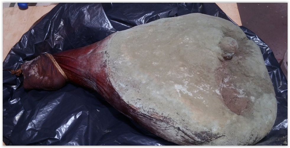

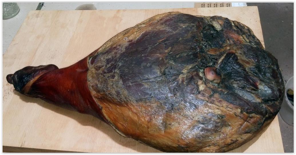

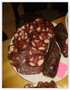

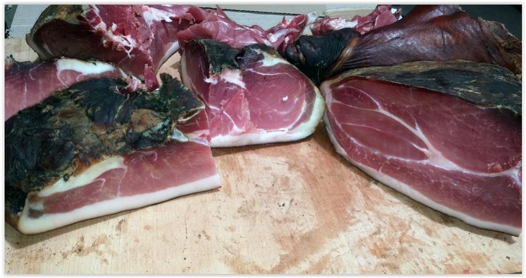

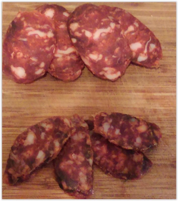

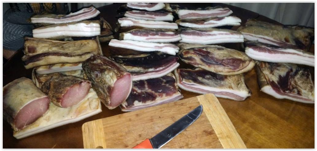

    After a few months depending on the type of meat it looks like this:

    Are you willing to share the recipe for the salami in the bottom photo?
