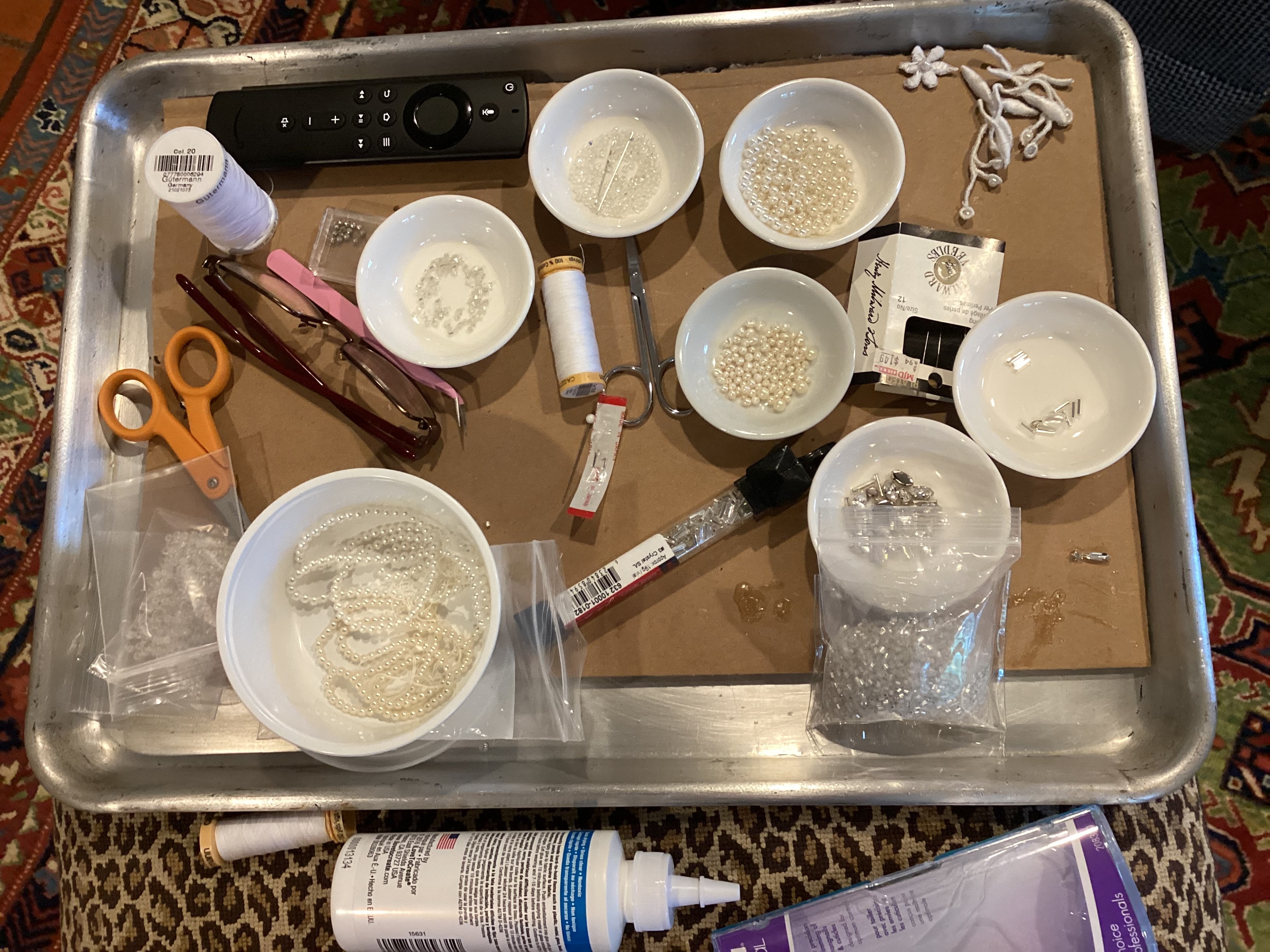

    This both brilliant and timely, Marv. My wife is in the middle of making a veil for our daughter’s wedding, and the den floor has a lot of escaped beads, pearls, etc. on my way to the shop now. Thanks!
