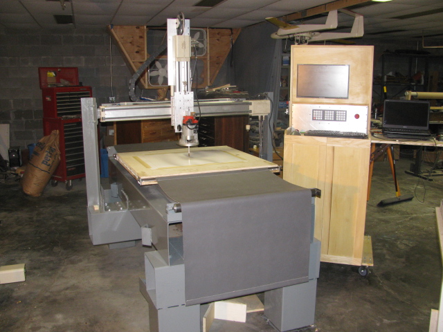

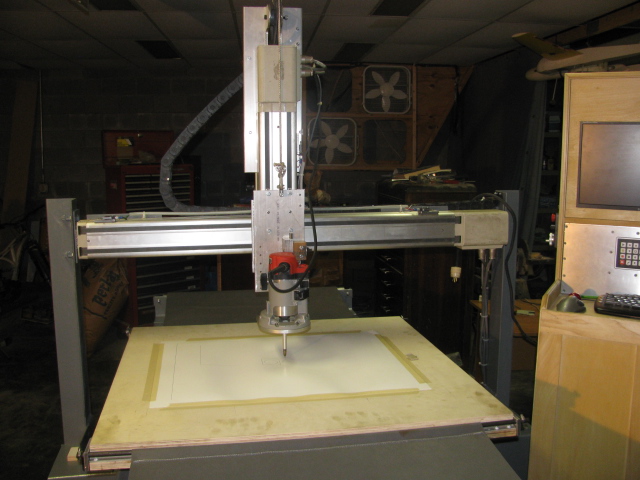

    Thanks everyone for your patience and kind words. I thought that I would post a couple of final pictures of the router and controls, now that it is finished, here they are, Bob.CNC router build from Adept robotic cartesian slides.-img_2384.jpgCNC router build from Adept robotic cartesian slides.-img_2385.jpg
