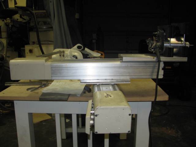

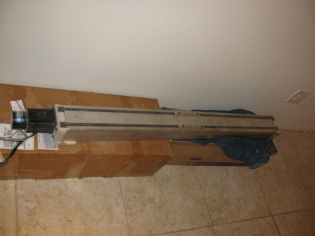

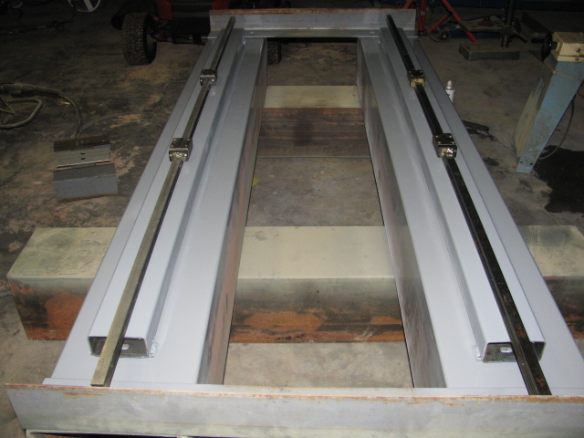

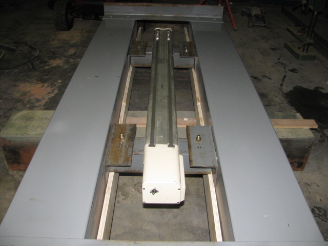

    CNC router build from Adept robotic cartesian slides.-img_2210.jpgAbout 5 years back, I started a cnc router build based on Adept robotic arms. I chose this route because the slides, ballscrews and servo motor are all installed in the assembly. I will use three of these slides for x,y,and z. Most of the components are already designed and ready to be installed and or welded. I bought 10 by 10 steel tubing as the base because I got a good price on it. Also the Adept slides are designed with quite a high ballscrew pitch, 20mm., so with that available speed of movement, I elected to build a rigid base. This build will take a while, even though I will be working on it everyday until finished, so I will add some meaningful comments and pictures as the build goes forward. Here are some pictures of the X axis slides and installation. This will be a fixed gantry type router and the table will move 19 inches plus and minus for a movement of 38 inches, both on the X and Y. I am primarily designing this router because I needed an X movement of at least 32 inches to build molds for my 1:32 model train molds. My mill would only traverse 28 inches. I added a pic. of one of the Adept slides. Bob.CNC router build from Adept robotic cartesian slides.-img_2206.jpgCNC router build from Adept robotic cartesian slides.-img_2205.jpgCNC router build from Adept robotic cartesian slides.-img_2208.jpgCNC router build from Adept robotic cartesian slides.-img_2209.jpg

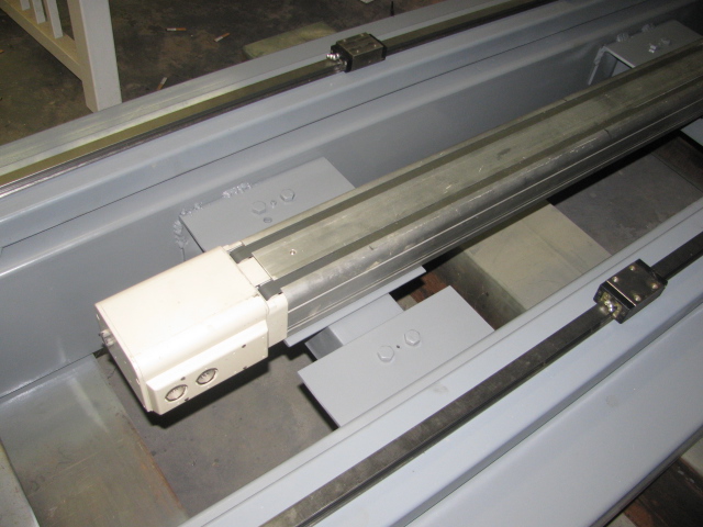

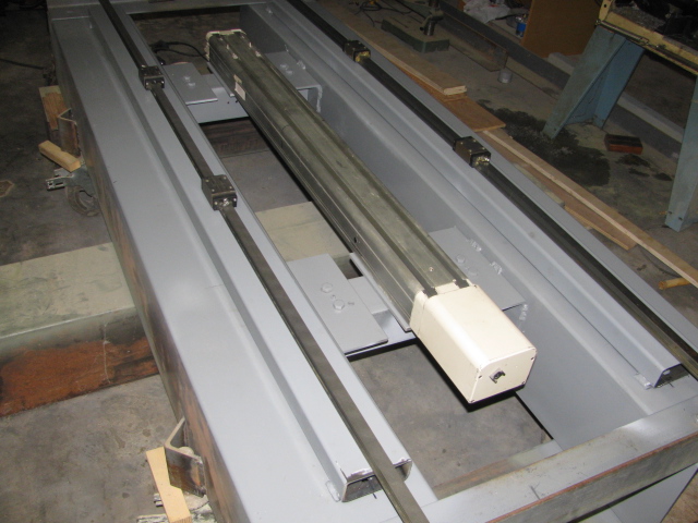

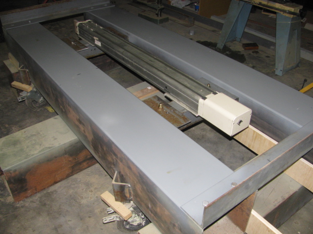

    Today I placed in position the X axis servo slide and tomorrow I will weld in place after doing some grinding for the welds. Bob.CNC router build from Adept robotic cartesian slides.-img_2211.jpgCNC router build from Adept robotic cartesian slides.-img_2212.jpg

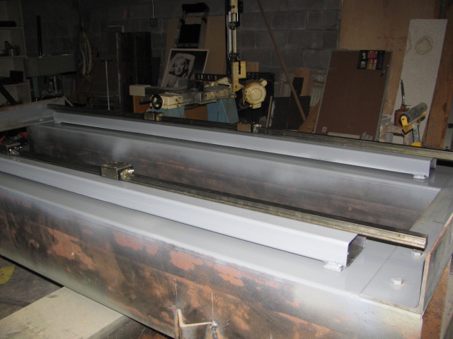

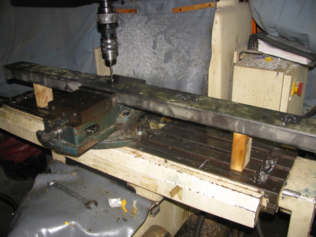

    Thank you kbalch a jere, I originally approached this router with the idea that because of the all in one slides it would be easier and I am already realizing that goal. It appears that it will go together pretty quickly. You won't see it until the end, but I am installing the X axis slide covers. They will be attached to the ends of the table and weighted on the other end. At the end of the base will be a roller and the cloth or rubber cover will wrap around the end, so it will cover everything and keep debris out. It should look very clean. I welded the X axis slide mounts and will be doing some painting and then mount it to stay. Next, I will be making a table for it, it will be 38 in. by 38 in. Here are some pics.CNC router build from Adept robotic cartesian slides.-img_2220.jpgCNC router build from Adept robotic cartesian slides.-img_2217.jpgCNC router build from Adept robotic cartesian slides.-img_2218.jpg Bob.

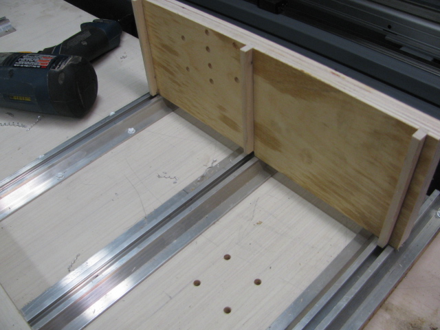

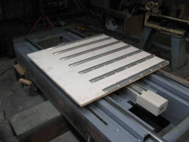

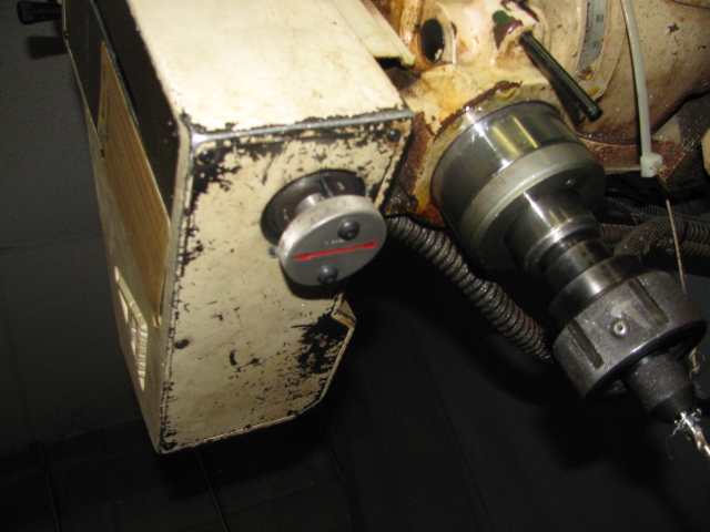

    Well, I had a little set back with my cnc mill. I originally thought the problem was electronic, but it was mechanical. The nut on the Z axis ballscrew had either backed off or was installed incorrectly from the start. I was getting erratic movements from the Z axis, so I took it apart and then I saw the split lock nut had backed off allowing movement between the quill and the ballscrew, I tightened up and it works as intended now. I also added a knob on the end of the ballscrew which allows me to manually operate the Z axis, very helpful. The cnc router has moved forward to the table. I have machined the hold-down attachments to the slides and added hold down extrusions. The plywood piece with splines are for spacing the hold down extrusions at six inches. Here are some pics. Bob.CNC router build from Adept robotic cartesian slides.-img_2221.jpgCNC router build from Adept robotic cartesian slides.-img_2224.jpgCNC router build from Adept robotic cartesian slides.-img_2225.jpg

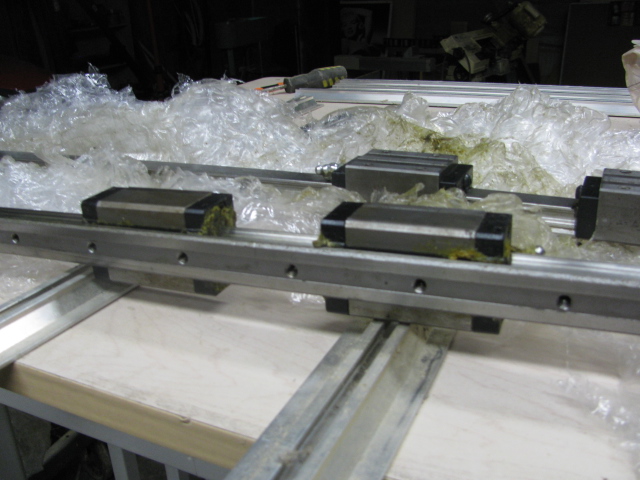

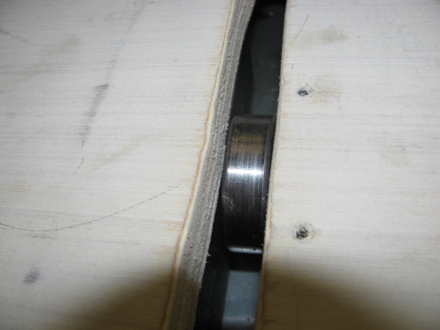

    CNC router build from Adept robotic cartesian slides.-img_2227.jpgHere is a video of the explanation of how I plan to attach the table to the servo. I wanted 0 backlash between the table and the servo, so I mounted a bearing on the servo and on the table is a slotted piece of angle, machined to fit tightly around the bearing. The other advantage of doing it this way is, If I want to remove the table for any reason, the table just lifts right off after removing the slide bolts. Bob.

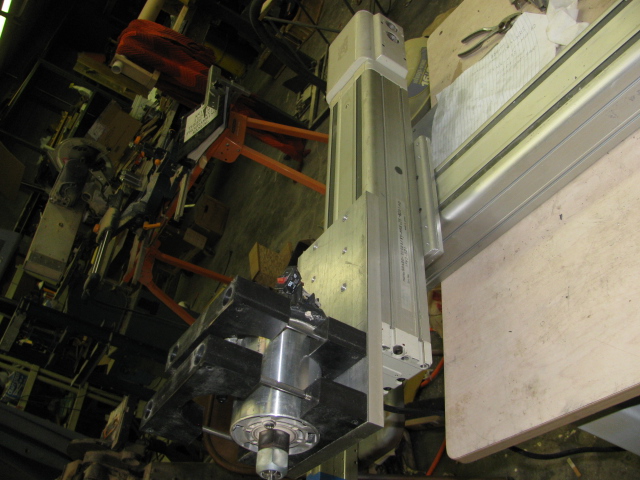

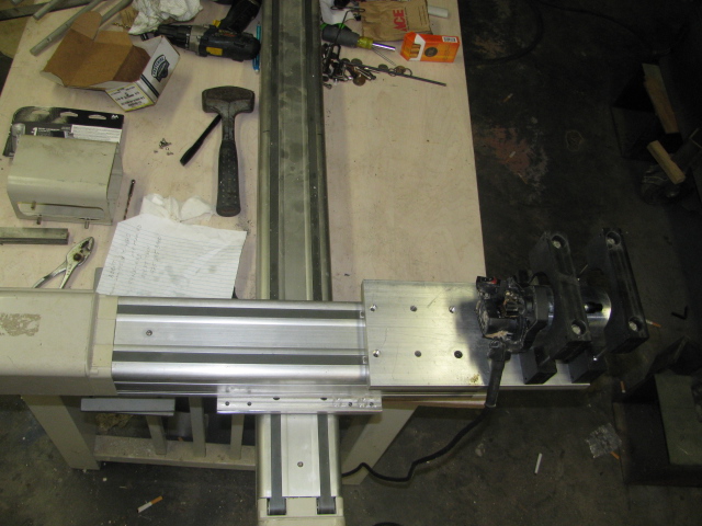

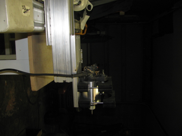

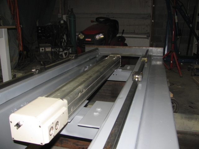

    CNC router build from Adept robotic cartesian slides.-img_2240.jpgCNC router build from Adept robotic cartesian slides.-img_2241.jpgCNC router build from Adept robotic cartesian slides.-img_2242.jpgCNC router build from Adept robotic cartesian slides.-img_2243.jpgWell, the table-x axis, is installed permanently. In order to achieve 0 backlash, the two pieces of angle were squeezed in opposite directions against the bearing and then epoxied and were screwed to the table. The next job was to figure out my design because it has been 5 or 6 years since I have started the project and with no drawings, I usually just build with short notes that are long gone, and then tried to figure out what the heck I was thinking. I finally figured it out. What threw me off was two pieces of large aluminum angles for mounting the Vertical slide-Z axis to the Y axis. I had not cut off the arm to make it a flat piece, instead of angle, five years ago. I guess that is where I stopped the project. Once I figured out that, the design came back to me. Also, I designed a pressure foot, and unlike most, this one stays down into the work. It is adjustable up and down and is fixed to the Z servo frame, so when I want to change a tool, all that I have to do is raise the router and change the tool, not having to move the pressure foot out of the way, we will see if that works. Tomorrow I will cut the angles and then size the height of the Y axis to determine the how high, and the position, of the fixed gantry. I found, on Ebay, another Adept 38 inch slide, brand new and I couldn't pass it up, cost me 400, not bad since they sold for thousands back in the day. The one I was going to use sounded a little rough, so this will be better. I don't know if I had mentioned it, but I needed two drives made by Granite, but they don't make these drives anymore, so I had to hunt all over the world to find them. I finally found two in the Czech republic and two in New Zealand, lucky for me, since my setup revolves around the Centipede parallel card that fits in my computer designed by KSI labs. This setup is obsolete now, they have come up with a system that goes right into your computer, circumventing the need for the Centipede card. Oh well, if this doesn't work out, I will go with the new system, it's only money. Next time, I should have the gantry and router installed. Here is what the Y and Z axis will look like. Bob.
