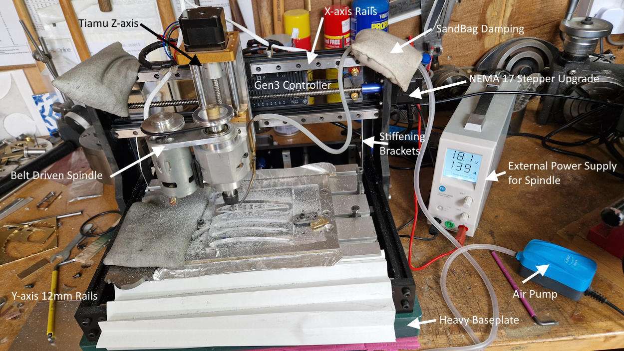

    Just been pulling together a list of all of the updates to my Genmitsu 3018-pro: Upgrades to a 3018-PRO - glue-it.com
    1. Spindle - angular contact bearings, belt drive and ER11 chuck that I have ground to a higher accuracy
    2. Z-axis - Tiamu aluminium frame and homemade spindle holder
    3. X-axis Rails - changed 10mm round rails to MGN12 linear rails
    4. Y-axis Beams - changed 10mm diameter to 12mm diameter and upgraded linear bearings (the balls in the bearings are now spherical!)
    5. Sand Bag Damping - simple and cheap way to add damping to any machine (also used in my large manual mill)
    6. Frame Stiffness - added brackets that triangulate the uprights
    7. X and Y Axis Stepper Upgrade - point of caution is that the controller has a limited current output and hence this might be the limiting factor
    8. Controller Upgrade - Finally I checked online and realised I was running an old original version of the controller. Upgrading to the GEN3 controller has made a significant improvement and no more jumping / missing steps on the X-axis.
    This Sainsmart Genmitsu 3018-pro or otherwise now known as Trigger's Broom works really well machining brass and aluminium, tasks it just could not achieve out of the box.
