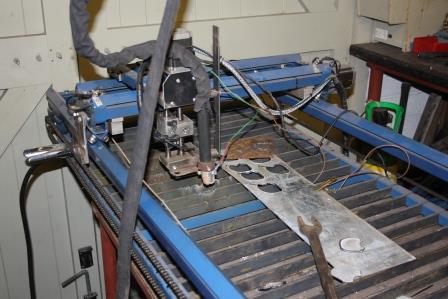

    I started work on this project as I had one specific thing in mind.
    I wanted to cut out a plate of a ploughman with horses and plough to put on my father’s grave.
    He had farmed for 89 years on the home farm in Cumbria Uk, the significance of the horse and plough was that in 1957 he was the world horse ploughing champion, he won again in 1958, lost to Canada in 1959 (which he said was a fix, apparently the award was given before all the competitors had finished and before their time was up). However he did win it back in 1960. So the seed was planted for a plasma cutter.
    Having built a 3D printer I decided that CNC was a piece of cake, I had a friend who works for a paint factory who provided me with some nice stepper motors and H bridge controllers and the rest just happened.
    The guts of the machine is a GRBL based controller (many thanks to those guys for their excellent work and their willingness to share it).
    The thing that makes my machine different is that I have used a cheap 50A HF start Plasma cutter and managed to overcome the High frequency noise affecting the electronics by controlling the plasma unit by means of fibre optic.
    The HF start was converted to Pilot ark by grounding the electrode for 0.5 seconds to strike the ark, I used a very nice motorcycle starter motor to switch the contact which is capable of handling 600A for 10 seconds.
    It is my intention to publish all of my drawings and work for this project in due course.
    There is still some work to do, calibration, dispelling gremlins etc.

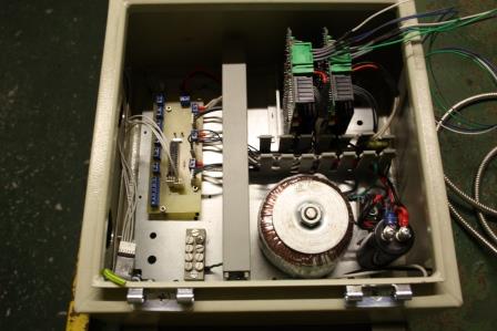

    I thought i had better add some more pictures to wet the appetite, i'm still formulating the the build instructions and getting all the drawings together. I have realised that i will have to put the printed circuit board layouts onto pdf as the software i use (Proteus)
    does not seem to transfer files well to other vendors software, I will however be producing the Gerber files which should be transferable. The mechanical files will be in DWG format.
    My Electronics have been built into a IP67 Enclosure
    The power supply is producing a regulated 48vdc for the stepper drivers and motors, as these are industrial beasts and paired, i didn't see much point in changing anything. Having read numerous posts on stepper drives it looks like makers like us need to look more closely at the voltage and amperage of our motors and using the right sized stepper drives to suit our needs. Stepper motors are quite forgiving and will work on voltages higher and lower than those specified Its then up to the stepper drivers to handle the correct amount of current. The actual load/torque required for driving an X,Y,Z table isn't actually that high. The Nema 17 12v motors are just as capable of driving a table as those i have used. hell there is some grotesque 3D printer builds out there which manage to build some reasonable stuff. Always remember, trial and error is a well practice method of engineering. The bouncing bomb may have been mathematically and scientifically designed but the targeting came about by accident using a home made sextant and trilling the drop height until it was perfect, victory was built on such precise guess work. My ideology is don't waste money, try not to spend money, recycle every thing possible and leave the maths and science to the boffins-whilst they are talking about it i'm building it. I saved my last employer a fortune in his Petroleum R&D company.

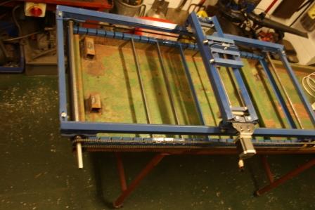

    The Plasma table start with the bedways/axis, you need to decide how big you want to make this thing. making a cutting area larger than an 8 ft x 4 ft sheet of steel is probably pointless for DIYers, then you have got cranes/hoists etc to get the plate onto the machine etc. I aimed for 3ft x 3ft and failed miserably OK one way but the Y axis i limited myself by recycling the lead screw.
    I will use the table i have built for now until i grow out of it.

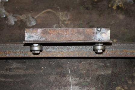

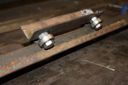

    slides for axis.
    I found a few pictures of various designs of slides on this very site. some required a plasma cutter to cut out various shapes - hello, i haven't built the thing yet. So following my non scientific farmer son approach i went for a simple design.
    I ran the slides on a 1" steel angle, up to 4ft this should be reasonable strong and take the weight of the Y axis carriage. if your intention was to build a larger machine then i would consider using 1 1/2" or 2" angle.
    due to the expense of acme threaded worm screws and all the hardware required to hook them up, i opted for a chain drive which works perfectly. I had the added advantage of having a right angled 10:1 ratio gearbox, to be fair i used it to reduce the profile of the machine rather than needing the extra torque for the X carriage. The right angled gear box gave me the advantage of attaching the motor along the side of the frame instead of it sticking out at 90 degrees.
    Well i hope this is enough of a taster to get you hooked
    more to follow
    Jason.

    There has been a couple of guys who have already enquired about eliminating HF noise so i will quickly let those guys know how i reduced the noise to a sufficient level for the machine to operate.
    DO NOT USE LAPTOPS
    umm not totally true just try using and older lead brick one, windows 98 ilk.
    unfortunately the software may dictate something that requires windows 7. If you choose win8 or Win10 then you are taking your life in your own hands. nobody uses such pants.
    Many new laptops are susceptible to RFI noise, they are designed to handle it internally but when it comes to plugging USB peripherals in their stability goes to pot. For some reason laptops from around the Vista OS era and before seem to be more noise immune. If any one would like to add to this reasoning it would be much appreciated
    Mains/power filtering
    The laptop power supply is best fed through a mains EMI/RFI filter
    http://www.ebay.co.uk/itm/2-stage-Ma...oAAOSw4q9XTyuh
    There are various types ie. how they are installed and what power rating you require.
    this type requires a little electrical know how and the ability to insulate the electrical connections. They are good at removing surges and transient noise.
    Stepper Motor Electronics/Drivers
    always try to get opto isolated inputs or if you are building your own electronics build it in to your design, that way you can create a barrier between your control electronics and your stepper motor/drivers.
    This type of driver are ideal as they provide the level protection needed
    http://www.ebay.co.uk/itm/CNC-Single...kAAOxyBvZTWWD7
    If possible don't run the motors and the control electronics from the same power supply, again this will create a physical barrier.
    Always keep in mind the motors are made up of huge coils of wire - the best aerial in the world.
    Earthing.
    Earth every thing, table, carriages, PC, bench. each metal surface should be individually wired back to an earth rod stuck int ground. the earth rod is only for plasma cutter DO NOT use any mains supply earth point, you will effectively take away the ground protection from you home/workshop supply - this will lead to injury and death. Do NOT do it.
    I will try and post the guys forum post from hypertherm who gave excellent advice on the best practice of earthing.
    Screening
    Screen all signal and motor cable or use screened cables, i found i needed to externally screen using a braided sleeving.
    add EMI filters to you signal, motor and USB cables. USB especially, i ended up having to use a USB opto isolator (at 40 bucks was probably the most expensive part of the machine).
    The braided sleeving should also be wired back to your earth rod, don't forget to screen the electrode cable with the braid and earth it. Do not do the earth clamp cable, Idiot. that causes a whole heap of mental pain. It effectively makes an ionic earth path through the atmosphere. Its that old Kirchoff law of dividing current in circuits, it produces very poor plasma ark's anyways.
    Fit 10uF capacitors across the End Stop/limit switch inputs on the pcb (Neg pin to Gnd, + on signal - my electronics are designed so that the micro switch grounds the signal line when triggered).
    Mouse and keyboards
    well that's a bowl of contention right there, they suck up noise like no tomorrow. most users are simply moving the PC away from the vicinity of the table. just don't rule it out as a likely source of noise if your program/PC keeps crashing.
    The Plasma Cutter,
    run the power cable away from the table as best you can, try not to use extension cords as these with only 1 wrap on the real are fantastic noise makers/inductors.
    run your plasma cutter and PC from separate wall outlets.
    the ark gap inside the plasma cutter/machine can be a huge source of noise. This is not for the faint hearted however some builders have reported on the web that setting the correct air gap can reduce some of the noise. I am not going to advocate it here, you will need to do your own research and decide if its something your are going to attempt and are capable of.
    in any case never remove the cover unless you are aware you are voiding your warranty and you have the plug held in both hands, if its in your hand its impossible for it to be in the wall at the same time.
    Last but not least i had to switch off hardware limits option in my Grbl firmware and use software limits instead.
    the only disadvantage is that i cant home the bed automatically i have to point it at the position i want it to start at and zero the axis there. the mechanical stops are still wired and will stop the machine if it tries to make a run for it out of the door.
    more will become clearer as i get my backside into gear and produce the documentation for my table.
