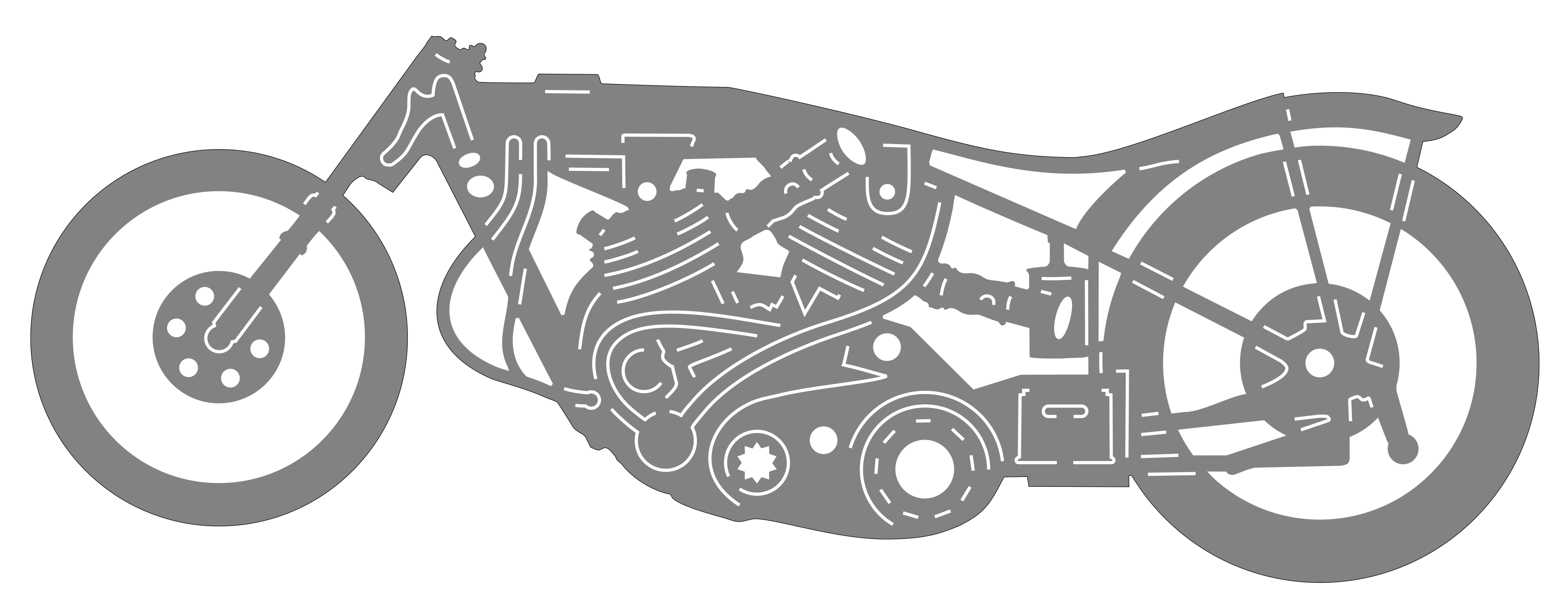

    I personally have used CorelDraw for a number of years. It has the ability to auto-trace photos and other bitmaps. It allows you to draw lines of any desired thickness quickly around any contour, and then fine-tune them in seconds to fit precisely. It allows you to easily maintain a given amount of space between lines and shapes (about .150" or 3.8mm for plasma). It also has the ability to let you automatically color lines and fill shapes to give you a near perfect idea of what your cut piece will look like.

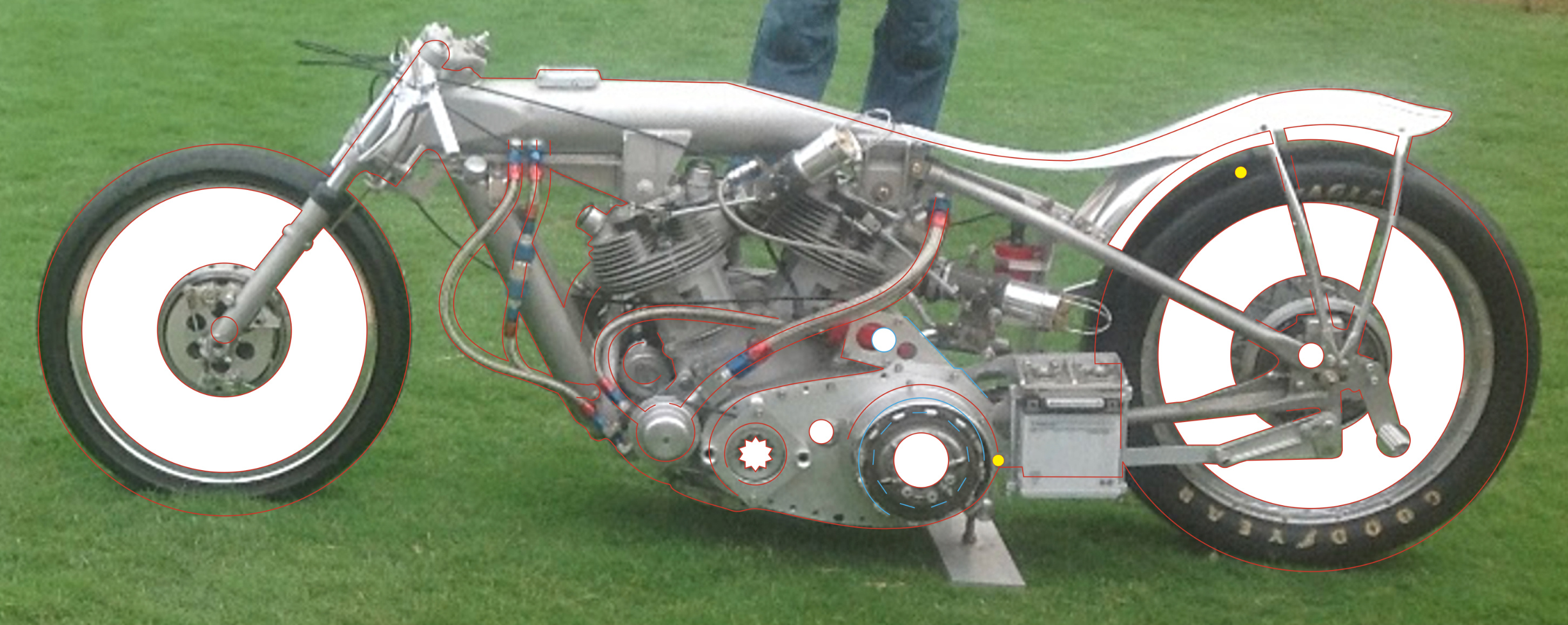

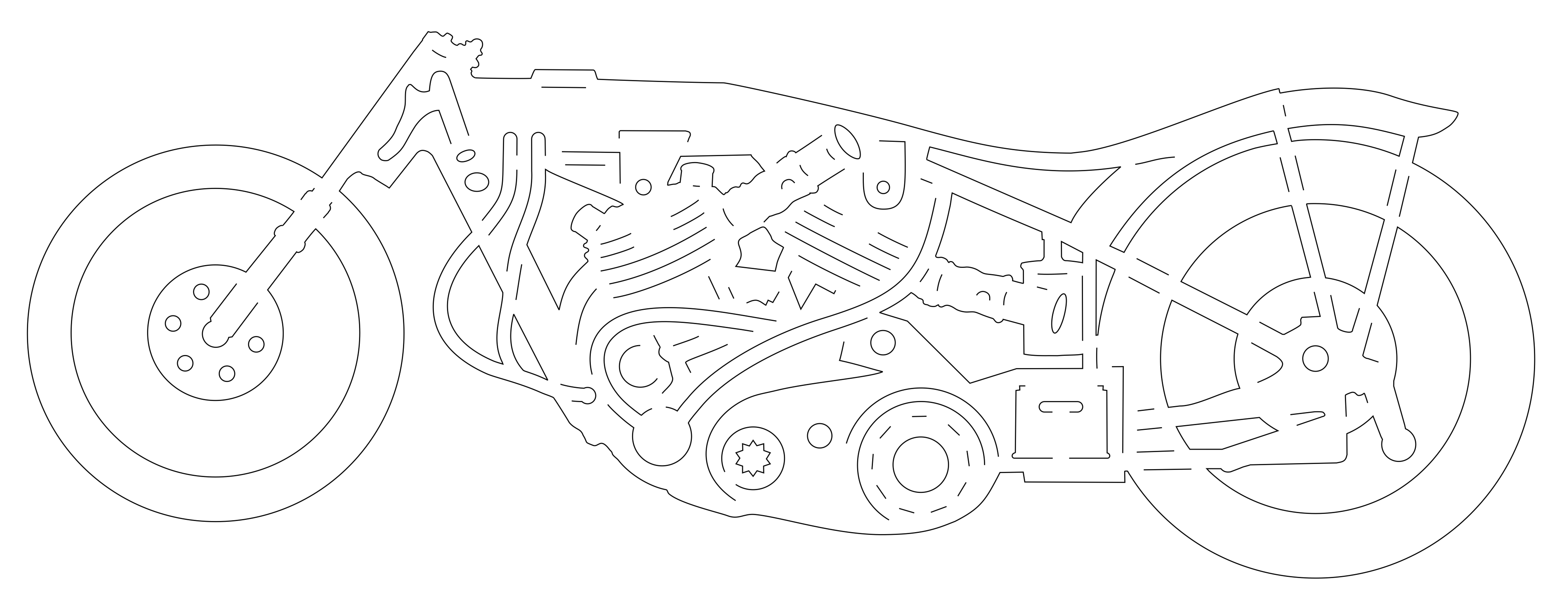

    The following photos show a fairly complicated drawing created by manually tracing over a photograph. Note the small yellow colored circle which is exactly the right diameter to assure the proper clearance between objects. Lines and internal shapes must be shifted slightly from their photo counterparts to obtain the clearances. The thinnest eternal shape that can be satisfactorily cut is around .150" while slots and internal shapes can be slightly thinner.
    When I have completed the drawing in CorelDraw, I export it as a dxf file, which can then be imported into my CNC software. The CNC software (FlashcutCNC) converts the dxf file into G Code, which the computer understands. It also arranges the cut order, inserts lead-ins and lead-outs, compensates for the kerf (gap) created by the torch, and determines the direction of torch travel. Your CNC software should be capable of doing these chores, as well.

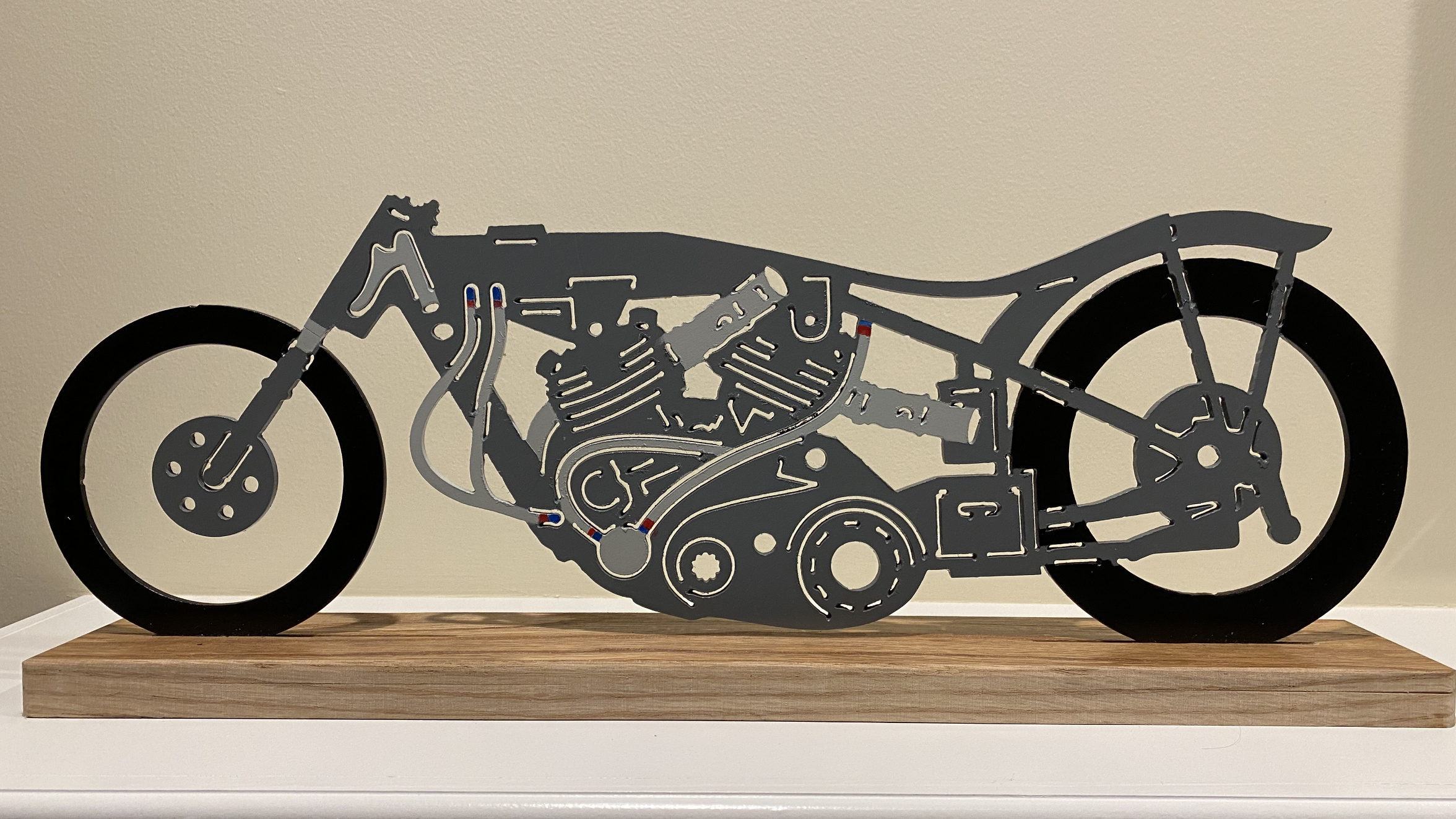

    The first photo shows a photo with lines and shapes partially drawn over it. The second photo shows the finished outline. The third photo shows the CorelDraw drawing with fill applied to provide a preview of what the finished piece will look like. The fourth photo is the finished shape.

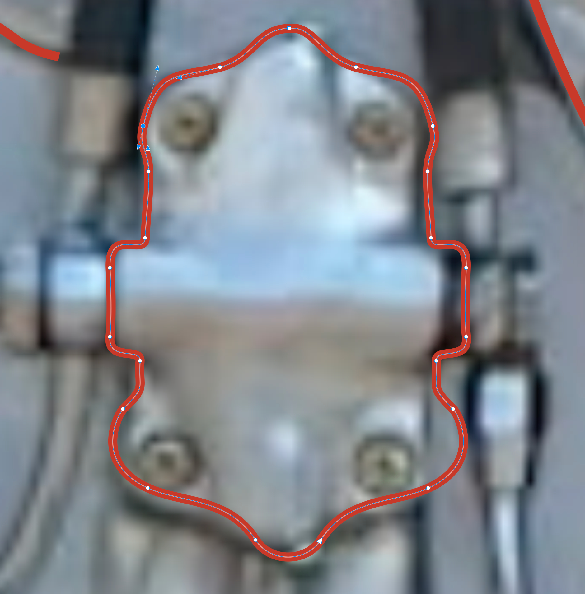

    What software are using to edit the lines? Will it let you move nodes around as shown in this screen shot? Click on thumbnail.

    Quote Originally Posted by tmate3 View Post
Name:	Node editiing screen shot.jpg
    I am using CorelDraw. You can create, delete, and move the nodes around. You can also highlight a group of nodes and duplicate only that section of the drawing.
    What I have done here is draw one side of the shape, duplicate it, mirror the duplicate and connect it to the existing side. This gives me a shape that is perfectly symmetrical on both sides.
    The nodes have little "handles" on them that let you manipulate the contour of the line between them. When you draw a line, you only need the two end nodes to shape it as desired. Click on thumbnail below:

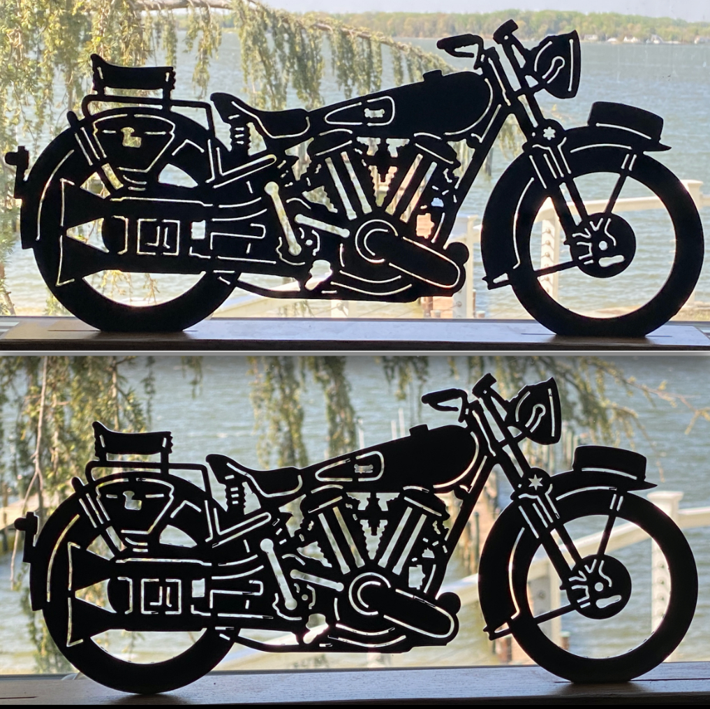

    In case there is any interest, here is the same motorcycle shape cut out with plasma and with laser for comparison purposes. The laser cut shape is 6" x 12" and the plasma version is 9 1/2" x 19". In the laser-cut piece, the lines were cut as narrow slots so they would show up.
    The narrower kerf of the laser is apparent in the little star shape in the front forks. The plasma-cut piece, having lines rather than narrow slots, has visible pierce points. The material thickness is the same for both.
    Just an interesting comparison of both processes on a moderately complex shape. The plasma version was cut on my little 2' x 2' home-made table. The laser version was cut on a high-end laser equipped cutting table costing several hundred thousand dollars.
