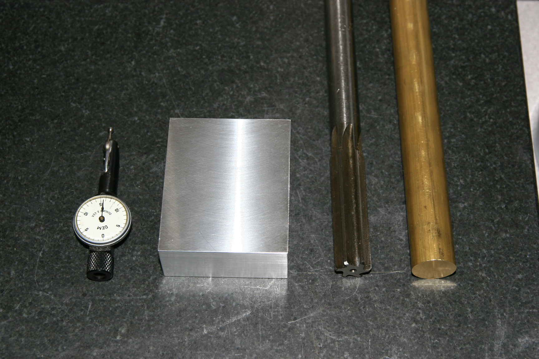

    Making one fixture creates the need for another tool for the shop.
    In the past I would just use a feeler gage to set my tool bit height on the CNC or Mill.
    Well for engraving with the tiny carbide cutters I needed a safer way to plunge the tool to the surface of the work.
    Many are available and are priced from $330.00 to $14.00 (14 bucks was a rough plastic with cheap dial indicator (import of course).
    I had a nice GEM dial test indicator and that seemed like a good fit for this project.
    No indicators were harmed in the creation of this tool!
    The indicator may be removed and used as originally intended.
    This is a real easy build. I started by cleaning up the block of aluminum for the base.
    The base is 1" thick and was to be 2" by 2" square. However I really hate to throw away aluminum or any other material.
    Since my blank was 2.75" by 2.2" I just cleaned it up and squared it up on the mill.
    It ended up 2.146" by 2.631" and .975 thick.

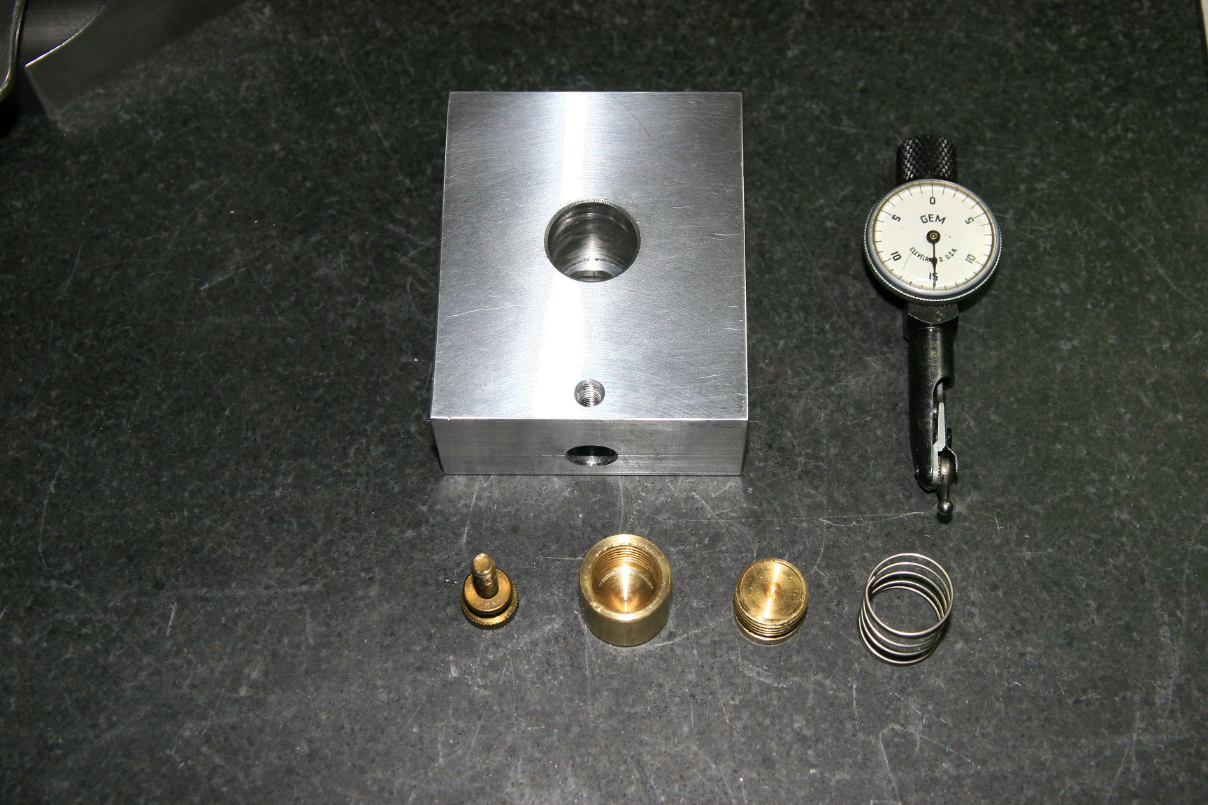

    A piece of 5/8" brass was drilled and threaded 1/2-20". A brass plug was threaded 1/2-20. This is the zero adjustment.
    The base has a 5/8 hole reamed which is used to house the zeroing/measuring plunger.
    The plunger has a 5/8" (just under) spring to hold the plunger up.
    The indicator is mounted with a .332 (letter Q) drill bit. That hole intersects the 5/8" hole for the plunger.
    Only tricky part was getting the indicator in the hole!. While the diameter of the shank of the indicator is .328 there is
    a wider part at the lever end where the rivet protrudes. So I had to mill a slot from the bottom side so the indicator could be installed.
    Trickey part #2 is orienting the lever between the spring coils so the coils do not get deflected by the spring. No problem,
    just compress the spring one coil space and it is 100% out of the way.

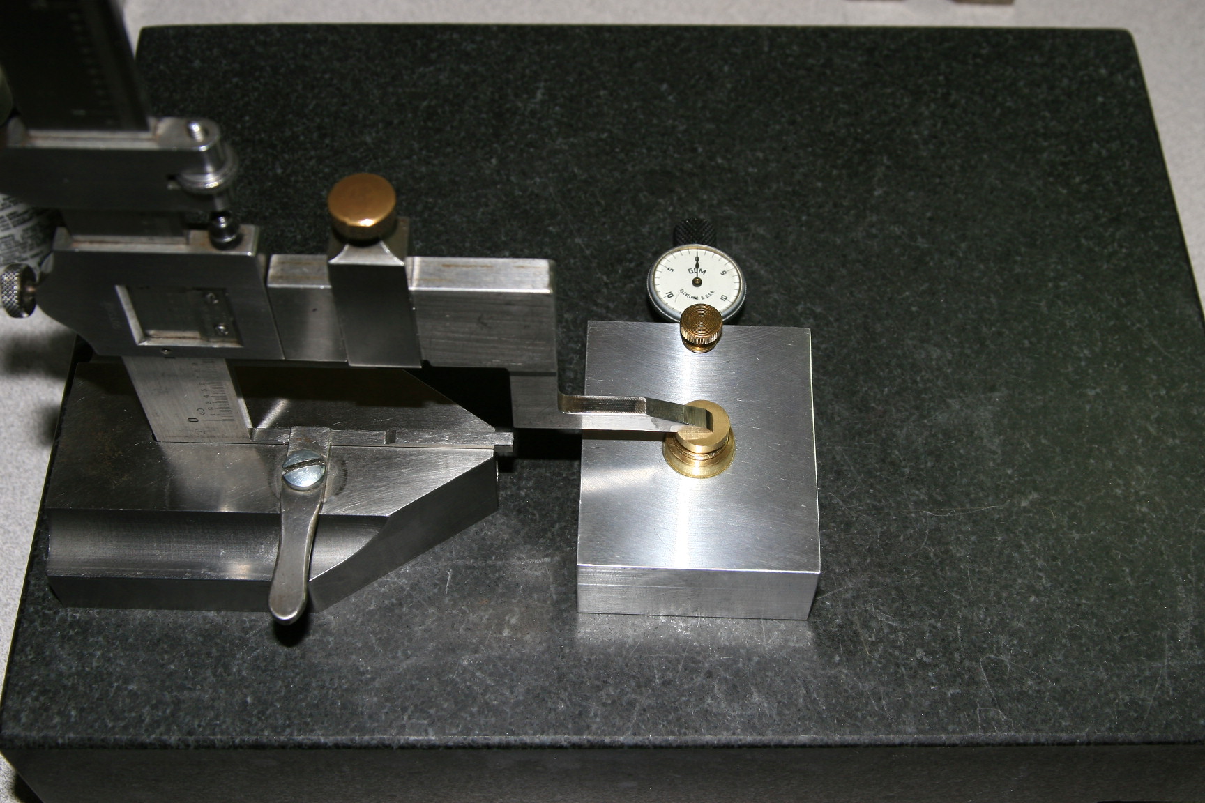

    Set it up using the height gage and put a small amount of blue loctite to keep the plunger set.
    Works like a champ at a cost of a small piece of brass, small chunk of aluminum,one spring, and one thumb screw.

    Hi Tony, I also considered electrical. Mechanical won out since I can run the height over or under as read by the indicator.
    I guess an electrical could also be settable using a calibrated screw/micrometer arrangement.

    jjr2001's Z height check is still a winning design. I finally supplied my self with a proper 6" height gauge that gets under milling heads, but a constant Z is far easier to use. A conventional height gauge, if compact enough, gets into play on castings, where a starting place is not so clear, and then establish other features.
    And we're not quite CNC'ing yet.
