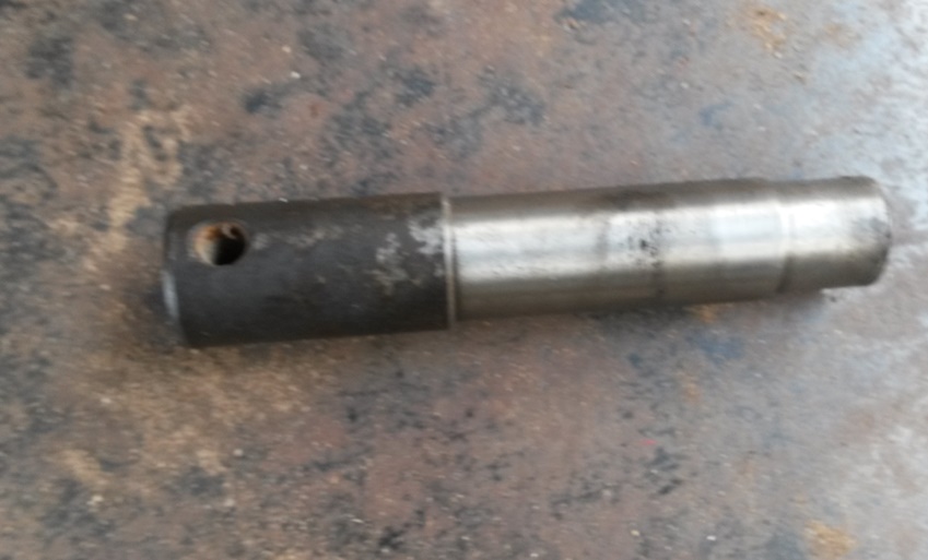

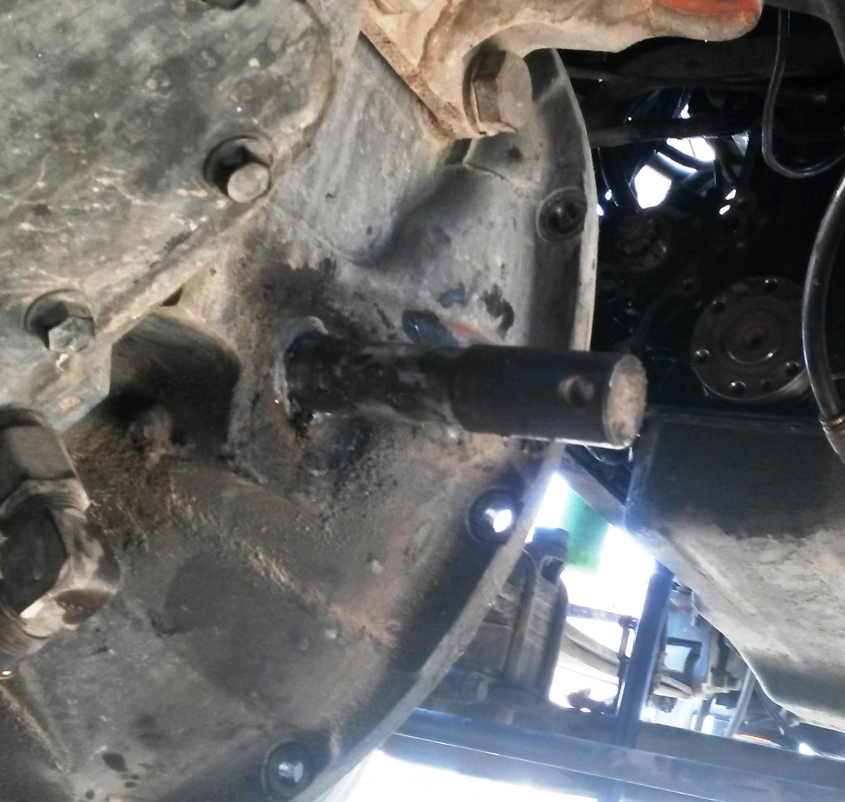

    Just a simple tool machined to .015 smaller than the OD of the clutch cross shaft bushings with a pilot .005" smaller than the bore
