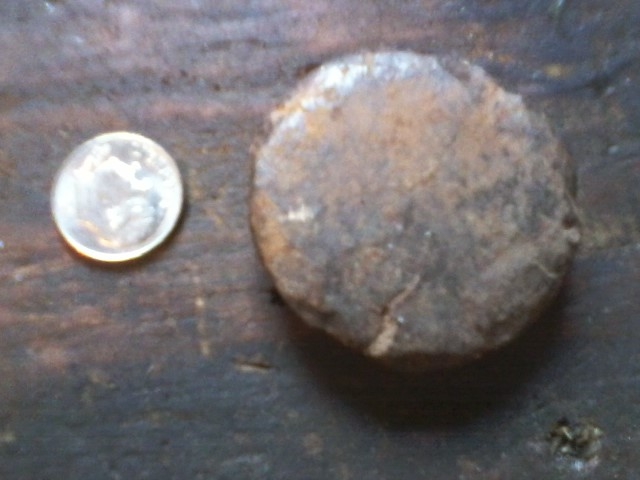

    Decided it was time to clean up some mushrooms on the ends of a couple of prybars. I was going to simply grind them down but then I thought why not use my new portable bandsaw and take advantage of the new stand I made and just cut them off.
    http://www.homemadetools.net/homemad...andsaw-stand-7
    This is a photo of the first mushroom cap cut off

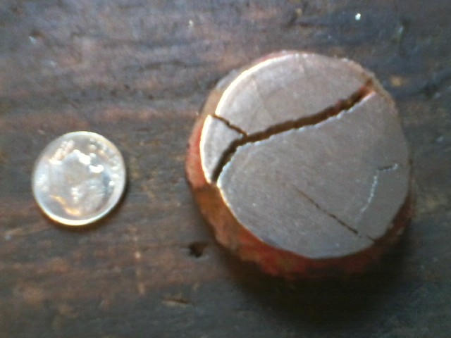

    The bottom side of the cut

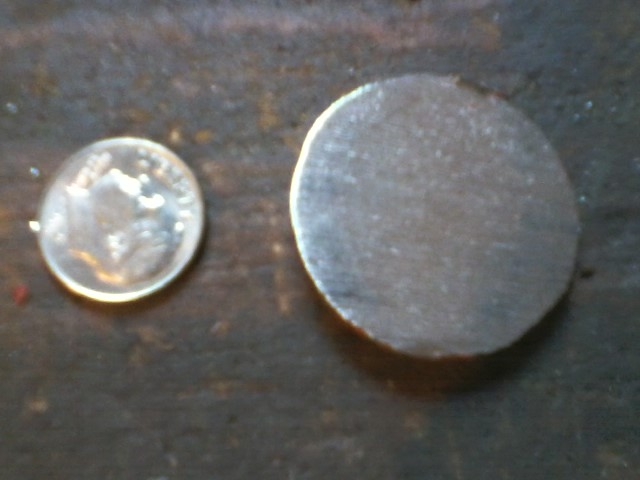

    Then I went after the second mushroom cap and cut it off
    The bottom side of the cut ,,,,YIKES!

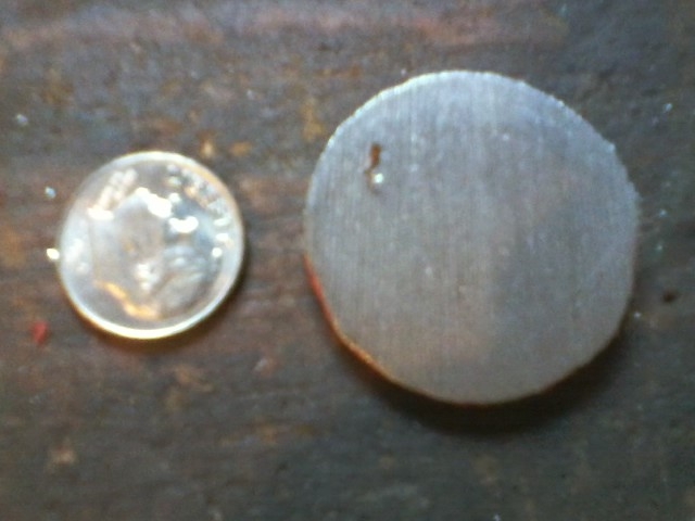

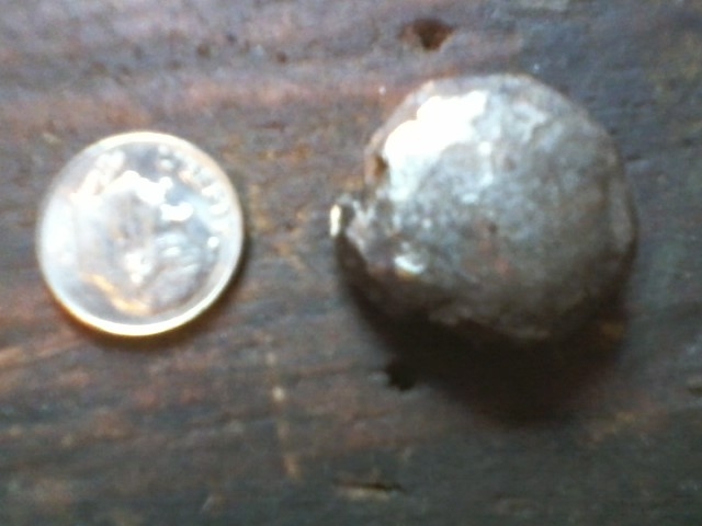

    That crack was a big mess so I took off another slice which just broke apart during the cut

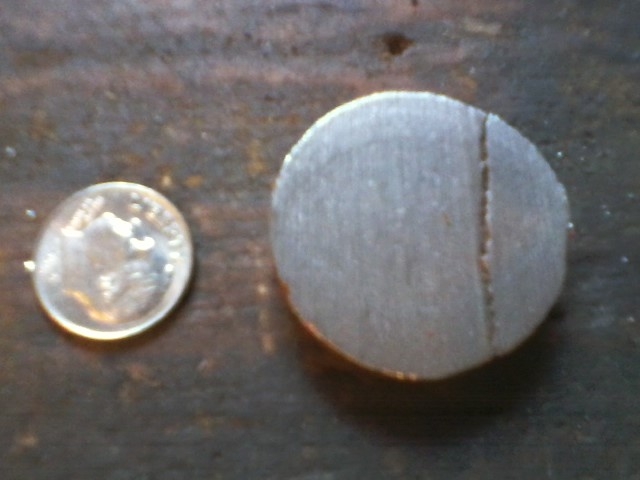

    I wanted to get to the bottom of this so I took off another slice

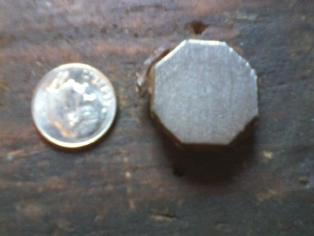

    ...and another

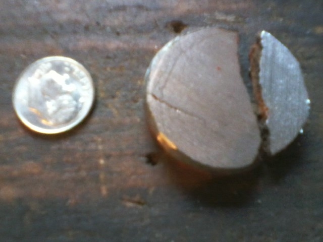

    ..and one more to be sure

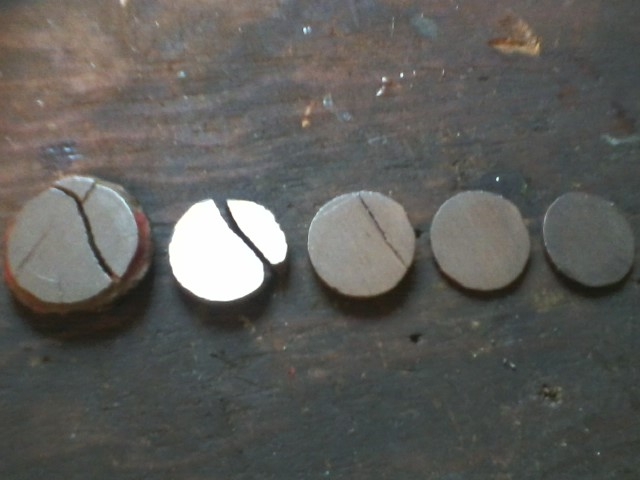

    Finally, no more cracks. But it was an interesting lesson and I'm glad I decided to cut off the caps instead of grinding them down.
    Here's a summary comparison
  2. The Following User Says Thank You to J_P For This Useful Post:
    Toolmaker51 (Jul 16, 2017)
    5,338
    7,048
    That is quite revealing. It wouldn't surprise a metallurgist, but few of us think of fatigue at a microscopic level - let alone visually. Grinding or sanding definitely hides many irregularities; samples are lapped and polished before examination.
