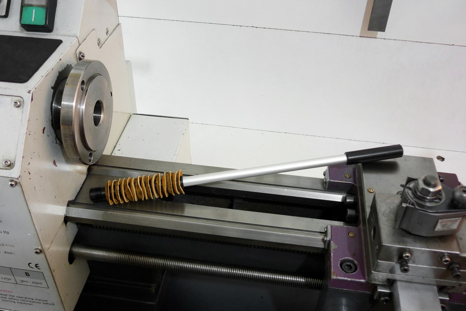

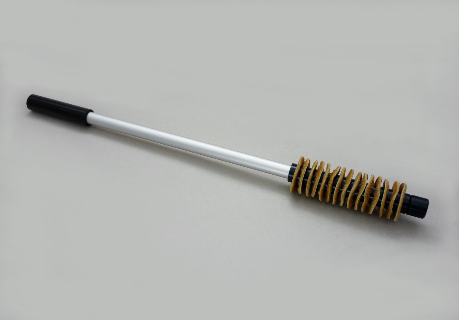

    The cleaning tool for the spindle bore is a tool I've copied from Toolsandmods. It’s simple and efficient; as I’m thinking it now, I should have made it long time ago instead of using paper towels or rags for cleaning the spindle.
    Now, what I have made is practically the same with the one from toolsandmods; the only that is different is that instead using fabric for making the cleaning discs, I used soft leather (approximate thickness 1.3mm).
    In toolsandmods it’s stated that the discs were made from windows cleaning cloth with a diameter of 28mm; now, since I decided to use leather I had to cut the discs into a smaller diameter (leather is definitely harder than window cleaning cloth) for an easy push or pull action of the tool inside the MT3 spindle of my mini lathe.
    I found (based on the thickness-hardness of the leather I had) that the right diameter for the discs had to be 26.5mm.

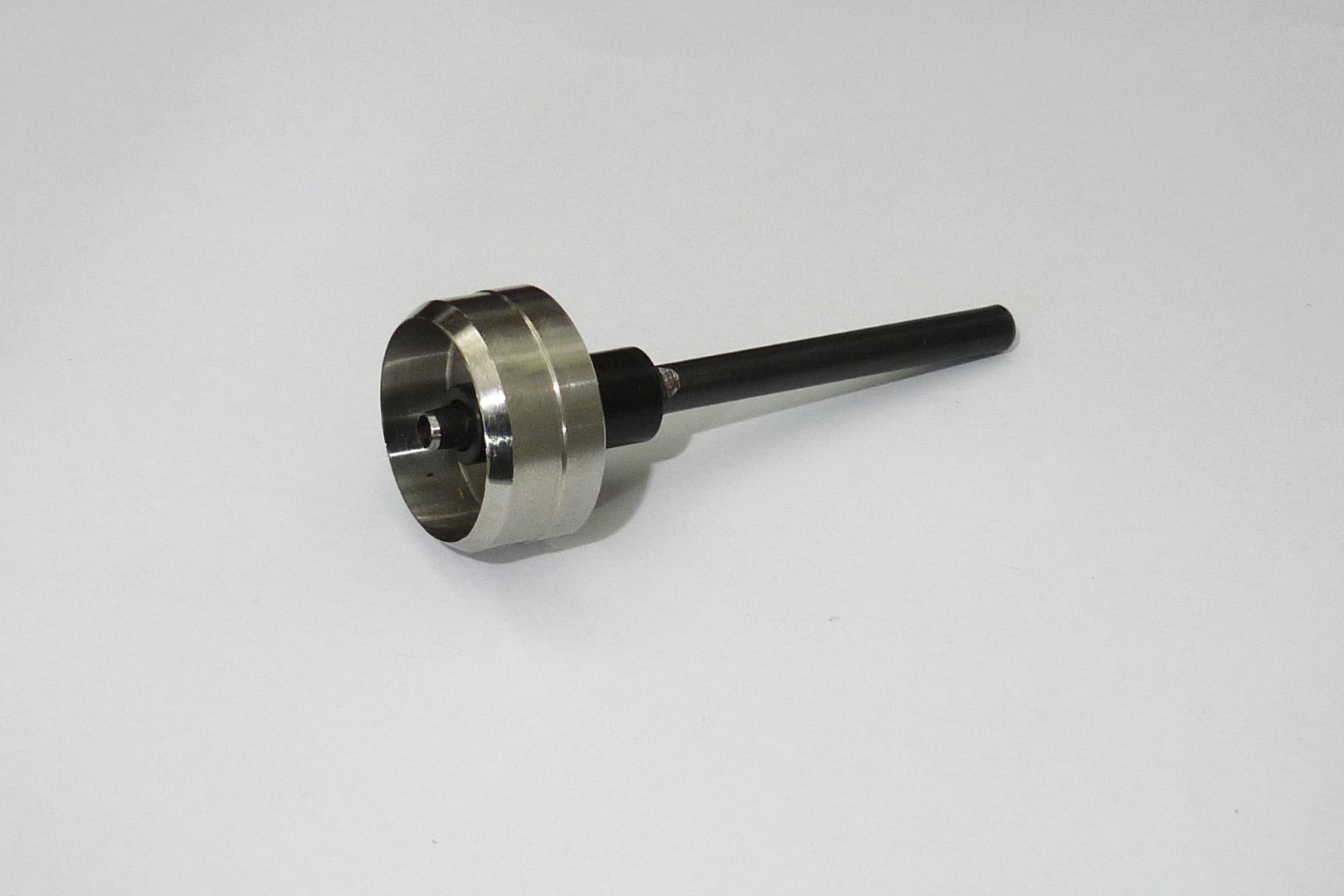

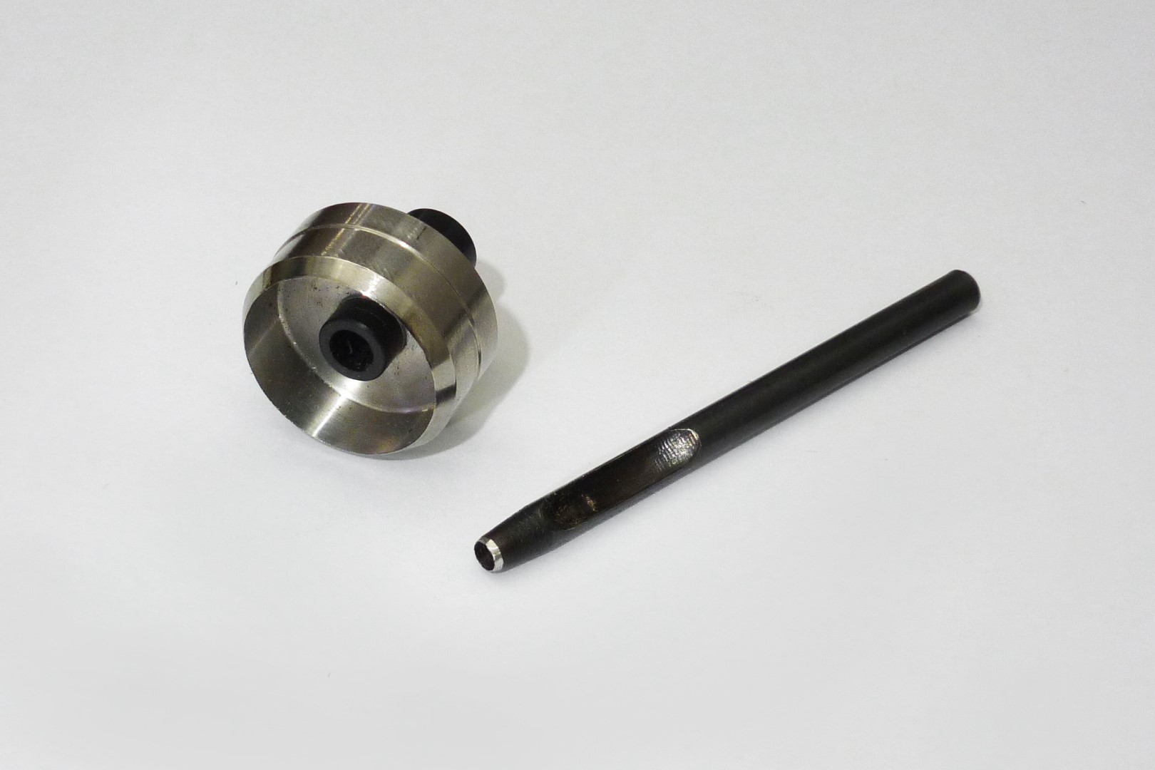

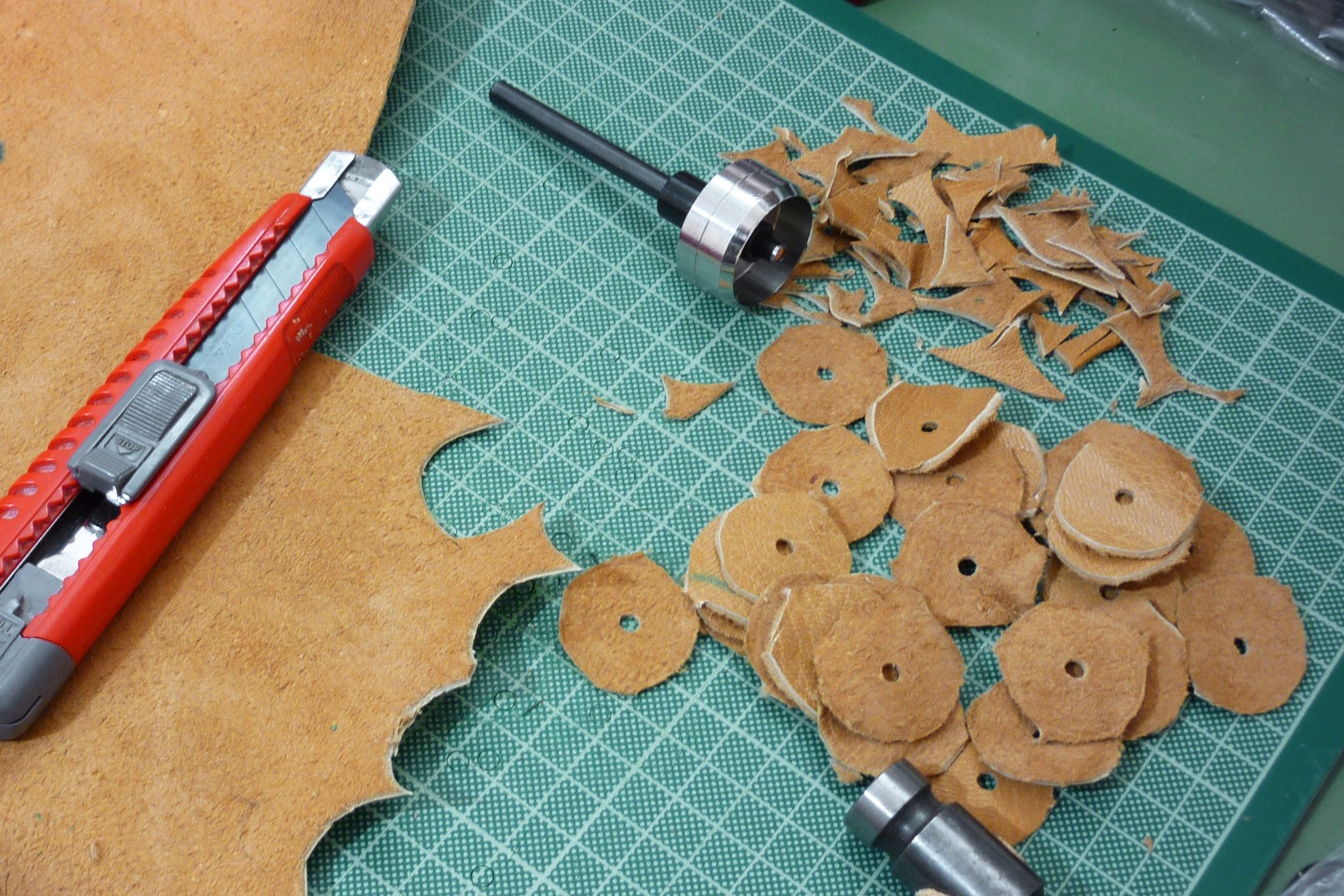

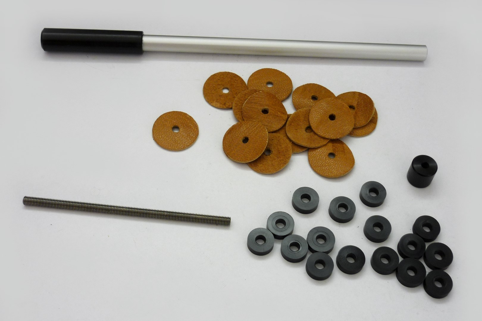

    For cutting the discs I made this round cutting guide which accepts a 5mm hole punch in its center
    Cleaning tool for the lathe spindle bore-2-large-.jpg Cleaning tool for the lathe spindle bore-3-large-.jpg

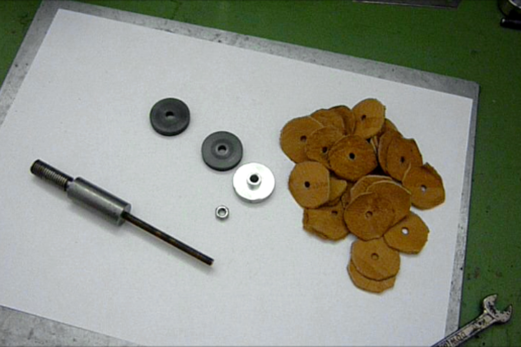

    The discs were roughly cut with a knife

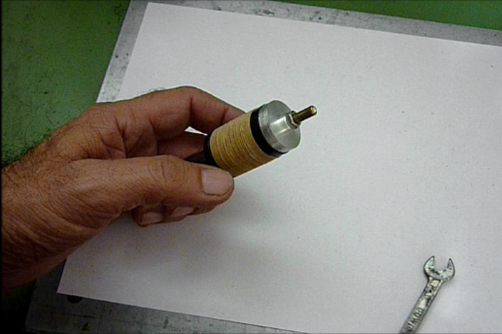

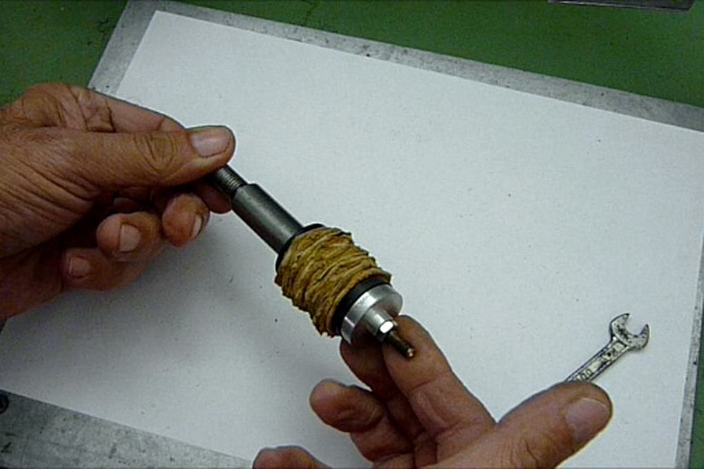

    Then the discs were pressed evenly and locked in a simple shaft; the final diameter was achieved by turning the stack on the lathe.
    Cleaning tool for the lathe spindle bore-5.jpg Cleaning tool for the lathe spindle bore-6.jpg Cleaning tool for the lathe spindle bore-7.jpg

    The overall length of the tool is approximately 325mm
