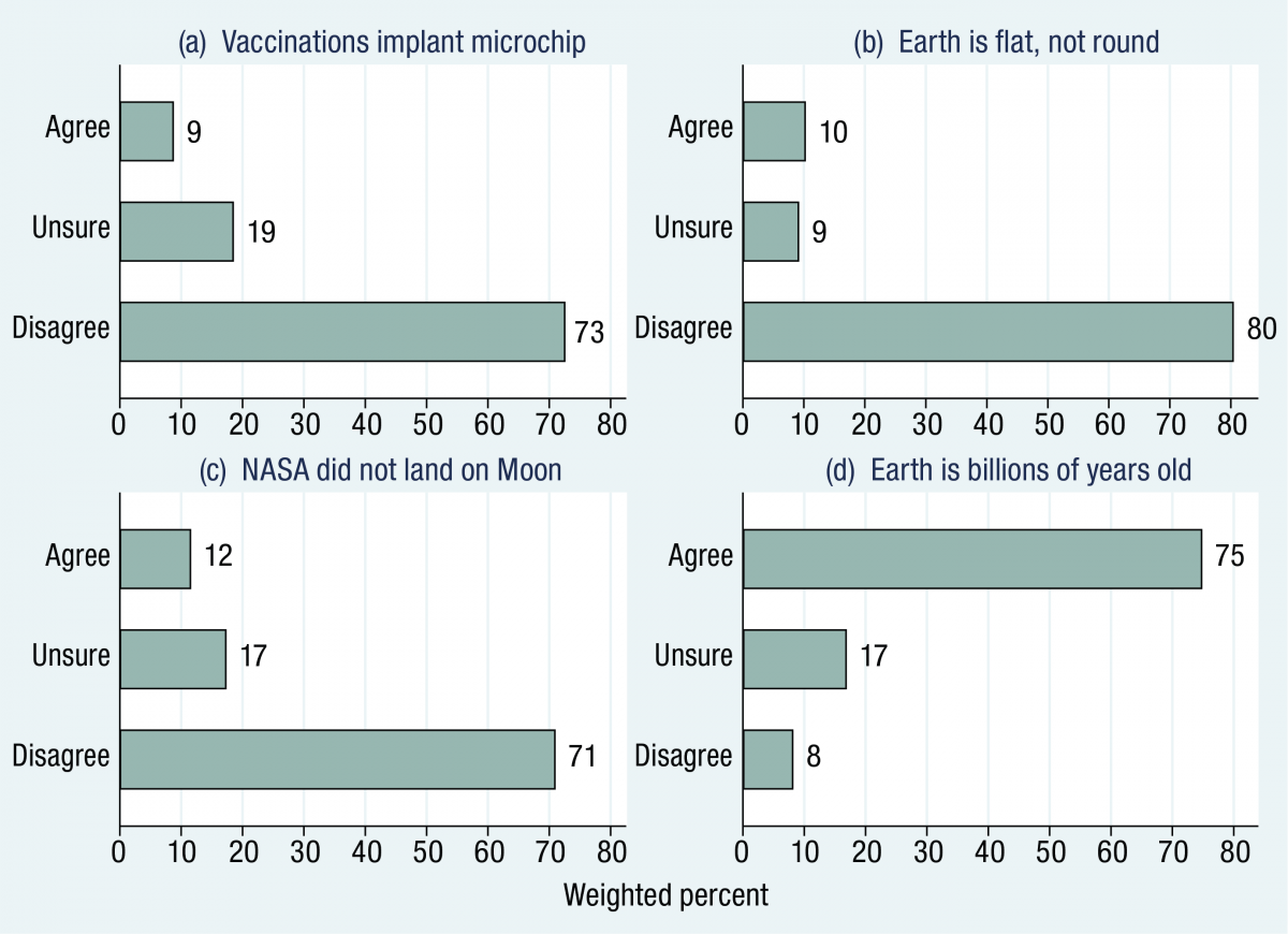

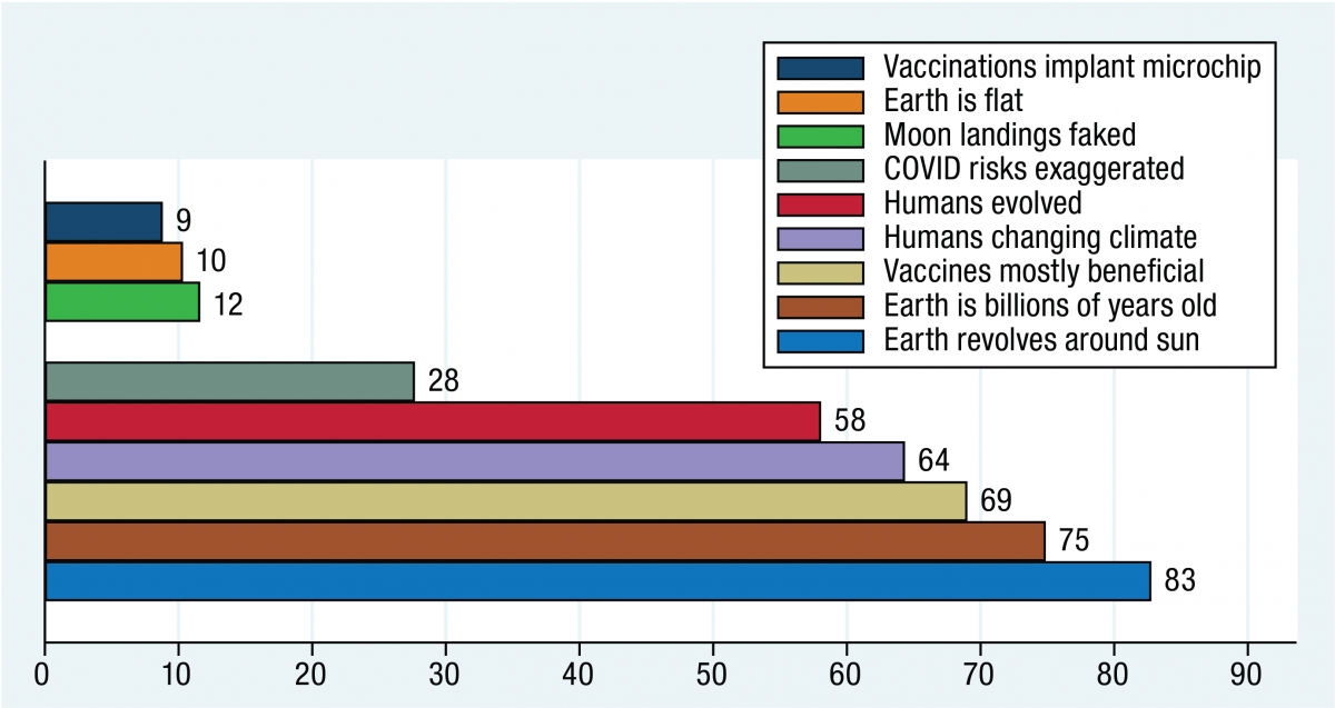

    The 2021 POLES study...
    https://carsey.unh.edu/publication/c...public-beliefs
    addressed both of your questions as well as several others. It's worth speed reading the whole thing but I copied two of the diagrams that provide a summary...
    Basically, 10% believe the earth is flat and 12% believe the moon landing was faked. The population of the USA is about 330 million so that's 33 million Usonians who think the earth is flat.

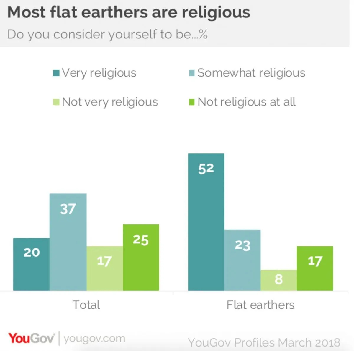

    Interestingly, another study...
    https://www.forbes.com/sites/trevorn...h=77622e447ec6
    indicates that most flat earthers are religious...

    Amazing statistics. Although from the US I guess that very similar results would be the case at least over that part of the world that we call developed. I do not find the connection between religion and flatearthers to be surprising.
