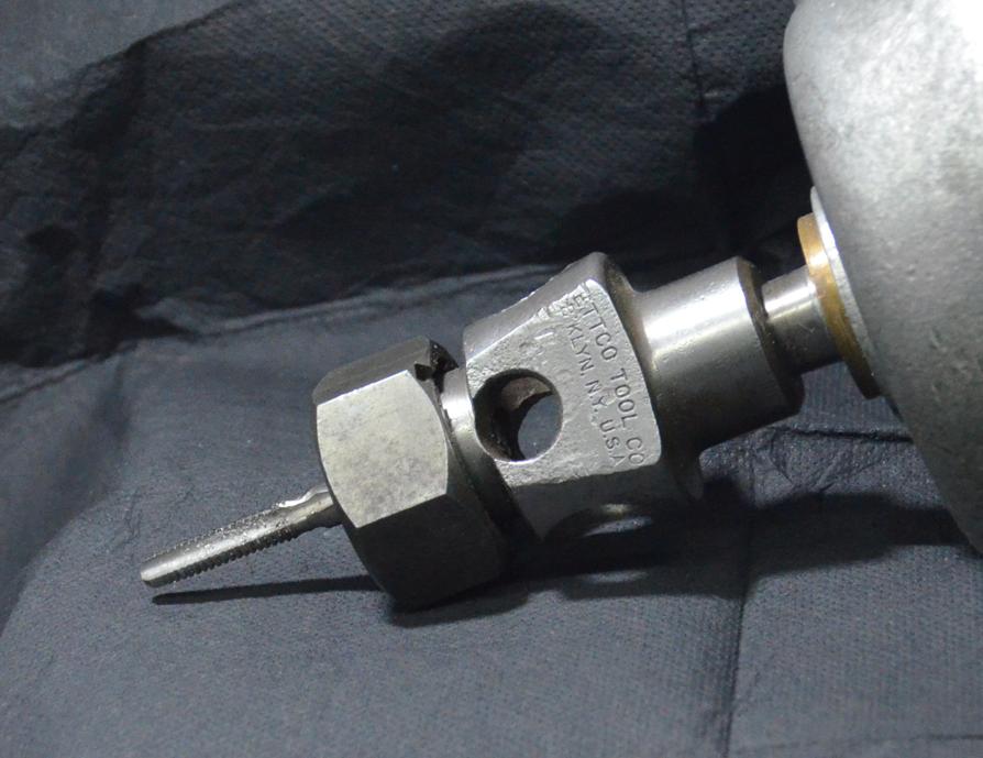

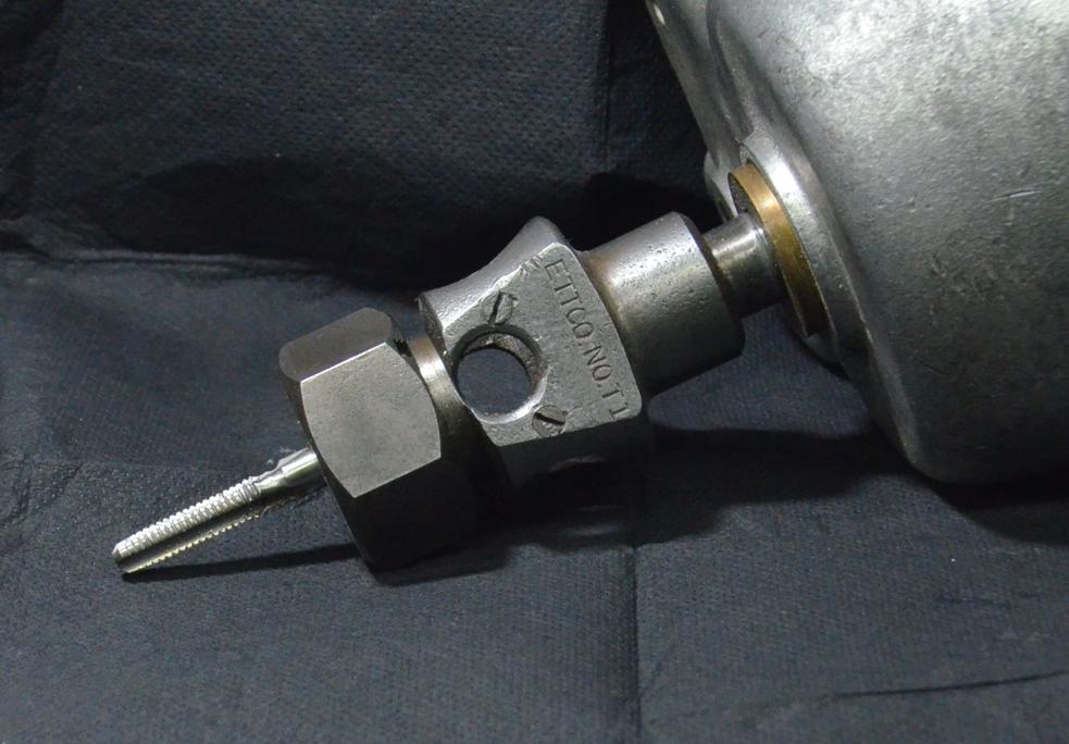

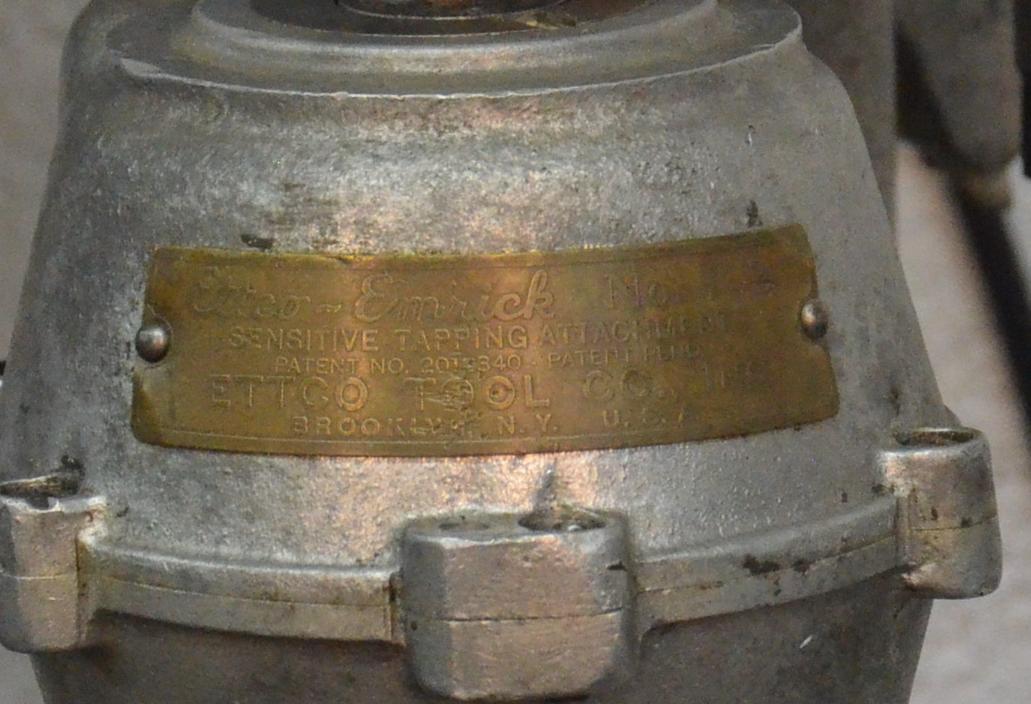

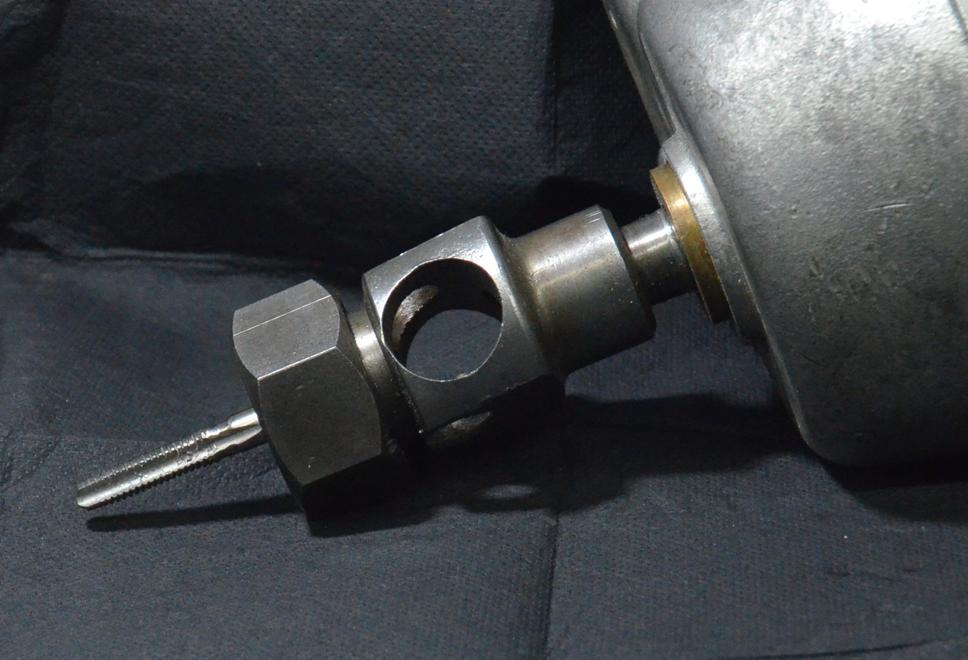

    Here are some pix of the tap holder on mine. It is basically just a collet system. I have always thought that something should fit into the large cross hole but the collets are complete as is. I use the small cross hole to put a bar in when tightening the collet nut.
    Clamp key and catch bar for Pollard tapping head-ettco-01.jpg Clamp key and catch bar for Pollard tapping head-ettco-02.jpg Clamp key and catch bar for Pollard tapping head-ettco-03.jpg Click thumbnails for full size pix.
    It is an Ettco as can be seen by the name plate, hard to read in this pic but it is a model 1-B
    I must have had this tapping head for at least 55 years. I think that it was given to me by an elder workmate. I do have another tapping head which is newer but I prefer to use the Ettco. However, the Ettco collet doesn't accept taps with large shanks but the other one does, with that one it clamps on the driving square of the taps.
