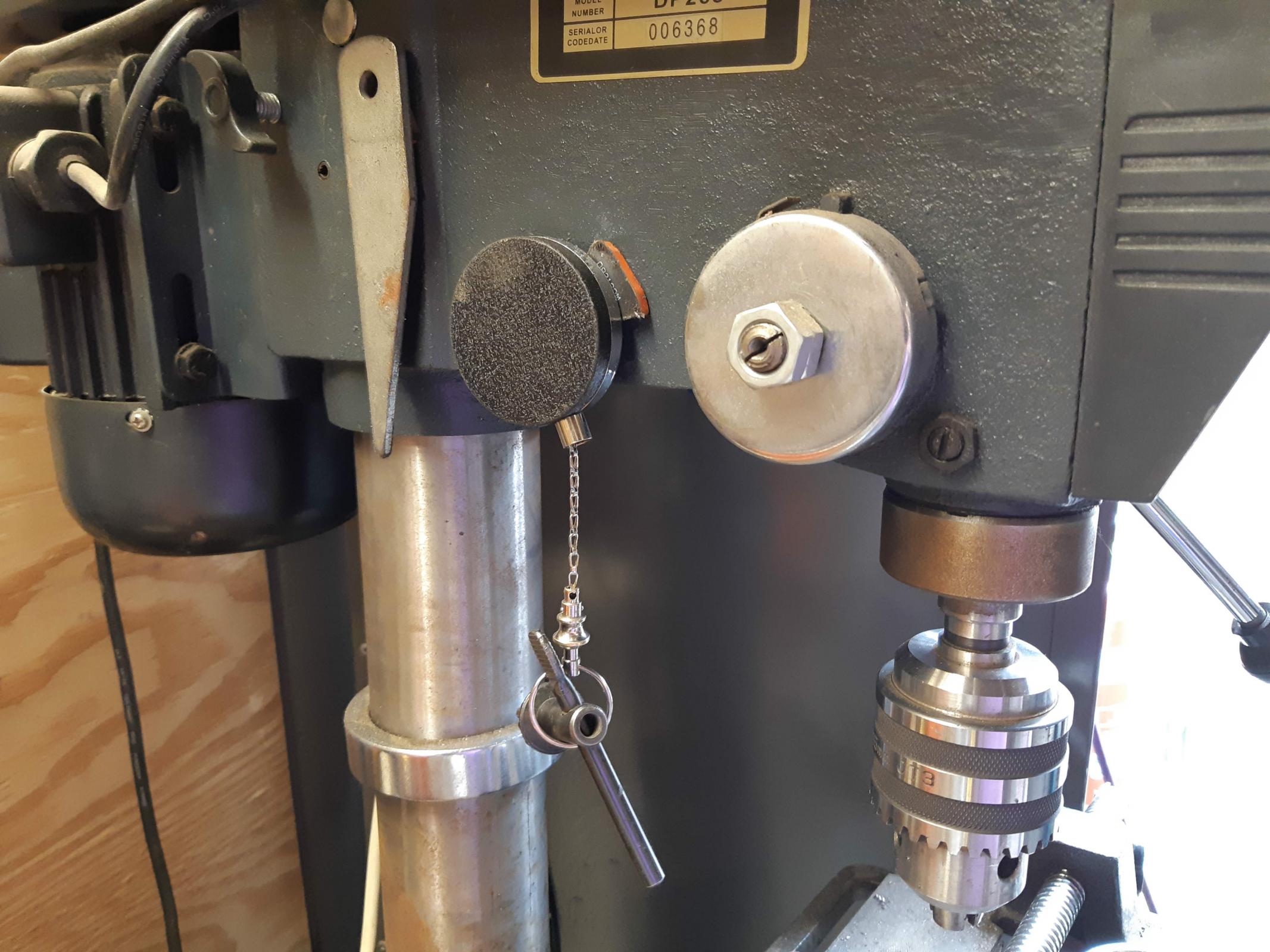

    Rather than throw out a retractable key ring with a broken belt clip, I fixed it to my drill press with some hard drive magnets. The only hiccough was making sure the magnets were spaced to the outside of the reel so they didn't cause the chain to bind.
    Now I never loose my chuck key, by eliminating the need to never put it down in the first place.

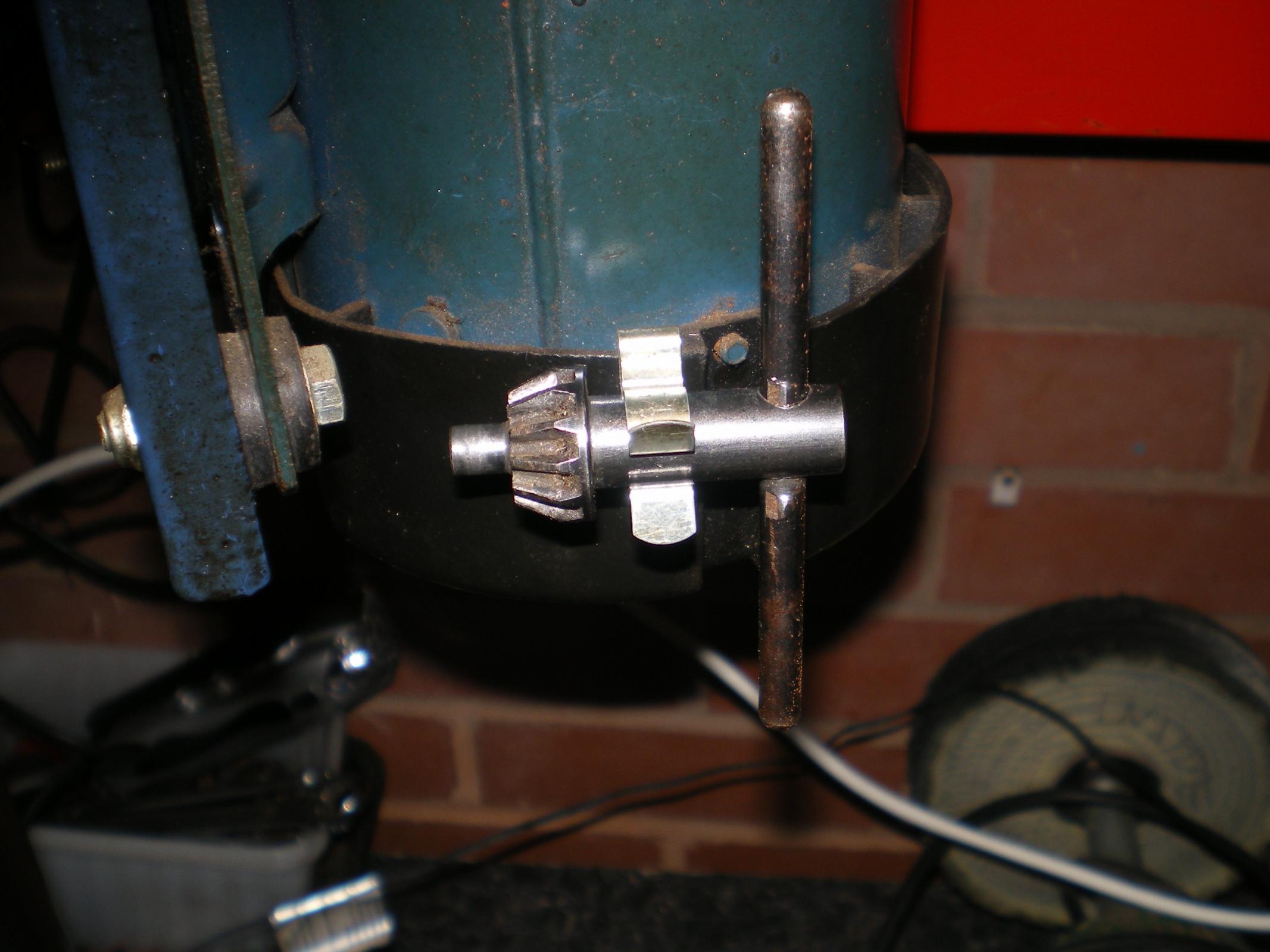

    Having an aversion to magnets around machine tools this is my simple chuck key holder, just a spring clip fixed to to the motor cowl, its always handy with no strings attached.
