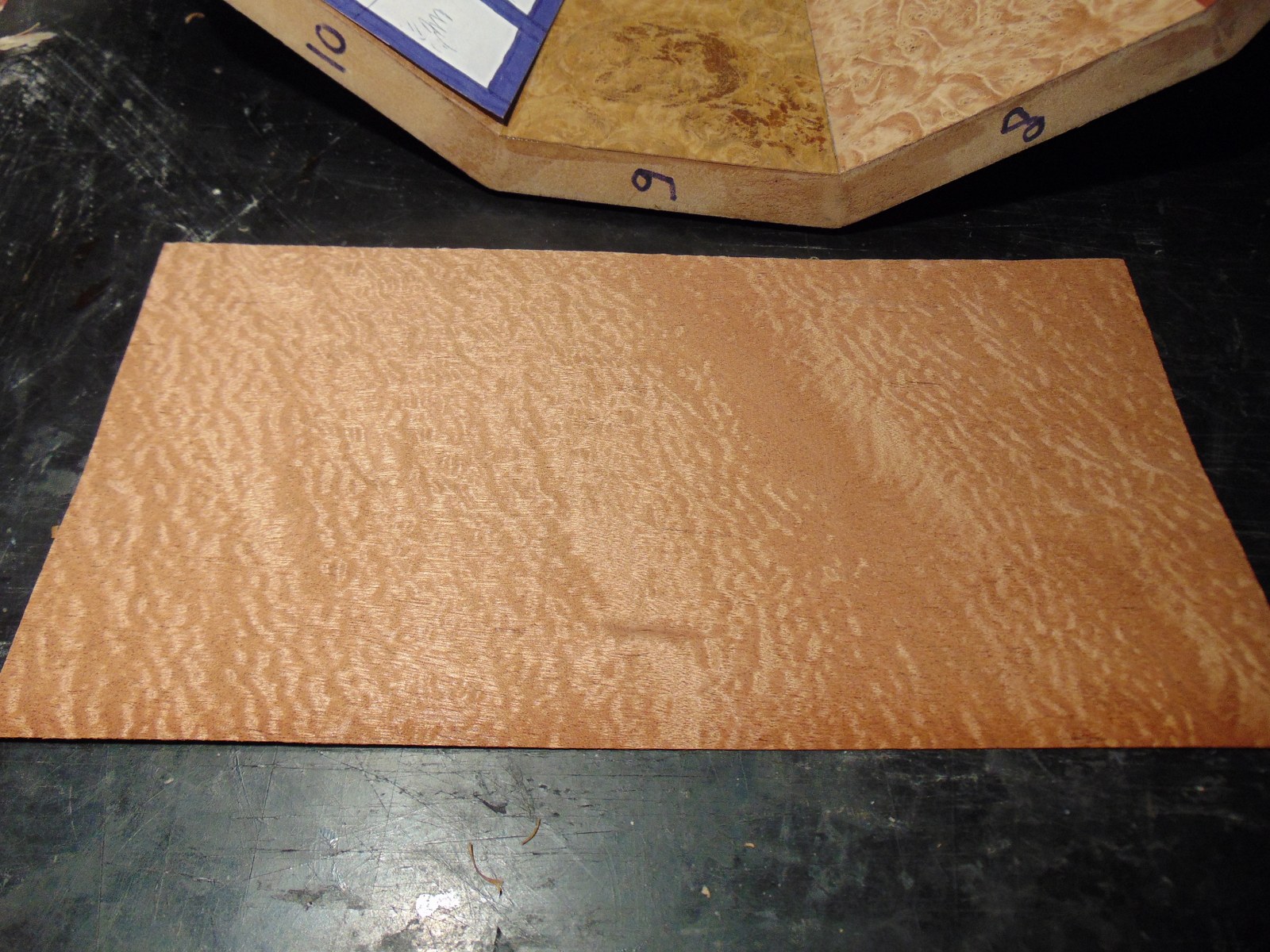

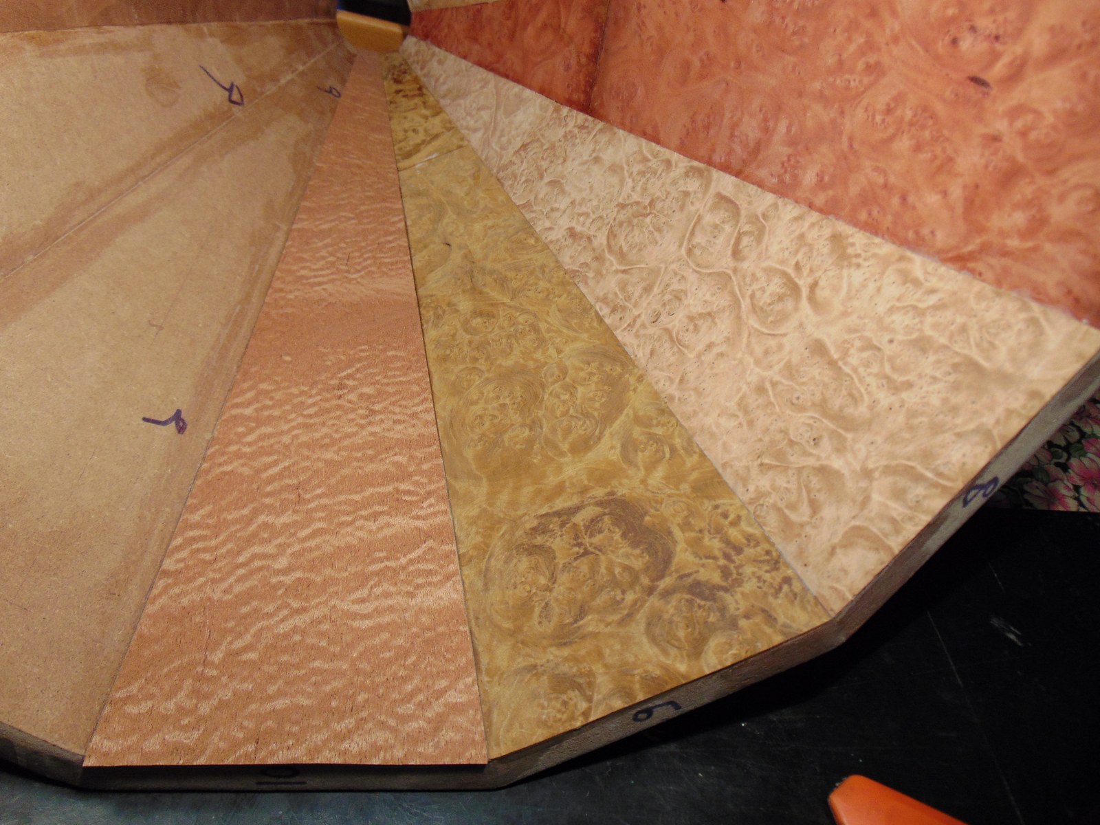

    Choice of finishing - burl veneer-dsc06334_1600x1200.jpg Choice of finishing - burl veneer-dsc06335_1600x1200.jpg

    I found this video of Rob O'Brien finishing a guitar with Royal Lac, a product that I wasn't familiar with and it seemed to me that it might be what you're after. I know that if you do what Rob says to do, how he says to do it that you'll have a finished piece that you're proud of and you can achieve a guitar quality finish just with hand application and polishing.

    Thank you! It's Always nice to learn new things!
    Looking the video it seems that the last passage, maybe the real polishing job, it's done with the cotton wheel and paste. Unluckily I can't enter the horn with the drill or the vertical grinder, the throat of the horn is tiny and the risk of damaging edges is high.
    I'm watching different types of wax (common italian brand, easy to find here), I don't know the differences between types, one is pure beeswax, one mixed with carnauba and the last one without turps.

    Watch the entire video - he first demonstrates how it can be polished by hand to what I think is a nice appearance. Of course it will never equal a buffing machine mirror finish but some concessions have to be made in an imperfect world.
    In general, I've found that Maguires products do a nice job, even on wood and if I recall correctly he mentioned one as an alternate for hand polishing. I did a little work on an expensive violin once and I used Flitz to finish polish it and it came out nice.
    I don't think you'll be very happy with the subdued finish of beeswax and something carnuba based would produce a result closer to what you're after.
    I just reread your post and finally snapped to the fact that you're in Italy and likely don't have easy access to many of the products that I mentioned. Try to find someone in your area who makes or repairs musical instruments and go there and ask what he/she uses for the type of project you're making. Buy him/her lunch and you'll likely get more information than you can remember.

    Thanks for advices
    In fact here it's quite hard to find everything that's not of wide distribution. Hardware store has common products (for each type of goods), if you have to buy the perfect product you have to search online, almost always from abroad, If you're lucky in Eu with no custom tax, otherwise you're doomed. Moreover, if you search for "pro" goods, you have to ask to specialized sellers that usually don't want to sell to a private Citizen without Vat number (or they ask a minimum cost up 100 euro).
    I can find shellac (flakes) or a ready to use lacquer, many types of wax, linseed and (not easy) tung oil, the only good one available in gun shop is the Tru-oil. It's even possible to find good automotive clear coating.
    I tried to put some wax on Iroko wood, the veins seem very nice, surely it's not glossy, but I think it could be a nice choice (after maybe some 5-6 hands) plus the hand wool polishing)
