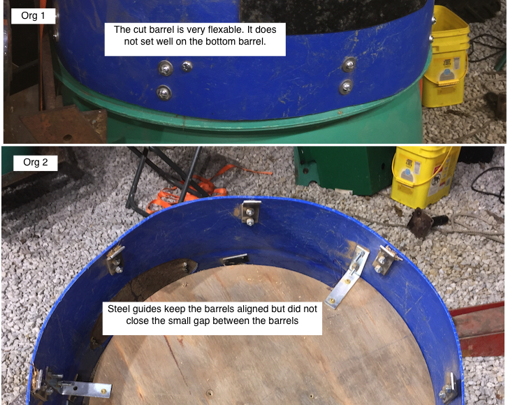

    Using the top 1/2 of a 55 gallon drum, plywood, plastic pipe and some angle brackets. I made one that worked very well , but it needed some improvements. Here are the original problems.
    The two barrels did not fit well enough together. Too much dust leaks out and was sucked into the radiator.

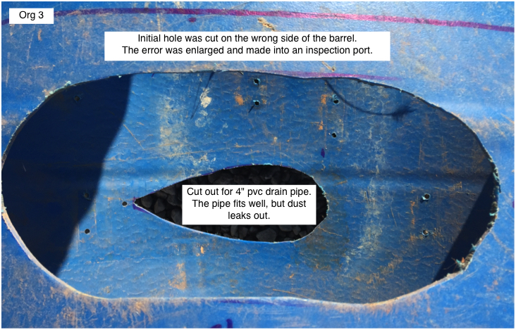

    The opening I cut for the inlet pipe had an ok fit, but dust was able to leak out around the joint. In addition, I cut the inlet on the wrong side of the barrel. I fixed that by making it into an inspection port

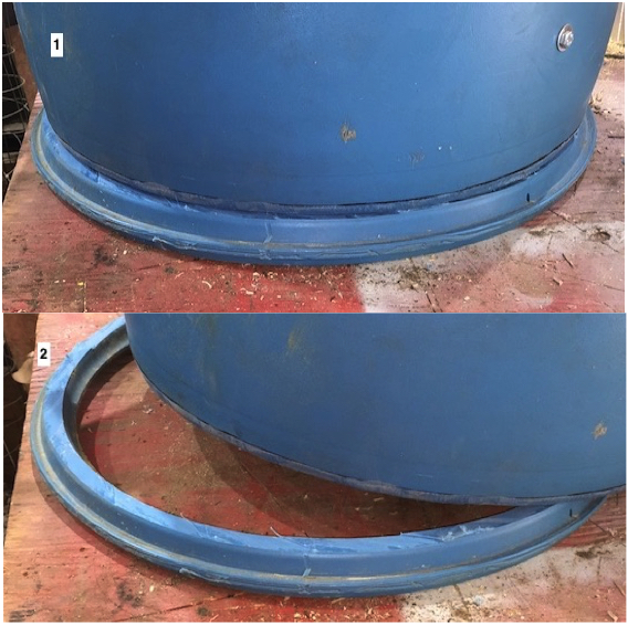

    The second attempt turned out a lot better. I cut the top lip off of a barrel. The barrel tapers under the lip. I cut it at the smallest part to allow it to nest into the top of another barrel The plastic is also much thicker and more stiff at the top/

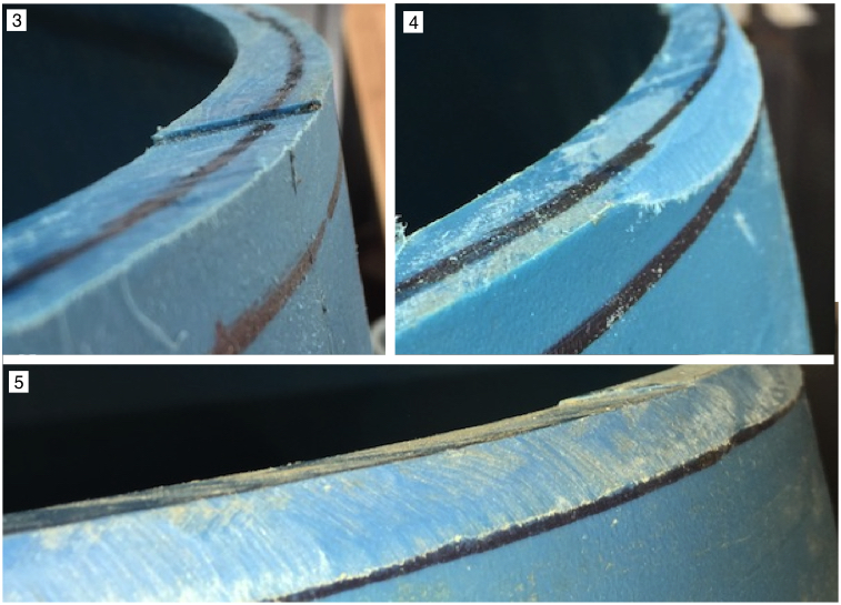

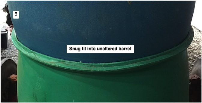

    With the lip removed, the 1/2 barrel fit ok into a standard barrel, but you have to wiggle it around as most barrels are not really round. There is enough thickness to allow trimming, I used an angle grinder and abrasive disk to taper the cut edge of the barrel.
    After trimming, they fit together nice and snug.

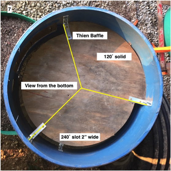

    Next make the top plate and the baffle. It is a little tricky to measure the inside diameter of a barrel as they are not round. To get a good fit, I measured the outside circumference. Then divide by 3.14 to get the outside diameter. Then subtract 2 times the wall thickness of the barrel. The closer you can get to a nice snug the better. Make the top plate first. If you make it a little too small, you can use it for the baffle.
    The gap in the baffle is important. Too small, the chips do not easily fall out of the air stream. Too large turbulence from the air stream will keep stirring up chips in the barrel. I found 2” to work well for my use. I just used angle brackets to attach the baffle.

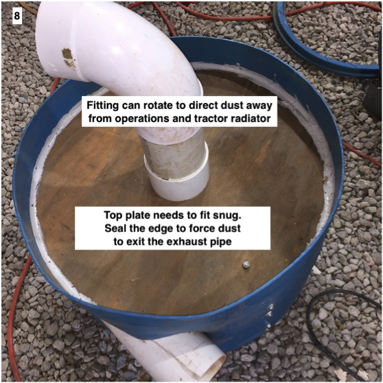

    Then attach the top plate. I used caulk to seal the edge of the top plate. Dust WILL try its best to escape places as it races around the inside of the separator.

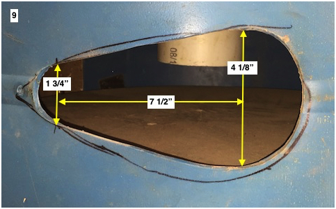

    Cut the hole for the inlet pipe. I made a fancy layout of the intersection of the pipe with the barrel for the first version. But, the fit was not a good as I had hoped. For the second one, I made a layout as shown which is a little smaller than the pipe.

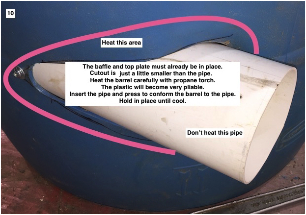

    After cutting the hole. I heated the barrel to soften the plastic, then forced the pipe into position. This stretched the barrel to fit the pipe. The joint is tight enough dust cannot escape.

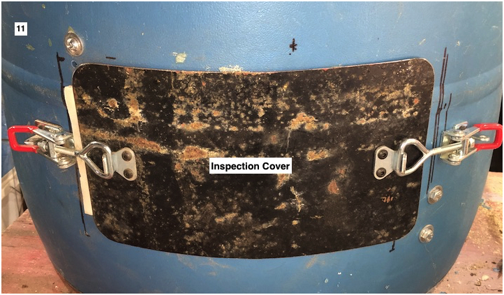

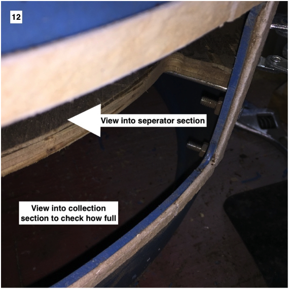

    You may not need an inspection cover. My first version had one because of an error. My second has one because there no way to check the contents of the barrel. The only way to know that the barrel was full is when chips start to fly out the exhaust. By then the separation chamber has also filled with chips. The inlet pipe from the chipper can also fill with chips. It is time consuming to clean all of that out.
    Chip Separator for tractor mount Chipper Shredder-11.jpg Chip Separator for tractor mount Chipper Shredder-12.jpg

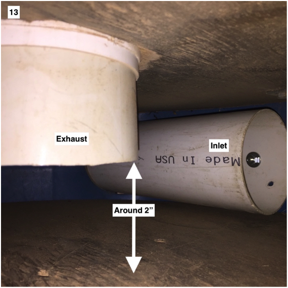

    Peeking inside the inspection cover, you can see the exhaust and the inlet pipe. The exhaust pipe is about 2” above the baffle. (I am considering enlarging the exhaust to 6”)

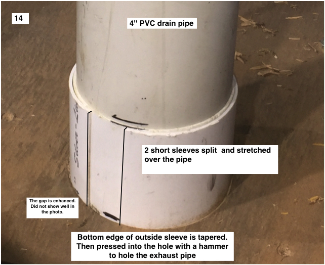

    I held the exhaust in place using two short pieces of pipe. Split the pipe up one side. Stretch the pieces around the exhaust. I used the angle grinder to taper the end of one of the pieces. Then persuaded it into place with a hammer to secure the exhaust pipe.

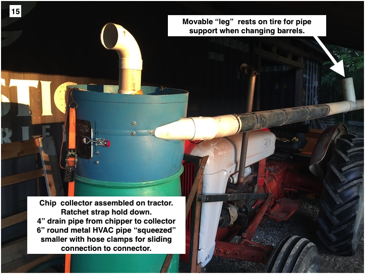

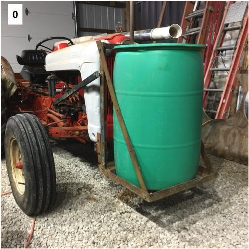

    The collector mounted on the tractor. The metal pipe section is 6” round HVAC. The crimp on the one end was cut off. The snap seam was removed from one side, then hose clamps were used to squeeze it down to a sliding fit over the 4” PVC drain pipe, I am happy to report it works very well. Although it does restrict discharge from the chipper some. If I try to chip much larger than 2" branches, the discharge pipe plugs up. without the spearator I can chip 5". But I use anything over 2" for firewood. The pipe easily supports it self when it is attached at both ends.

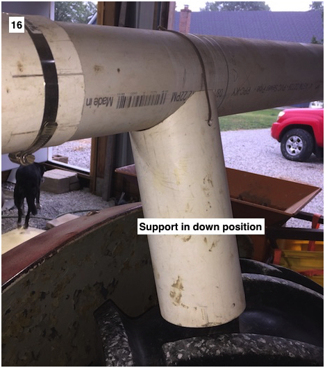

    When the separator is removed for barrel replacement, a movable “leg” rests on the tractor tire to support the pipe..
