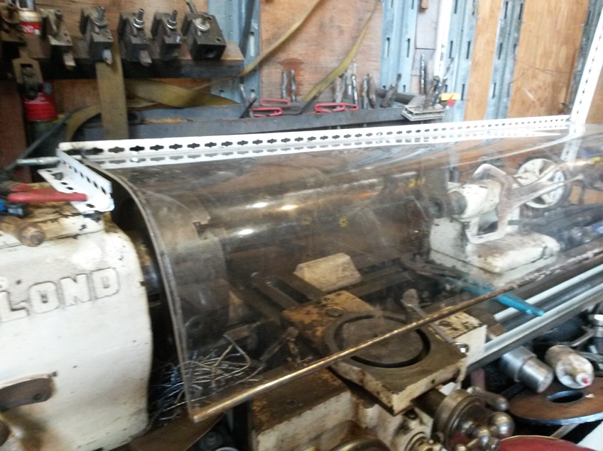

    Most of my lathes have always had a drop down chip deflector for use when turning up close to the chuck. My 65 year old le Blond round head does not and never has.

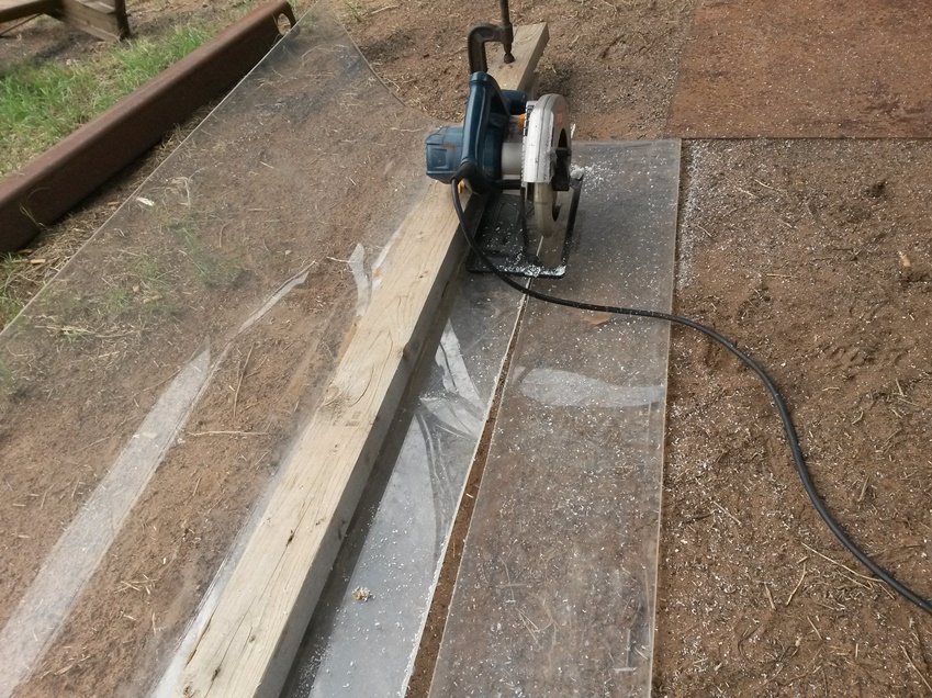

    A while back I came across a lexan or plexiglass display case window that was shaped in a large radius and nearly 6 ft long I thought that it might make a perfect view window for use on the old lathe.
    I first cut it down to size then split a length of 1/2" SS tubing to put on the leading edge to not only stiffen the plastic but to serve ad an edge protector and a convenient handle to raise it out of the way.
    Next I will have to make a mount and pivot for it to mount it with Hopefully I will be able to find a pair of gas spring struts to hold it up

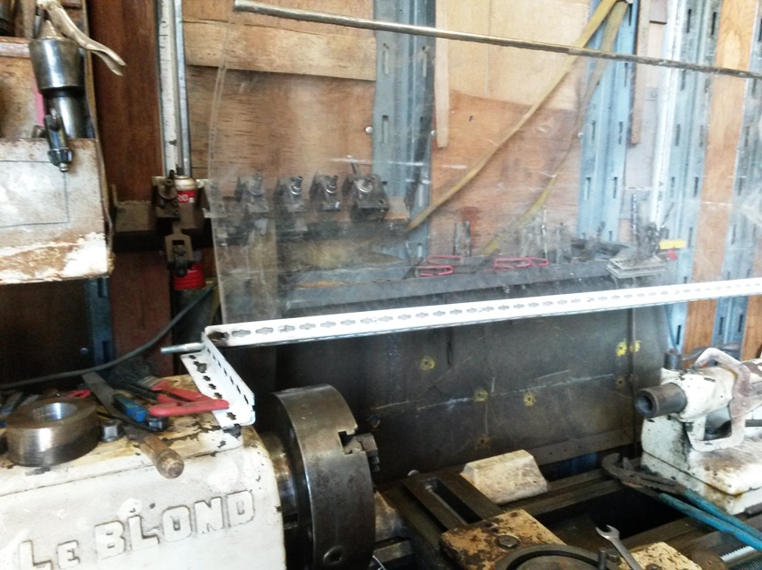

    Got the chip shield mounted on the LeBlond today this is one of those function over form jobs I wanted it easy to remove if needed and didn't want to spend a lot of time fabricating a mount that I might decide to change later anyway.

    I think it looks for tempo. If it works out as good as you would like then you can fab some nicer mounts.

    Nelson the thing is most of the time I find these things more in the way than useful, but those are the ones that only extend a few inches past the chuck. This one being the full length of the lathe you are correct I may find that I like it well enough to fabricate a nicer mounting system and add gas springs

    Your shield does looks quick and plenty usable Frank. I always thought a smaller flip up one like yours that fits on the carriage cleanly would do a sufficient job of deflecting chips into the pan at the source.
