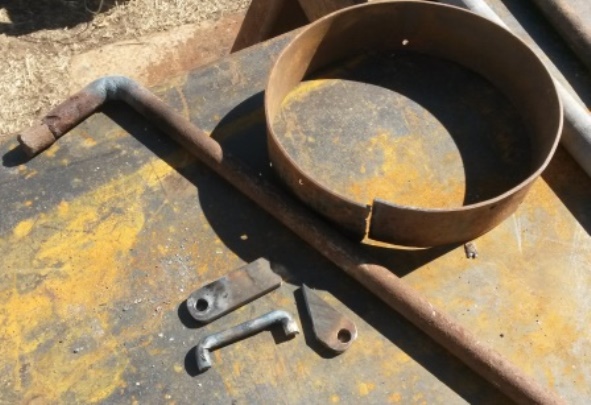

    After pulling the core out I decided that I could over sleeve it with another section of pipe.
    Since putting 8 inch pipe over 8 inch pipe defies the laws of physics and since it was the seem that was leaking anyway I just split it at the seem and inserted it inside of a new pipe. My reason for doing this was the new pipe was galvanized while the core was stainless steel.
    Now comes the problem of how to expand the core to fit tightly inside of the sleeve. I decided to make an expand-er
    I dug around and came up with a length of 1/8 by 2 flat bar. 1/4 by 1 flat bar, 3/4 sucker rod, 3/4" pipe and a bicycle kick stand
    Here is what I came up with

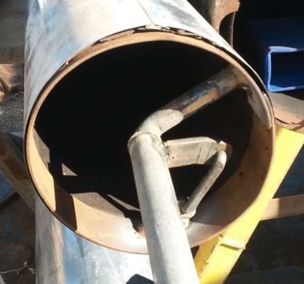

    the bungee cord makes a good 3rd hand to hold tension on the tool

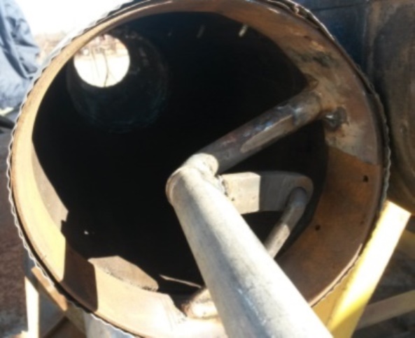

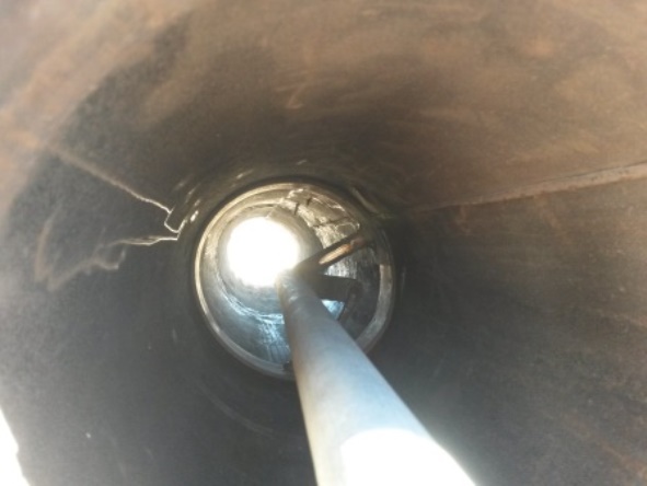

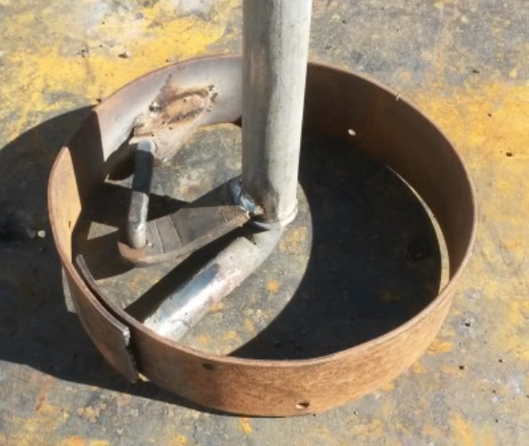

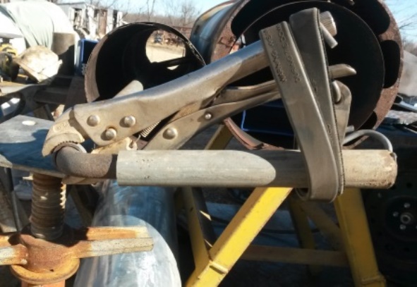

    In addition to expanding the inner liner the expand-er provided a solid back up for drilling in the self drilling screws which hold the liner in place

    This is 1 of those tools that will most likely be a 1 time use special purpose tool also in a hundred years it may even become one of those mystery tools for someone to try and determine it's original use. Certainly not elegant but it functions unbelievably well I could see it literally stretching against the outside pipe
