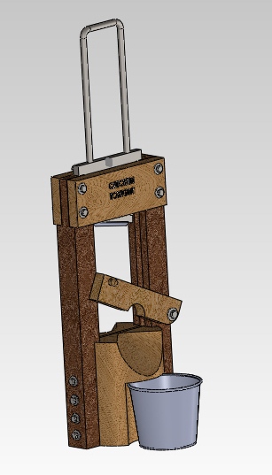

    About 5 or 6 years ago a friend asked me to design for him a way to chop the heads off of chickens.
    OK many of us who either live or have lived on a farm would simply take the chicken by the head and flick our wrist or place the head under a hoe handle and pull still others would hold the chicken with one hand and chop the head off with a sharp heavy blade.
    Sorry if all of that sounds a little graphic but fresh home fried chicken does not come from the magic fast food machine.
    I designed a guillotine for him and sent him the plans to build it since he was located in a country several thousand miles from me
    I thought I would share a few Jpeg renderings of my actual drawings.
    If the forum administrators do start the new plans page I will gladly supply a full set of drawings there
    in this first image you see the guillotine in the raised and locked position

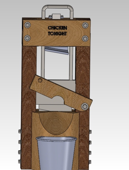

    After placing the head in the grove lower the head lock

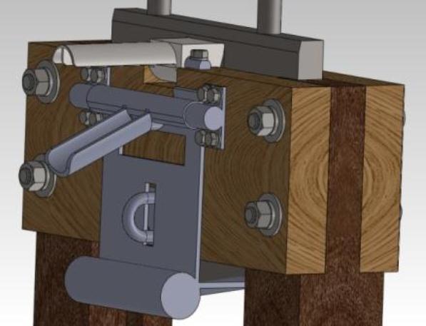

    this image shows the double lock safety mechanism in the locked position
    before the blade can fall the lower handle must be raised. It is impossible for the blade to fall if the trigger handle is depressed unless the safety lock is held open with the same hand

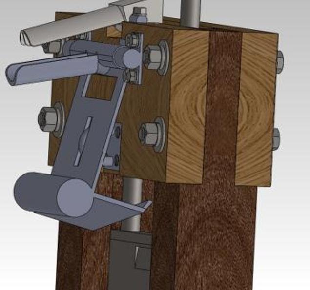

    then apply pressure downward on the upper handle to release the trigger plate holding the blade while holding onto the legs of the bird

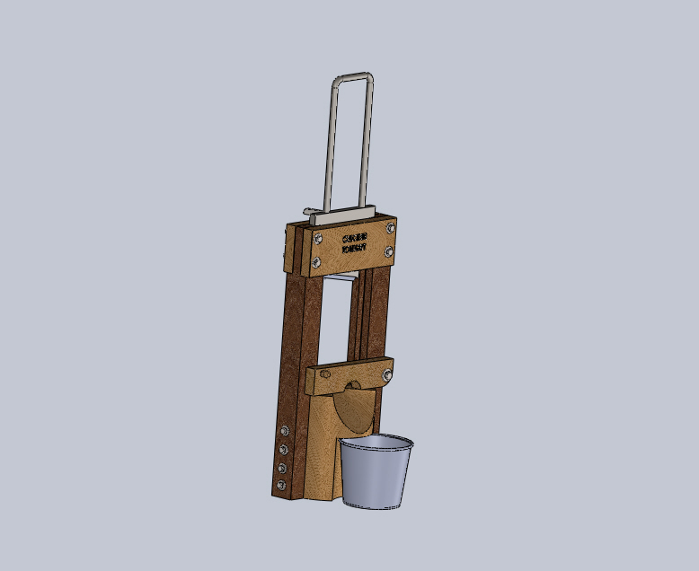

    the head will fall in the bucket you place the bird in another bucket or drum with a catch and hold net much like a very small basket ball net to allow it to bleed out this prevents it from flopping around and bruising the meat while it bleeds out.
