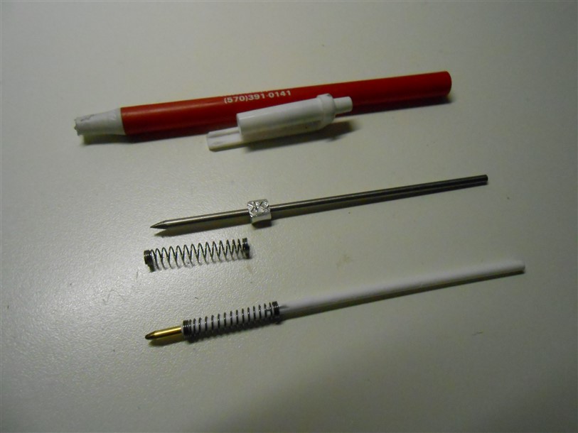

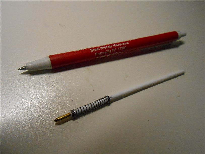

    Here's another little fun project. Take a cheap (or expensive if your a fancy jet setter) retractable pen and replace the ink insert with a metal scribe.
    I like to re-purpose things so the metal scribe part is made from the top section of a car antenna Cut to length, sharpen the tip and then crimp on a wire rope ferrule as a spring stop. (you may have to file it down a bit to fit the tube)
    Re-assemble and now you have a pocket "safety" scribe tool you can carry with you!

    Take a piece of suitably-sized drill rod and harden the end and grind a knife edge and you've got a useful and safe retractable mini-knife for opening stubborn packages, clipping coupons, whatever.
    Drill out the button used to expose/hide the knife blade, glue in a small magnet, and you've got an always-in-your-pocket for spotting those big-box store Chinese brass screws as brass-plated steel.

    Now why didn't I think of that. I wouldn't have all those puncture wounds in my chest.

    Possible further improvement..replace only bras tip of pen insert...with same size steel tip !
