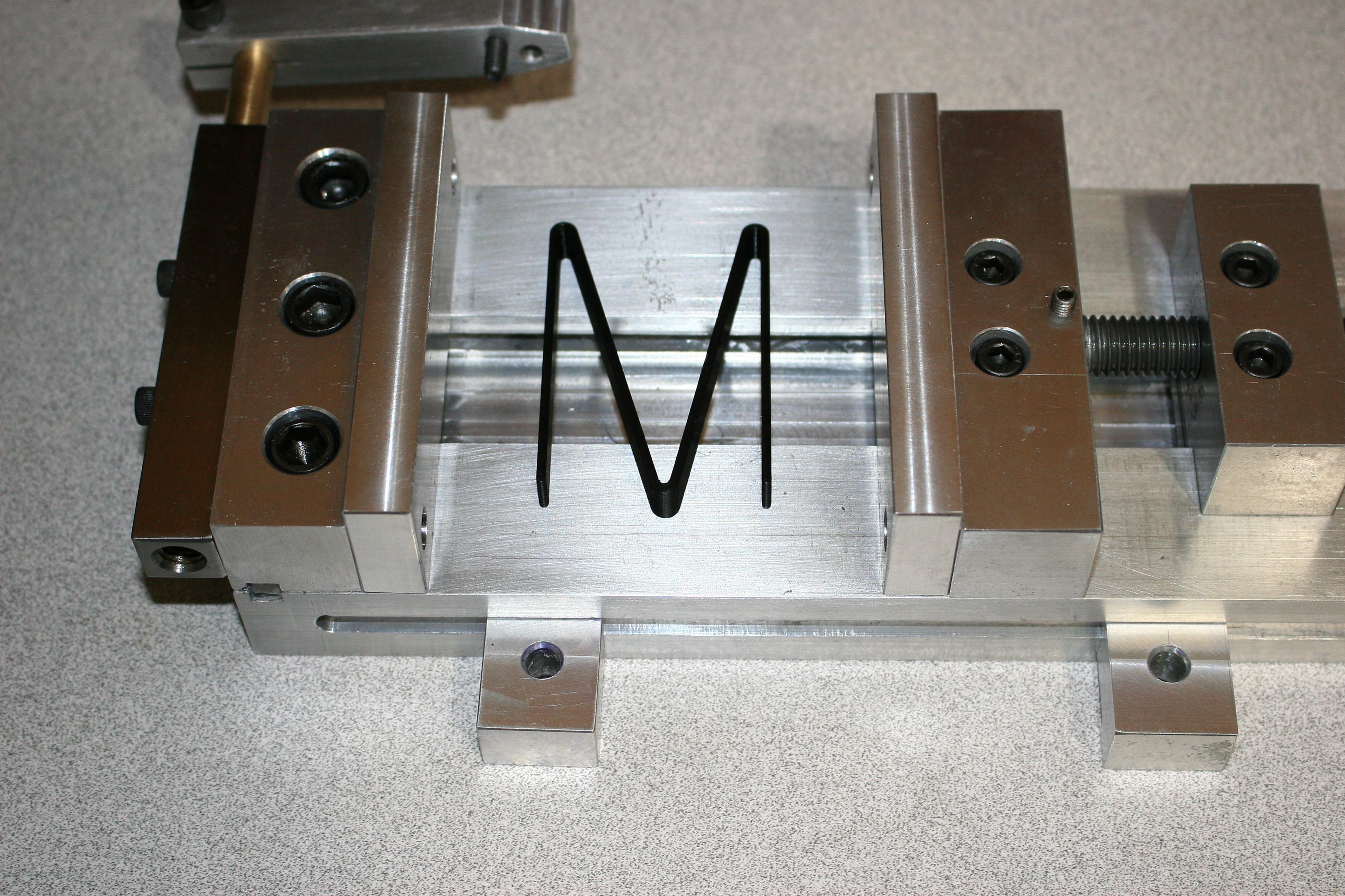

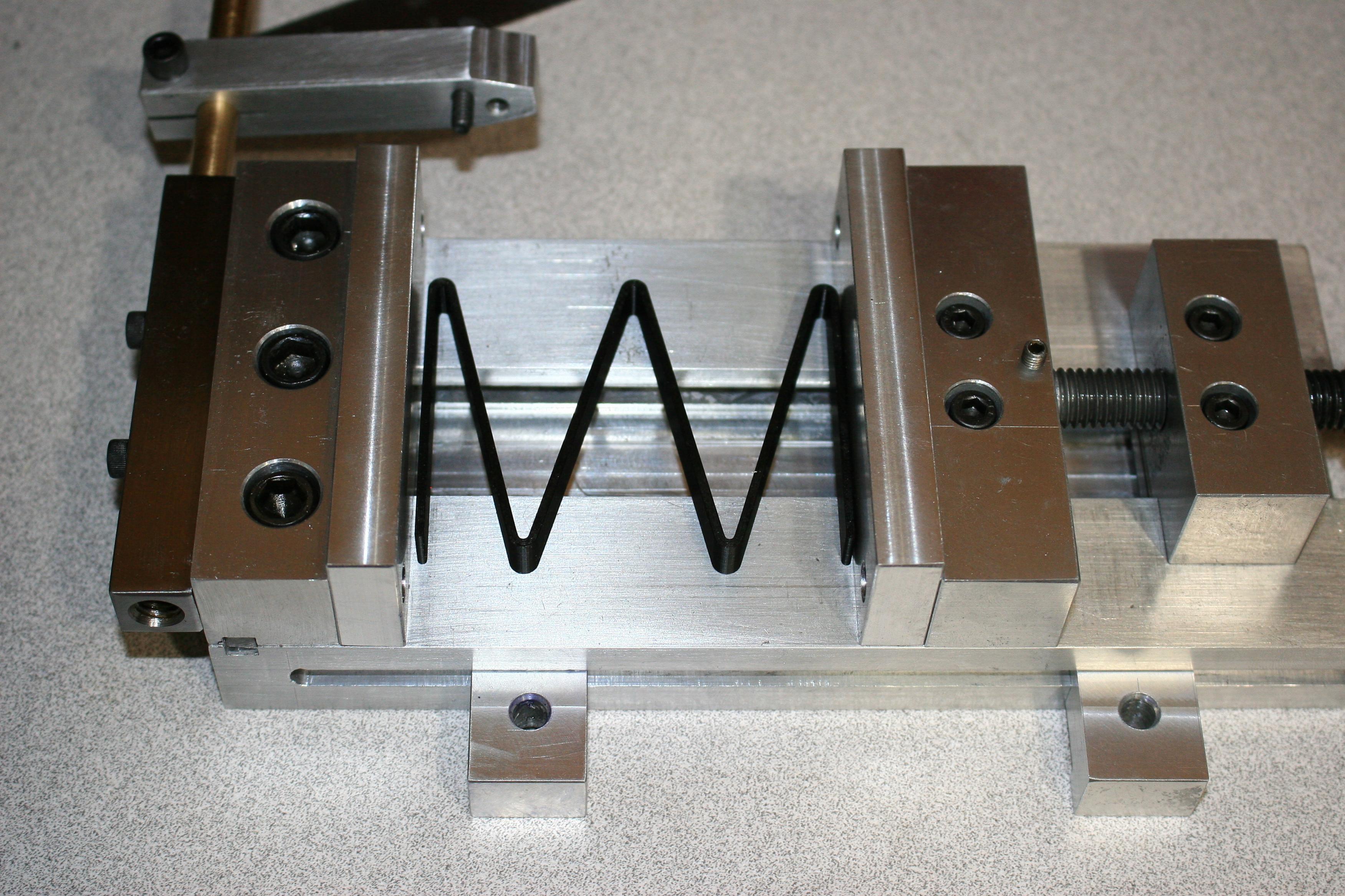

This is a quick 3D print that will save time and nerves.
My parallels are always needing to be "hand reset" to the vise jaws.
Well no more...These little springs work wonders on the milling vise parallels.
Cheers, JR

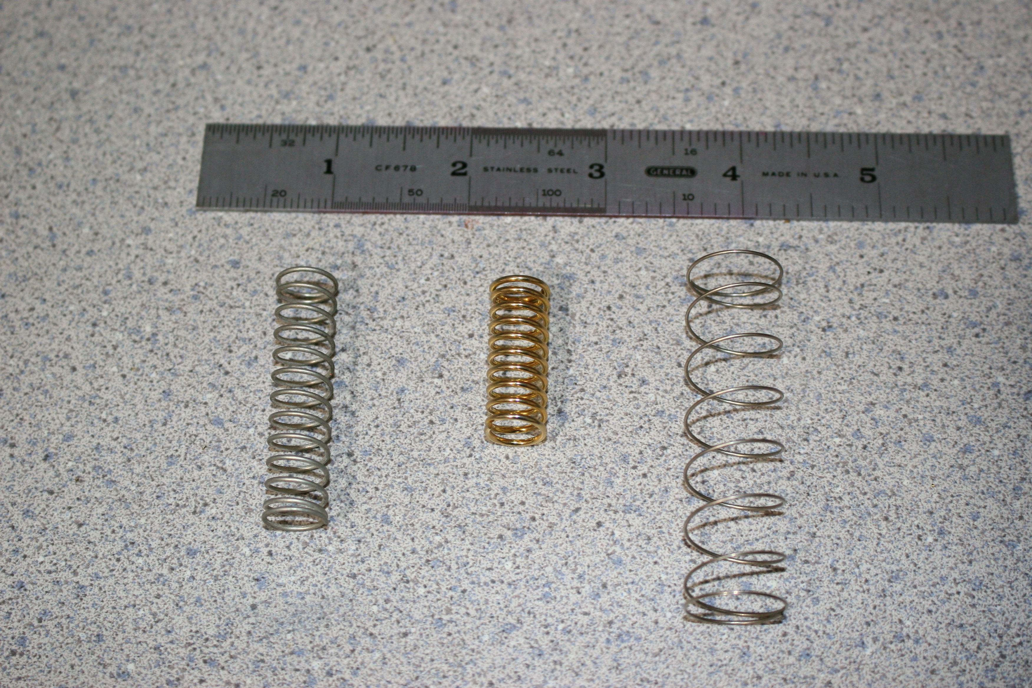

Here are a few more of my older springs that I use on the mill.
First picture is of course just--- well---- Springs! They work good, just don't let them spring off into the shop!!

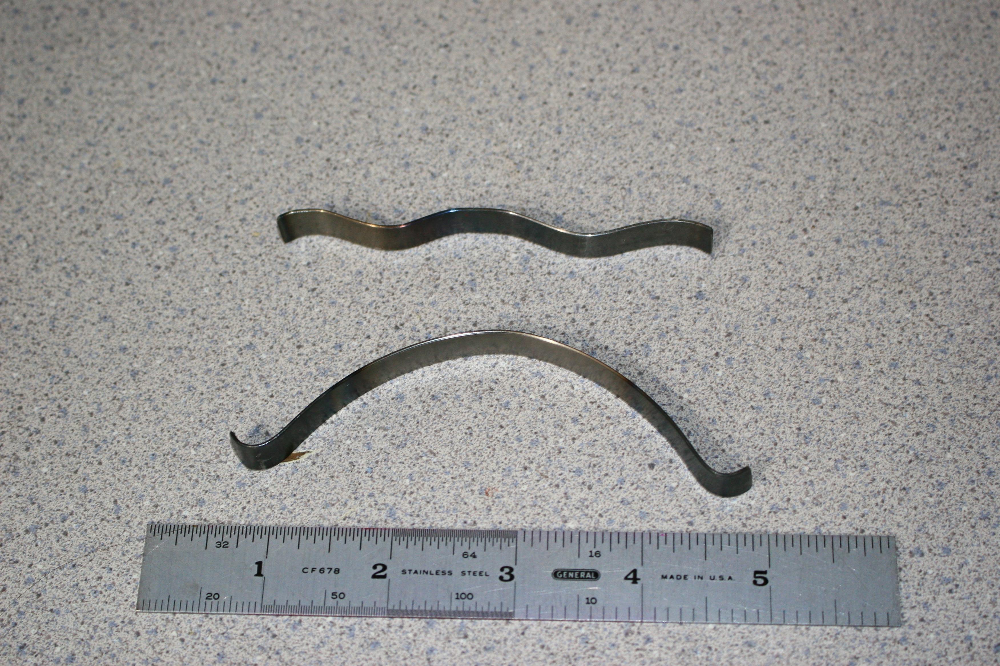

Next are some I made from an old quill return spring that I removed from my small mill that I did not need.

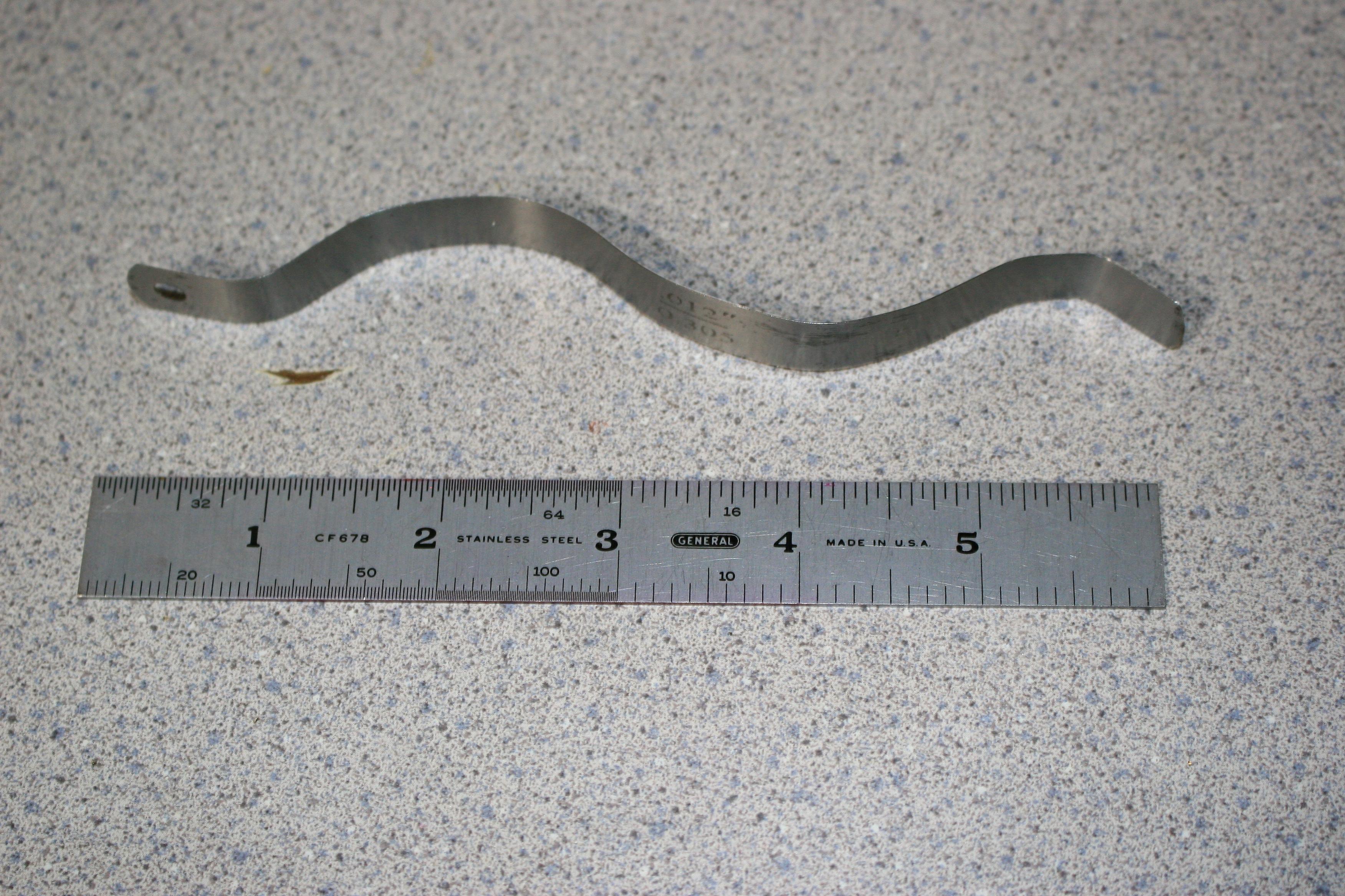

Last is the one I made from an extra long feeler gage of .012". Just bend them around a piece of round bar.
Cheers, JR
