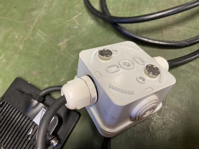

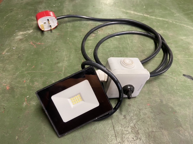

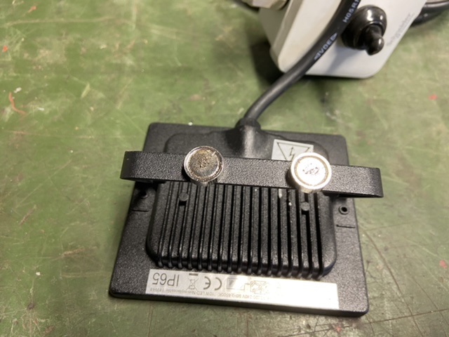

    Hi All
    Whilst being dragged around shopping with the wife in Home Bargains. I had a look down the tool isle. I found a small external 240v led light for under a fiver so thought I would have one. I know 240v is not great around machines with coolant etc but on my tool and cutter grinder and other machine tools would be fine. The light and switch are fitted with magnets so it can easily be placed in the desired position. The light is very bright and certainly helps on setups.
    Cheap portable machine light.-63b13528-3ad1-4b09-88cf-cd2757e5789a.jpeg Cheap portable machine light.-ed20a939-28cd-4a22-86cd-2d2f3033edfe.jpeg Cheap portable machine light.-1a0156f9-4ed6-4844-ae2a-704909956b2f.jpeg
    Complete light and magnets to position light and switch

    Good price, there!
    Don't worry about spraying it with coolant - it's IP65 spray-proof...
    Guess it's a 20 W "Daylight" (i.e. 5000K-ish color temp).
    You might want to check it for strobing, if you intend to use it for shooting videos.
    Its driver can crank out pulsed output anywhere from DC up to 44 kHz.
    I've had some success in hooking up the chip parallel with a 4700 muF capacitor to make it "flicker free".
    Easy check: Film its surroundings with your cellphone, preferably at slo-mo, and check for flicker.
