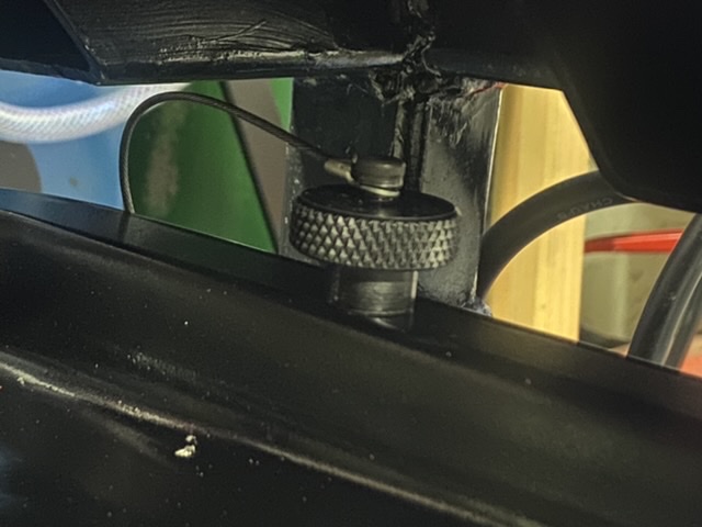

    Hi All
    I often put things down in the workshop and subsequently can’t find it. Over the years and with a bit more experience, I have learned to attach pieces when ever possible that can easily lost. Often these items are placed in that safe place and never to be found, until you have given up and no longer looking for it and there it was all the time
    Chain is a favourite to secure pieces. But chain isn’t cheap and it is surprisingly how much you can get through.
    So a solution to this is bicycle brake cable and electrical ring terminals. The price of a new cable is considerably cheaper than chain and ring terminals are penny’s.
    Also a bike shop will happily give you old cable’s they have replaced.
    The photos below show the lanyards with knurled thumb nuts.
    Cheap lanyard-0395c415-897a-46b9-b25f-3414804493df.jpeg Cheap lanyard-d49b7528-9672-4747-9e93-9159478565db.jpeg Cheap lanyard-36ae73fe-ab20-4a02-90d4-b036b2303d61.jpeg
    The cable also doesn’t get tangled when rotating the thumb nut unlike some chain.

    Certainly, things are lost daily, and with a bit more self-discipline, it would happen less frequently. If trained when young, it might be possible to put tools away as you go, but being so intent on the process, it’s like running a race, focusing on the finish, not noticing the surroundings. But I am not sure what you are securing, Andy, is it the knurled nut? I use a little leather cup, which is for farriers’ nails - when I remember!

    yes the two bits of angle bolt under my saw to the frame and support a coolant drip tray. The Knurled nuts simply lock the tray in position. When the tray needs cleaning the nuts are removed. I know I will put them down and lose one if not both. I will be added a post on the complete coolant system soon.
    You are correct, I should be more organised and put things away as I go but bad habit’s!
    It’s funny when I tidy up I can never find anything either. Can see more lanyards being needed

    Cheap lanyard-63643946-742d-49ea-a0bb-6f6b0d1a8f2b.jpegThumb nut in place holding coolant drip tray in place
