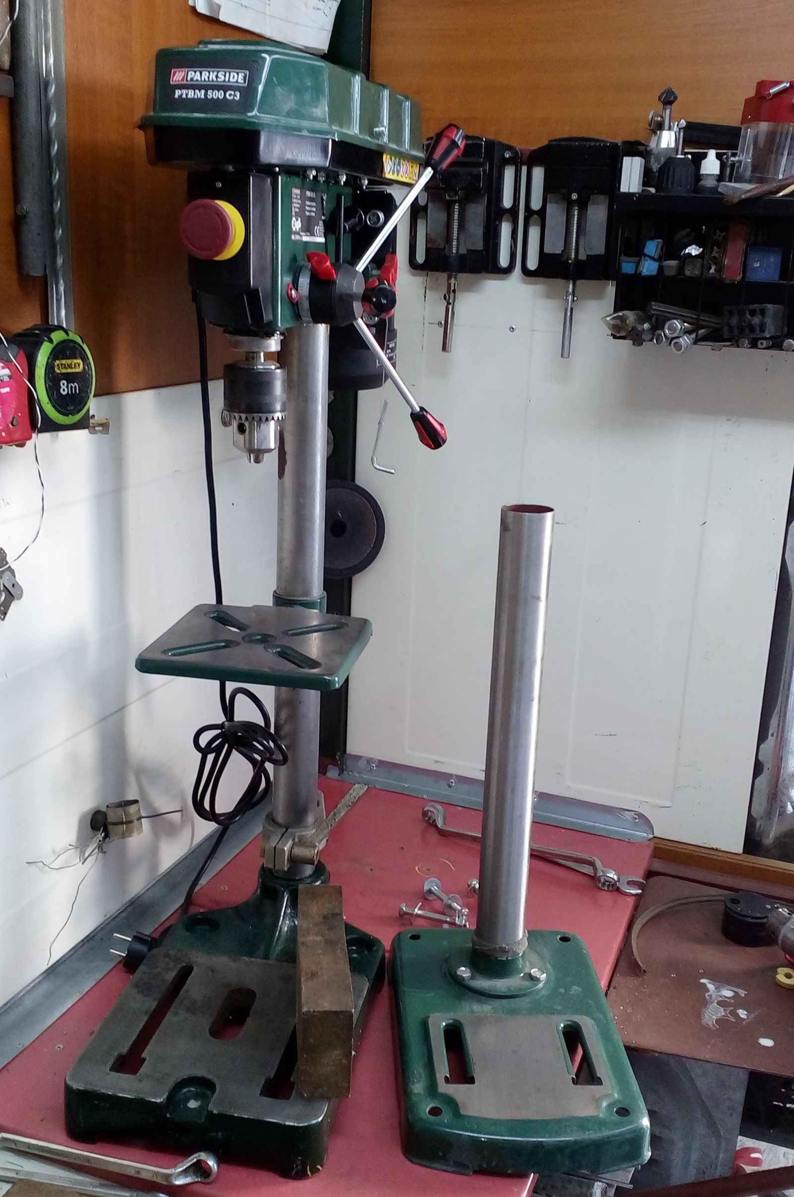

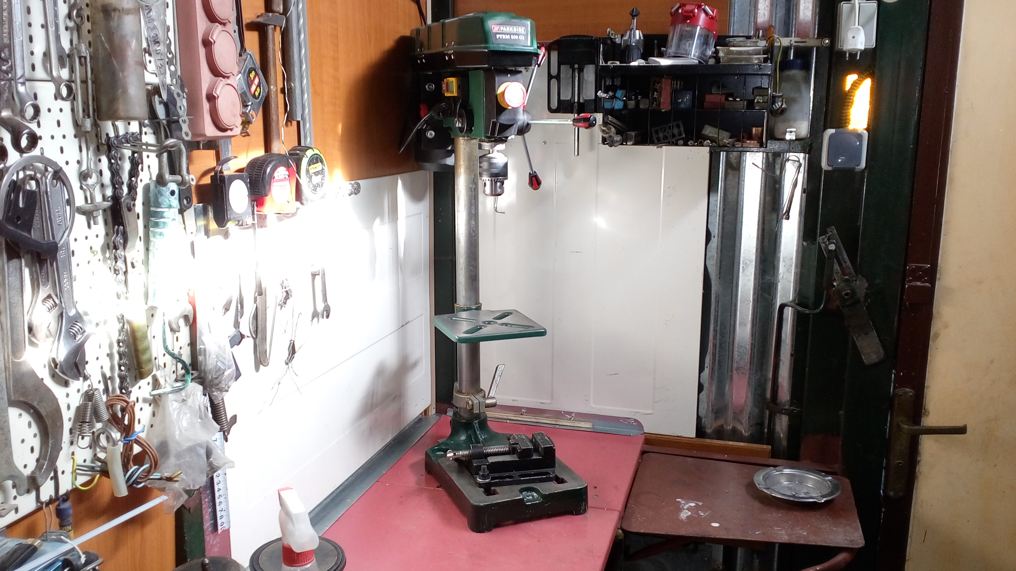

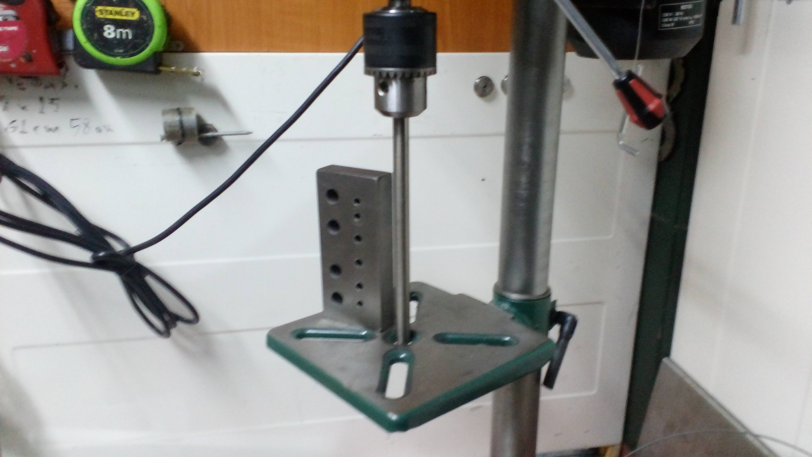

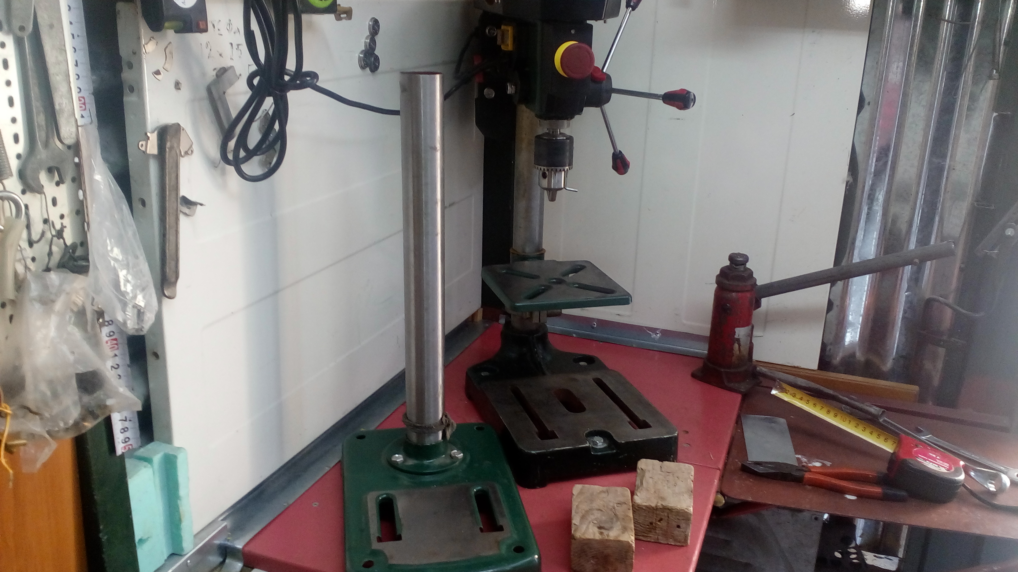

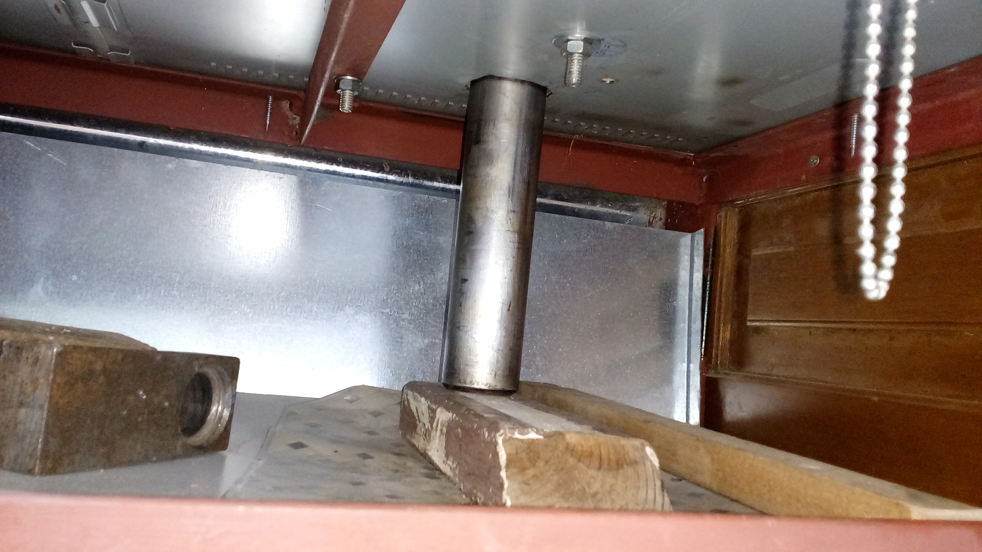

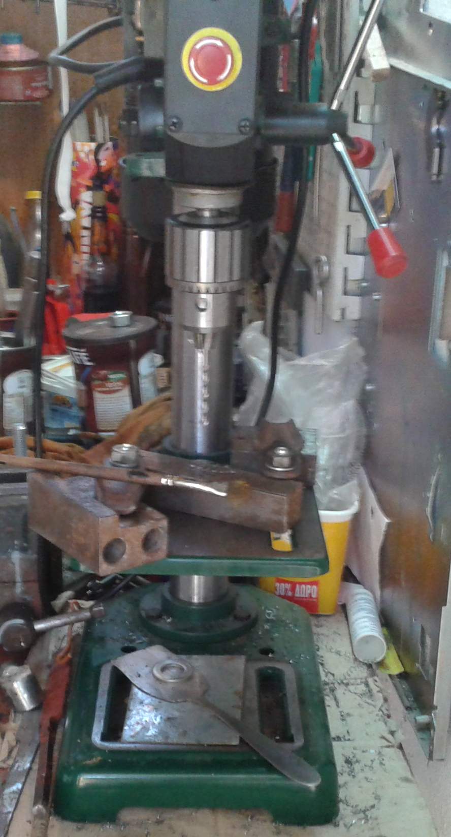

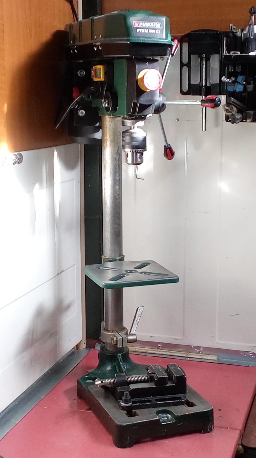

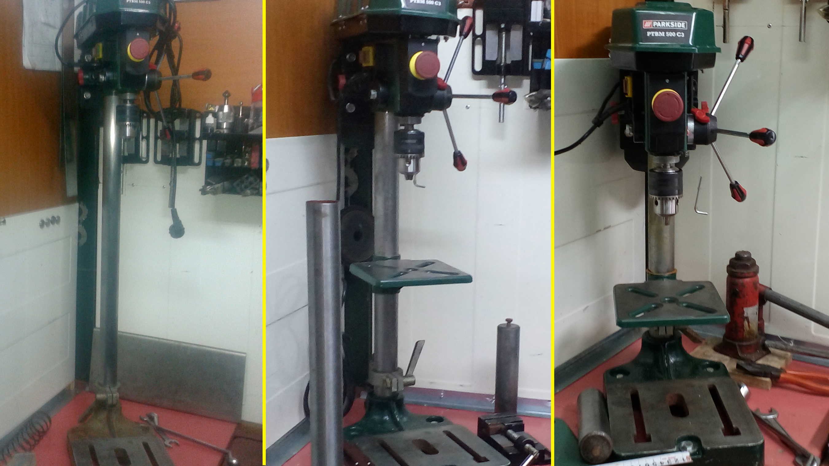

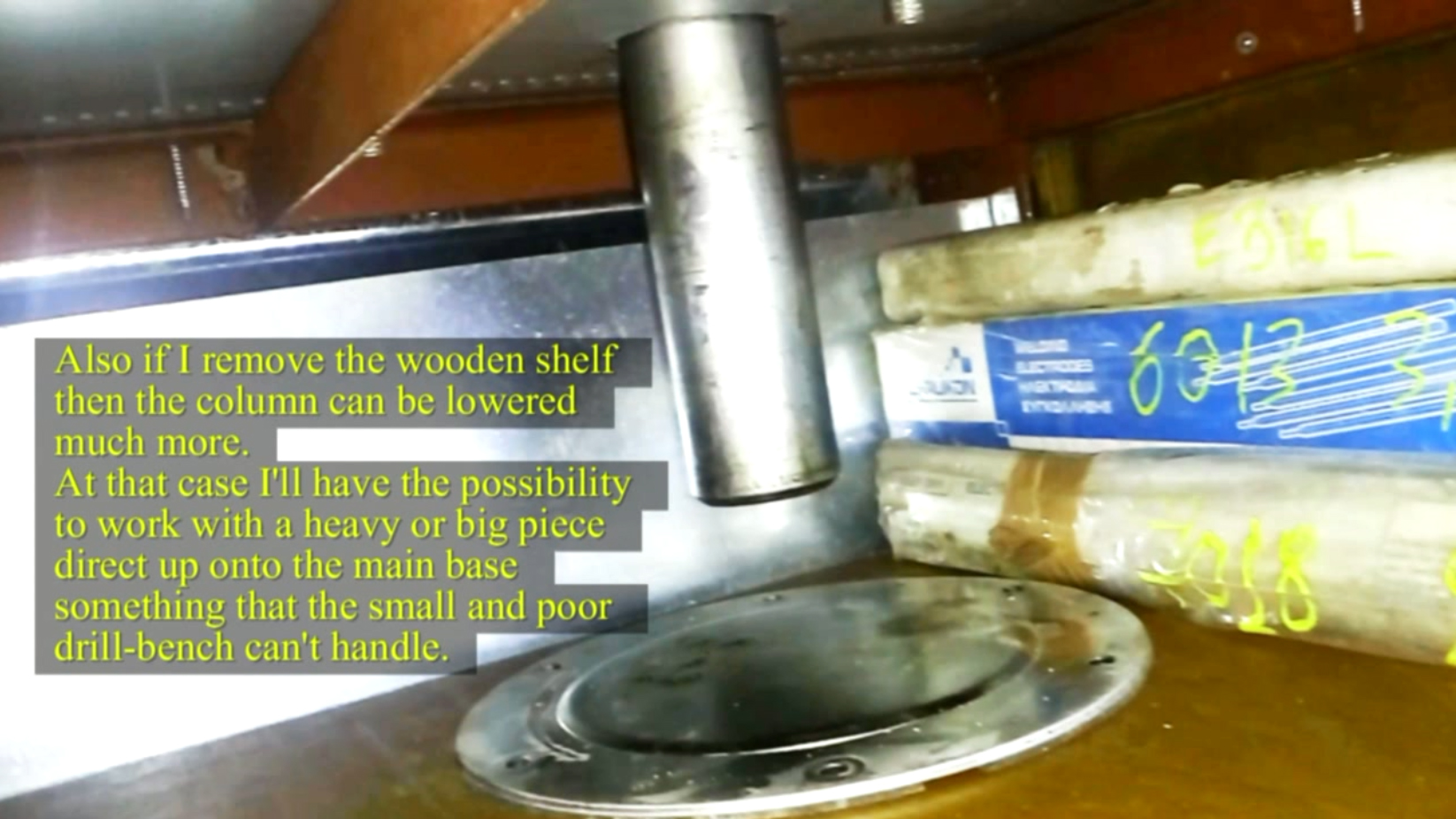

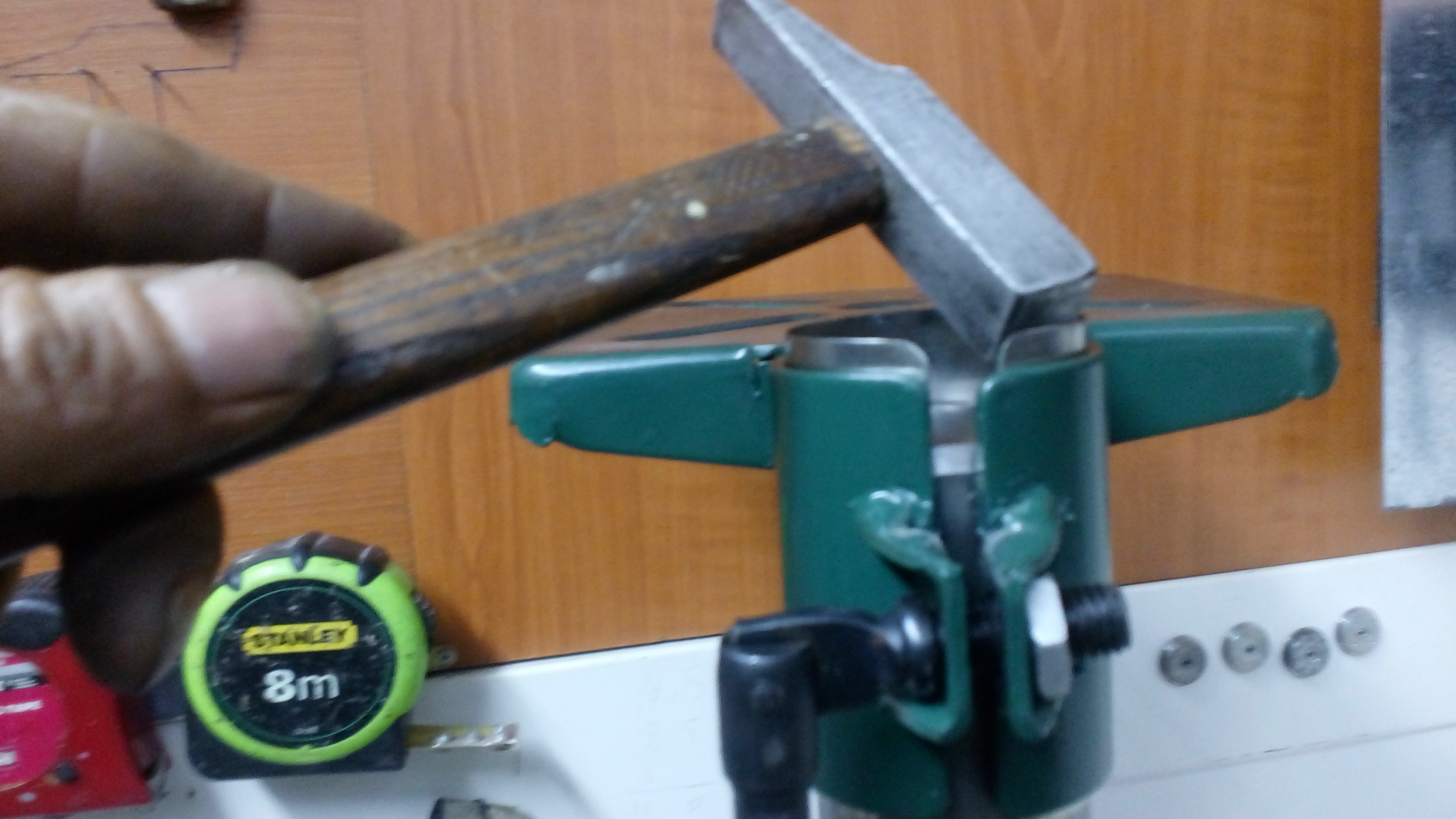

    From the very first day I bought this drill press (Parkside PTBM 500 C3)
    I had in mind to replace the column that was too poor (a tube ø46x450x1.5mm) and relatively short with a solid one
    as well as its base with something more robust and stiffer like a cast iron plate or a steel plate.

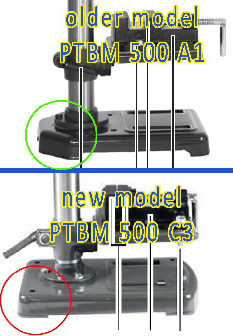

    The major problem was at the base; wrong geometry.
    When I push to drill then the main base distorts around the column and starting to move up and backwards losing its verticality.

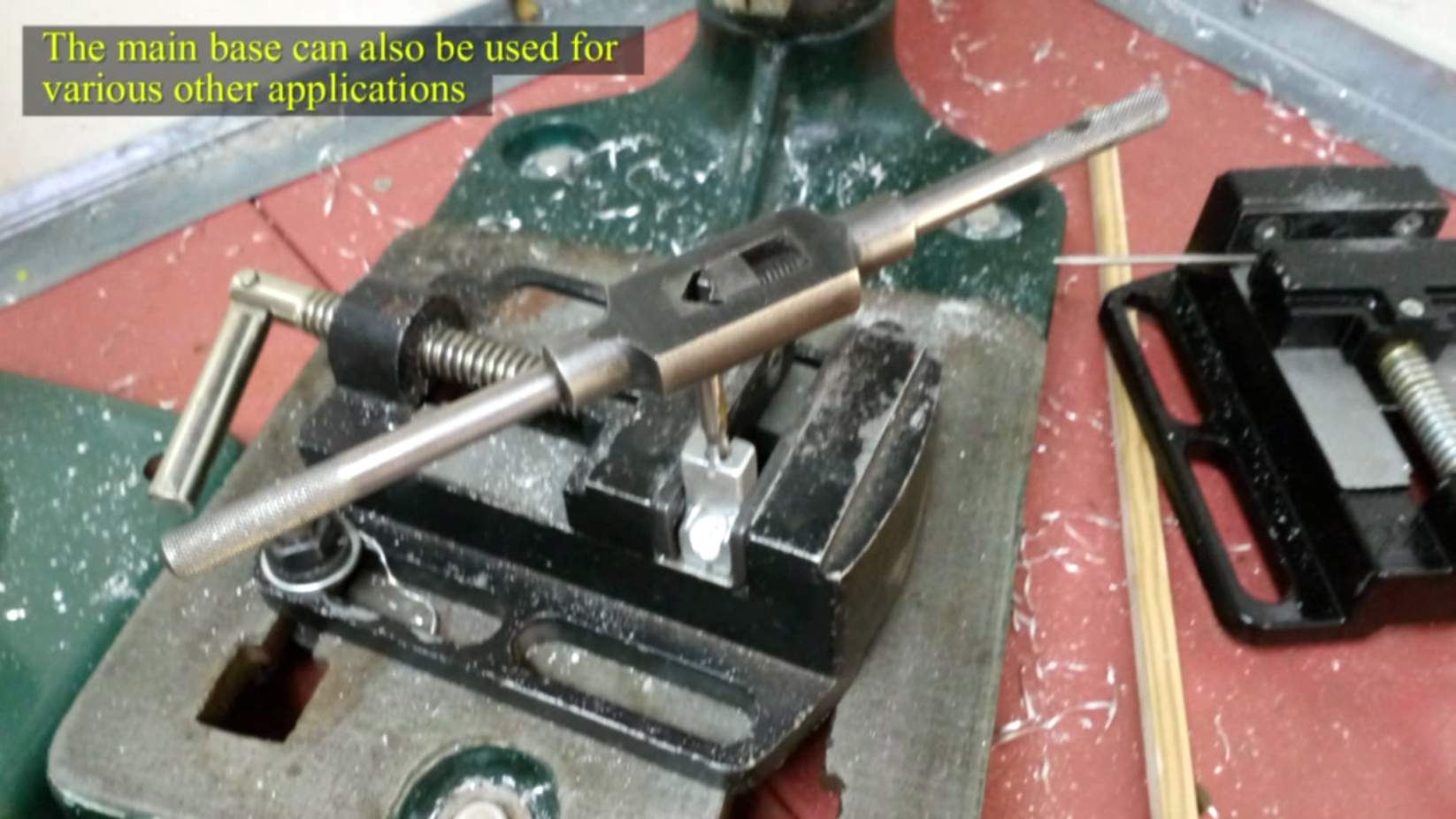

    I have an older model (PTBM 500 A1) that its base whereas it was sheet metal made;
    I never encountered any distortion issues like in this model.

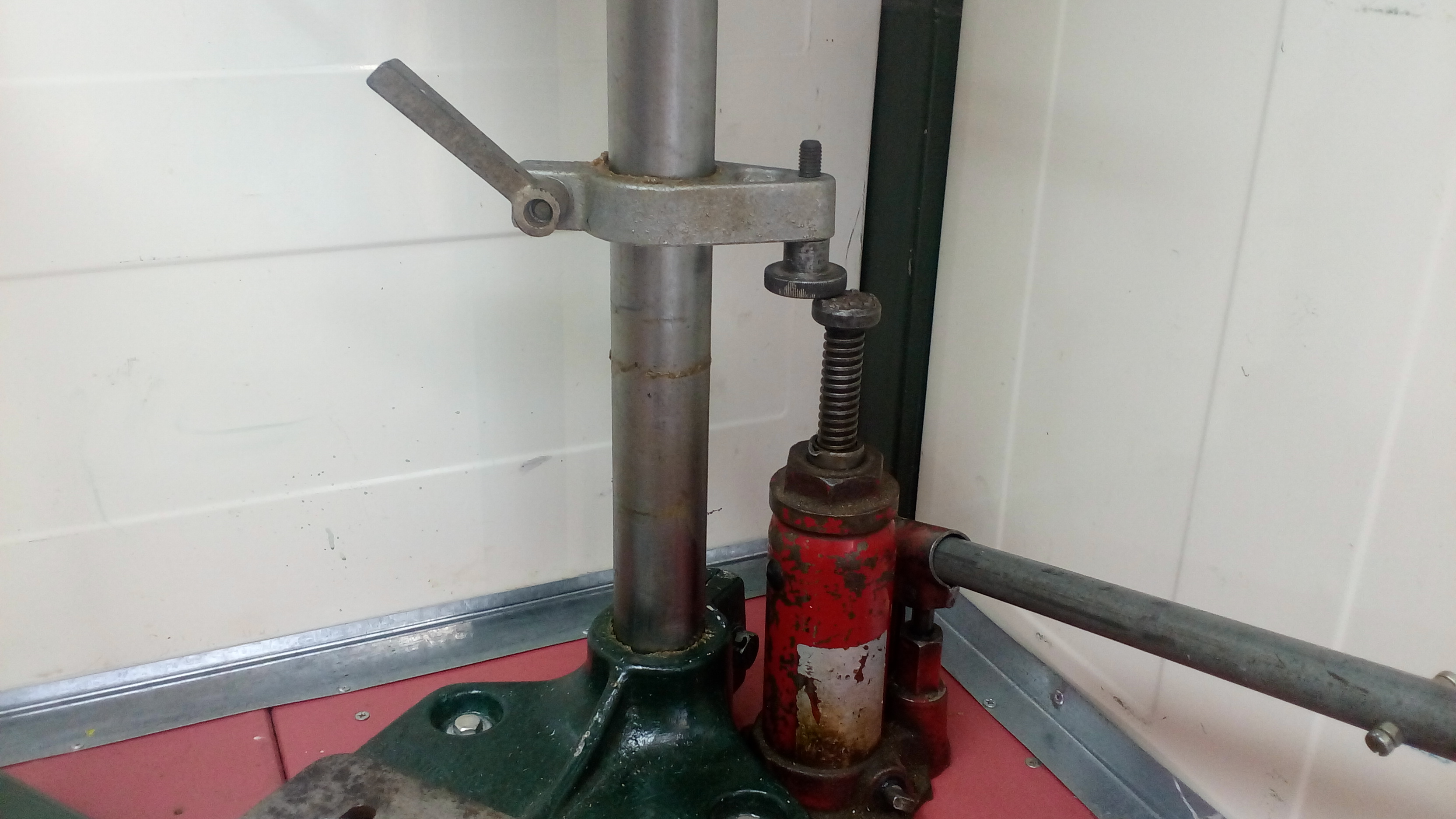

    Cheap Drill Press Improvements-old-new.jpg Cheap Drill Press Improvements-20150810_192551-crop_1.jpg

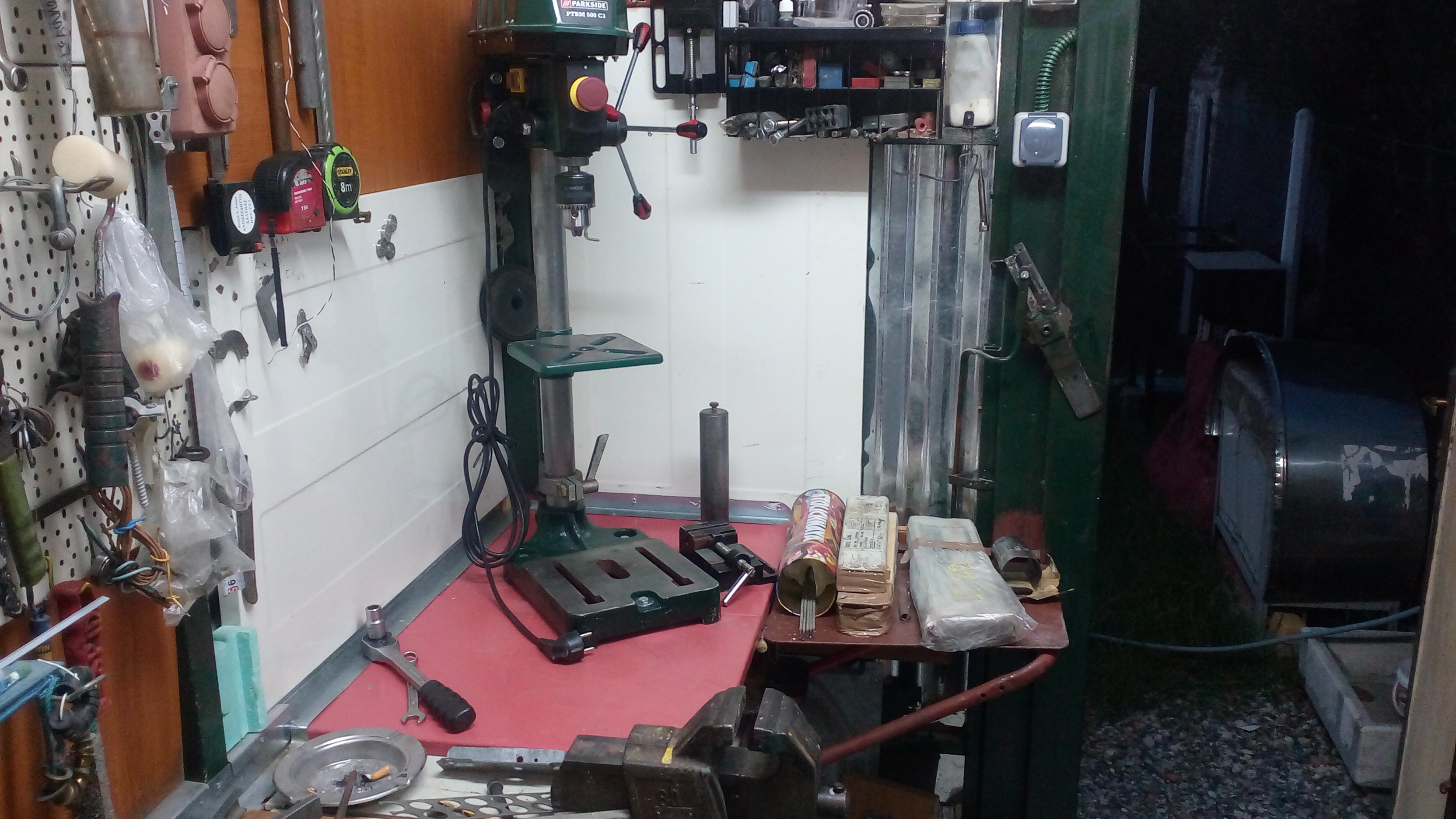

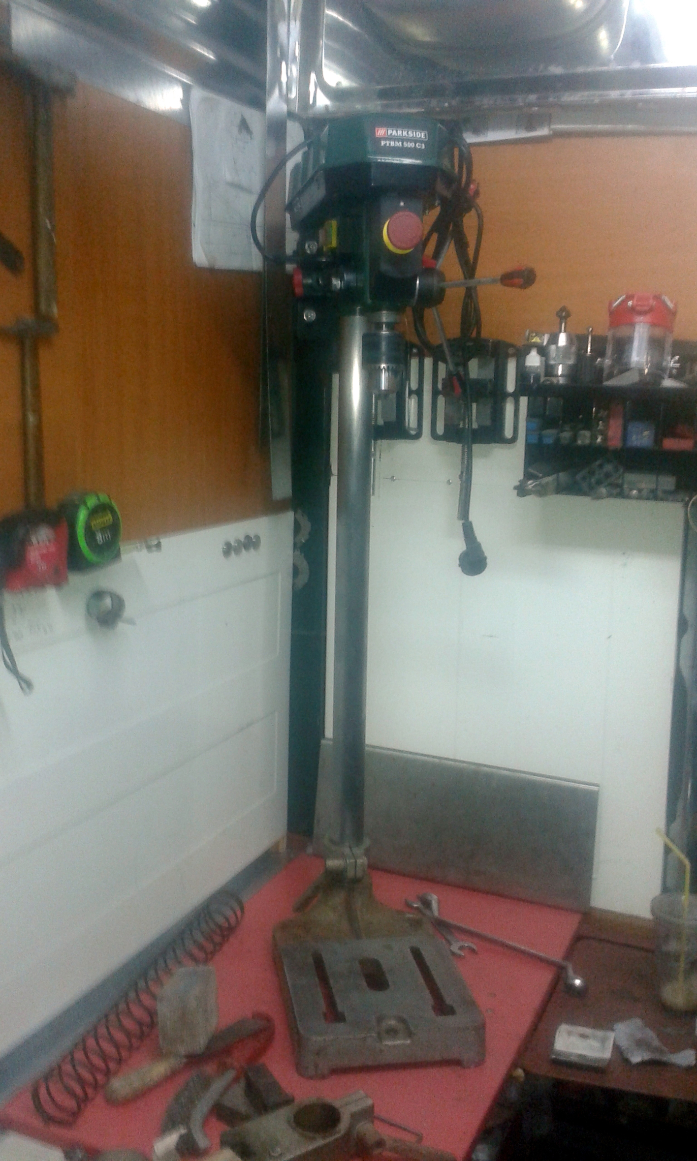

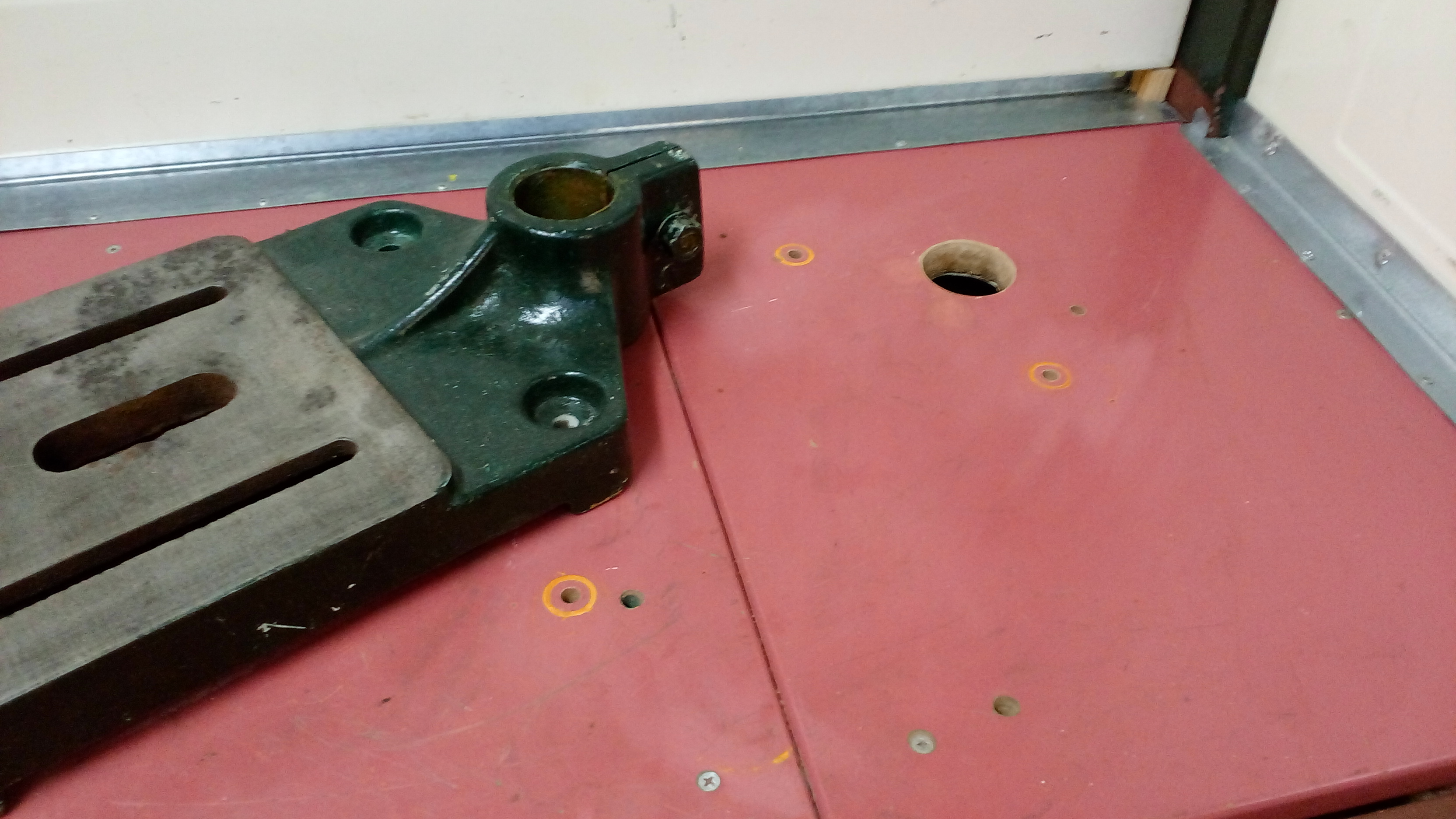

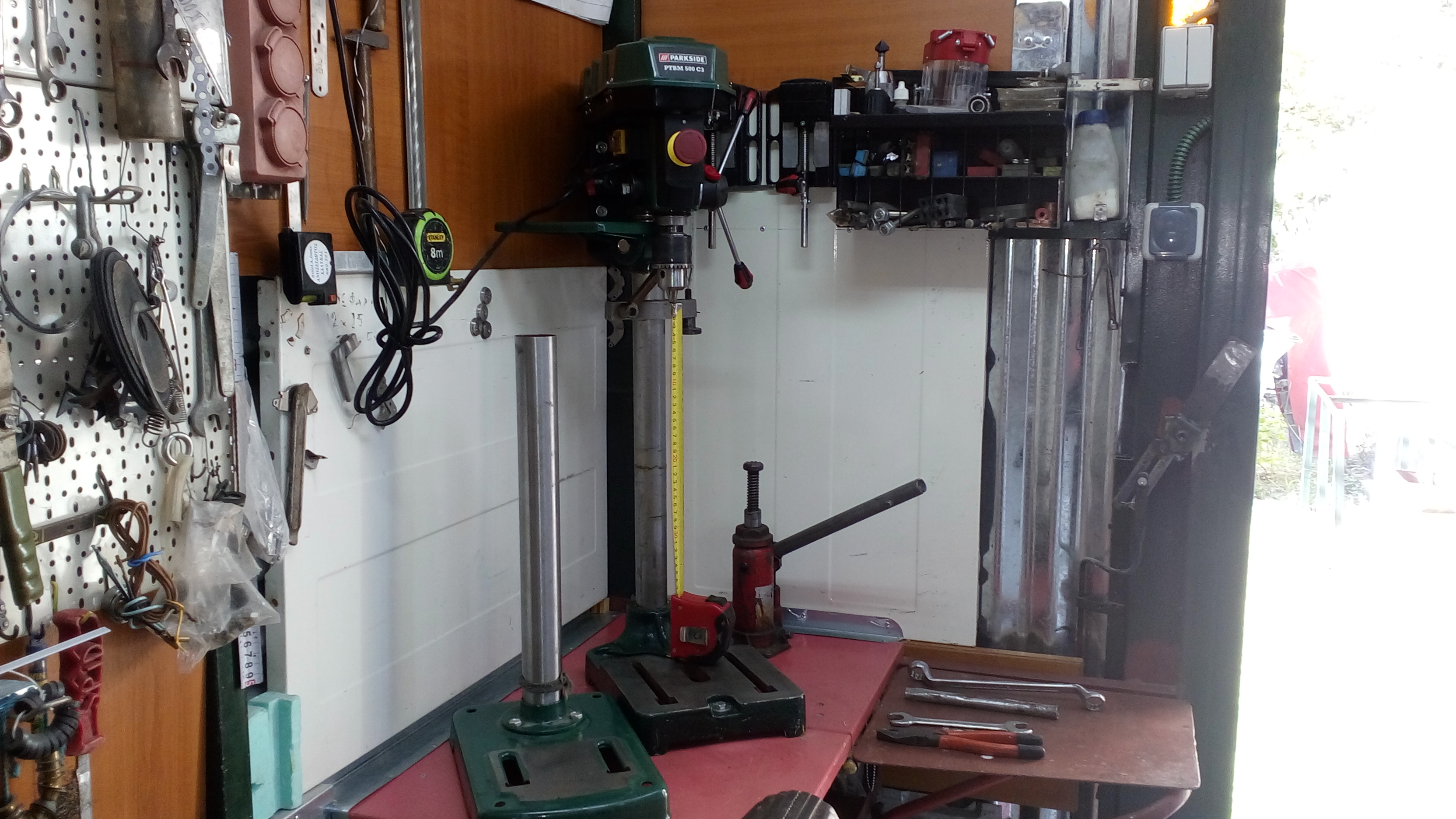

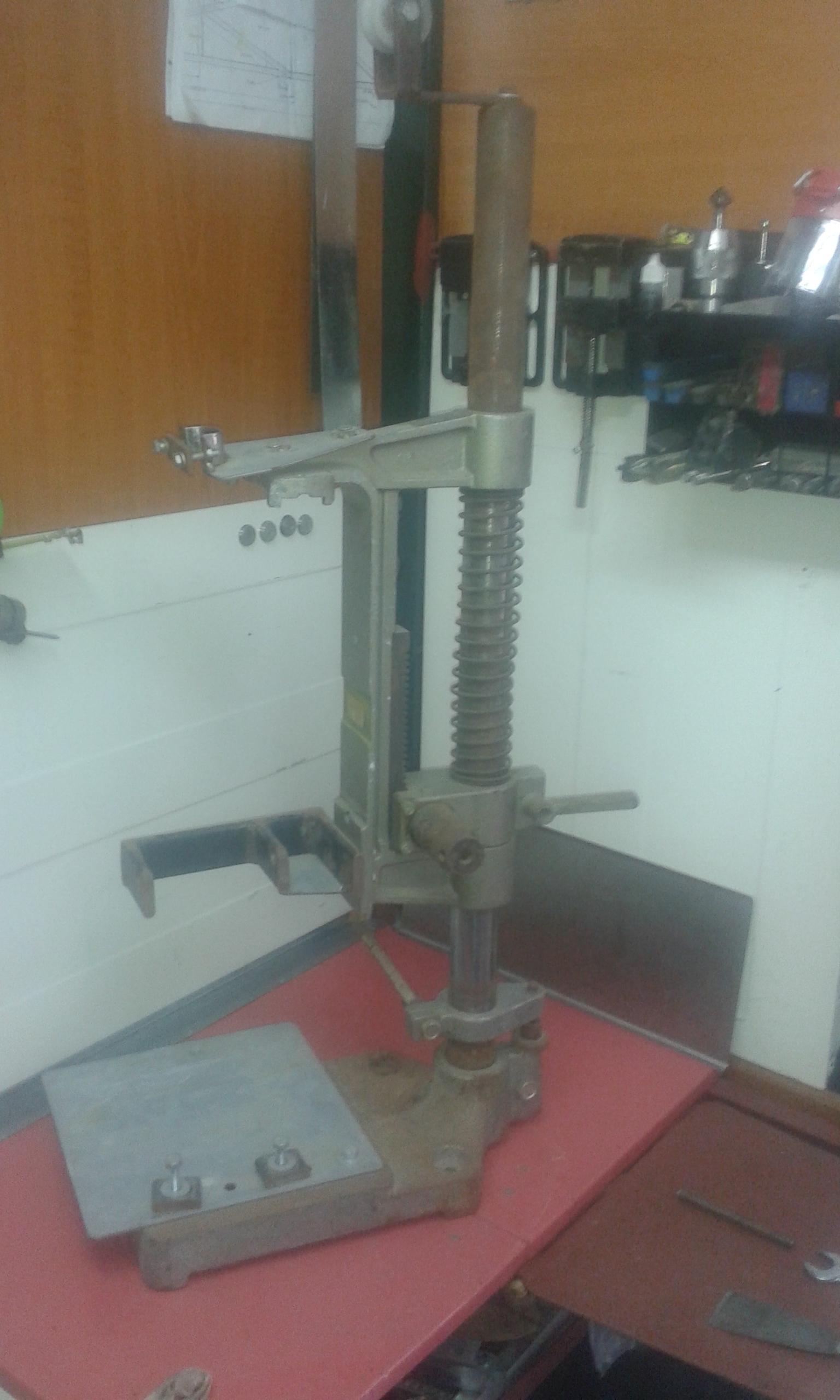

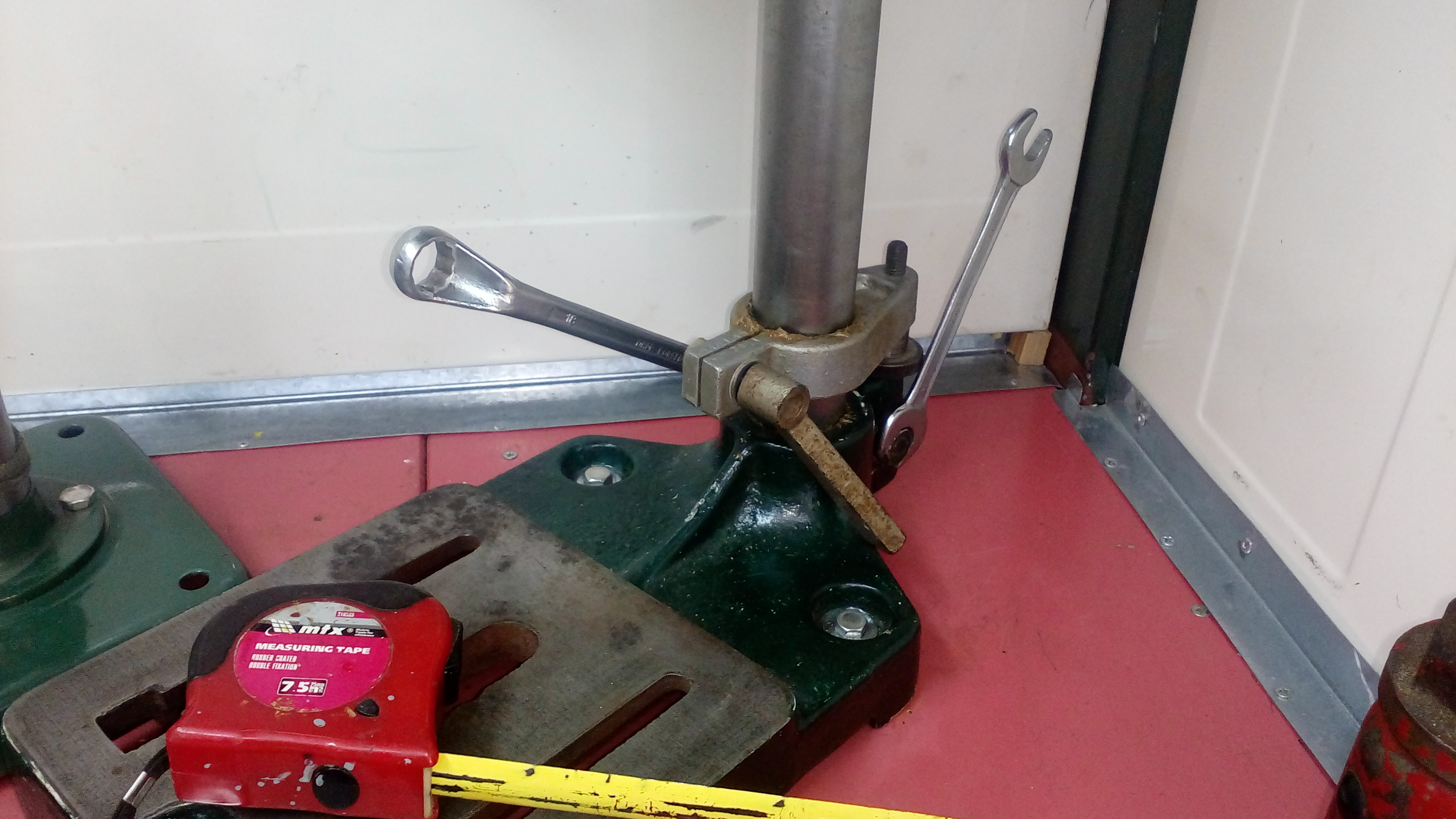

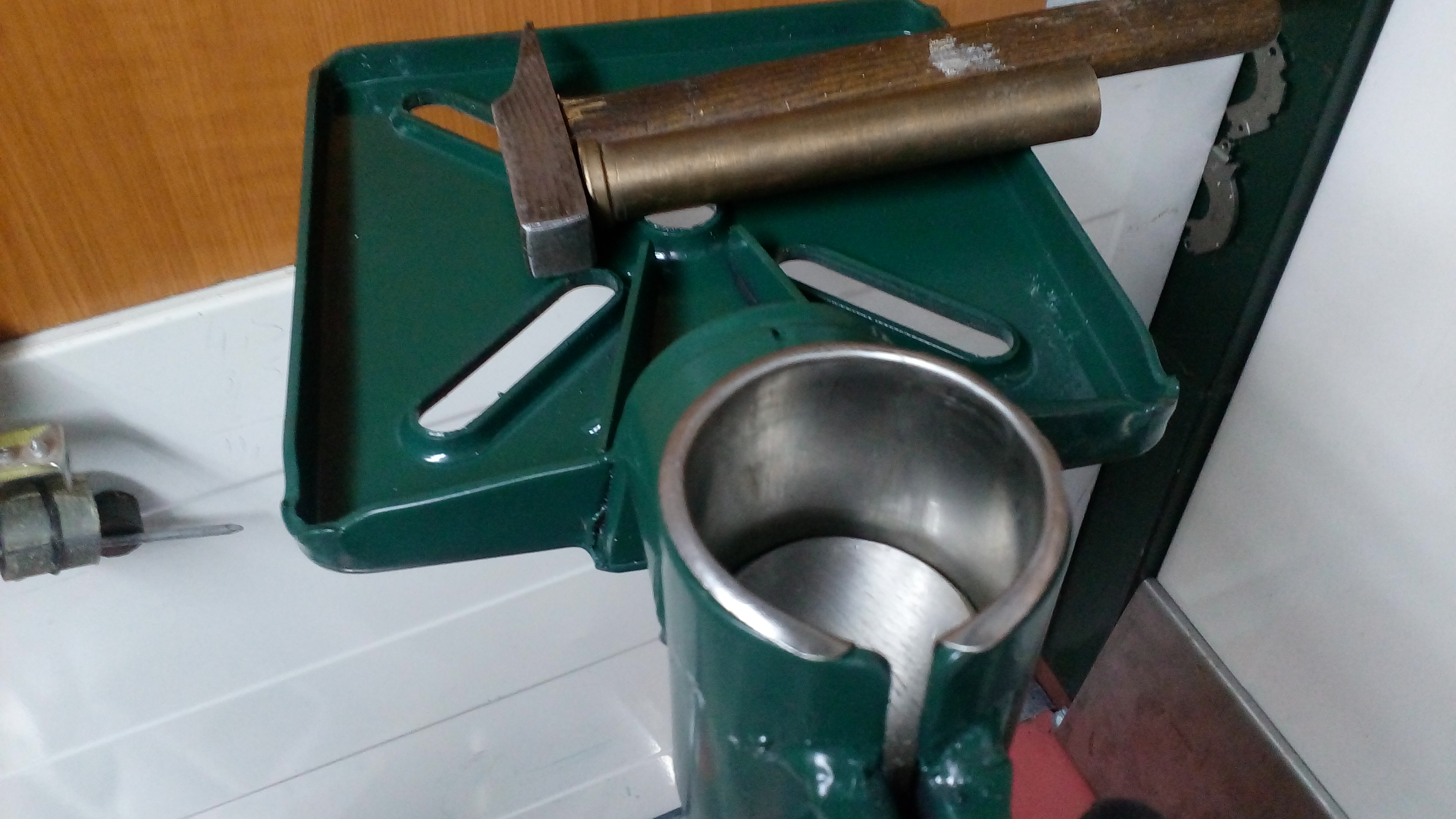

    Searching at the junkyard I found this stand that probably once it was a drill press base that later was modified to be used for some other application.
    Its column diameter was ø45mm (one millimeter less than the needed) but it wasn't a so big deal.
    The base of the stand was cast iron.
    So I decided to buy it and give a try.
    Cheap Drill Press Improvements-20180114_162435-r.jpg Cheap Drill Press Improvements-191103-r-auto-leves.jpg Cheap Drill Press Improvements-img_20100104_042035.jpg Cheap Drill Press Improvements-img_20100104_044708.jpg Cheap Drill Press Improvements-img_20100104_061435.jpg Cheap Drill Press Improvements-hight-low-3-pos.jpg Cheap Drill Press Improvements-img_20180804_180540-crop.jpg Cheap Drill Press Improvements-img_20180804_201901.jpg Cheap Drill Press Improvements-img_20180805_121018.jpg Cheap Drill Press Improvements-img_20180805_184337.jpg Cheap Drill Press Improvements-img_20180805_185748.jpg Cheap Drill Press Improvements-img_20180805_183547.jpg Cheap Drill Press Improvements-img_20180805_190028.jpg Cheap Drill Press Improvements-img_20180805_191451.jpg Cheap Drill Press Improvements-2.jpg Cheap Drill Press Improvements-3.jpg Cheap Drill Press Improvements-img_20180804_205855.jpg Cheap Drill Press Improvements-img_20180819_093858-crop.jpg Cheap Drill Press Improvements-img_20180819_093858.jpg
