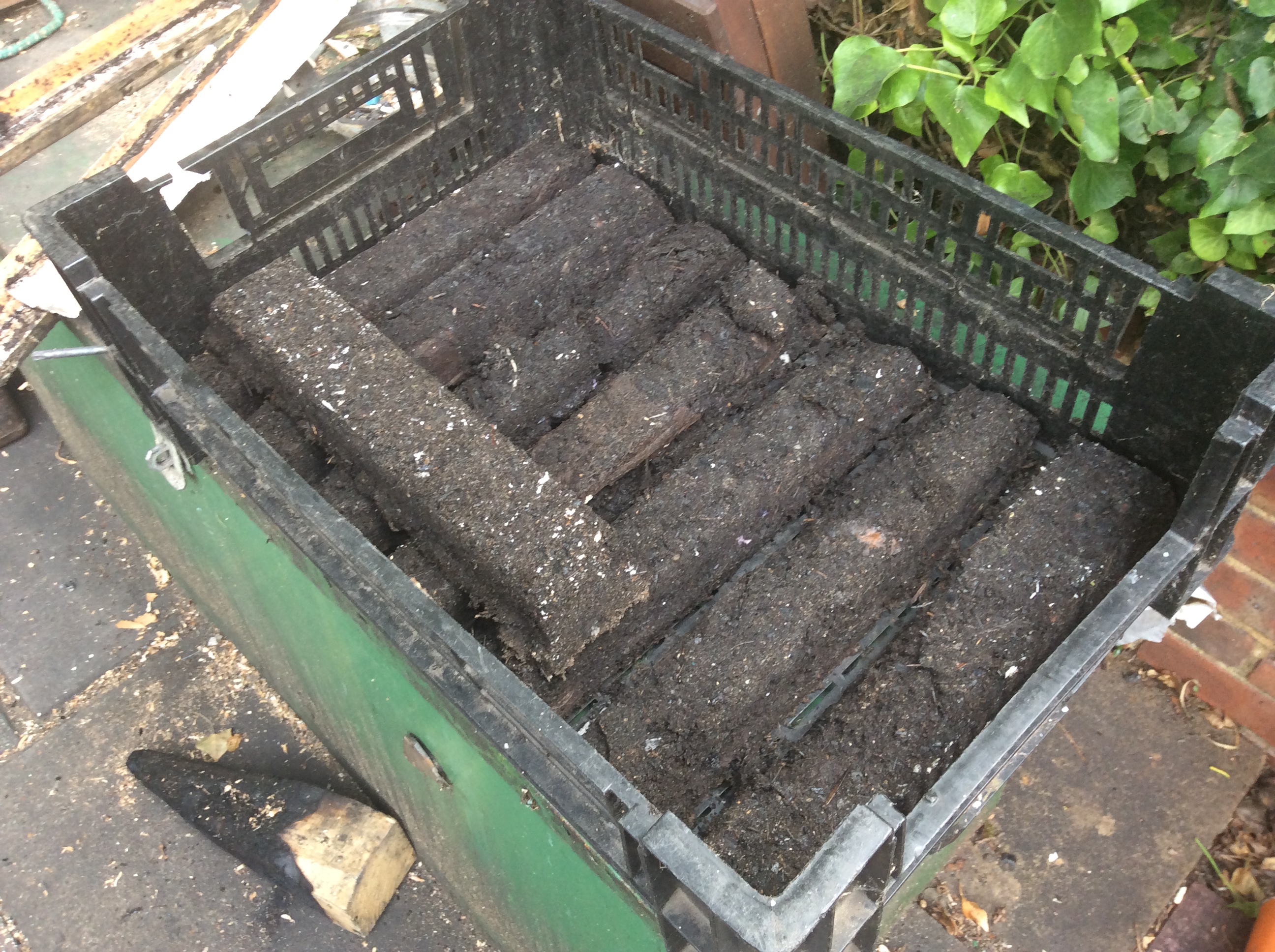

    I make my own charcoal for forging. This is very small scale, since I use broken furniture which I am given. Since it is possible to do SOME forging using firewood only, in the winter I am keeping warm AND forging AND making charcoal, by raking out the glowing embers between heats, and sealing them in a steel box. But I am also busy with drilling, sawing, chopping, buffing WHILE that’s going. I am not standing there waiting for the iron to turn red.
    When I have a chest full of charcoal, I sieve it. The briquettes are made from the fragments which remain, plus sawdust, pine needles, paper pulp, mixed with jam specially boiled up from damsons picked a fortnight ago.
    The briquettes are still a bit damp, but they resemble peat. They will burn.

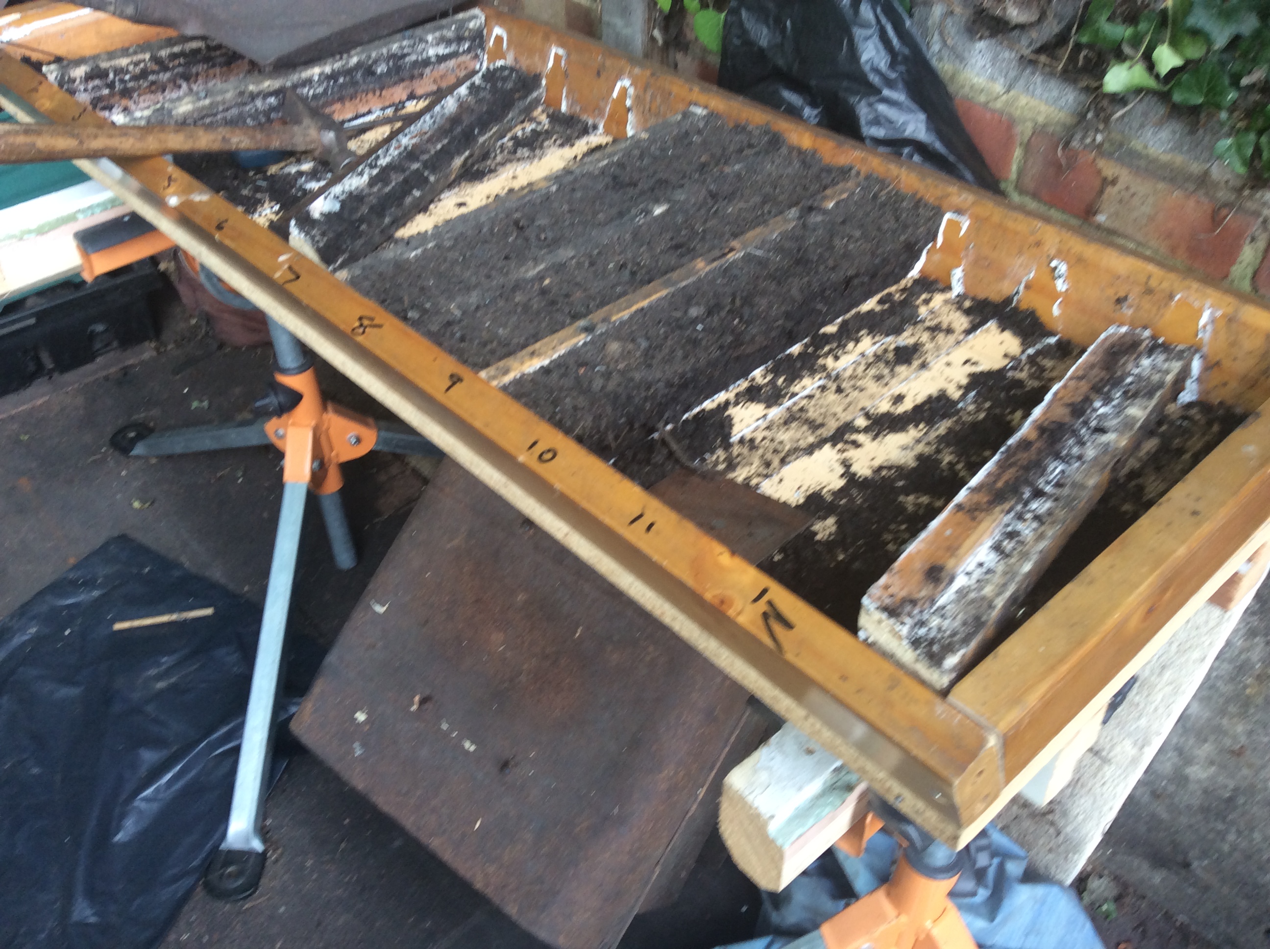

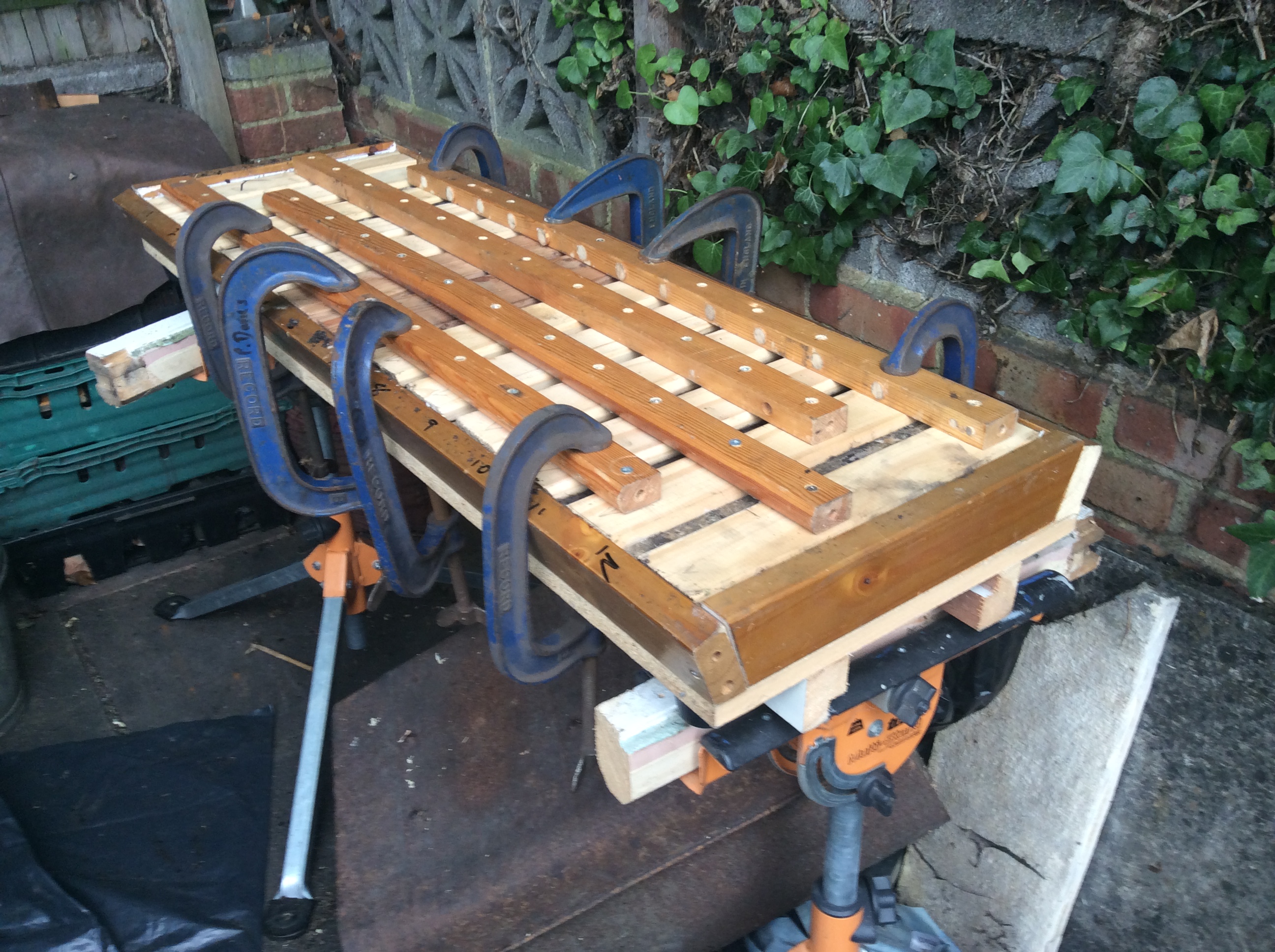

    This is the formwork I made for the experiment. From old furniture. The ribs are tapered and were smeared with molten wax.

    interesting idea. As for that Jam, is it a real jam or just ground up plums? If a jam what do you use for a sweetener?

    Thanks, Wizard! I have just made up a second batch. I simmered the plums for twenty minutes, poured it hot into the charcoal/sawdust/pine needle mix adding nothing else except paper pulp, using a power mixer/stirrer in a power drill, as you would to mix plaster. This resulted in a mouldable mass which I shovelled into the formwork, tamped it down with a paddle or pestle, then clamped the ladder in place. I shall leave it now 10 days, but it will come out in complete cakes, that can be crumbled or burnt whole, with or without drought, hopefully not too smoky, but I shall wait for rain. The damsons are in season, nearby, and nobody else picks them. Other fruits may work just as well. Elderberries will be tried next.
