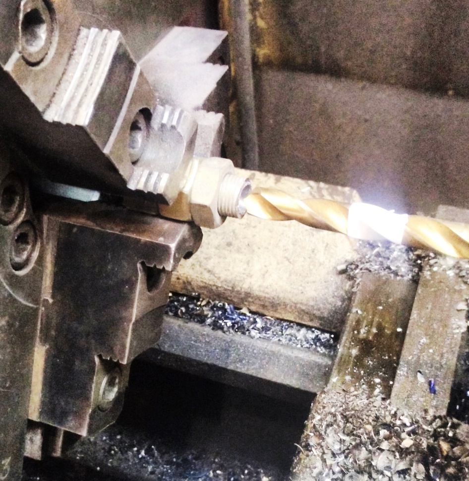

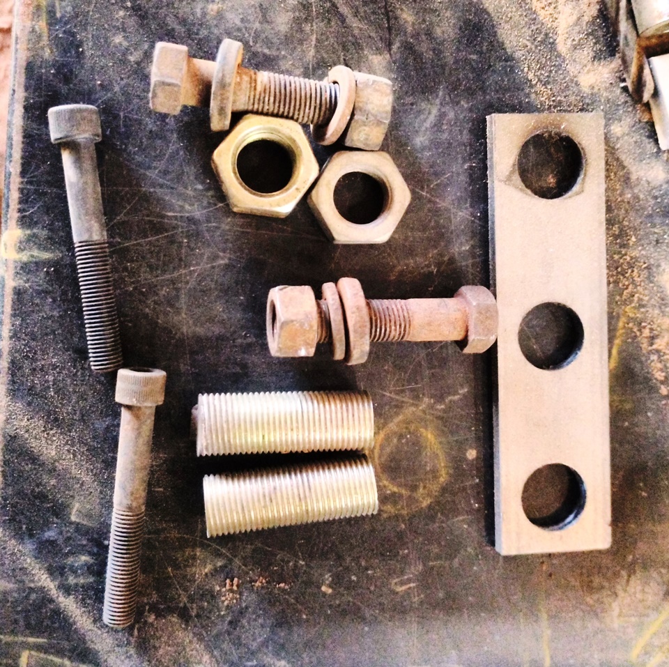

    here is what I did I stated with 2 pieces of 5/8" fine threaded rods . the rods were the cut offs of semi truck air brake chambers so they are hardened grade 8 to start out with. and 2 5/16 socket head bolts a pair of fine thread 5/8 nuts and a pair of 1/2" fine thread bolts I wound up not using the 2 in the picture because I found a pair of 1/2" socket head bolts with better threads

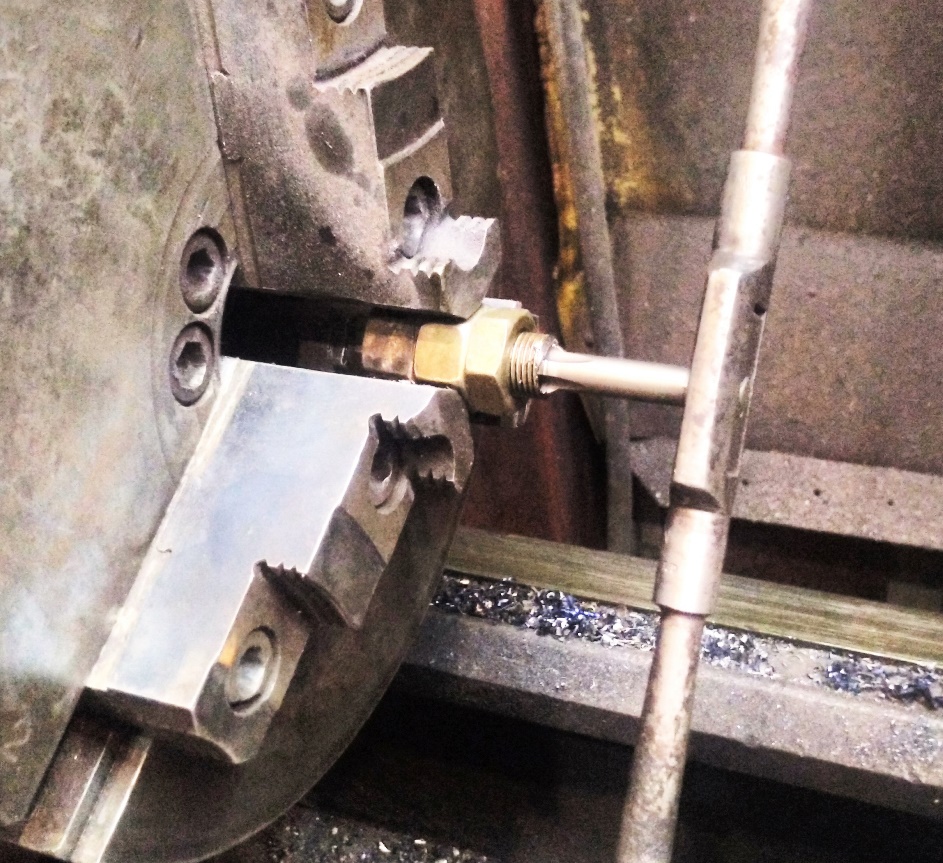

    I drilled the rods with a 5/16" drill bit then counter drilled with a 29/64" to the depth of the white tape then threaded the inside to 1/2-20 TPI then filed flats on 1 end to fit a 9/16" wrench
    turned down and off most of the head on the 5/16 bolts cross drilled to the chain pin size and parted them off. cross drilled the 1/2" bolts and parted them off as well and ground flats on them to the thickness of a chain link. then sawed the 5/8' nuts in half to make 4 jam nuts

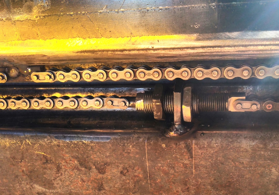

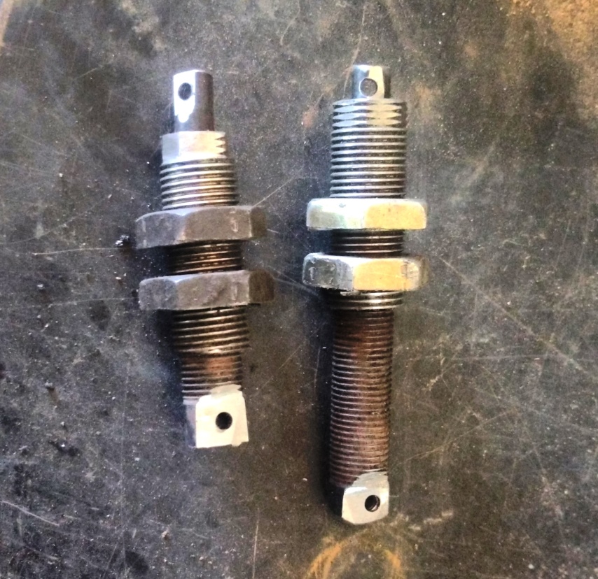

    this is how they turned out.

    you can see all 4 ends of the 2 chains once the chains are tight it is just a matter of moving the jam nuts one way or the other on either side of the machine to achieve the correct position for the part they are connected to
