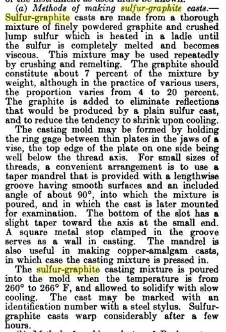

    Sulphur-Carbon casting recipe from NBS Handbook 1934
    Melting point of sulphur is (as you all already know):
    115 °C or 240 °F
